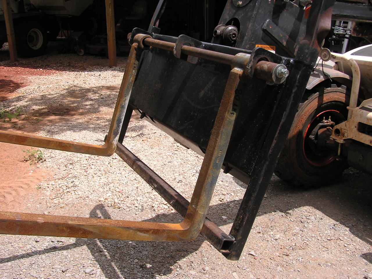

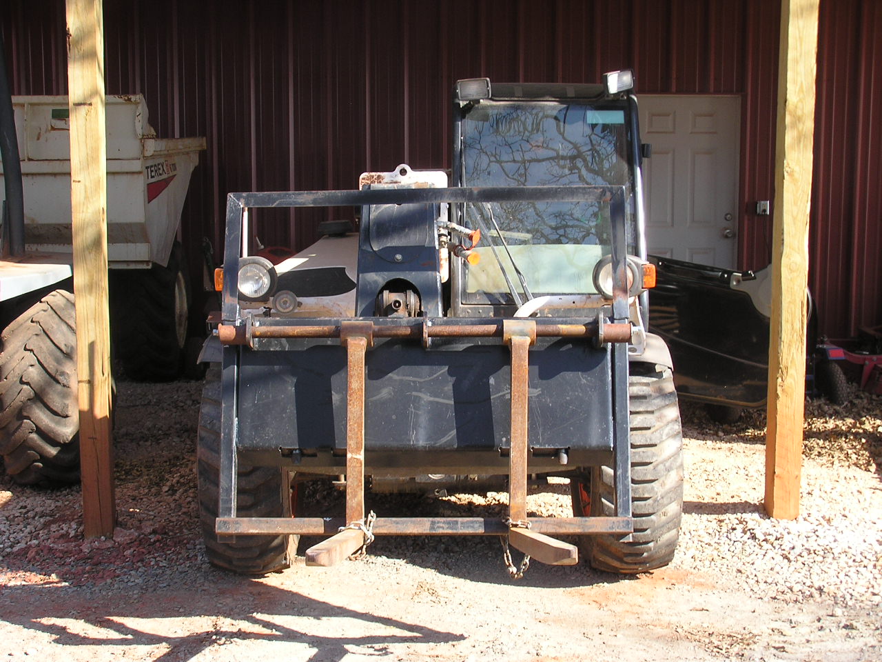

John, since you are building your own, consider this design.
It would be lighter than all the extra receivers. You can still make the forks from tubing.

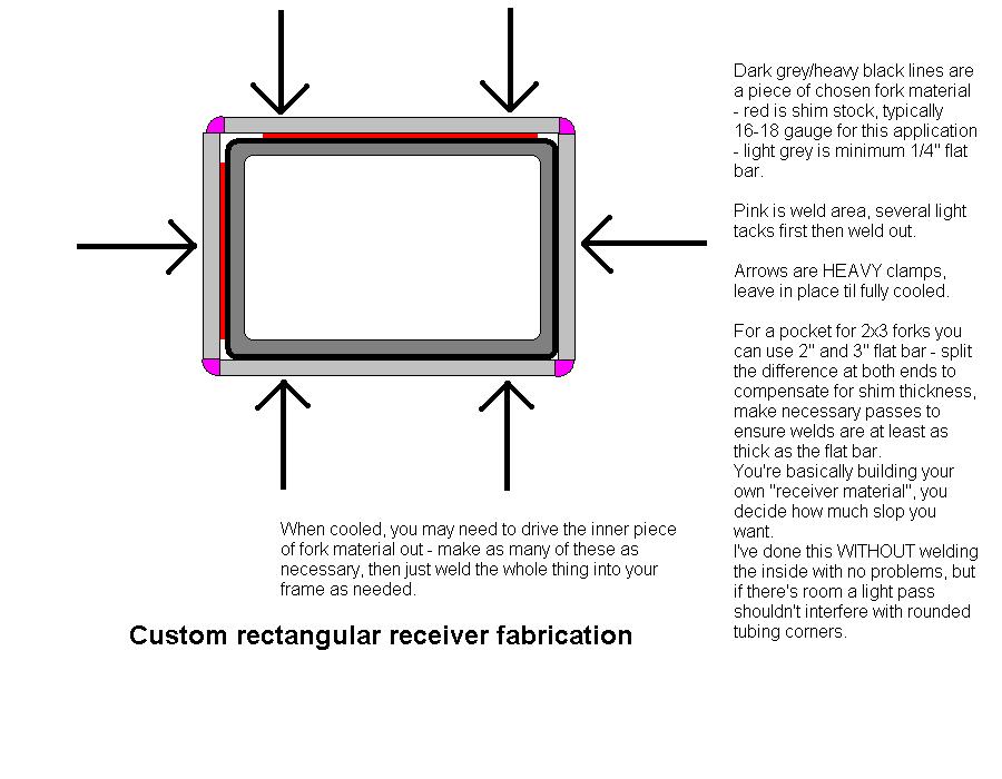

Joe, sorry I'm just now getting back - tax time, etc...
That 2.53 stuff you've been drooling over, AFAIK is ONLY available in SQUARE tube because that's what standard hitch receivers use.
My suggestion is something I've used a couple times with good results - build your OWN custom sized receivers, as many as you need, and weld them into your frame. This way you get the amount of clearance YOU need AND a receiver that isn't the weak link AND a PITA.
Here's how I do it - and if you're not experienced enough to know where, when and how much to weld and you're gonna have an experienced weldor do it, that's fine - I don't know what you're capable of, so take this sketch for whatever it's worth to you... Steve
