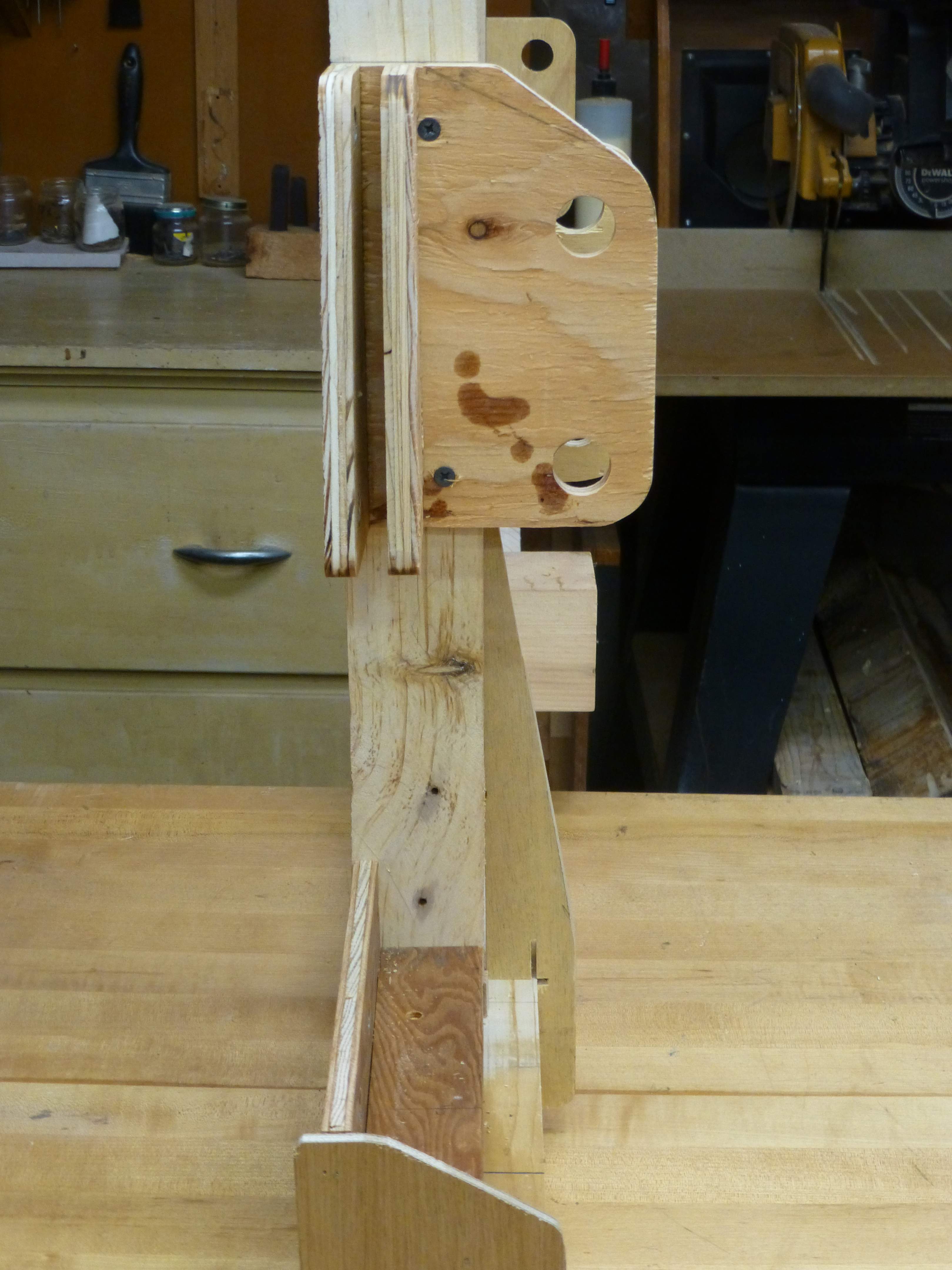

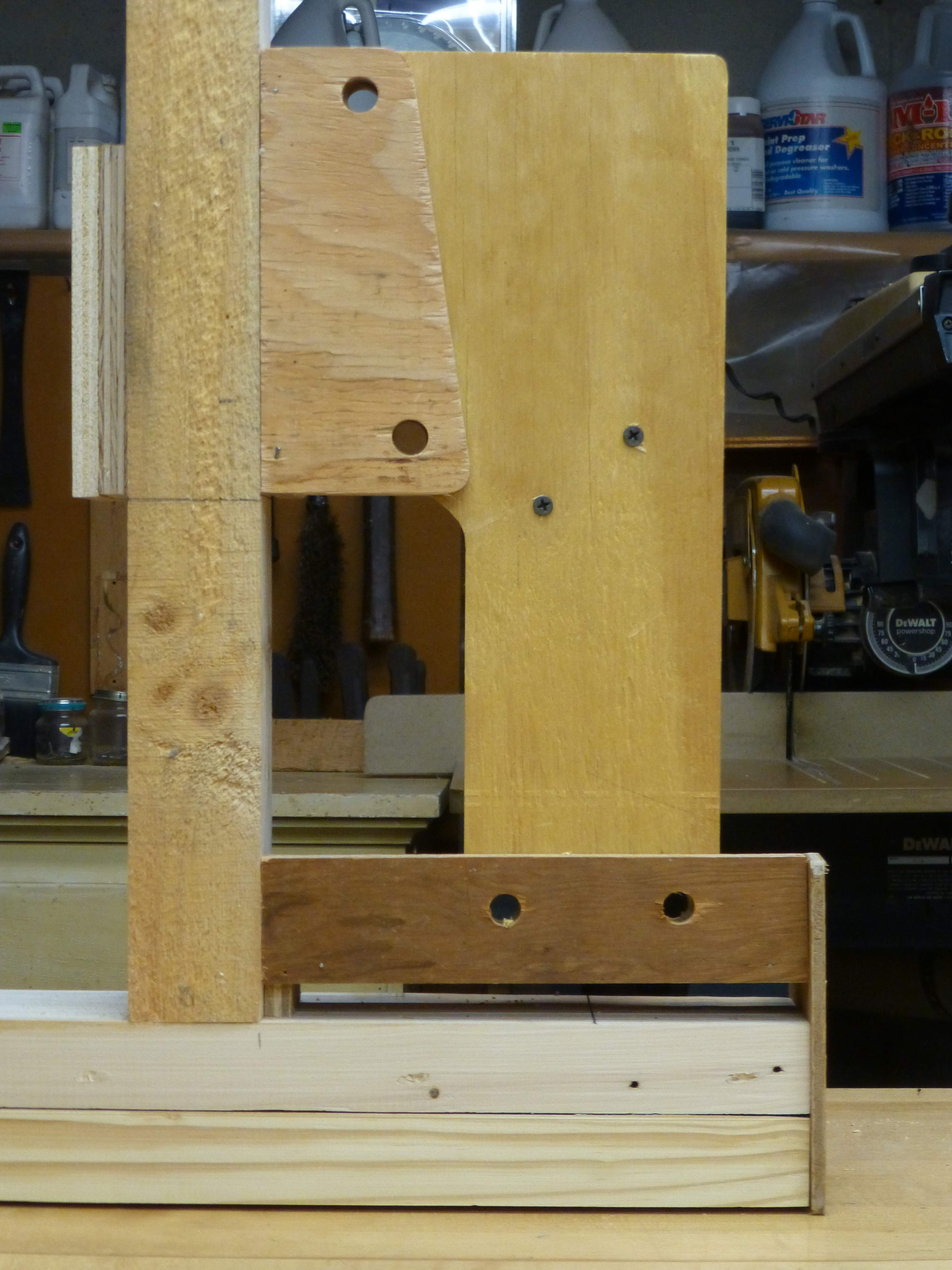

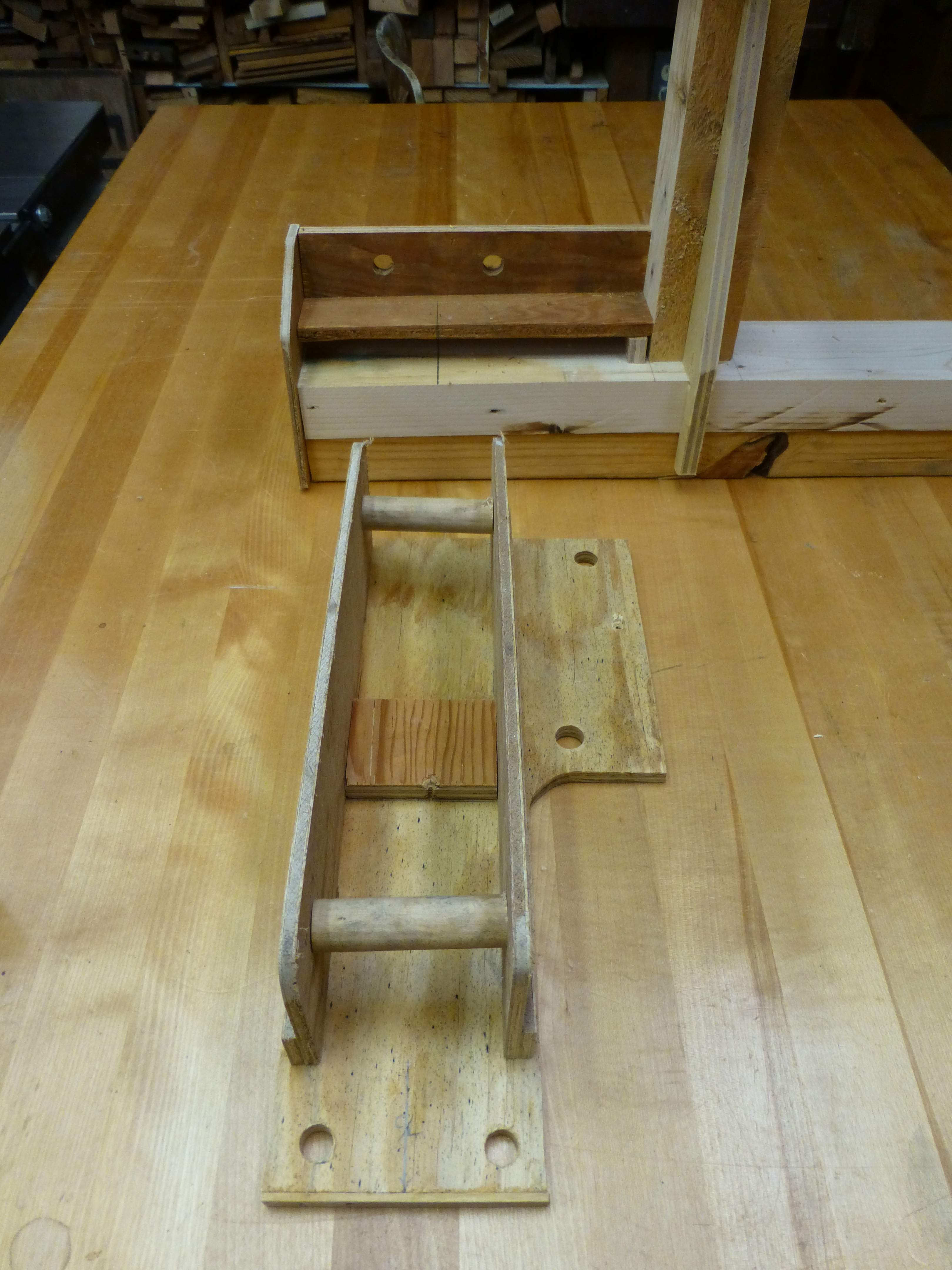

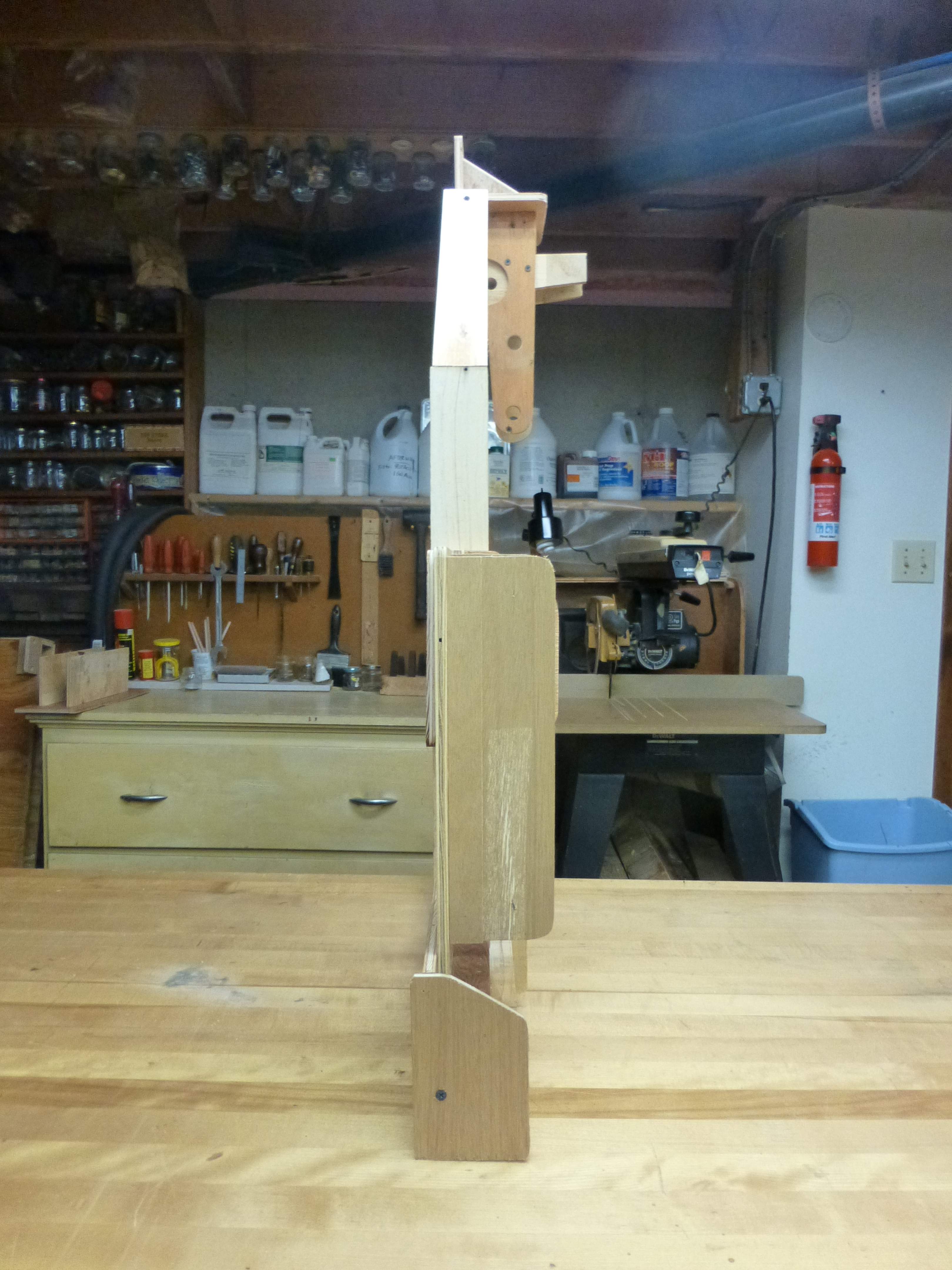

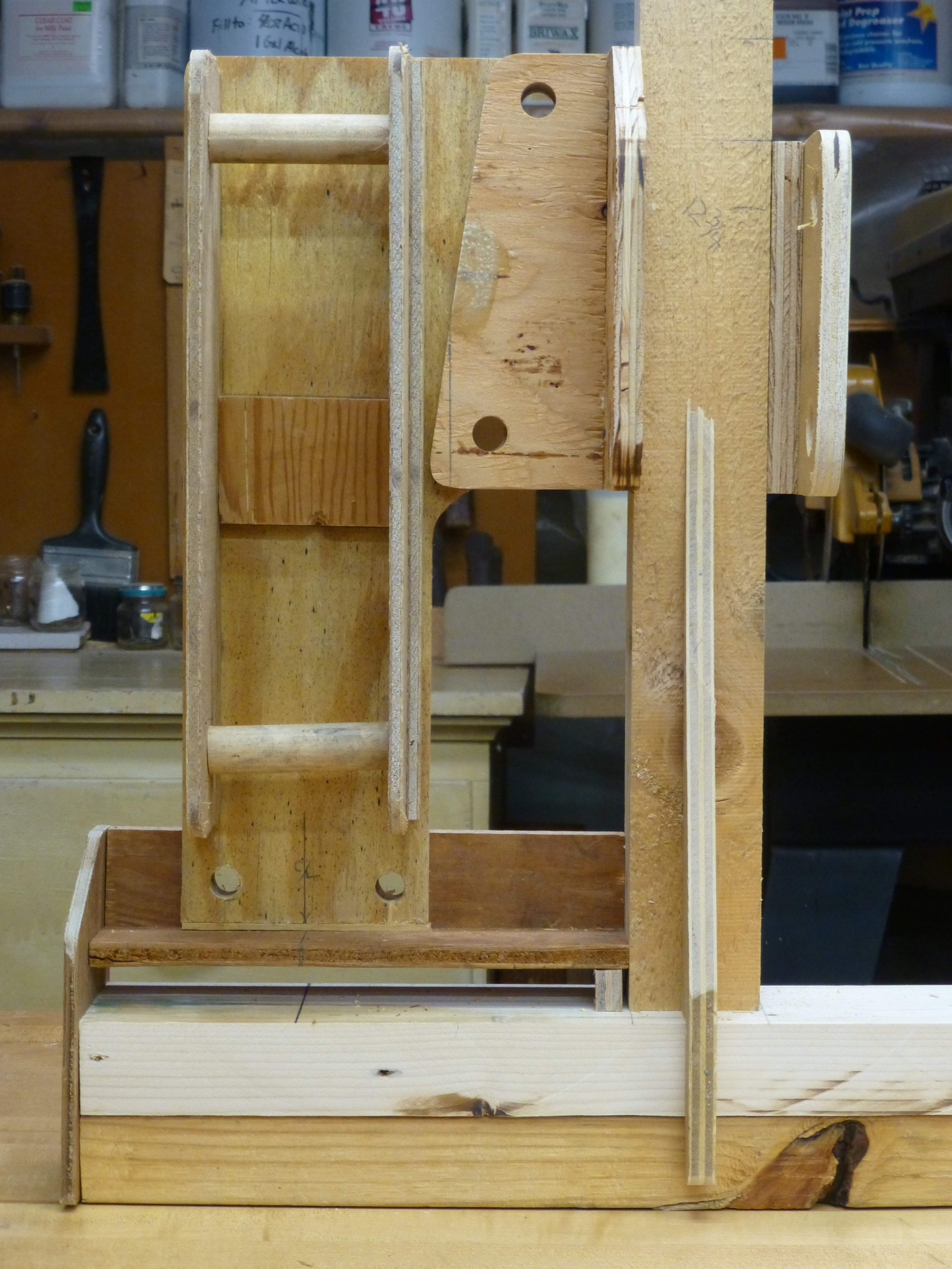

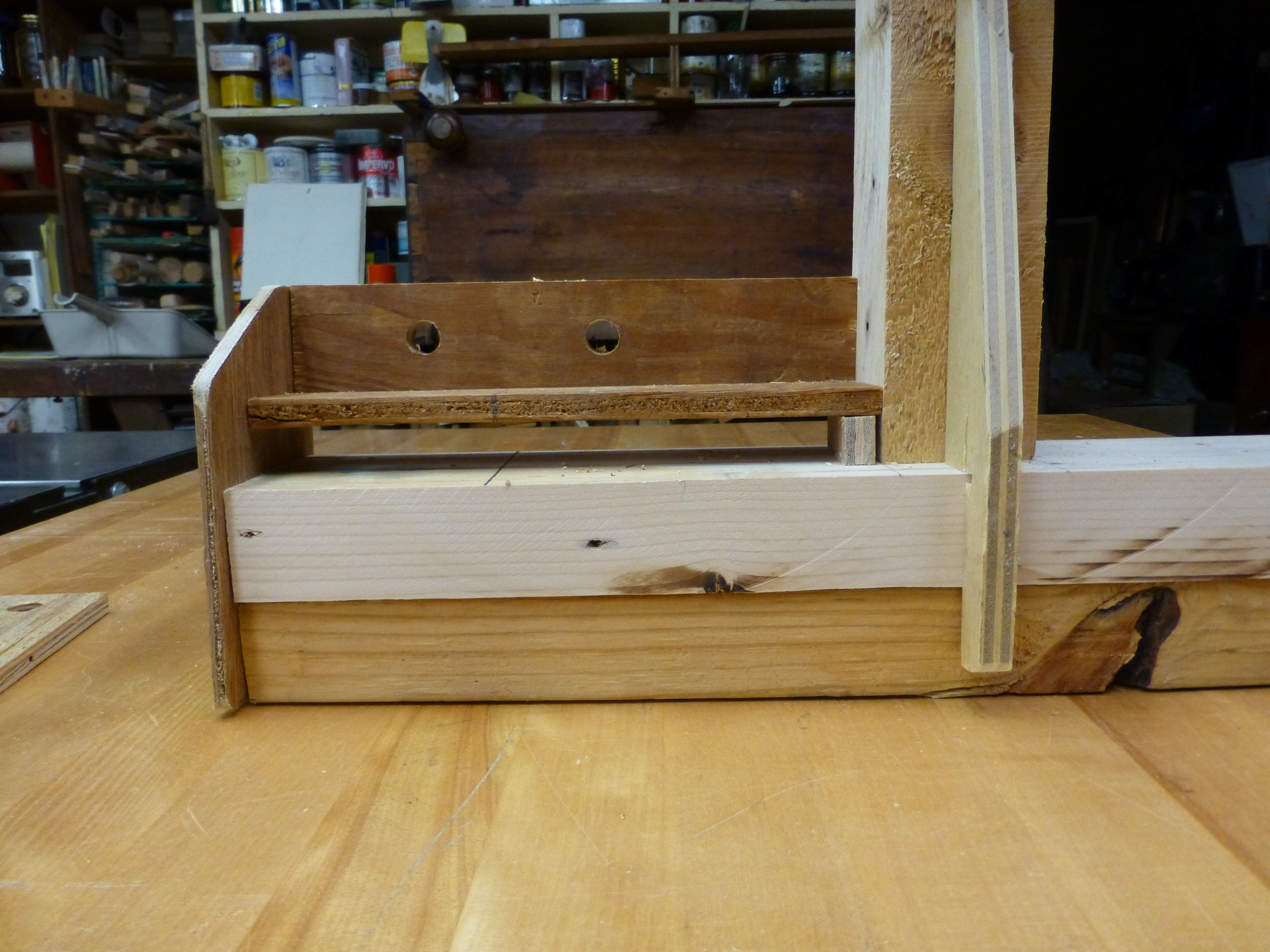

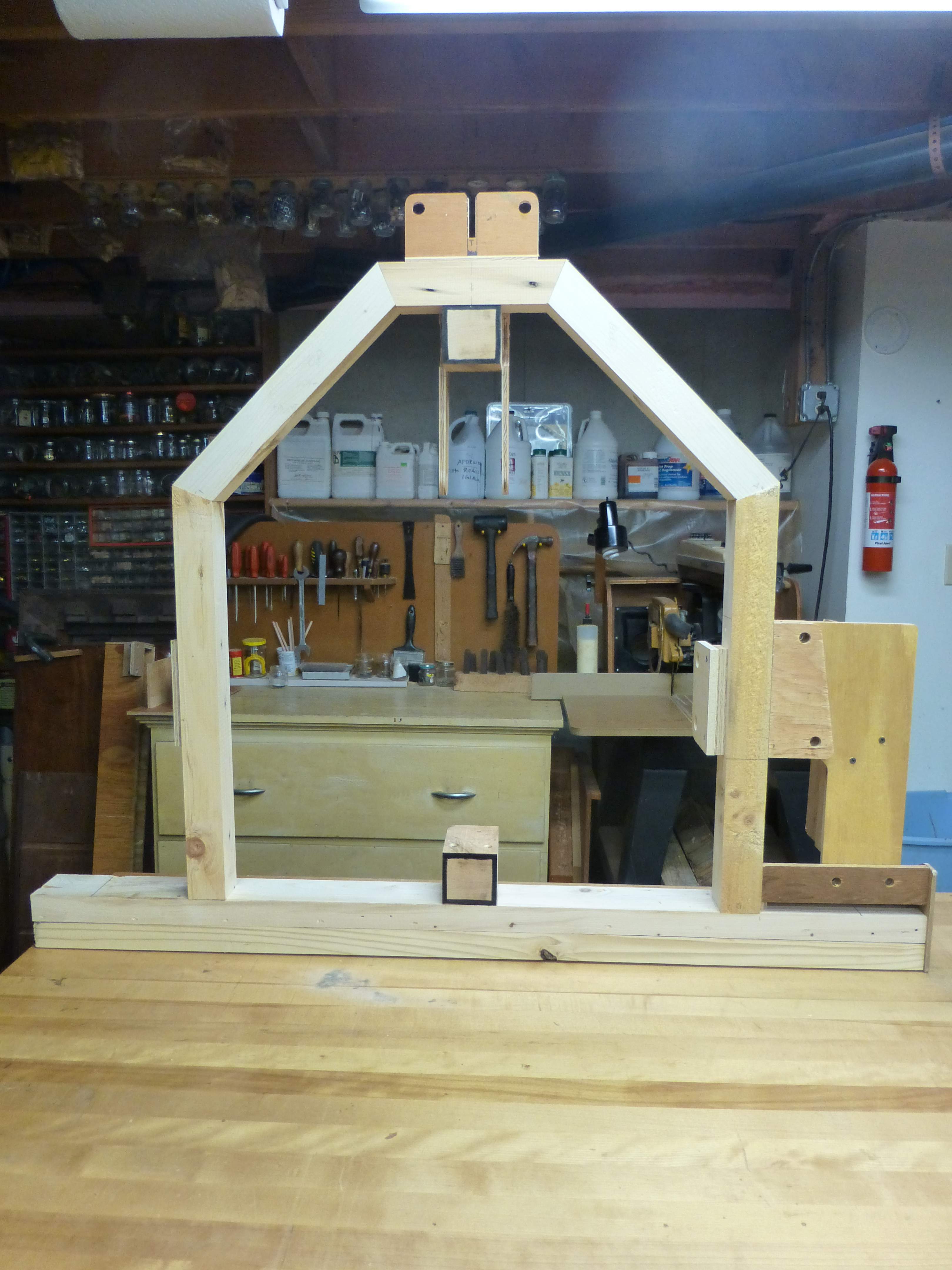

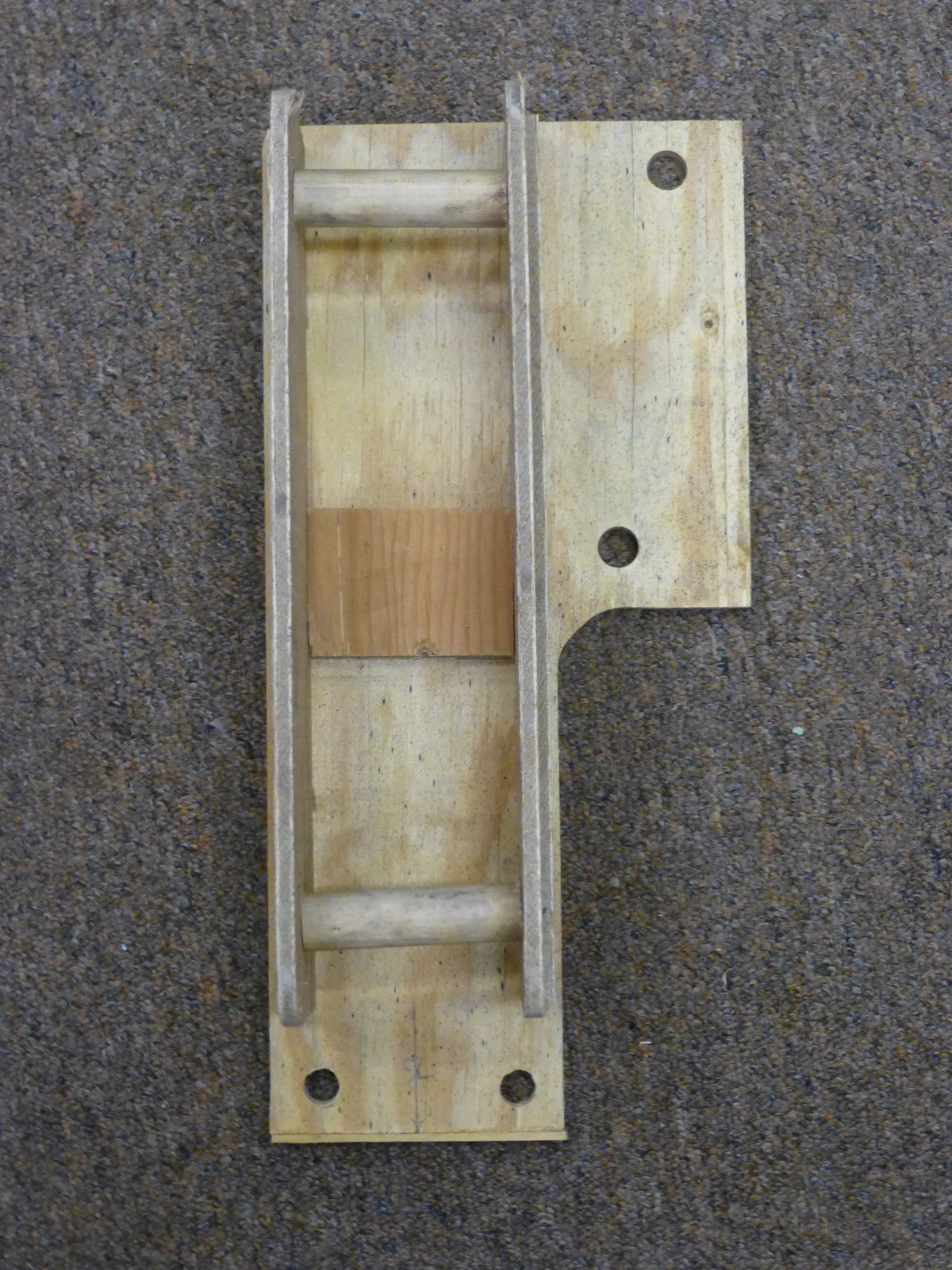

I decided to make a full scale model of this attachment
out out of scrap lumber. I'm really glad that I did. It allowed
me to see relationships (that I would not have other wise seen)
and make the corrections before sending this to the welder.
Being that I am not familiar with working with metal, I can use
some help in designing a way to mount the FEL brackets to the frame.
I am now using Creamer's fork design with square bottom rail and wrap
around c-clamp. See Post #137.
The upper frame is 2x2 tubular and the bottom rail is 3x3 tubular steel.
My goal is to make the FEL plates removable. They will add approx. 50lbs
to the attachment that I would like to be able to remove when not in use.
Sending 8 photos to give you an idea what it looks like
and what I thought may work?
Photo 1 is an overall front view showing the FEL mount on the right.
Photo 2 shows a close up view of the upper and lower welded mounts
and the FEL plate in place. These would be bolted together.
Photo 3 shows the 3x3 with a welded end plate on the outside. An angle iron is then welded
between this plate and the 2x2 tubular frame upright. This is the bottom support
for the FEL plate. Note that the angle iron is supended above the
3x3 rail. This space will allow the fork c-frame to be inserted and mounted in this outside
area. This will allow for complete adjustability from the center hitch receiver, all the way to
the outer welded end plates-minus the 2" space taken by the frame uprights.
Photo 4 shows a side view of the 3x3 end plate. and the FEL bracket, above it.
Photo 5 shows the lower link mounting plate that I modified to create a channel
where the FEL plate is inserted into the channel.
Photos 6&7 are of the FEL brackets welded to the mounting plate.
Photo 8 is a close up of the lower angle iron mount and the space for the c-clamp
to fit into. Note the verticle steel welded to the 2x2 upright as well as the 3x3 rail.
This may add strenght to the frame and rail design/torsion?
Well, there it is. Feel free to completely re-engineer.:thumbsup:

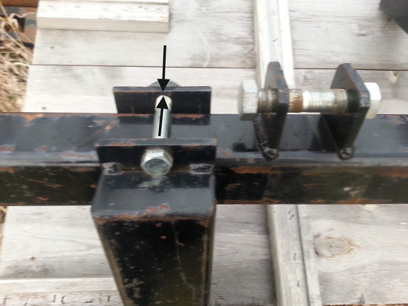

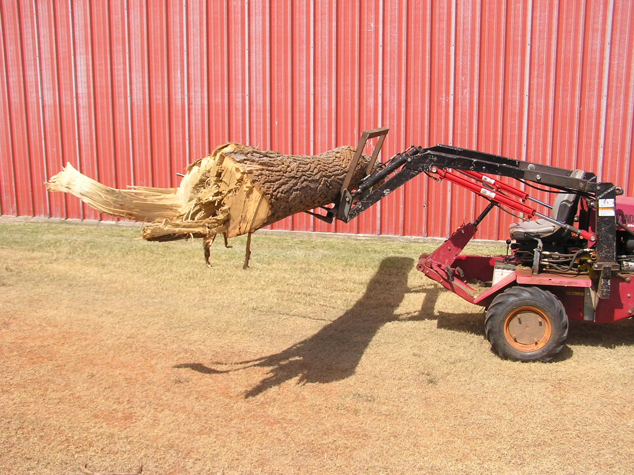

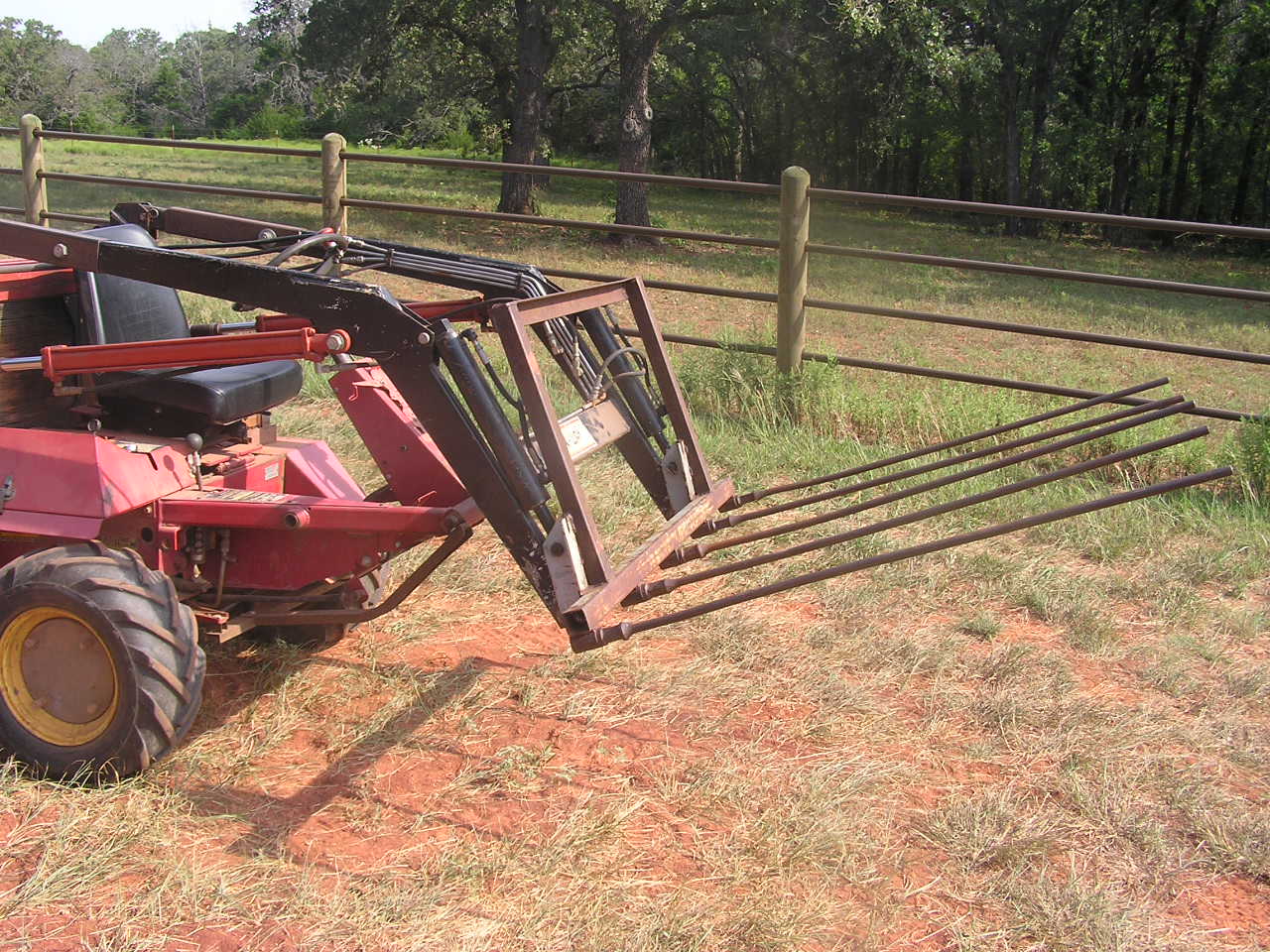

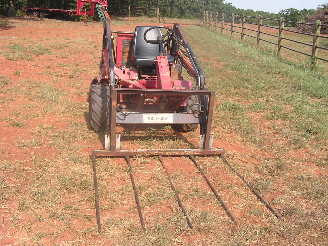

I like your full scale model. :thumbsup:
The wraparound c-clamp looks like it needs a longer wrap, the hole is too close to the edge. The bolt could tear out with a lot of weight on the tip of the fork.
Make sure the fork frame will go low enough, his lift arm bolt/pin looks too low, unless your 3 point arms will touch the ground fully lowered.
2D edge distance is a good rule of thumb. That is 2 times the hole diameter measured from the hole center to the edge of the material.

xfaxman and dragoneggs-
Thanks for the information.
Do you think the design for mounting the FEL brackets will work?

My B7800 has a pin on bucket. I am making a set of forks that will attach to both the
3ph and the FEL.
What I now need to do is mount the FEL brackets onto
the frame. I want to bolt the brackets on so I can remove them when
not in use.
The photos of the wooden model shows the frame mounts and the
FEL brackets that need to fit together.
My question is, will these brackets (see model) work?
Are they strong enough, or is there a better way to mount them?
Thanks again-

I know you are making forks, I edited my post. Seeing the pin on brackets confused me.
The brackets should work.
A gusset where I added the arrow would help make it stronger.

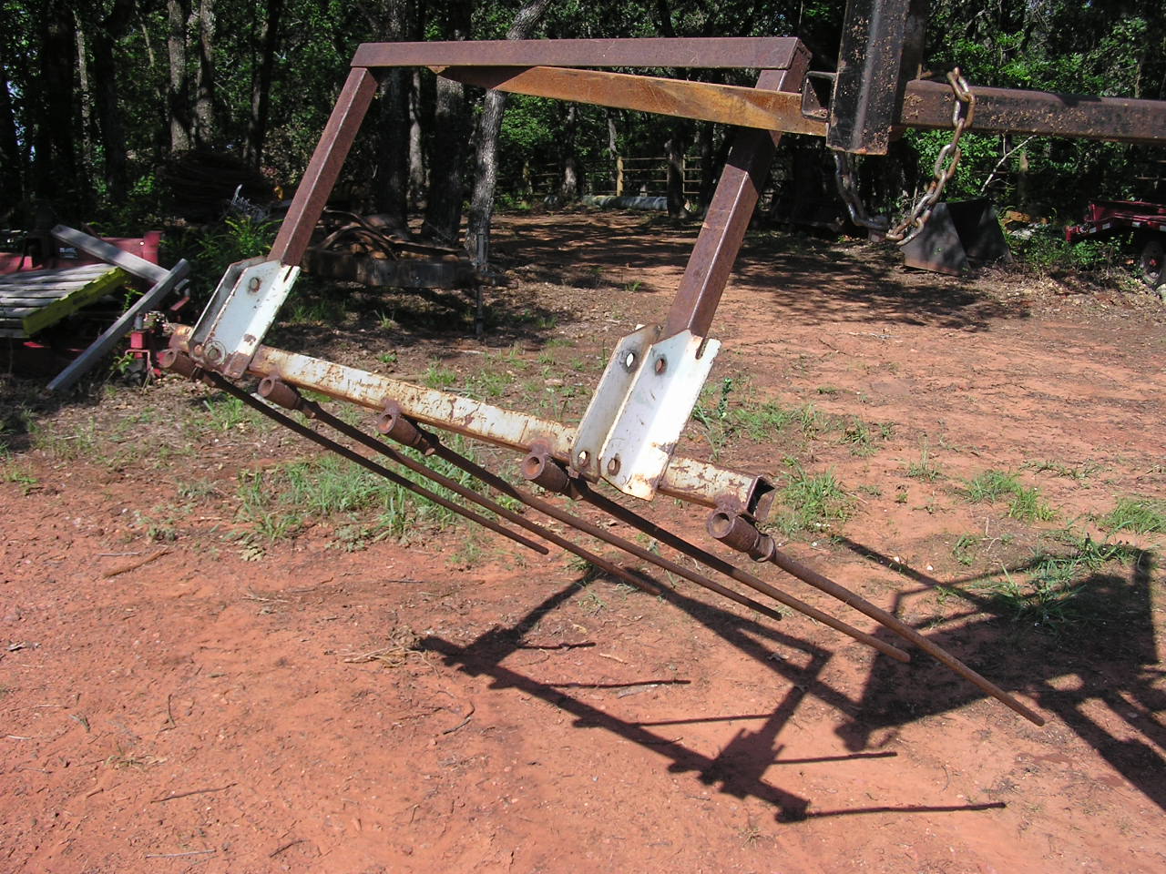

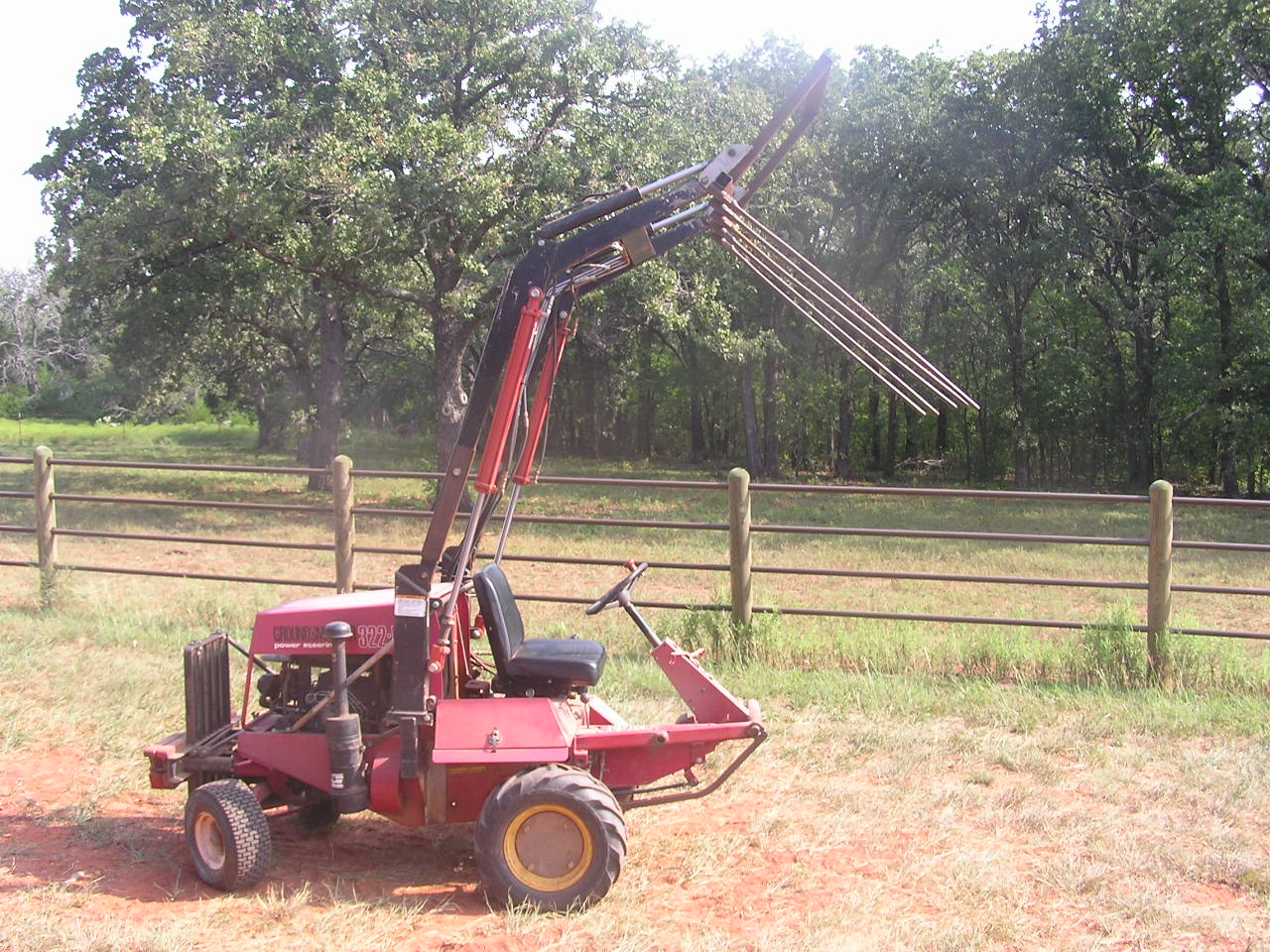

Have you checked the rollback angle? I noticed the pins are straight up and down.
When I made my pin on brush fork, I angled the angle iron mounts and offset the holes to get enough rollback on the ends. Also note the chain slots, very handy.

In the video, starting at 40 seconds you can see the offset holes on the grapple. Then look at the bucket, it doesn't have near as much rollback.
Without rollback, driving downhill stuff will fall off of the forks. :eek: :thumbdown:

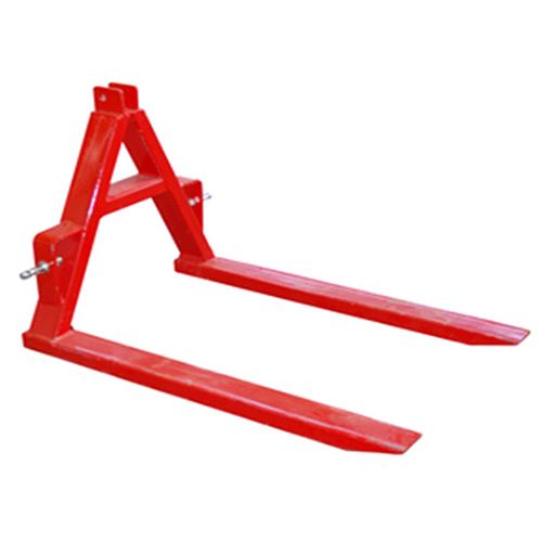

With that quick coupler, I recommend building the frame wide like my brush fork frame and add one permanent crossmember for the 3 point lift arms. It would be stronger and lighter than your removable brackets. You can use flat plate for the pin holes, like is shown in the video, not angle iron like I used.
Here it is back in 2009 with a cottonwood log that weighed 805 pounds.
/ Question about steel strength?? #179
Let me clarify that previous post. I mean use Creamer's fork design with square bottom rail and wrap around c-clamp, but the width would match your loader arms. The FEL mounting brackets would look just like you bucket mounts, but offset if you need more rollback.
You can find someplace in or on the frame for chain slots. :thumbsup:

Xfaxman - I get a kick out of seeing the old Toro lawnmower turned into a loader. I will bet it is handy though. It seems like you are a little close to the action though - maybe a little in the dirt? I like the brush fork concept. Very simple and I will bet useful.
