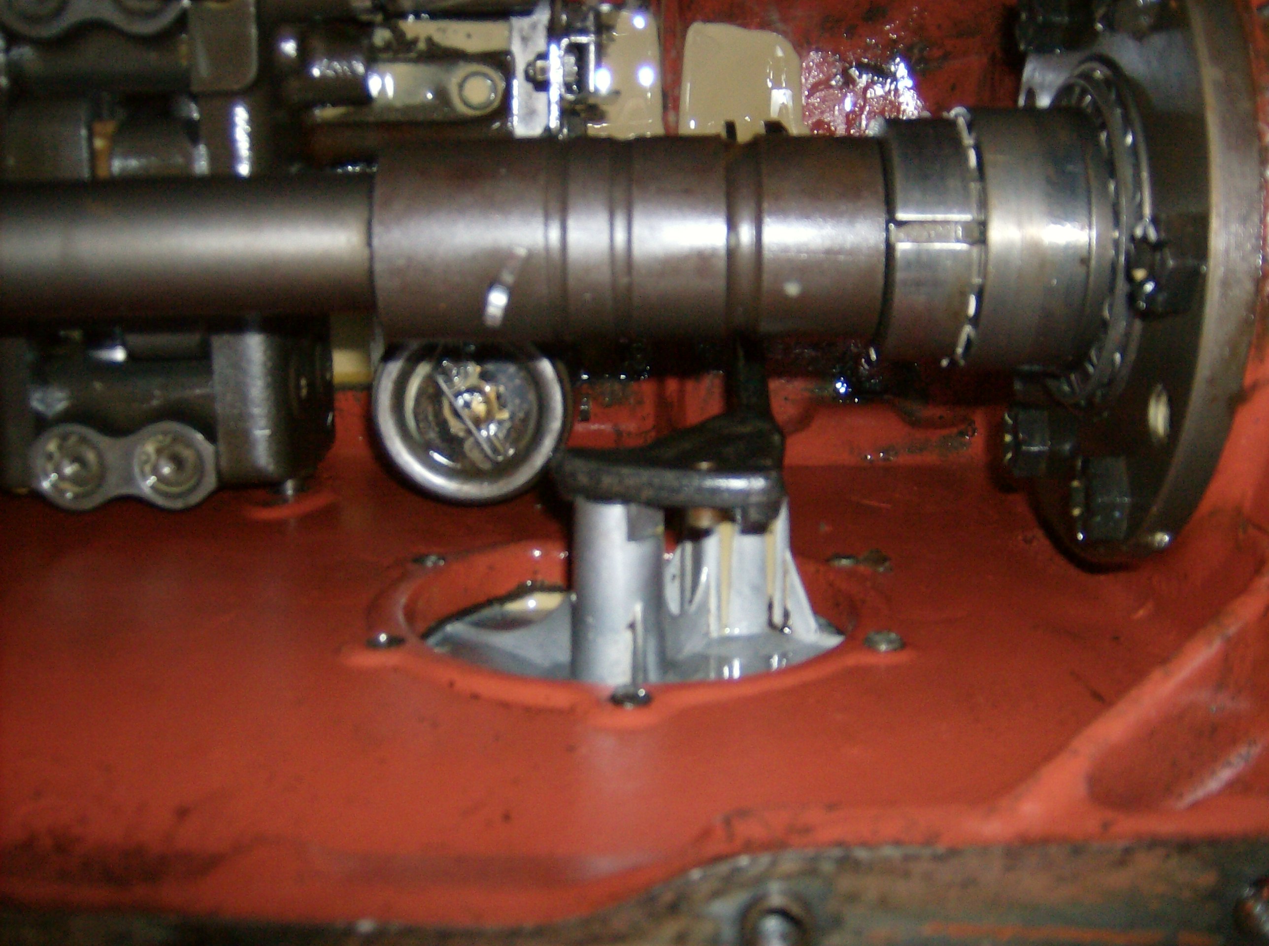

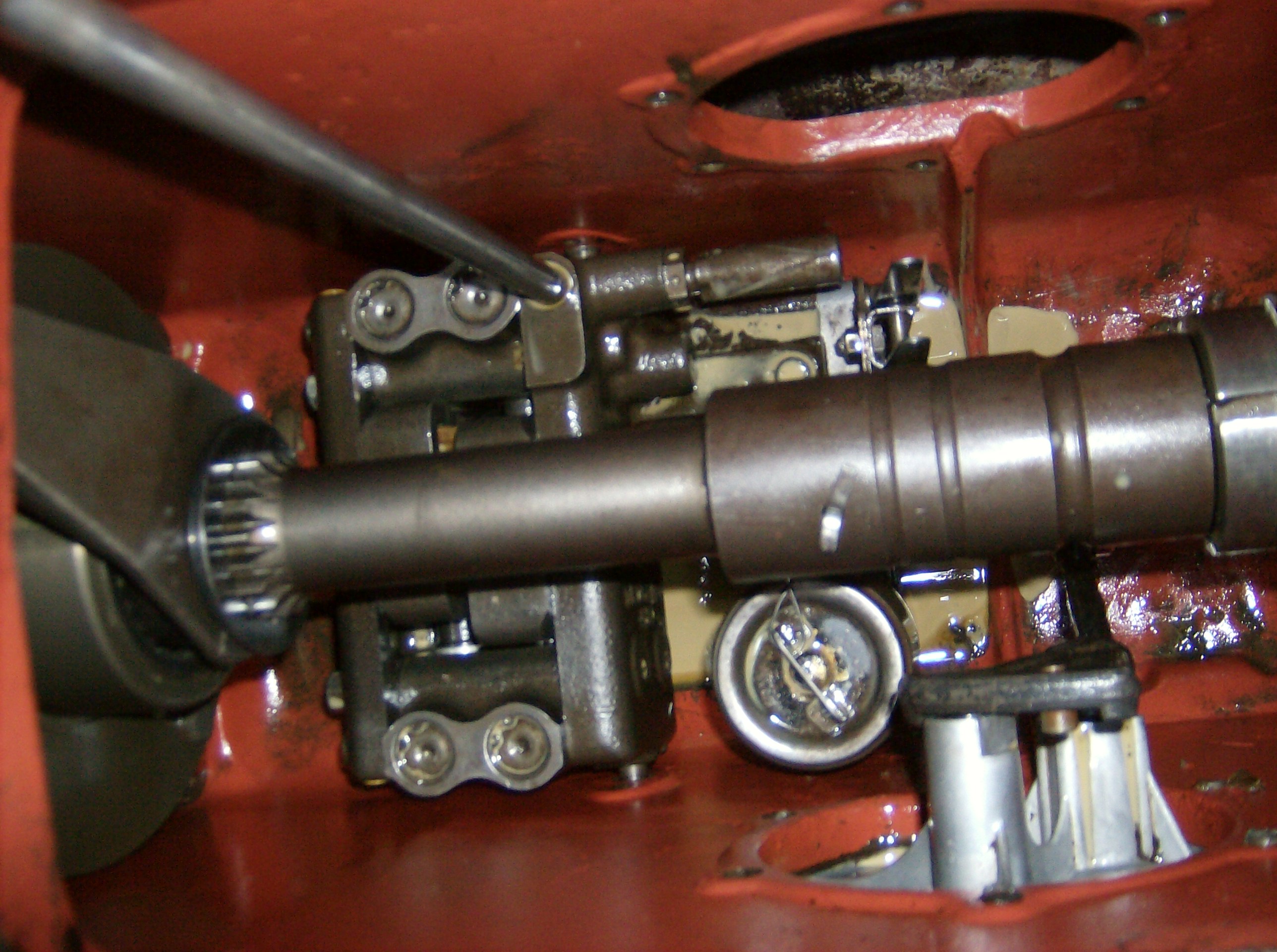

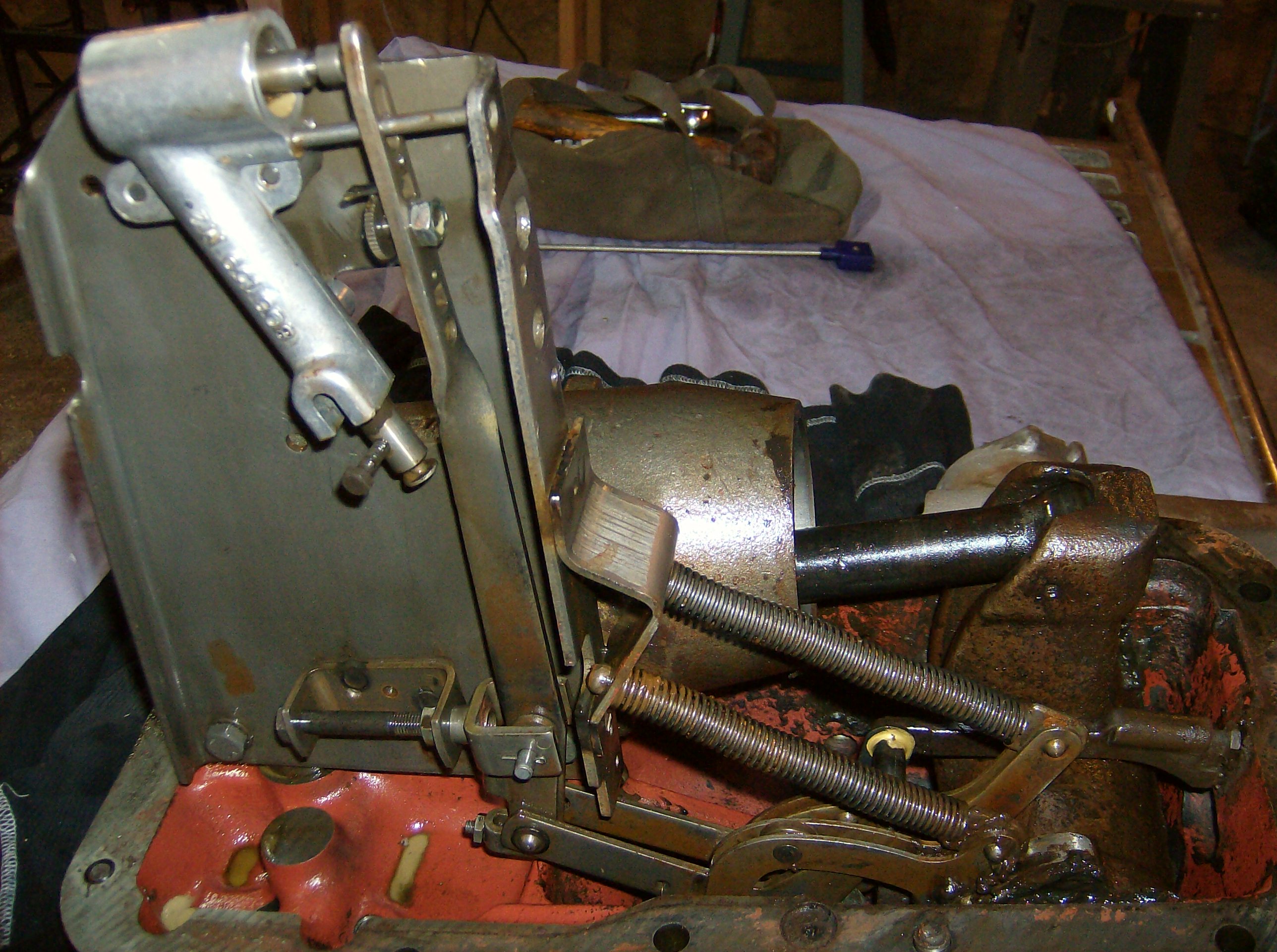

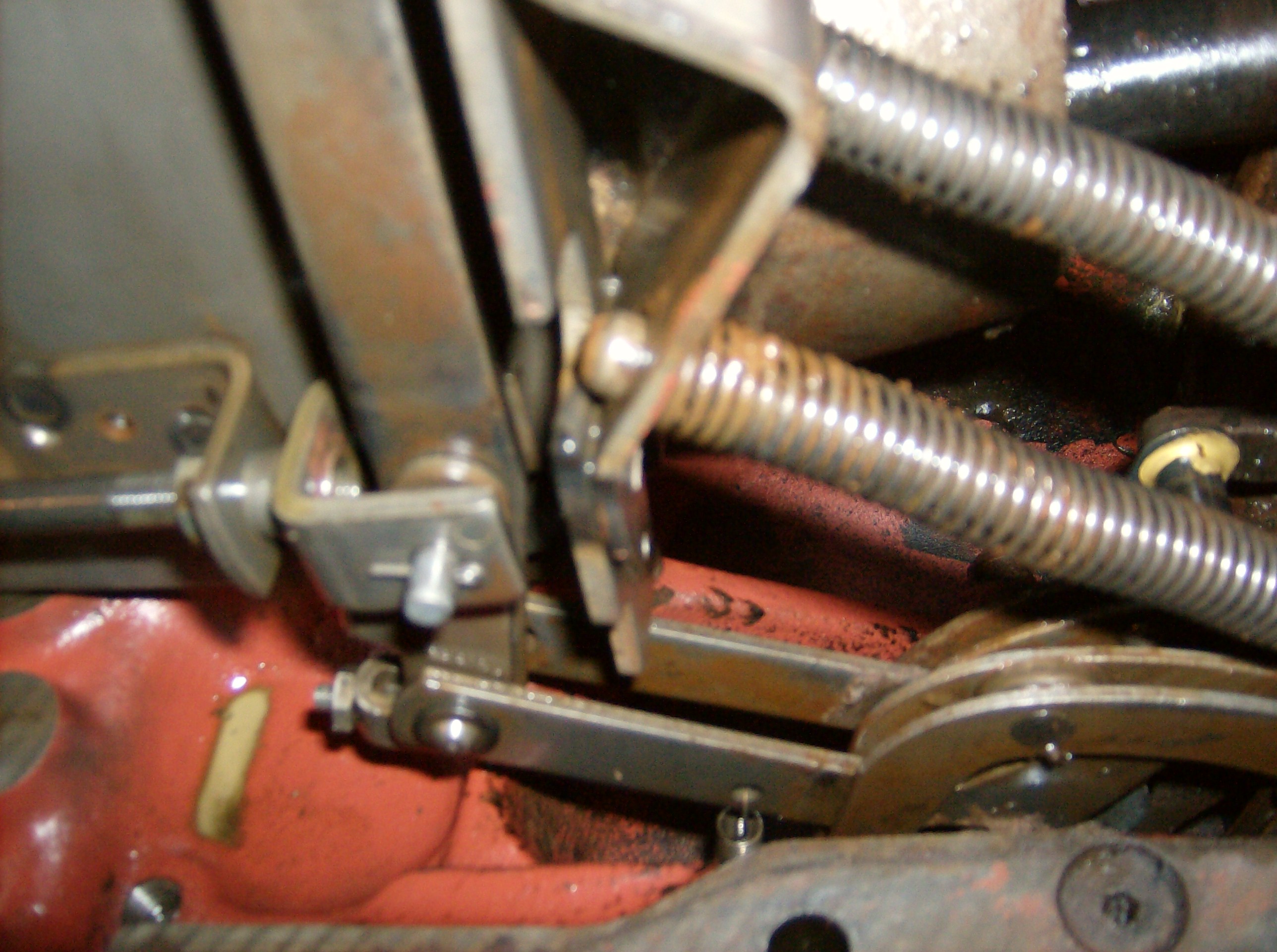

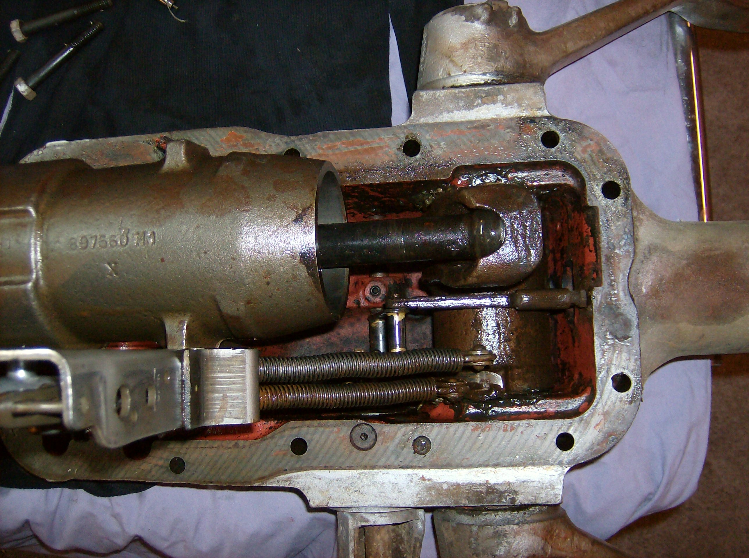

I don't know if the TO 35 would be much different from my 66 135. Mine was acting similar to what you're describing shortly after I bought it. Hyd fluid was so full of water it looked like a caramel milkshake, it was a wonder I didn't burn the pump out of it. Changed the fluid, opened it up to make sure the ring on the lift cylinder etc was still in good shape. Have had to rig the linkages for better response this past year and change the upper link spring but it's working great.
A few pics of what mine looked like tore apart.

Also, when looking through your side cover, the standpipe (upper left photo, running from the pump to the upper left corner of the photo) that comes from the pump up to the aux block on mine has o-rings on either end.
I've had to replace the top o-ring (took the block off, curiosity got the better of me and when checking it after re-installing, fluid sprayed everywhere :eek:, looked like a shower when looking in through the side cover). Surprising how little it takes to lose pressure when the pump only delivers 4.5 gpm. Fortunately you can change them without removing the top cover, that weighs a ton......

............Fortunately you can change them without removing the top cover, that weighs a ton......
That thought went through my mid when I saw the pics. Did you have a tranny lift to get it up?
   / Question about TO-35... #7
No, unfortunately not. A good friend who like me belongs to the strong back / weak mind club.....
Was glad to have taken the opportunity to take a good look at everything, gives me confidence. I sure wouldn't do it solely out of curiosity, like you said, three days work.
