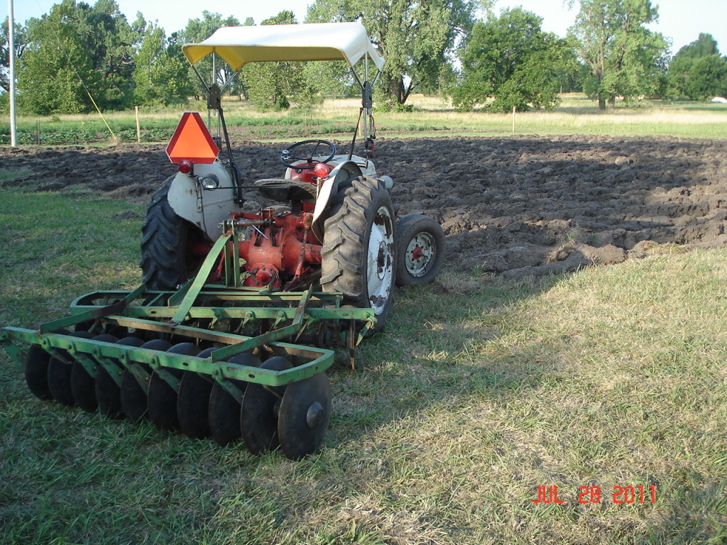

i have a 8n ford and i am using a disc to plow my food plots, can't get the back set of disc to cut and i have the top link turned out, maybe i need a weight on the back of the disc? any suggestions

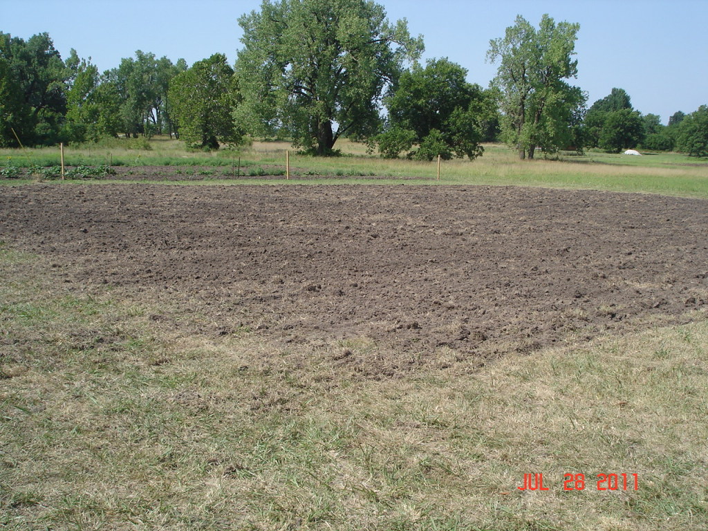

If your ground is like ours around here, it's mighty dry. The disc probably won't cut much or very deep. I plowed 2 days after 1.5" rain, disced the next day. Cut like butter, the wads and clods practically exploded. This was on sod that was sprayed with generic Round-up 2 weeks prior. Very little dust was kicked up. My disc is 1/2 of a JD KBA that's been channeled to about 6'. I can adjust the angles by pivoting one side of the 3 point to 3 different positions. Normally set so it's level front to back. When it's lifted, the front end is pretty light. Steering is done by brakes, mostly. You can see how good it worked the ground in the second picture. I was waiting for some rain to plow, and work up this plot. It's going to be another market patch for next year.
