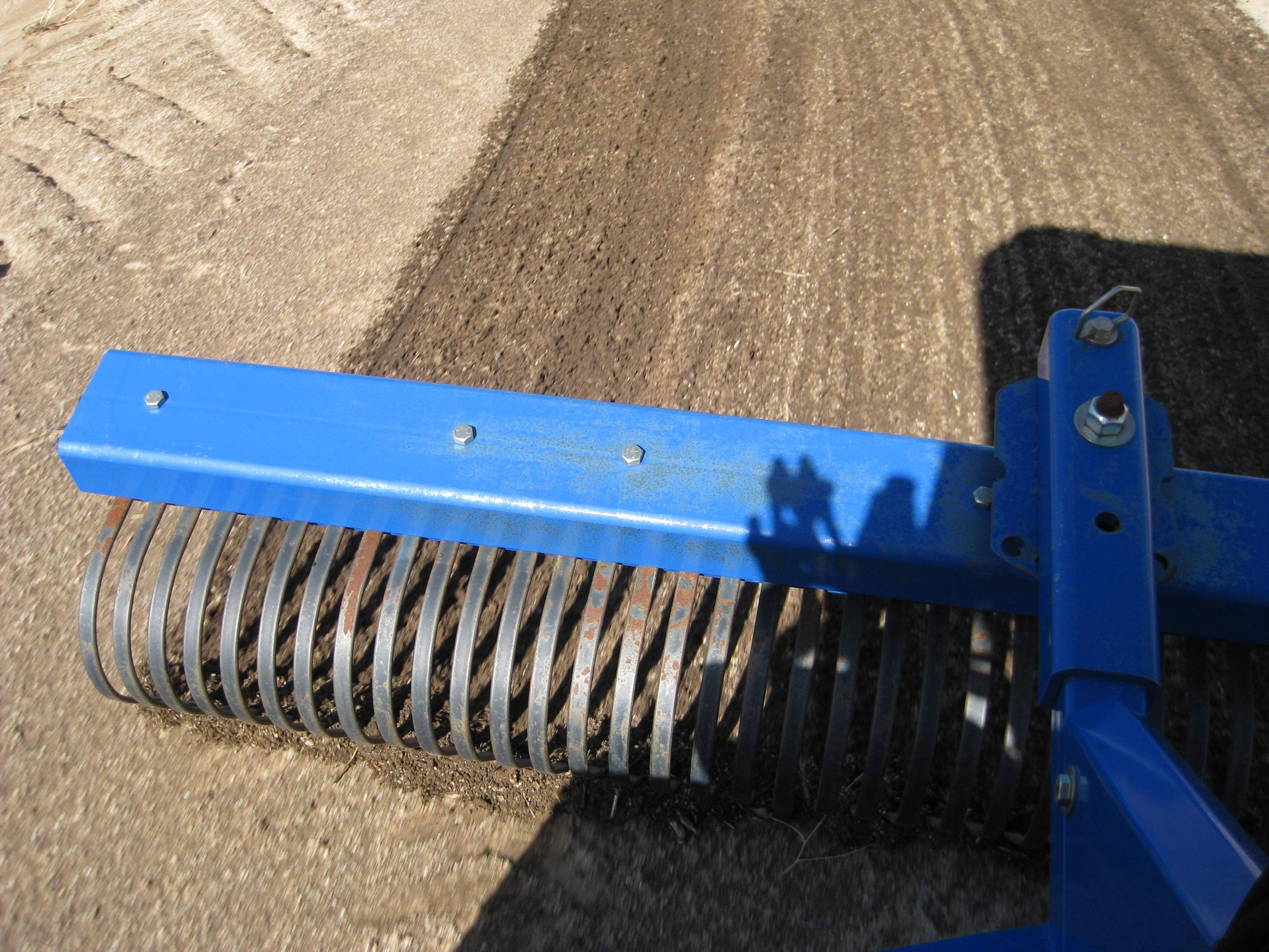

I have a KK landscape rake and I noticed that you can turn 180 degrees. What would be the purpose of doing that?

I use mine turned around for smoothing. This way you don't collect much material. ;)

I like that. I wonder if that would work well on a limestone driveway. When I use it on the driveway the regular way, it picks up the too many stones.
I use mine in turned around for smoothing. This way you don't collect much material. ;)

Going forward with rake in reverse you can shallowly cover seed beds, especially wildlife food plots.
Sometimes a LR works better pushing yard debris into piles when reversed and the tractor is operating in reverse.

I run in reverse when I do not wish to drive over piles. Especially piles that could puncture tires, namely old boards complete with nails poking out.
Yes it will indeed,that's how i smooth mine after boxblading the holes out and then using the rake to crown.

That's how we smooth and level gravel with our ROBB too, run forward with the blade facing backwards, it's like using a spatula to smooth out frosting on a cake.
In fact, I'm looking around on EBay for a new shorter top link to make it tilt forward even more and allow it to smooth more and transport even less stone from one place to another.

3pt hitch landscape rake = hand held metal garden rake, but up sized for a tractor.
the springy-ness (if that is a word) of the tines that make up a 3pt hitch landscape rake. allows them normally to be pulled forward, and allow each tine to kinda hip/hop skip across the ground, if it is to hard to dig in. at same time let material (dirt / soil) flow through the tines.
when ya turn the 3pt hitch landscape rack backwards, and drive forward, it is like turn a hand held metal garden rake upside down. to smooth stuff out. the tines are not digging in, but rather sliding across the ground to help smooth / level out the dirt/soil.
adjusting the "top link" of 3pt hitch, can give different angles, much like you might adjust angles when using a hand held rake. to kinda feather out the dirt / rock or what not. TNT(top n tilt) for 3pt hitch really shines in this aspect.
do you have a garden with some various melons (grown in some hills)? break out the 3pt hitch landscape rake, in spring / early summer before the vines start growing out, and drive a few passes around the melons to rip out the weeds. without taking a bunch of dirt and moving it around.
