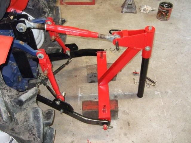

I haven't noticed if you stated your chains are running parallel to the lift arms or in an 'X' pattern? If you cross them you should eliminate a few more inches of free play...like in this attachment:
