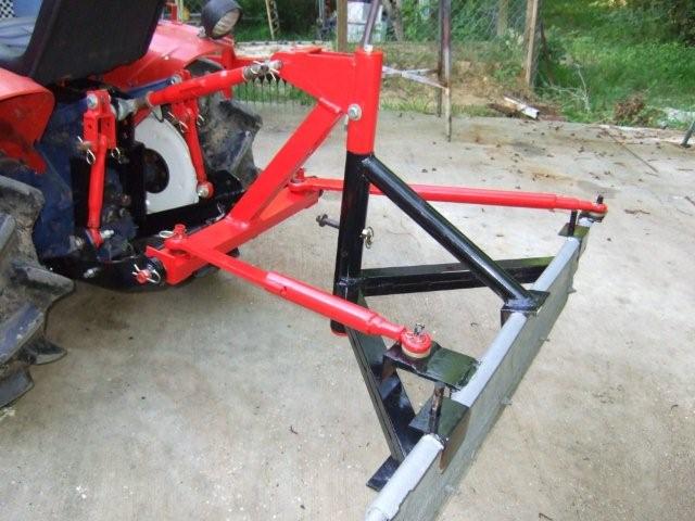

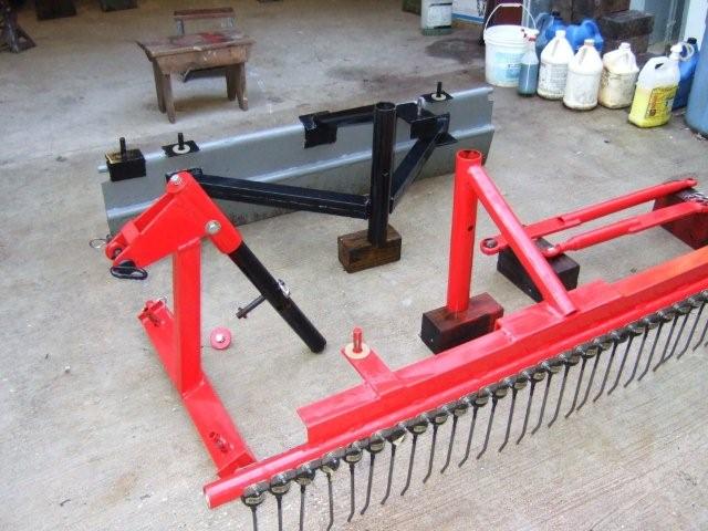

Alright Mark, I give up...what are we looking at in the picture? There has to be a function to that thing that I am missing.

Wayne...LOL, It does look completely ridiculous with out it's attachments. It's a 3PH adapter for a rake and back blade. The heavy wall tube and eccentric arms allow it to operate straight or at a 20° angle, for angle blading (or raking).
Mark
