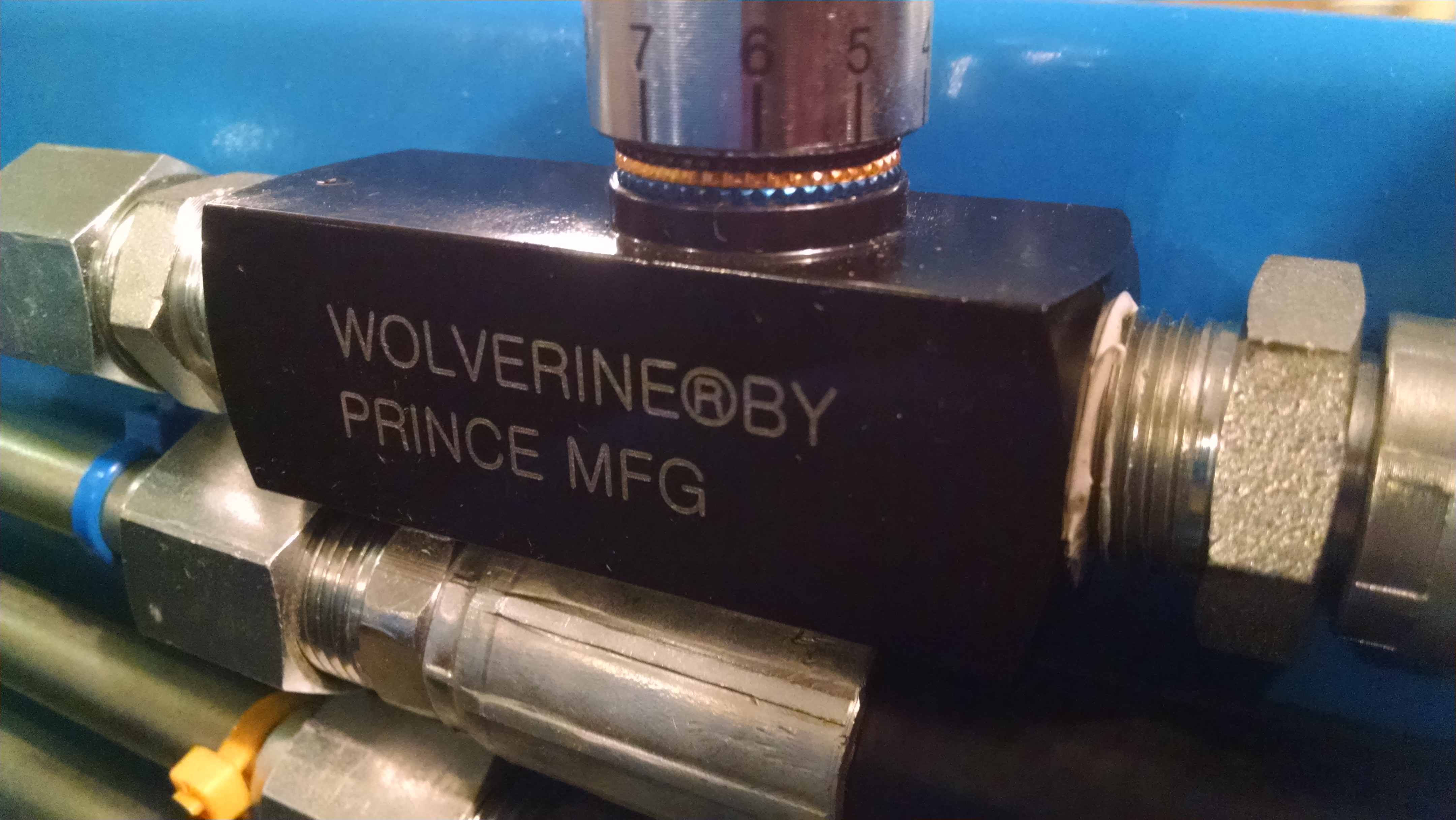

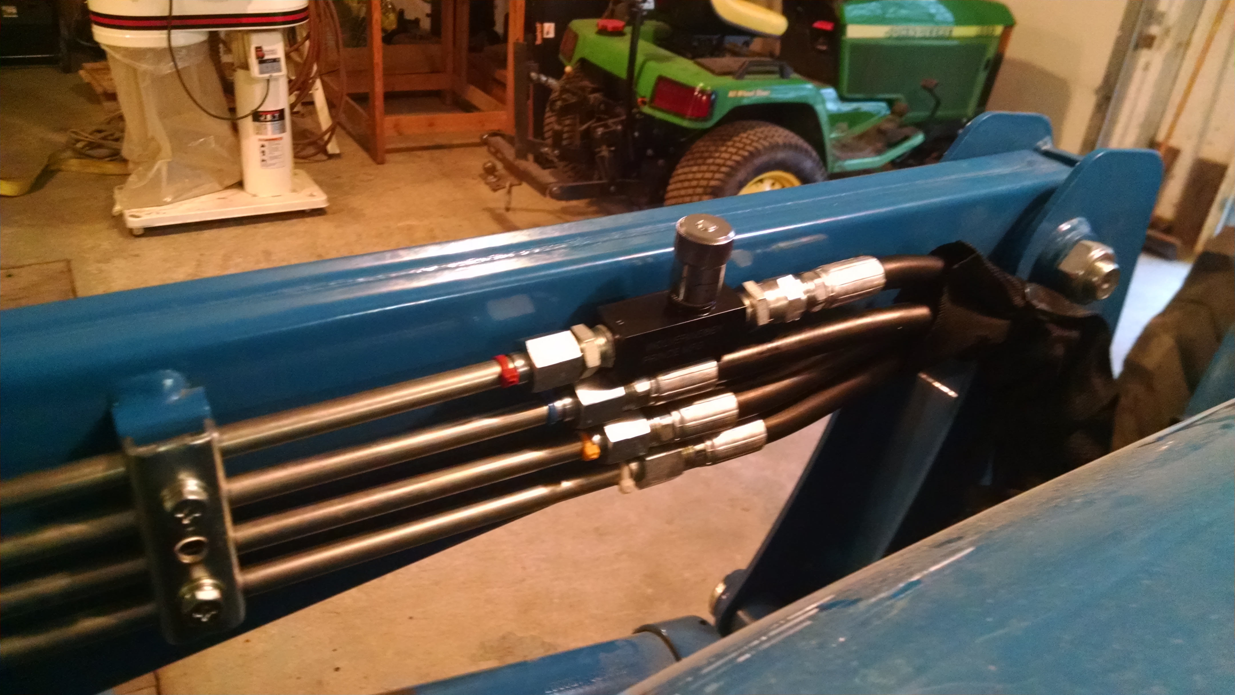

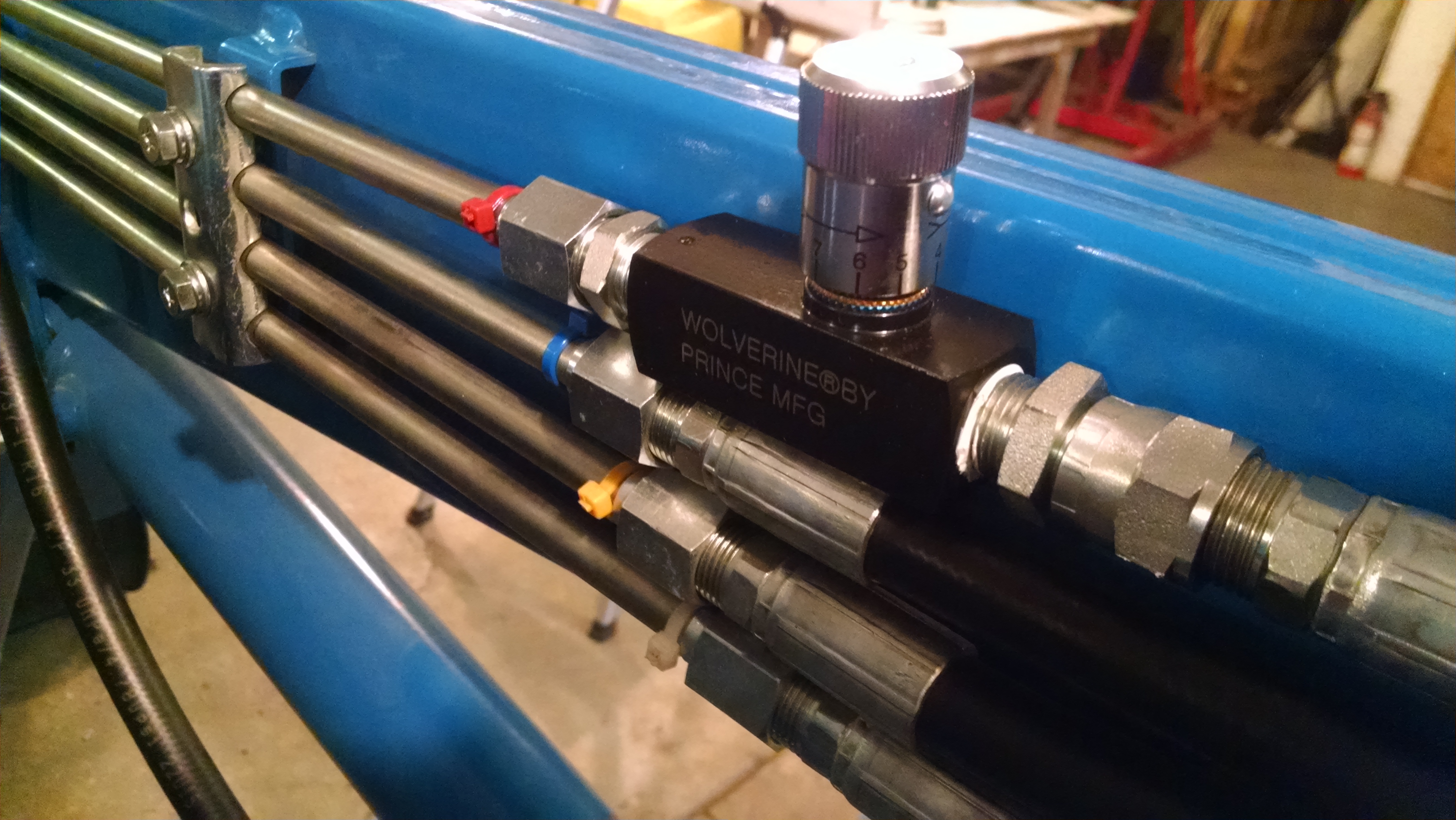

This is another great option. If there is enough clearance it sure would make adjustments easier. I had to crack the upper fitting loose when installing at the bulkhead / quick attach end to position the knob just right. Nice job!
   / question regarding loader control valve on my g3033 #32
I too modified the bucket circuit with the flow control valve modification. However, I mounted it on the loader arm so it is more accessible when switching from the light bucket to heavy grapple. You will end up with a slightly slower bucket dump to control the flop.
Here are the pix:
View attachment 465474 View attachment 465473 View attachment 465475
Thanks for all the great info and contributions to this thread!
I am still trying to understand the regenerative circuits and if there are other work-arounds to fix this.
