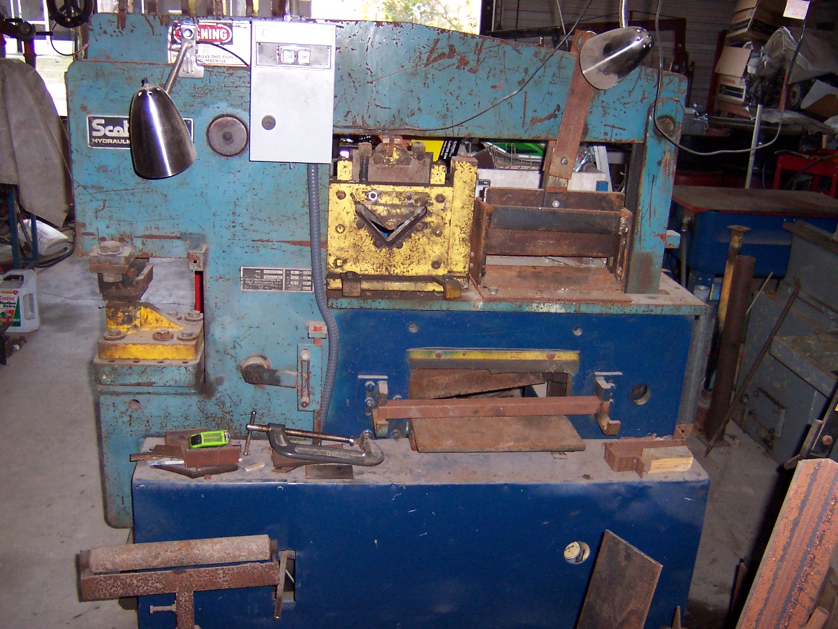

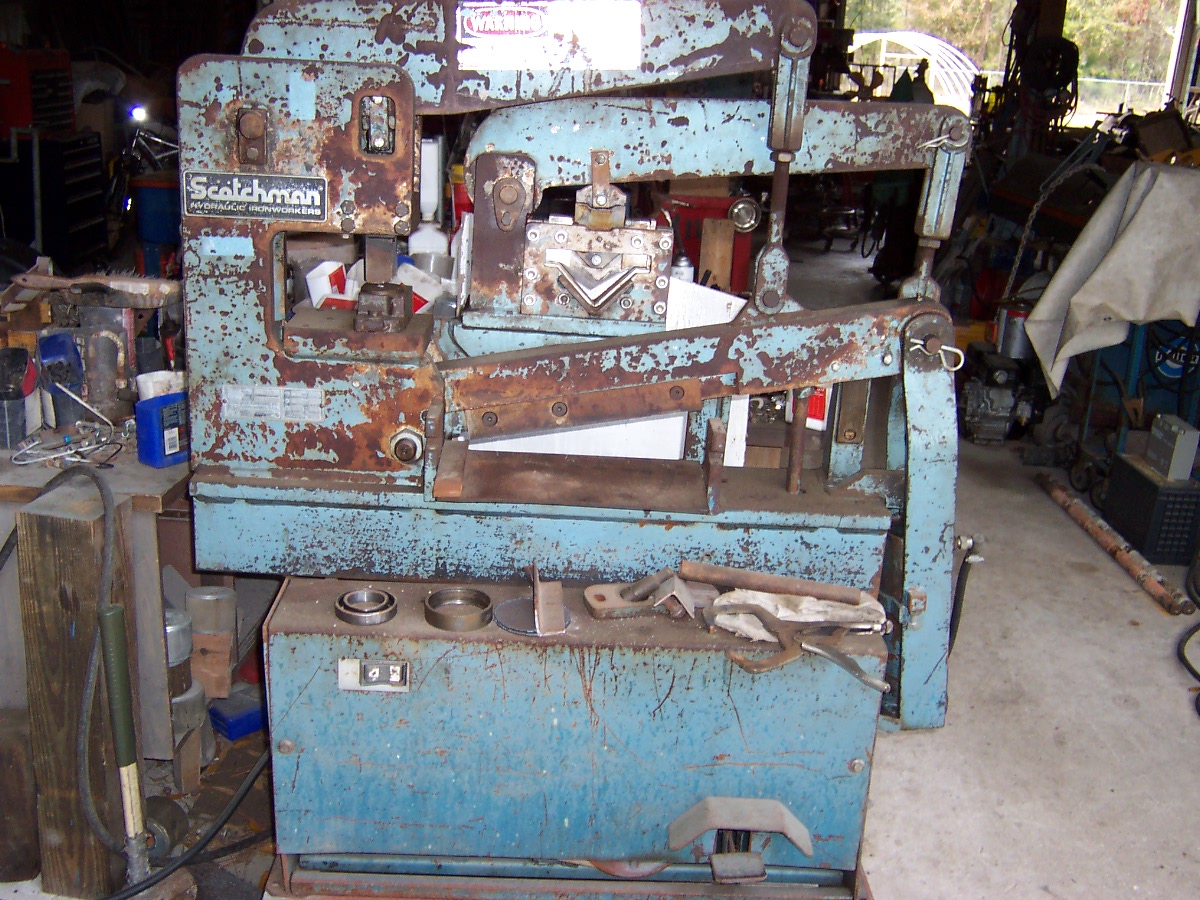

I have two Scotchman Ironworkers, a 1980 50 ton and a 1981 35 ton. I bought both used.
Both used Ironworkers and Unicorns come up for sale if you look long enough!
Mechanicals are SCARY Dangerous! Most of the older ones are illegal from an OSHA standpoint because they don't have proper guards and safety controls.
Both of my machines are 3 ph and I am running them on single phase with a "Static Converter" that I built for about $45. in parts from instructions on the internet. One converter for both machines and a 15 X 54 Cincinnati Hydrashift Lathe.
My 50 ton is rated for a 1 1/8" hole in 3/4" steel.
I know a guy with an Edwards and it has a pump wine that goes right through me! Also when he punches it has a loud BANG!
My Scotchman just go right through the metal like it's butter with no bang.
If you look on ebay there will be some listed and you can get an idea of what is out there price wise.
Northern Tool lists a couple entry level machines priced reasonably-
ironworker from Northern Tool + Equipment
They are worth every penny for a business and can even pay for their self on one or two jobs!!!
