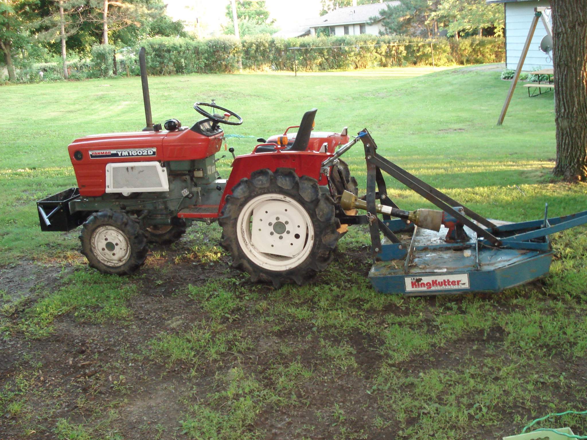

I guess My tractor has a hydraulic issue, I installed a bolt with tension spring and wing nut to the lever guide so's to provide a stopping point for the lever and lift, It now stops at the correct hight although after about 3 minutes the lift arms goes on all the way down, having to keep pulling the lever back up and starting over again and again, I have even tried putting the lift where it needs to be for the front of the cutter to stay off the ground and lock down the twist knob under the seat to try and hold it in place, but still it drops on down,:confused: I'm beginning to think this might had started back earlier this spring when plowing with the disk Harrows, The time when the lift got stuck in the up position and would not come back down through the lowering of the lever,:cool:

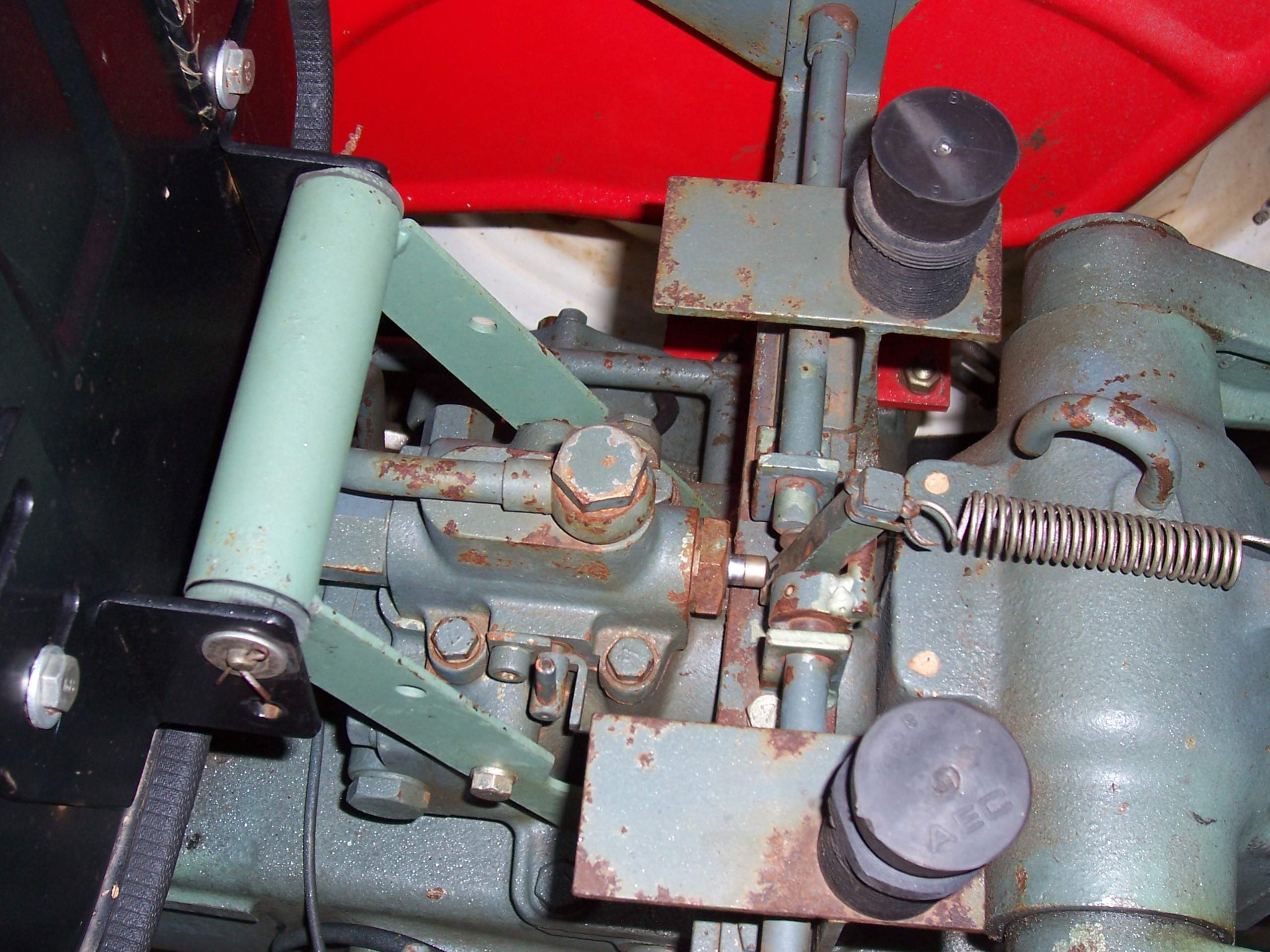

I my have found part of if not all the problem. I went ahead and drop the connecting pins down to the lower holes on the cutter, but yet still had same problem with the front sagging, I didn't really figure this would have help much,.... I began looking at something else I'd notice back when first purchased the tractor, and been curious as to what it was for and what perhaps could be missing? on the left hand side while sitting on the tractor just to the rear of the seat and close to the inside of the fender is a linkage that connects across to the up/down lever on the right hand side,
well at the left side of the upper lift arm there is a slot that this linkage slips into, this slot has a hole at the end that this linkage had dropped into which it is my belief has made the lift system become a Floating system... so I started playing around with this linkage and found that it can be pulled out of the hole and slip back into the slot and this allows the hydraulics to have increment stopping points, in other words now the lever will stop the implement at wherever I put the lever,
it does not fall on down,... However! there seems to look like a part of this linkage system missing? or either should be a spring in a hole that is on the end of this linkage..... does any of this make sense? and does anyone know what exactly might be missing?

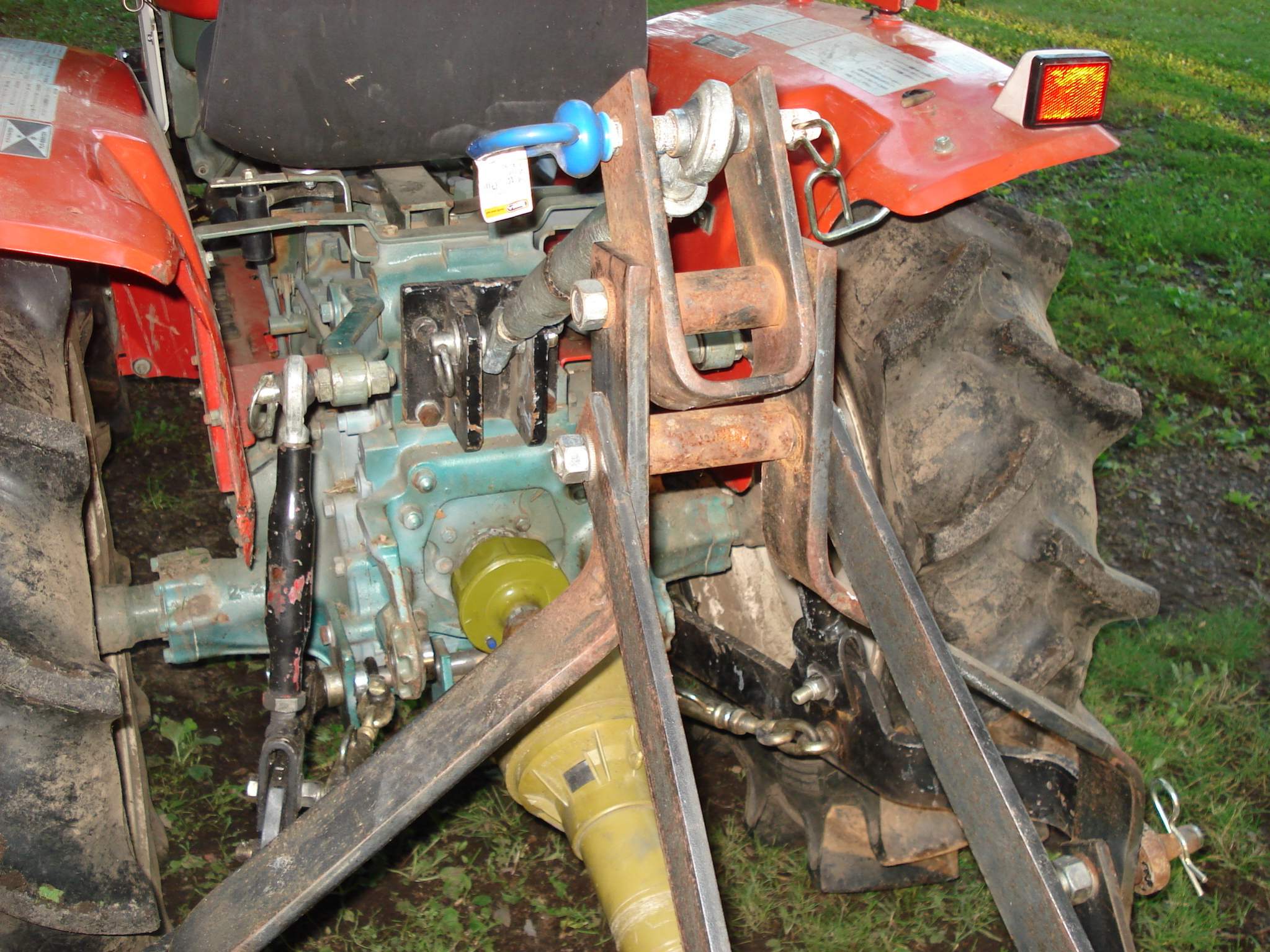

Deep I believe this is the same. I had alot of play in the shaft also and had to replace the spring to the linkage and snug it up. it's been like this since right after I bought it with no problems what so ever.

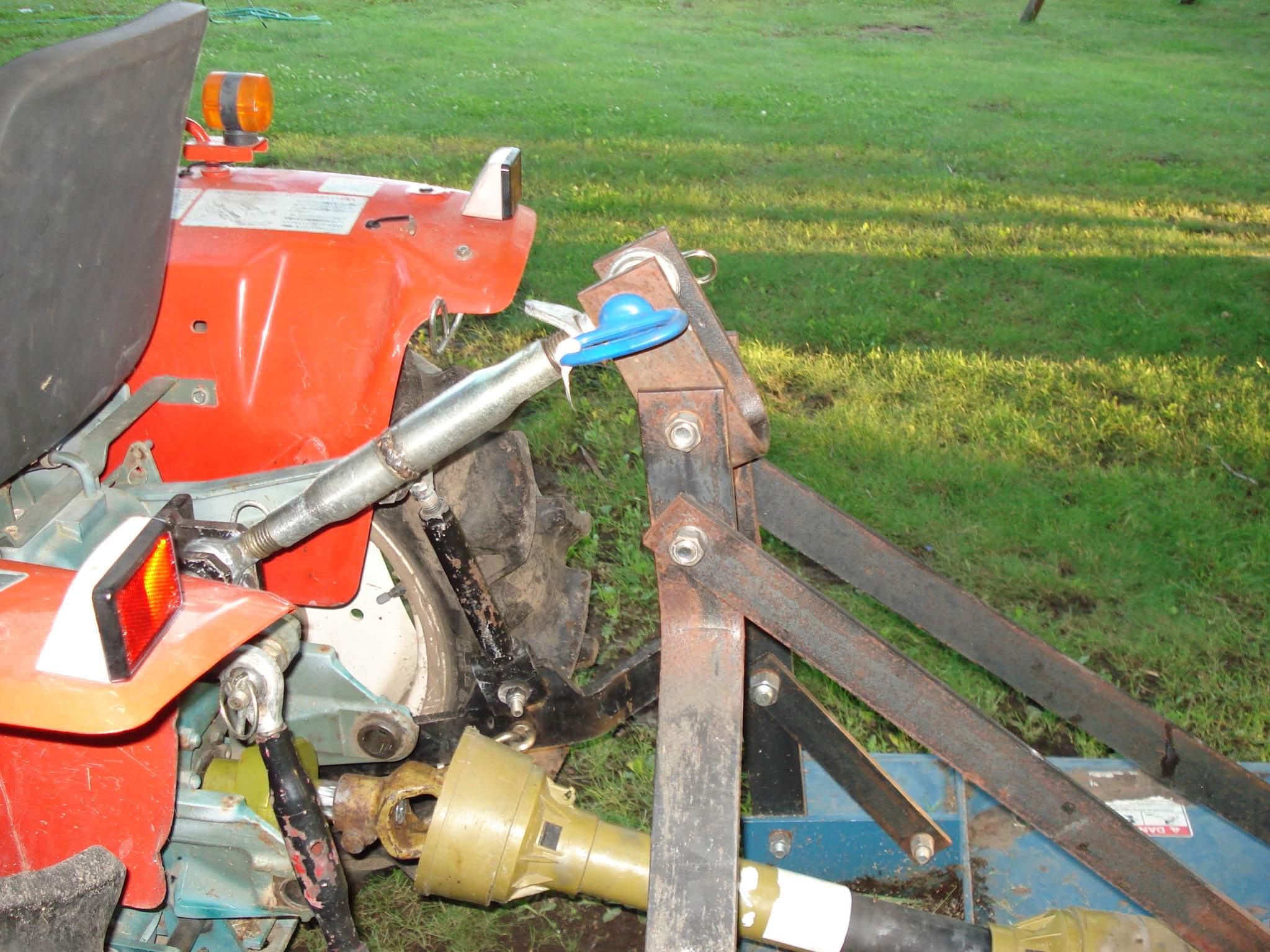

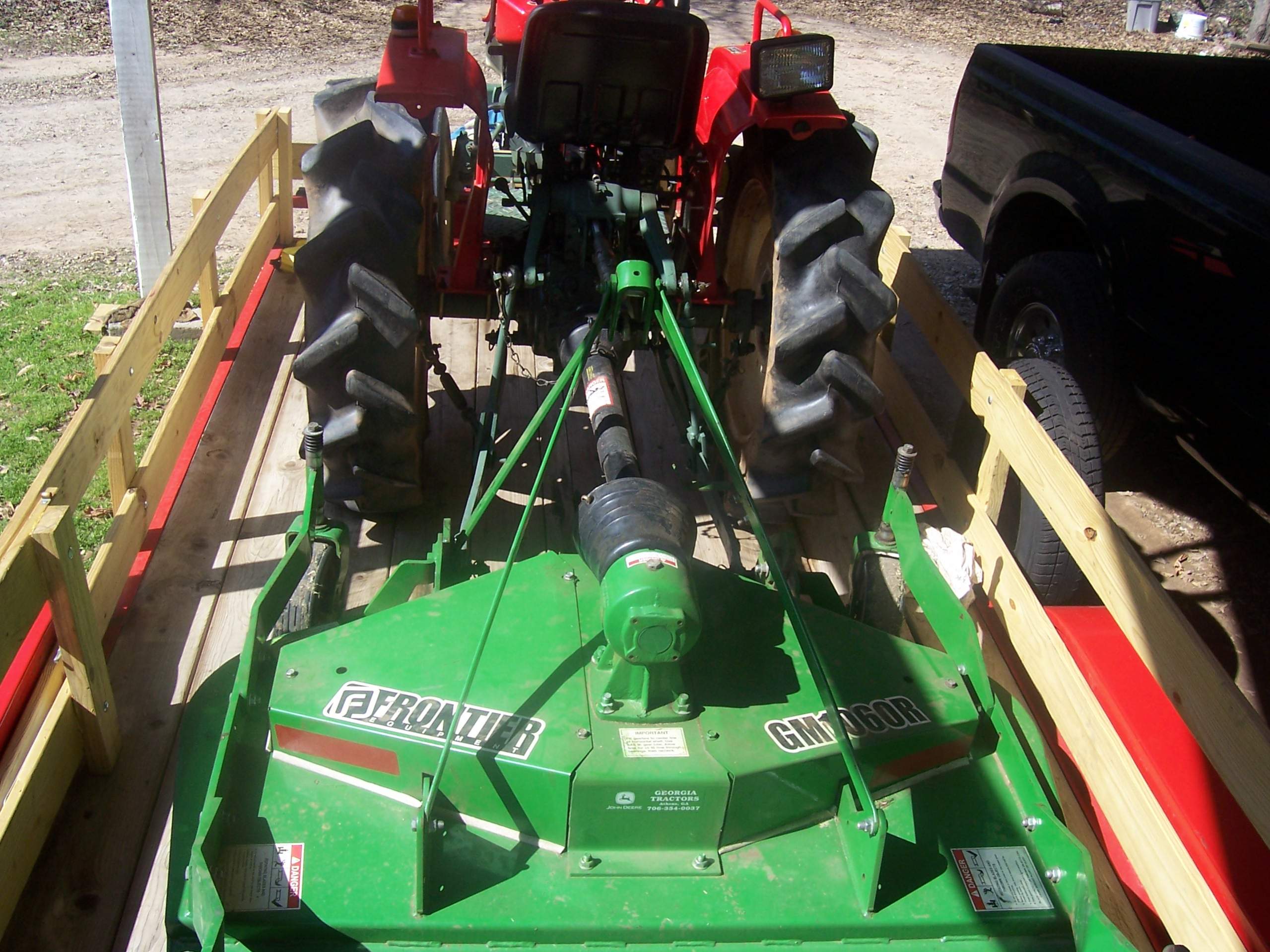

here is a few pictures of the part I am trying to describe, the red arrow shows the part with the slot and hole, and the blue arrow shows the part I have no idea what is suppose to connect here?
The position you see the rod in now will allow the lift lever to stick wherever I place it, although the way I found this linkage down in the end of the slot at the hole must allow the lever to kick back, in order to move it out from this placement it must be pulled and slipped over, there is a Tab & spring on the other side to keep tension on this linkage so's not to go back into the hole,
Yep looking from the top mine looks like that, except my linkage is at the other end of the slot. The under side i will have to look later.
Clemsonfor, While your looking could you please look and tell me what is missing on the linkage you seen with the Blue arrow points to in the picture?

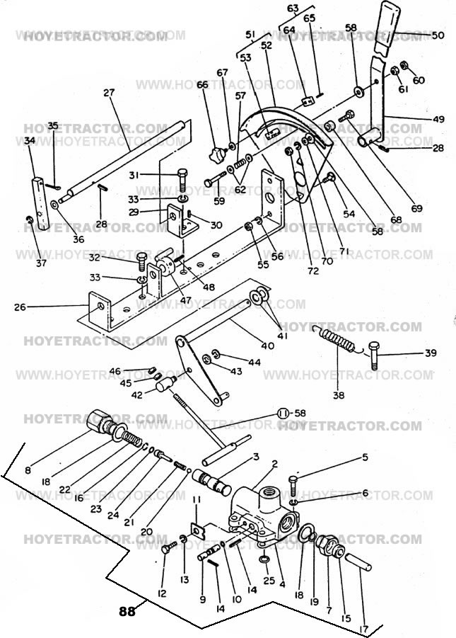

Here's an old thread about that mysterious linkage under the left of the seat.
http://www.tractorbynet.com/forums/yanmar/99395-unknown-part.html
And here's a diagram I put in that thread from the YM240 (YM2000) manual.
In summary I think the part bolted to the 3-point arm 'tells' the control valve that the arm has gone lower, so the valve opens and sends more fluid into the hydraulic cylinder. This should maintain the implement level even if the piston o-ring is in poor condition.
That thread was about YM2000 and I thought YM1700 would be the same. But there's no slot in YM2000 linkage. Does the slot look like it was added later?
