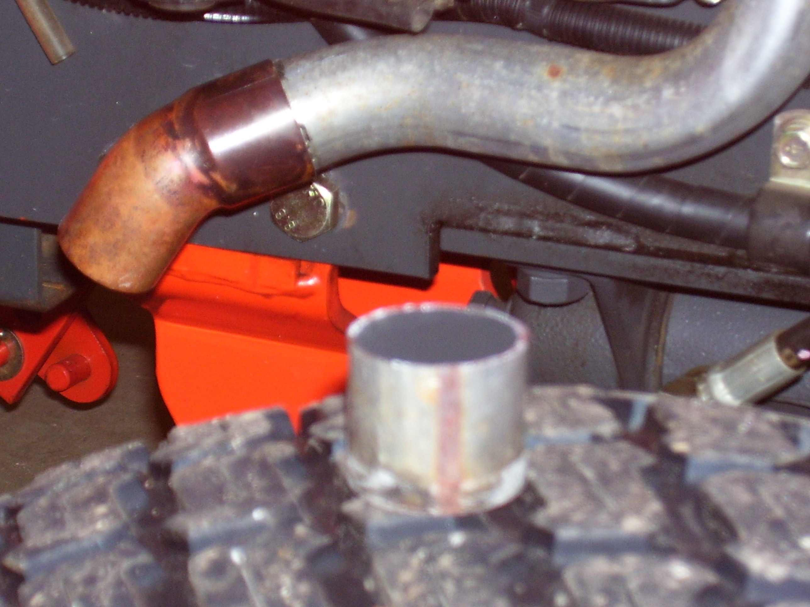

jim_wilson, I went to a plumbing supply house to purchase a piece of copper pipe fitting that I used on the exhaust of my B3030. I think it cost me about $10.00 a couple of years ago. I heated it with a propane torch while holding it with a pair of vice grips due to the heat then easily slipped it over the exhaust pipe. Once cooled it shrunk for an extremely tight. I had to trim the exhaust pipe first so the fitting (I believe a 45 degree STREET fitting) would be at the correct angle. Cheap easy fix! Not to hijack this thread but wanted to help jim_wilson. Stanley

Thanks guys. That helps. I'll check out Lowes or HD once I get the tractor and see what I can find.
