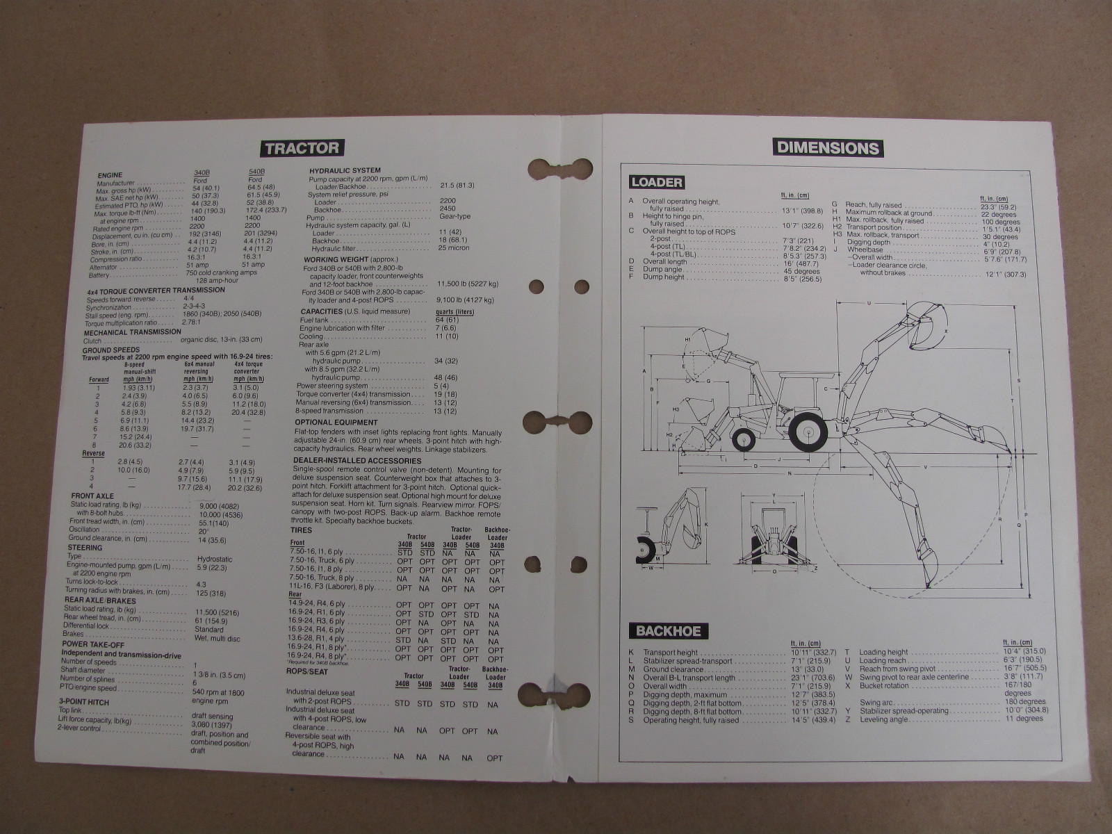

Do you have a manual for your tractor? From what I found, it was made between 1984-1987, and is an open center hydraulic system like most of ours, so adding the hydraulics would be pretty straight forward and not too expensive (I think my kit cost right around $700 give or take 50) (relative to a closed center system, although I don't have a good grasp on closed center systems).
It appears your loader has a 2,800lb lift capacity, and a WHOPPING 21.5gpm hydraulic flow??? :eek: If I'm reading that correctly, that is a LOT compared to almost all our tractors on here! You could probably even run low flow skidsteer implements off your FEL! Most of ours are somewhere between 8-12 with the utility tractors closer to 14-16gpm. I don't know if the 3rd function valve that I linked to, can accommodate that much flow? I seem to remember it being somewhere near 10gpm max. I imagine in this case you would certainly want a selector valve, as full flow to the grapple cylinder would slam it shut before you could even let off the button! :laughing:
With 2,800lb lift capacity (if you have the loader referenced in the below sales brochure) you shouldn't have a problem with bending/breaking a standard grapple. I wouldn't go with a light duty one like I have, but you don't need a monster that would take the abuse of 5k lb+ lift capacity either (or the associated cost to go along with it).
This may be a little too much information and make for a boring post to read, but I think a lot of people can benefit from the "basics" sometimes. I apologize if you already know all this info and had to read through my nonsense without learning anything you didn't already know. :D
Is this the tractor you have in the pics below? (I hope so, or forget everything I just said:laughing:)

Do you have a manual for your tractor? From what I found, it was made between 1984-1987, and is an open center hydraulic system like most of ours, so adding the hydraulics would be pretty straight forward and not too expensive . . .
Yes, I have the manual for my tractor, although I use TractorData for quick reference on the specs. The serial number of my tractor shows it to be a 1985 model.
Yes, 2,800 lb. is confirmed in my manual and by TractorData. Only for my general knowledge, what is the normal lift capacity of compact and newer utility tractors?
You know what they say, "Knowledge is power!" Seriously, thanks for taking the time to explain what I need to know about grapple hydraulics.:thumbsup:
View attachment 321484 View attachment 321485 View attachment 321486
Yes. It is my understanding that I have the factory installed model 745 loader.
