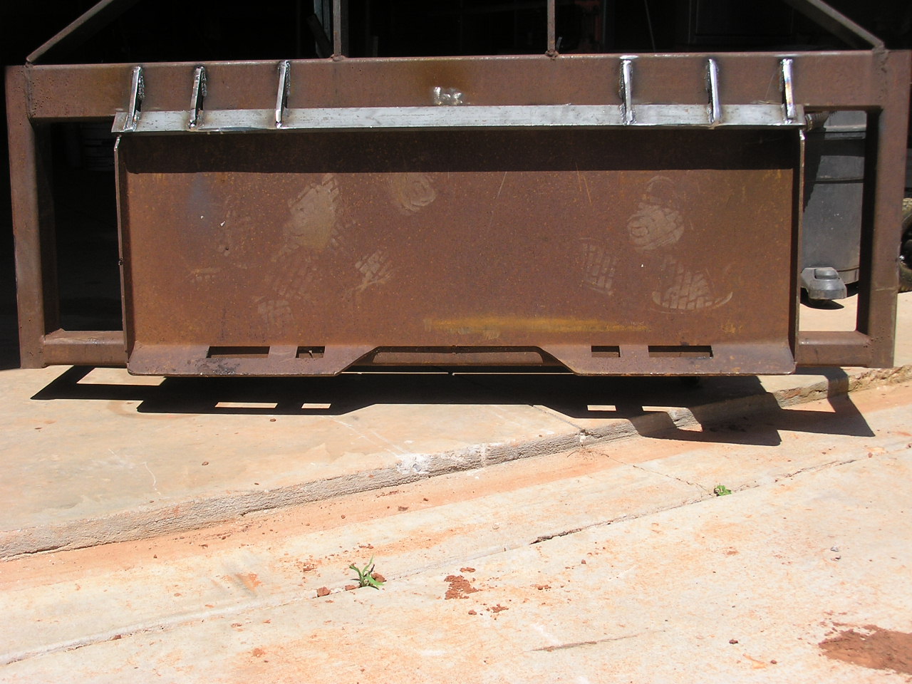

Couple of brackets and it'll fit.. I was thinking of a reenforcing bar across the tine tips like the others I see, but then I am in sandy soil (all right, sand).. Whatcha think?
   / Quick Attach and Grapple for Industrial Tractor\Loader?? #52
Don't think you need it. Try it first, you can always add it later if needed.

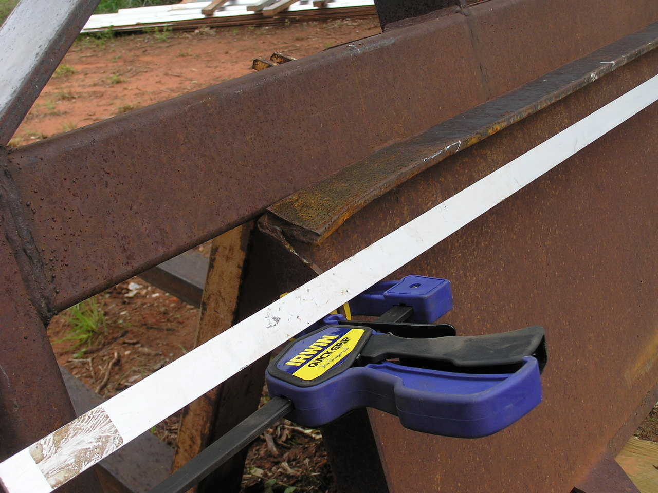

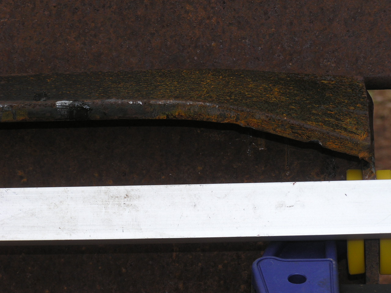

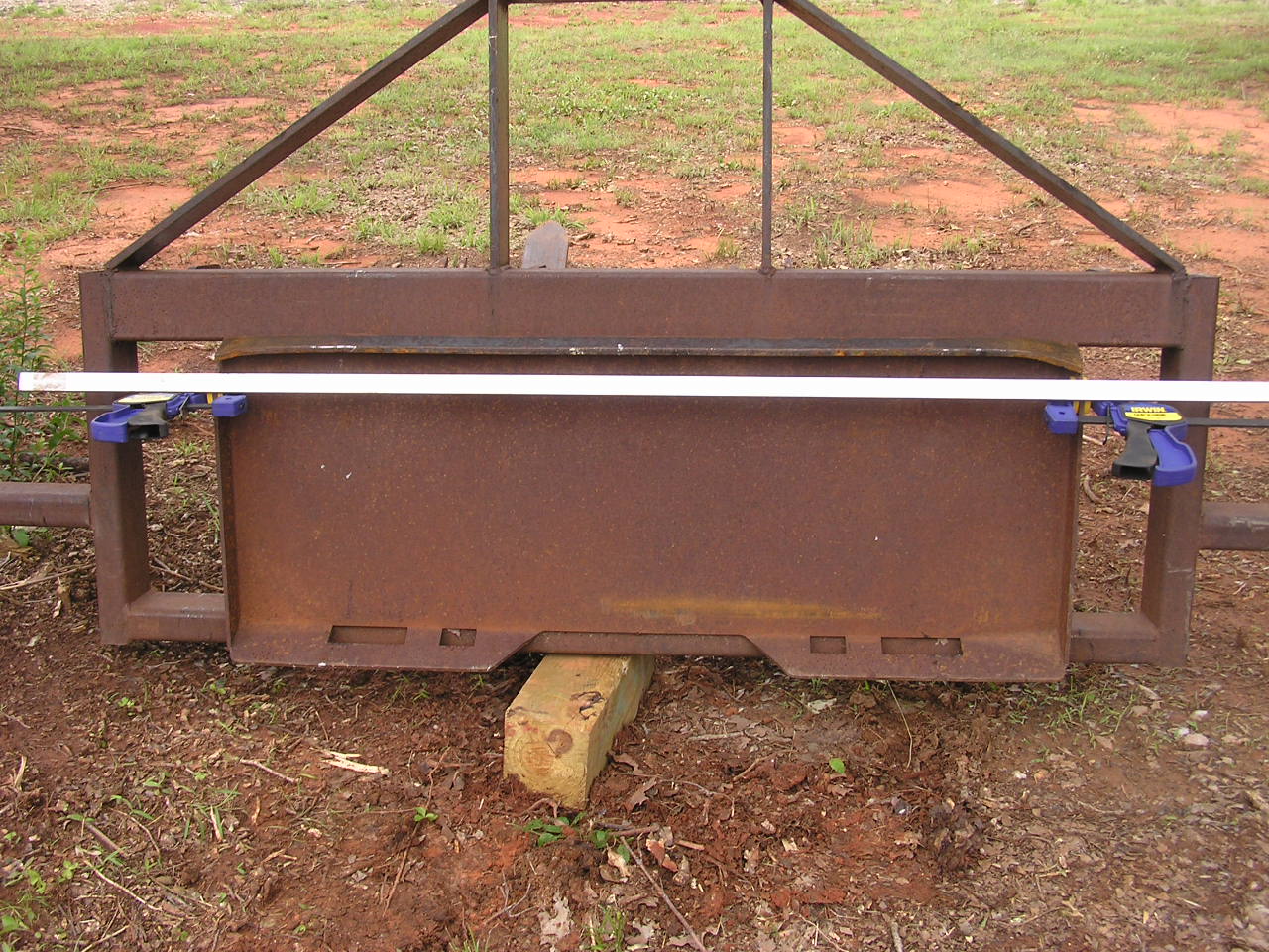

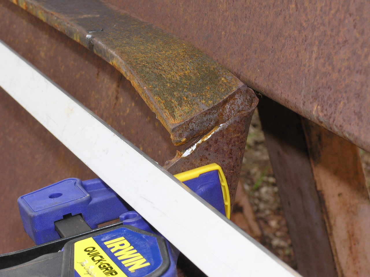

Message #26 06-06-2013

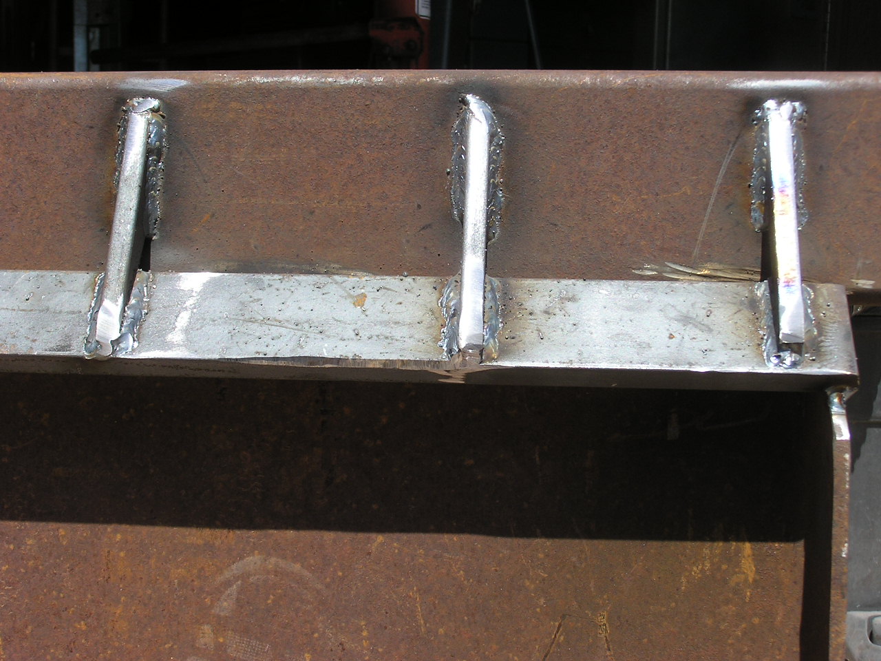

Here is the other one. 1/4 inch SSQA plate, 3/8 x 2 inch bar across the top. Was using it on the V417, trying to pop a dead tree out of the ground, when it broke.
View attachment 321365 View attachment 321366 View attachment 321367 View attachment 321368
I knew it needed bracing added, just never got a roundtuit, now I need a fixittuit! :laughing:
I always wanted to be a procrastinator, I just never got a round to it.

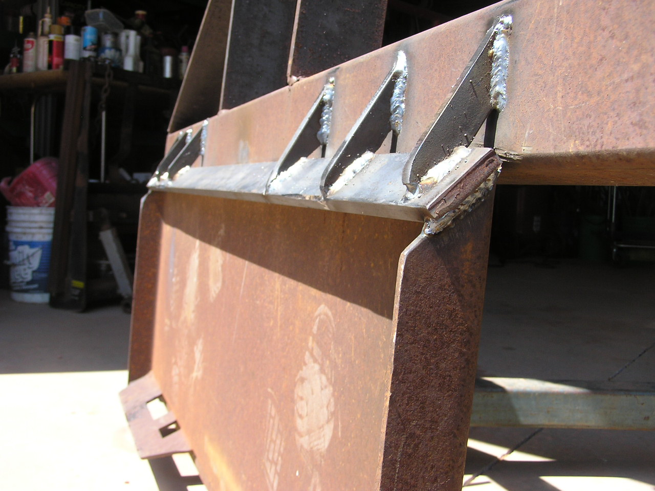

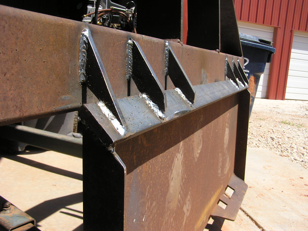

Just an update, this is the way it should have been made to start with.
Removed the bent 3/8 x 2 inch bar across the top, replaced it with a 1/2 x 2 inch bar, and added 3/8 braces, to keep it from bending again.

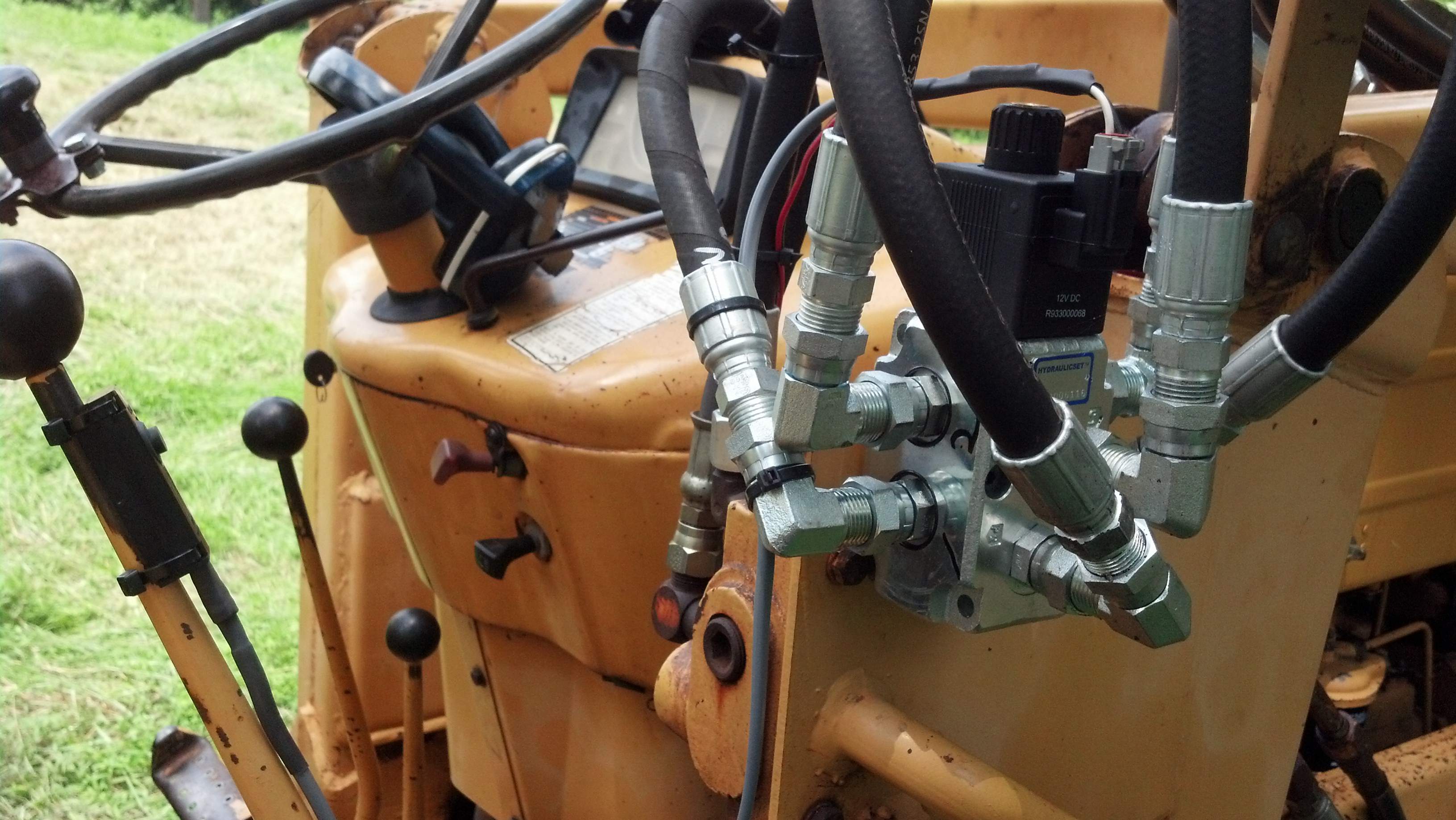

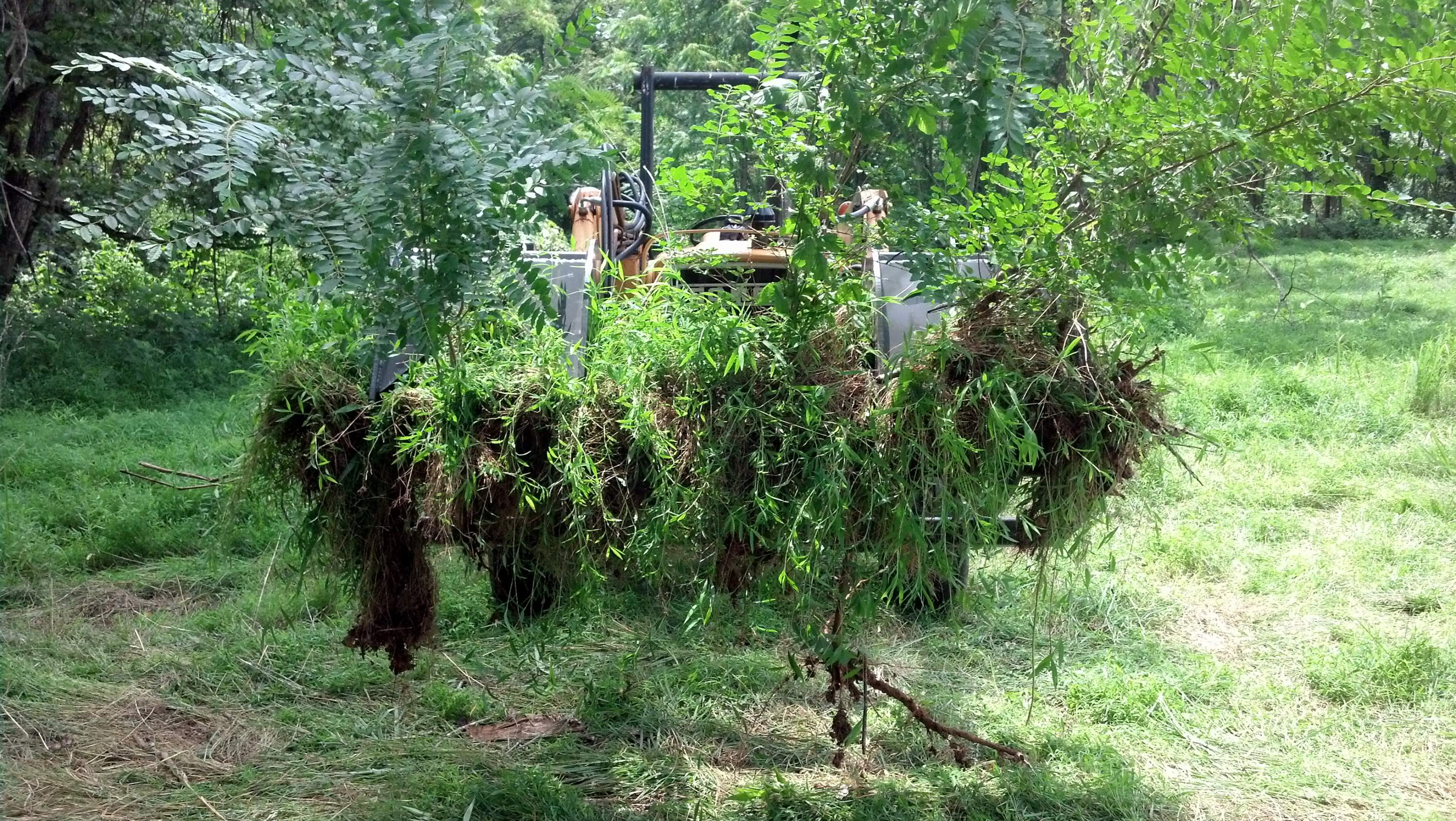

Well, how can I say this? Simply put, I love my grapple!:D Sorry it has taken me so long to get back to TBN, but I finally completed installing my grapple and have been busy using it. Here are a few pics of the grapple in use:
IMG_20130724_142448_685.jpg IMG_20130724_142545_023.jpg IMG_20130802_100656_081.jpg
I have moved limbs and logs much heavier than the brush, but failed to take any pictures. Also, I have not tried removing roots and stumps yet because I'm still waiting for additional weight on the rear. The grapple is very useful on a construction site, as in the picture of moving a steel beam.
Thanks to all of you for your help with this project!:drink:
