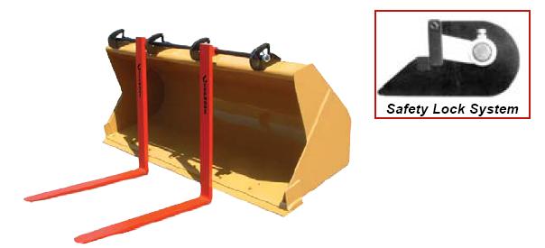

I found this Quick Attach Bucket Fork system on the Gearmore website (see attached). My father made a similar setup for his Case 580K Backhoe.
Are there any other companies on the East coast that make a similar system?
Do any of you out there have a similar setup? If so, how do you like it? Also, where did you purchase yours or did you make your own? Does anyone have any idea what the cost is on this system?
Finally, are there any disadvantages to this system as compared to Clamp-On Bucket Forks or Loader Mounted Forks?
Compared to loader mounted forks, I suppose the obvious disadvantage would be the added weight of keeping the bucket on the loader and also the added distance from the loader pins.

bones1 said:
What holds them steady on the bottom?Seems like they would just flop around.
The weight of the forks is what keeps them from flopping around. Sure with no load on them and rough terrain they will bounce a bit. But not as much as you would think.
   / Quick Attach Bucket Forks #4
You didn't indicate your loader setup, but I think the "best" option IF you have skid-steer quick attach is a separate set of forks. Even with that setup, I have a hard time seeing where my forks are precisely (not a big deal sometimes, BUT when it's Good-Wyfe's commercial embroidery machine on the pallet ...). The bucket would seem to make that worse if not impossible. Of course, if your just picking up fence posts or brush it wouldn't matter that much. Lift will be reduced because you're out farther from the pivots, but it looks like a pretty simple system. be interested in what others have to say.

I have a similar set that I purchased on Ebay for my BX22. They worked fine for the few times I needed them. As others pointed out, the bucket does limit visibility and their lifting capability is limited because of where they attach. Depending on your use, that could be a big issue.

I'm still torn between the Quick Attach Bucket Forks and the Quick Attach Loader Forks. I think I have definitely discounted the Clamp-On Bucket Forks. I have used the QA Bucket Forks on a Case 580K and they are OK but visibility is very limited.
The problem is that the JD QA Loader Forks are so expensive. The JD forks that are rated for 3500 lbs cost around $800-$900. The Skid Steer Quick Attach Loader Forks are less expensive but then I would need a conversion coupler to go from JD QA to SS QA. I think these conversion couplers can cost as much as $400. Does anyone have an inexpensive source for these conversion couplers?
By the way, how should fork capacity be rated? Should they be rated by the loader capacity, breakout force or rollback force? I have a JD 3320 with 300CX FEL. Roughly, the lift capacity is 2200 lbs, breakout force is 3400 lb/ft and rollback force is 3100 lb/ft. My guess would be that I want my forks to be rated for at least 3500 lbs.

As for forks, I fabbed up some bucket-hanging forks years ago, and they
worked OK, except for all the stuff I damaged by not seeing what I am
doing. The weight holds them down fine, if the tines are heavy (they were).
I also considered the clamp-on forks, but they are invisible, too, and they
damage the carcass of your bucket. $350 seems high, too. Then I
considered the factory-made adjustable pallet forks that pin on in place
of your loader bucket. $650-800 and man were they heavy! I briefly
considered the QA style, but they are even heavier and further restrict
lifting capacity by sticking further out front.
So I fabbed up a non-adjustable fork frame that pins on in place of my
bucket and weighs only about 200-250 lb. It is very strong and uses
commercial 1.75" thick tines that I have had cut down to 3" width.
These have worked extremely well on my Kioti CK30 and the previous
units I built for my Kubotas L2550 and L2500. This photo is of one I did
for a Kubota.
