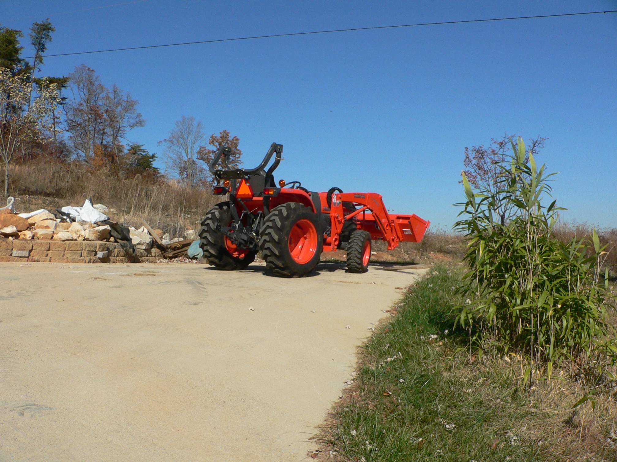

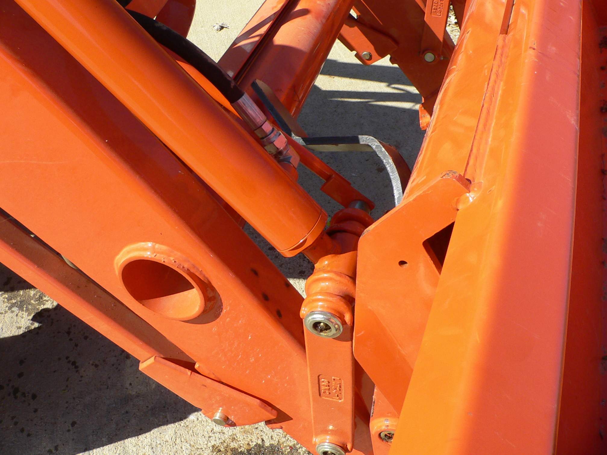

L3240HST had 19 hours. Now has 22 hours after trying to put the quick attach bucket back on. Would not go back on. Finally noticed one arm cylinder was out a couple of inches more than the other. Called dealer and talked to mechanic. He said it was out of alignment. Said to put a piece of solid oak between arms below cyclinder and pull arm back then whack the other side on top of attaching bracket. Used a pine 4x4 and the cylinders reached almost equal amount out. Didn't have sledge hammer so drove into a rock but could/can't get the bucket to hook on bottom. Looking down you can see needs 1 to 2 inches to be able to push pins down to lock on back bottom of bucket. Went to dealer and told him I wanted to trade back to a B7800. Not enough money back so will have to try again to fix or take it to dealer to fix. Talked to mechanic while there and he said to whack it with a sledge, he said the jar seems to make it come back to even. Will try that and wait till some one with a low hours B7800 and some cash shows up to trade. Attaching pictures of before I got cylinders to equal out.

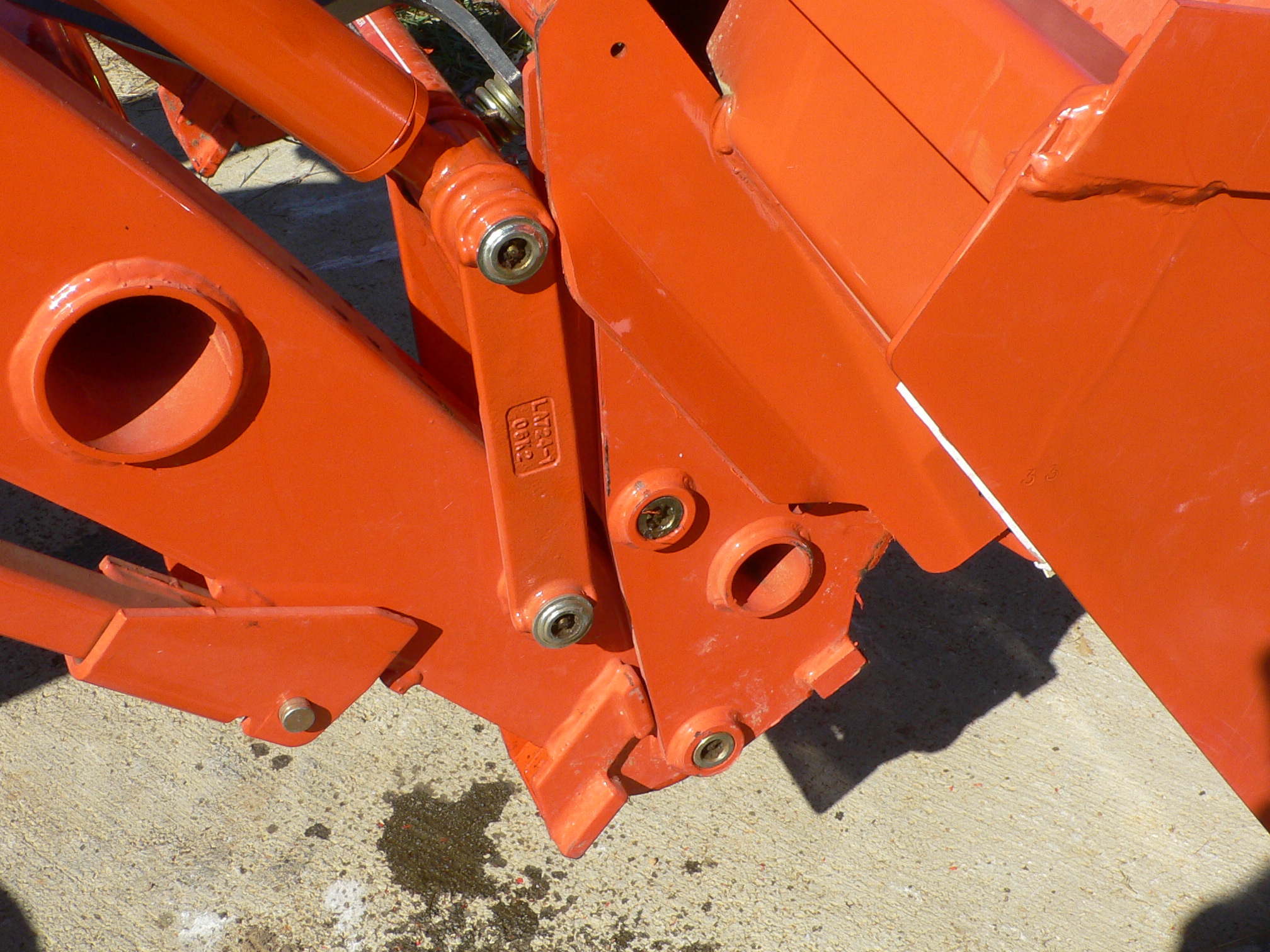

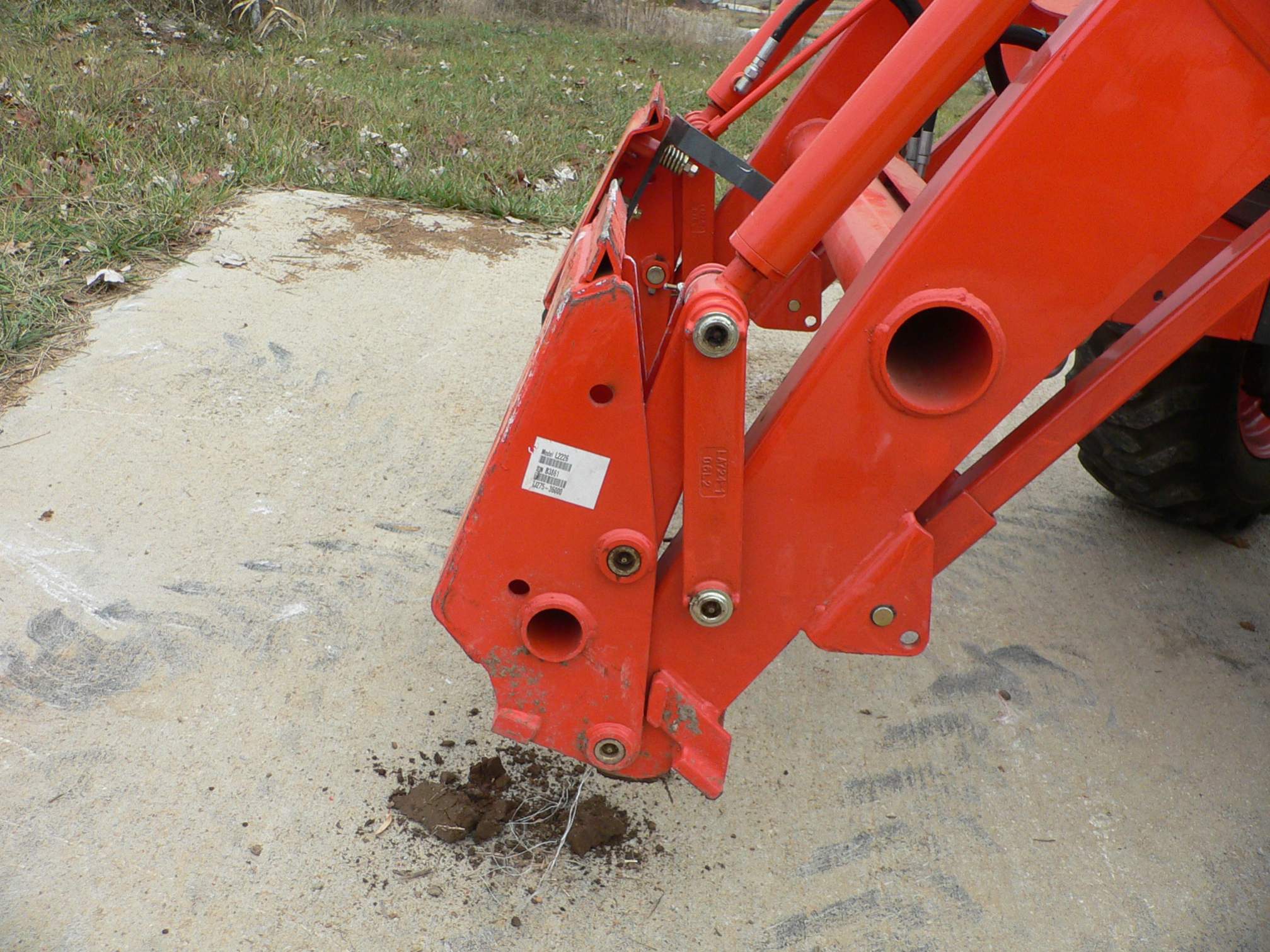

Tried again today. Whacked one side with sledge with 3 pt hitch down and no movement. Picks up at top perfect but bottom stays away from bottom latch. Here's a couple picture showing the distance apart of arms on one side vs the other side. Also had to throw in a view shot.

Looking at your photos:
1. your adapter looks twisted about the torque tube.
2. the left hand hook is twisted counter clockwise looking down from the top.
Lay a straight edge across the top of the adapter to check. The tops of the hooks should lie in the same plane both horizontally and vertically. I don't think that yours do.
This looks like a warranty matter.
Vernon

I agree with Vernon, your cylinder rams are even, the QA isn't, it got twisted somehow. I remember seeing a thread with the same issue, was bent worse than your's..but if you can't use it..bent is bent.

Youre QA has a twisted torque tube. Try this: Tie your joystick in curl position. [Pump will labor against the relief valve.] This amount of force should torsion the torque tube enuf to get a line up. After you make the hookup cut the torque tube and reweld. -- FIXED.
