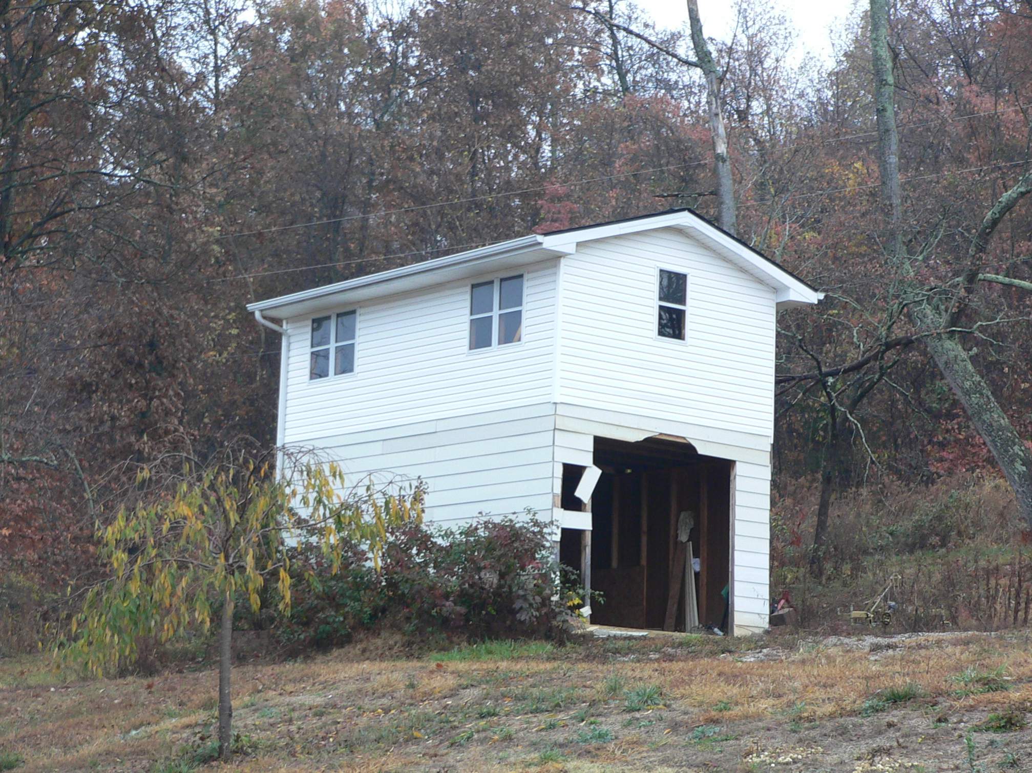

Tractor won't fit in tractor building with ROPS up. I was not operating, I was trying to attach the bucket. When I do more than move it on fairly level ground, I raise the ROPS. Picture of "the rock" that I moved with forks and tractor building showing why I lower the ROPS, now.

Didn't have the bucket on when it bent. Had forks on with a hugh rock on the forks. Drove it up the hill, layed it down and pushed it into place. Think the lower pin came out when I pushed the rock. Left the tractor with the dealer yesterday. Told him no hurry and a week would be fine to fix it and attach a hook on the top of the bucket while he has it. Will ask the mechanic how he fixed it when done. I tried the pushing against the immovable object and it didn't budge. Have this rock sticking out of a bank that's perfect for the immovable object stuff.
Until I fixed my QA so that the pins won't cam out the only time I had them come out was when backing. Back draging the bucket or the fork frame drug in the ground coming out from under the load. When pushing they only set deeper into the slots.
