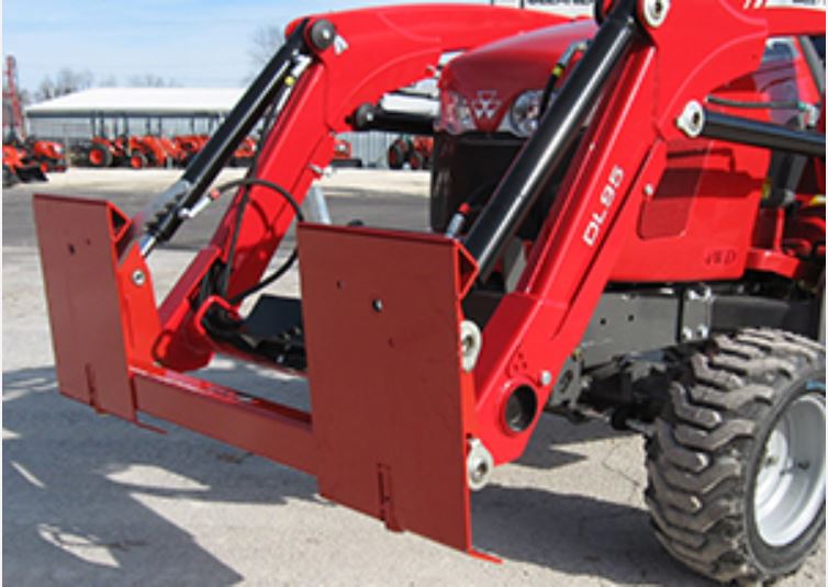

First thing I tried to find was a quick attach, but as I said above, what I was finding was heavy (weighting 10% of the FEL lift capacity or more) and expensive.
As I could not find anything that I was happy with, I decided to design my own.
I also contacted a local fabrication company that builds sheet metal and weldment assemblies (I use their services for work related projects so I know their fabrication capabilities and quality) to get me a quote for individual parts as well as complete welded/painted assembly.
I thought that there could be interest in the small tractor community for such product, especially here in Canada where the selection of small tractor attachments is smaller than down in the US.
Attached is a CAD rendering of the quick attachment, it weighs approx. 30 pounds.
I did also a quick basic FEA and it is plenty strong for the lifting capacity and break-out force of the DL95.
As you can see from the attached pdf, I am also working on the lightweight fork carrier attachment (and the grapple, not shown).
Also in the works is a set of conversion brackets that can be welded to an implement of your choice to make it work with the quick attach.
So please let me know if anyone would be interested or if you have any questions/comments.

axlehub is referring to this MASSEY TACH-N-GO
I have there QA and forks. Very nice setup. the fork also attach to the three point which i have used on a few occasions. The site looks a little cheap but the guy is nice and the quality is second to none
they are out of wisconsin

Hi not2old,
I have done some calculations and results are summarized in the table below.
Bear in mind that I may have the kinematics of the loader a bit off, as I do not have a production drawing with exact measurements and weights.
Also, I have estimated the cylinder diameter at 38mm, which may or may not to be exact.
However, my calculations are very close to the values stated in the OM for DL&L series loaders.
I can not speak for other Quick Attach designs as I do not have their COG location, geometry and weight.
But my design is about 1/2 of the Tach-N-Go weight (mine does not have the hitch receiver and chain attach points, hence the lighter weight).
I am working on a lightweight fork attachment carrier and the grapple is the next.
Will update the the table as I progress.
I am ordering components to build the quick attach.
As soon as I have it welded up and installed, I will post pictures.
Testing will need to wait a bit, it is still cold up here (-20ーC tonight, -4F) and I need the snow blower on the tractor, we just got about 15cm (6") of snow couple of days ago with more to still come....
All the best,
Roman

Your diagram shows the lifting force at the end pin, which shouldn't have changed from the factory specifications?????
First four rows of the table show factory setup.
Last four rows show setup with a quick attach (that I am working on).
You can see that available lifting force at the end pin is lower with the Quick attach, as it moves the bucket further away and adds weight of the quick attach.
Roman
