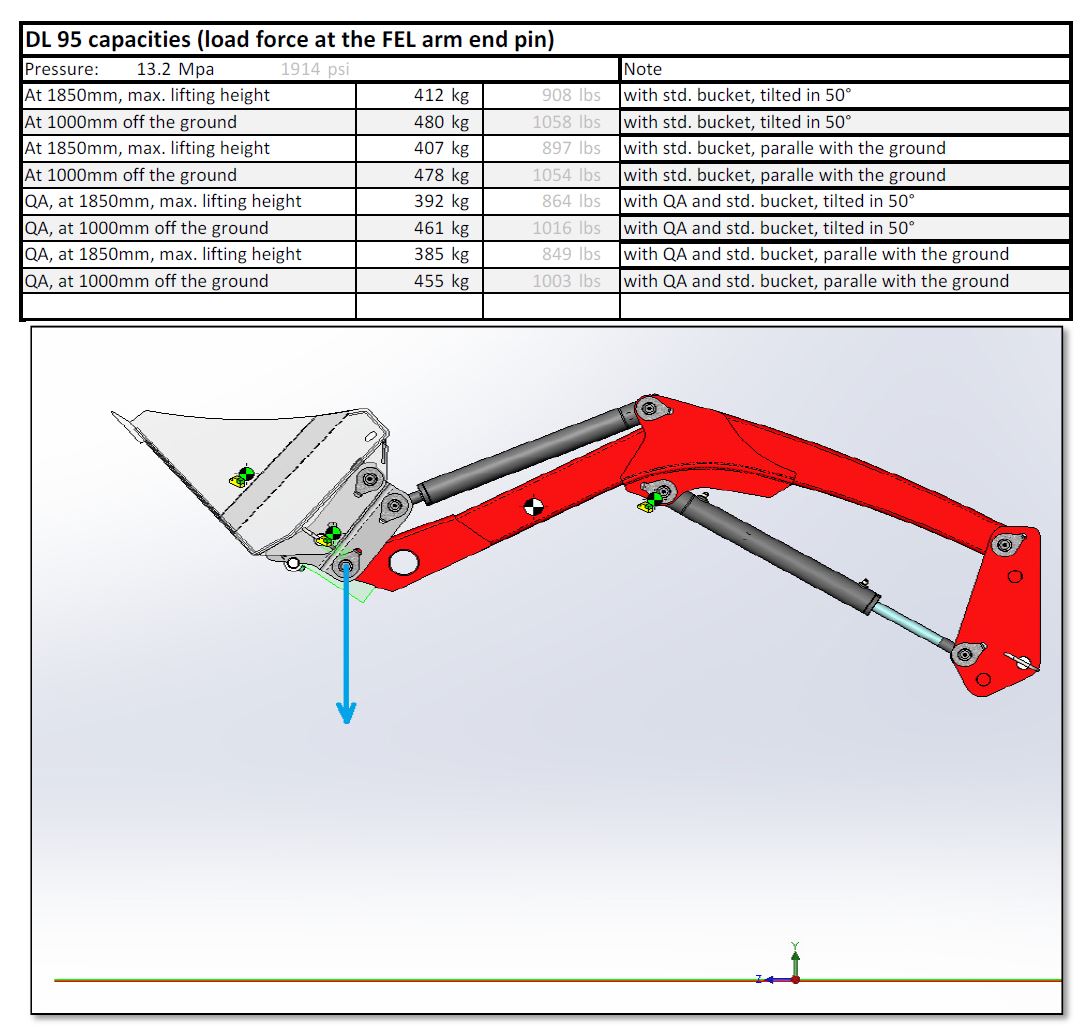

Hi not2old,
I have done some calculations and results are summarized in the table below.
Bear in mind that I may have the kinematics of the loader a bit off, as I do not have a production drawing with exact measurements and weights.
Also, I have estimated the cylinder diameter at 38mm, which may or may not to be exact.
However, my calculations are very close to the values stated in the OM for DL&L series loaders.
I can not speak for other Quick Attach designs as I do not have their COG location, geometry and weight.
But my design is about 1/2 of the Tach-N-Go weight (mine does not have the hitch receiver and chain attach points, hence the lighter weight).
I am working on a lightweight fork attachment carrier and the grapple is the next.
Will update the the table as I progress.

   / Quick Attach for DL95 (GC1700 series tractors) #14
Although I understand the geometry and physics, I have very little experience with hydraulics. Your diagram shows the lifting force at the end pin, which shouldn't have changed from the factory specifications?????, but the bucket sits further out which will change it's lifting ability. Do you know how much the loss is?
#15
First four rows of the table show factory setup.
Last four rows show setup with a quick attach (that I am working on).
You can see that available lifting force at the end pin is lower with the Quick attach, as it moves the bucket further away and adds weight of the quick attach.
Roman

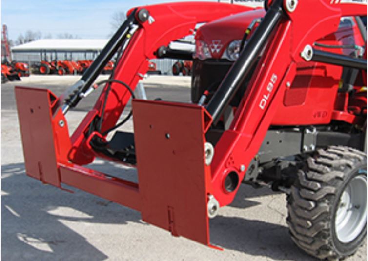

   / Quick Attach for DL95 (GC1700 series tractors) #16
I've sold a few of these universal quick attach adapters for Massey DL95 loaders.
At $650 shipped within 1,000 miles, they're not cheap, but they do make life much easier.
At 73 pounds, the weight is fairly manageable.
Travis

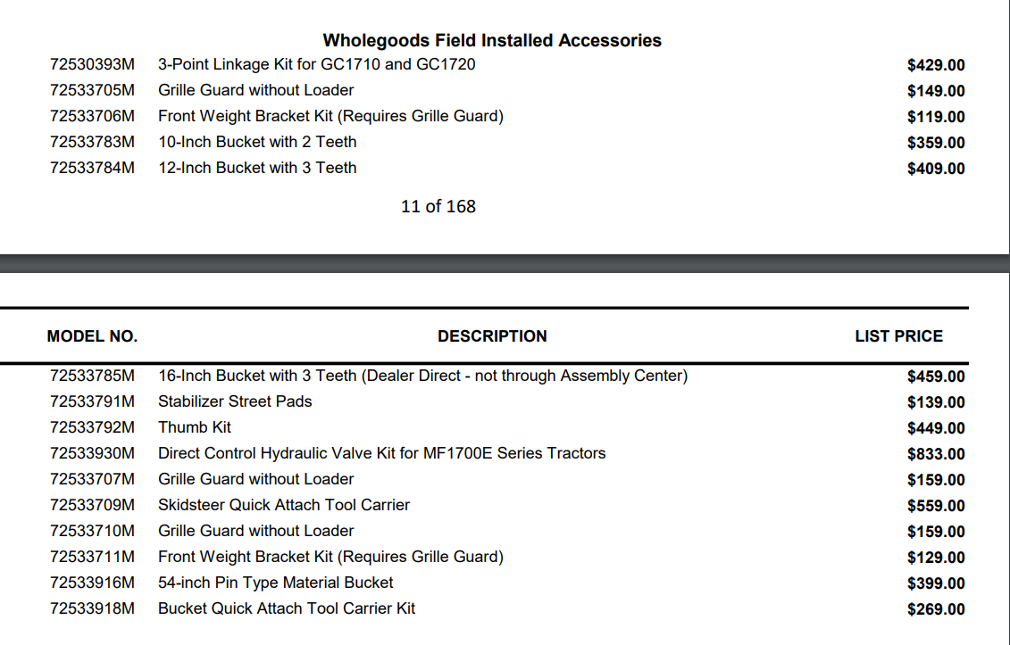

Not to burst any bubbles, it does look like Massey may have their own factory quick attach now.
See this youtube video. And this video.
I think they may have an SSQA option also. I've also recently seen mention of a 54" bucket option for the loader, a 16: bucket option for the backhoe. Massey seems to be doing a terrible job about letting even the dealers know about new options/features....
   / Quick Attach for DL95 (GC1700 series tractors) #20
I think a SSQA would still be better. I've also recently seen mention of a 54" bucket option and some other things. Massey seems to be doing a terrible job about letting even the dealers know about new options/features....
Dealers have to figure it out on their own. Usually it shows up as an option when the dealers order the tractor, but I haven't seen or heard tale of a quick attach here for a subcompact recently. Not even for the new 1526. 1726e and bigger get the option of pin on order skid steer.
