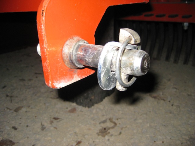

Hi everyone,
I have received my quick attach system and I didn't receive any directions on how to install them. I received 6 big washers that have a fold in them (when I get home today I will post pictures) Can someone please explain what the washers are for thanks.

The washers with the fold are for the pins on your attachments. You put them on the lift pin, then attach the snap pin through the hole in the fold of the washer (they should have a hole anyway), and this helps with stability of the qa.

I didn't think Titan sold 3 pth quick adaptors only quick hitch for loaders?

Here is how they go on the bend and the clip hold them at the outer ends so the 'fingers' of the hitch can grab in between

   / Quick Attachment system #7
Excellent picture, chopped. Very clear how it is used.
   / Quick Attachment system #8
If you ned more other than buying them there is a thread here somewhere on how to make them. basically large washer bent and then drill a hole for the clip to pass through. Not sure if its much of a savings from just buying them.
