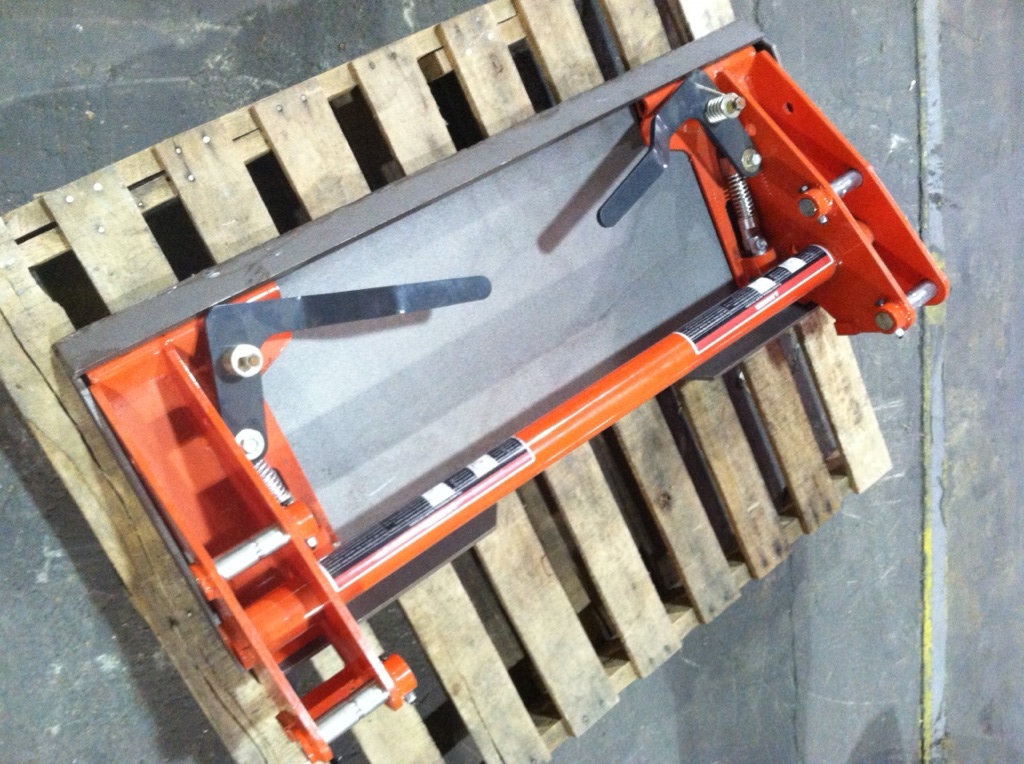

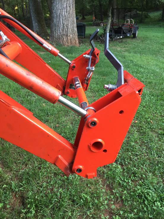

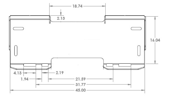

/ Quick attachment system #4
This is the SSQA plate that is on an attachment:
This is a SSQA mechanism:
Both together:
Loader with SSQA:

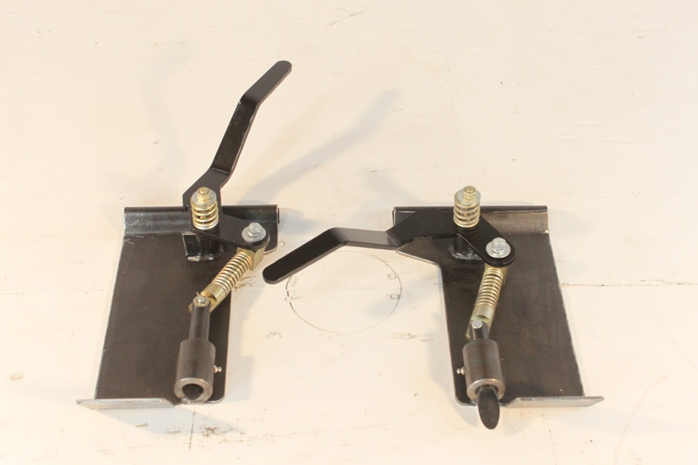

On my L3200 the forks were on more than the bucket. I ended up building a power SSQA for mine. Got in the habit of leaving nothing on the loader when I put it up at night. As the next time I'd use it the wrong impliments was guaranteed to be on there.
It was so handy to back out of the shop, grab the right impliment & take off. Hit the power switch to the linear actuator on the SSQA as I drove off to latch it.

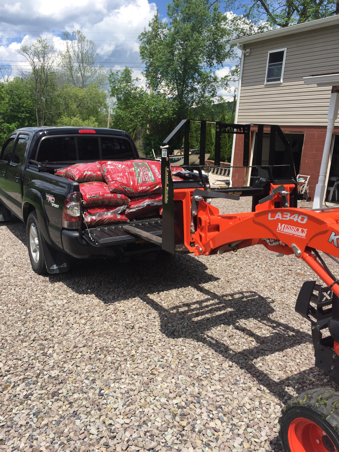

I like mine, glad i bought the optional SSQA with the BX23s tractor. It opens up many different options to buy more quik-attach things... oh noooo, there goes my dang wallet...lol. I`m looking into the pallet forks, and the sno-pusher right now. I only want things that i`ll use all the time. I dont want a back yard full of frontend attachable implements that only get used once and then sit there until i realize i shouldn`t have bought them. One expensive frontend item comes to mind, the grappler... i cant see the expense, and it would get used once and never used again. Not to mention, i would have to add the third hydraulic, thats a pricey option for how little i would use it. Not worth it to me.
IMG_6147.JPG forks are awesome with the SSQA!!
