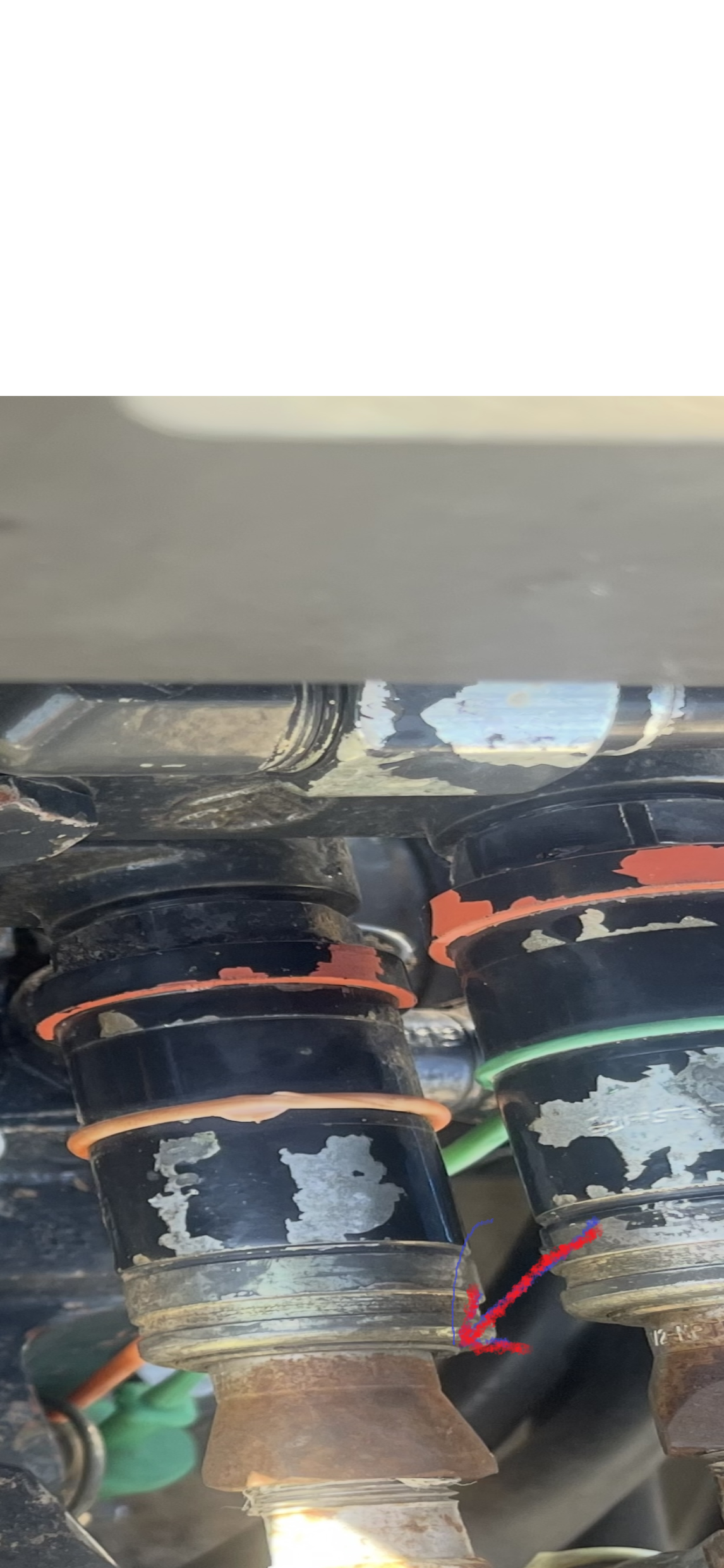

The Pioneer part is the male portion of the quick connect. Using a good penetrating oil soak the seam of the female section,
My arrow just barely shows up, soak that seam good and push and pull till it starts to move repeating the spray and soak till the male portion starts moving, eventually it will disconnect.
   / Quick Connect Couplers Question… #18
Also twist the plug side back and forth a bit to help mobilize sticking components. A little warmth should help too. Try a hair dryer for a couple hours.
