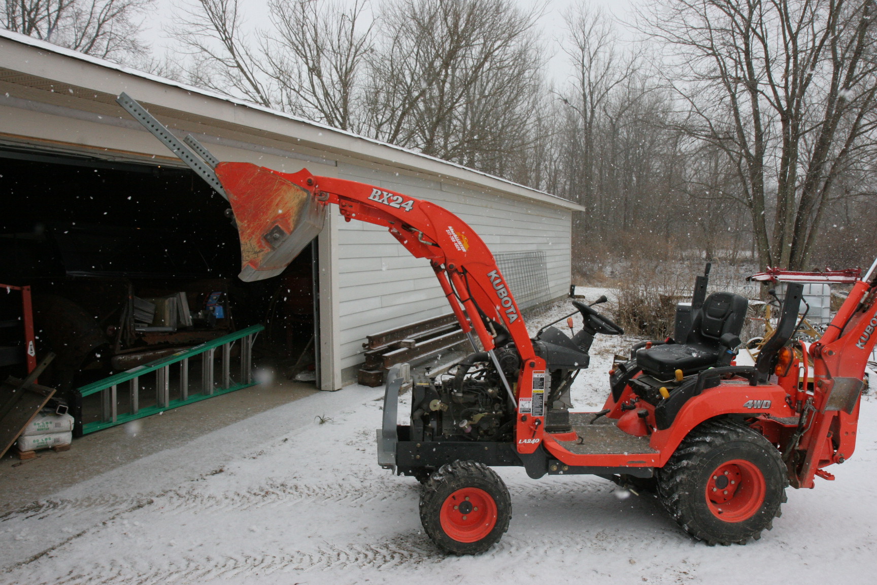

All you have to do is not pay attention when you have a log in the bucket and accidently drop it backwards onto the hood! The dealer quoted me somewhere around 200 for a new "lid". Since the tractor needed maintenance anyways, I took off the rest of the cowl to do that work. I really hate how much they block access to everything. Right now I am leaning towards making my own version of a new hood and cowl from sheet metal (with good access to things). Until I get there though, I thought it would be a good idea to put the front guard back on as I am running around "topless".

"topless"

"topless"
Wowy, wow, wow, wow. That is one smoking hot tractor. Is she single?
Or is it a male. In that case I don't date males, as I''m a male myself.:laughing:
I'm looking for a woman.
Anyway back to the topic. That looks like a great idea. Now you got me wanting to mount some to my riding mower. That I have to sometimes jumpstart.

BX24,
This is off-topic, but what/why do you have mounted in your FEL bucket in the "topless" picture?
Thanks,
Matt.

My guess is he wants to avoid a repeat of the event that caused the demise of his hood?
