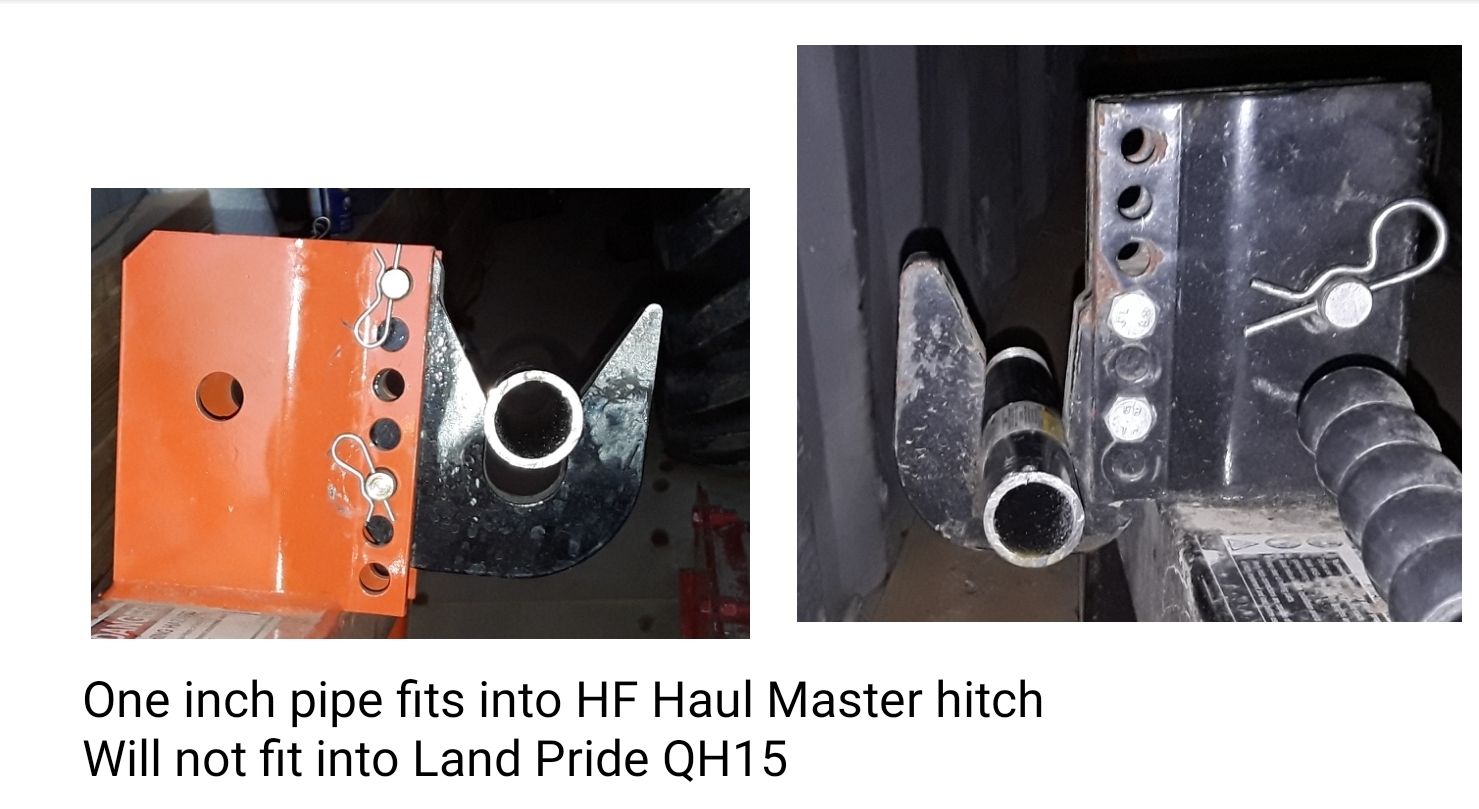

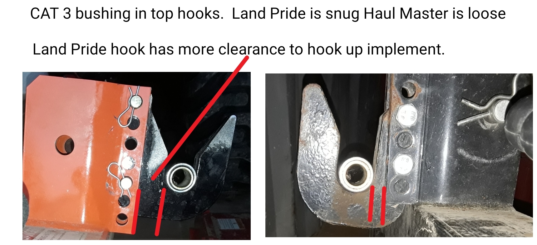

Using 1 inch pipe as the top bushing works as long as the top hook is oversize and out of spec. It worked on the Haul Master hitch but wouldn't fit into the Land Pride hitch that was machined to specifications.

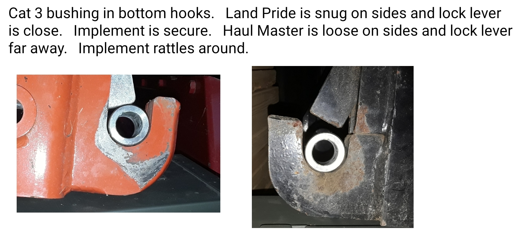

Here are some detail photos of a Land Pride QH15 quick hitch VS Harbor Freight Haul Master. The Haul Master is Chinese made and sold by many names.
After using both the Land Pride is snug and holds an implement such as a rototiller steady. The Haul Master is very sloppy and an implement jumps around.

How well does 1 inch pipe fit lower hooks....
Here is how it breaks down for lower hooks using 7/8 (cat 1 pins), at least for me...
Very expensive cat 3 sleeves, 1.430 inch
Simple scrap pile 1 inch pipe, 1.338 inch
For upper hook.... I used a 3/4 inch bolt (on ballast box) with a 3/4 inch pipe sleeve.
Very expensive "tractor" sleeve 1.104 inches.
3/4 inch pipe from scrap pile, 1.056 inches...

If you use 1 inch pipe in the bottom hooks it will be a loose fit. Especially on the Harbor Freight hitch. Over one hundred thousands is too much play. Slide a piece of 1-1/4 inch EMT conduit over the 1 inch pipe.
Upper pin should be 1-1/4 inch and 3/4 pipe is also too small.
I've only been paying $1.50 for bushing adaptors. Times 6 - $9.00 per implement.
Illustration was more to show how out of tollerance some of the imported hitches are. If you are thinking of buying one get a top and bottom Cat 3 bushing and check tollerances and locking latch fit.

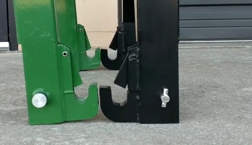

Tar River (black) VS Deere I-Match. Even without measuring easy to see the Tar River hitch will be a sloppy fit on the bottom pins. It pays to spend more.
