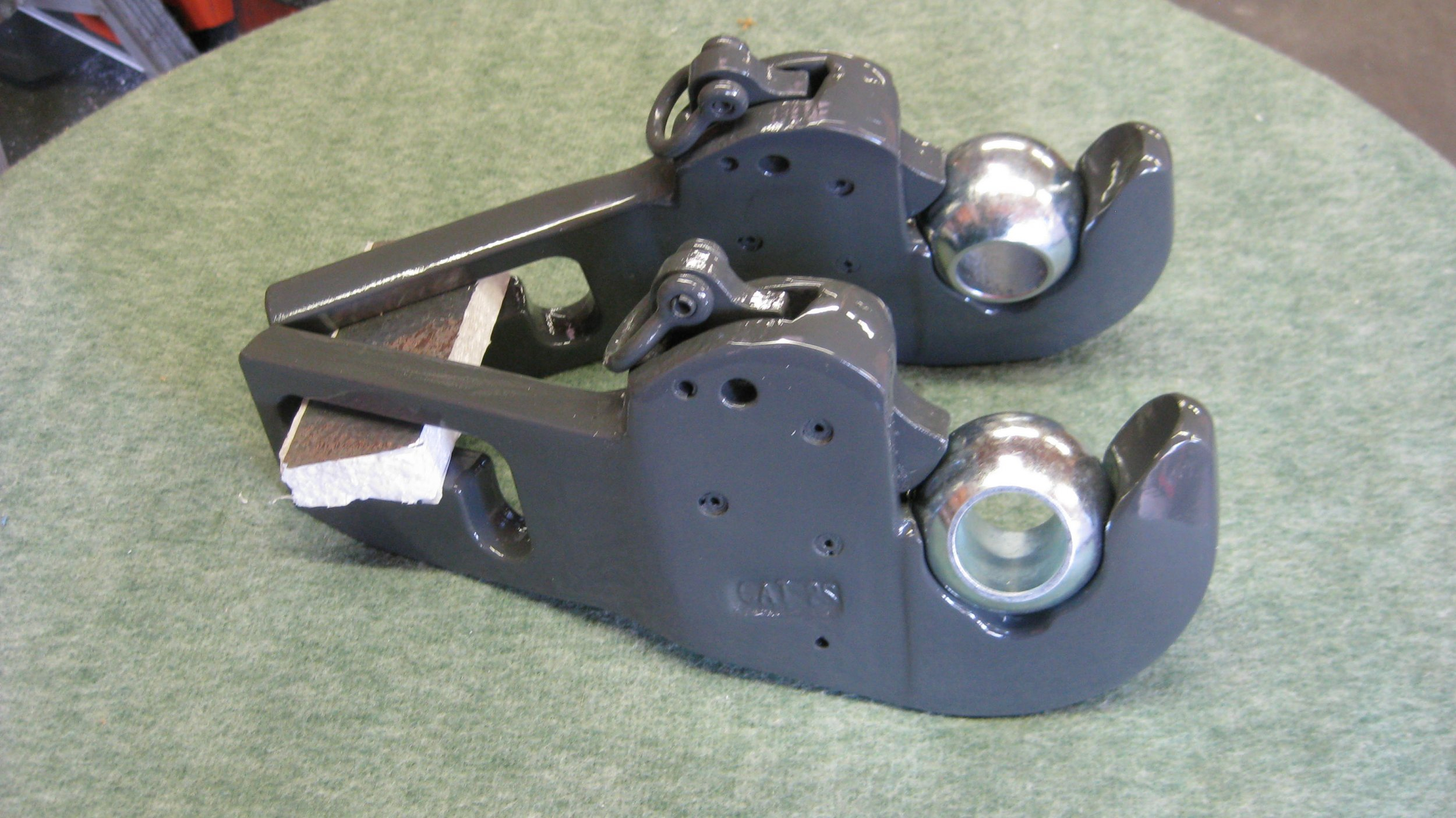

Where can I buy a set of these for a kubota 4740 cat 2
From me at Fit Rite Hydraulics.com I supply them with 2 sets of implement balls.
For your tractor I recommend the cat 1-2 ends, not the full cat 2 ends. The cat 1-2 ends are good for 9000lbs, you do not need or want the cat 2 ends for an L4740.
$250 you do the all the work, ship me the extendable ends and I will do the cutting, welding, grinding and painting. $400
I can typically ship the bare ends in 1-2 days. Ship your links to me, it is best if I receive them on a Friday so that I can return ship them the following Monday.
Use the Fit Rite contact form if you want to move forward with this.

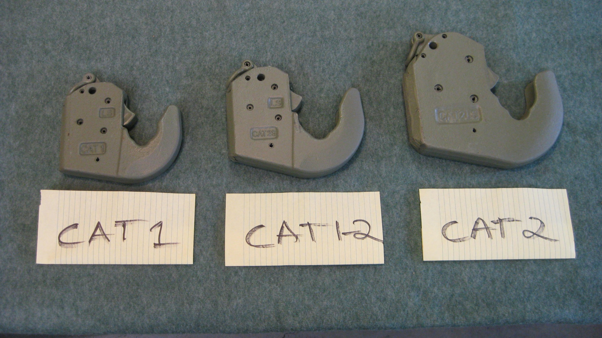

My issue is I have a jobn deere MX 6 brush mower with cat 2 pins and all my attachments are cat 1. I do not want to change the mower to cat 1 as John deere wants 275 for the kit. It appears that with your set up all I need are different balls and I can hook up to both cat 1 and cat 2.
   / Quick Hitch or 3 point extendable arms? #43
I can't remember if they make the balls for a Cat 2 hook with the hole for a Cat 1 implement though, but you can always get bushings for the Cat 1 implements and run the Cat 2 balls.
Just make sure there is enough space for the hook on the Cat 1 implements. These hooks are built to take a beating and therefore are somewhat bulky.
   / Quick Hitch or 3 point extendable arms? #44
My issue is I have a jobn deere MX 6 brush mower with cat 2 pins and all my attachments are cat 1. I do not want to change the mower to cat 1 as John deere wants 275 for the kit. It appears that with your set up all I need are different balls and I can hook up to both cat 1 and cat 2..
You would simply get cat 2 balls. Yes the cat 1 & cat 2 balls are exactly the same other than the ID for the different pin sizes.
The straight cat 1 hooks only have cat 1 sized balls that are a smaller OD. The cat 1-2 and cat 2 sized hooks take the same sized balls which are larger that the straight cat 1 hooks take.
As ptsg mentioned, you could very easily have clearance issues with full sized cat 2 hooks on cat 1 implements.

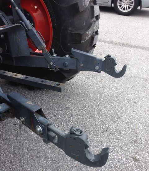

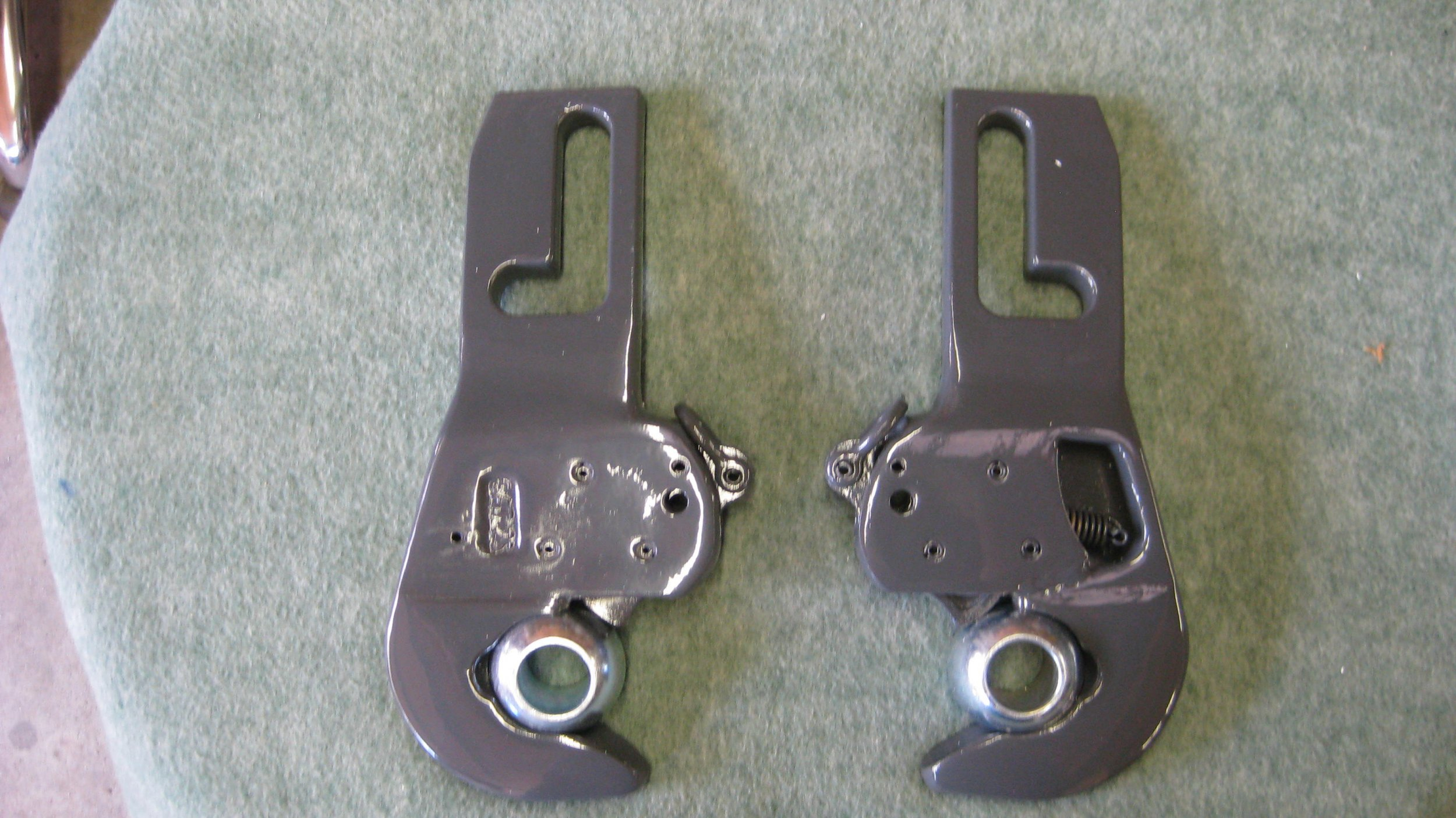

Here is a set for an L6060 that I supplied. :cool:
They are available for top links also. 👍
The last picture of the top & tilt set went to the tractor in the first picture with the draft arm European style QH.

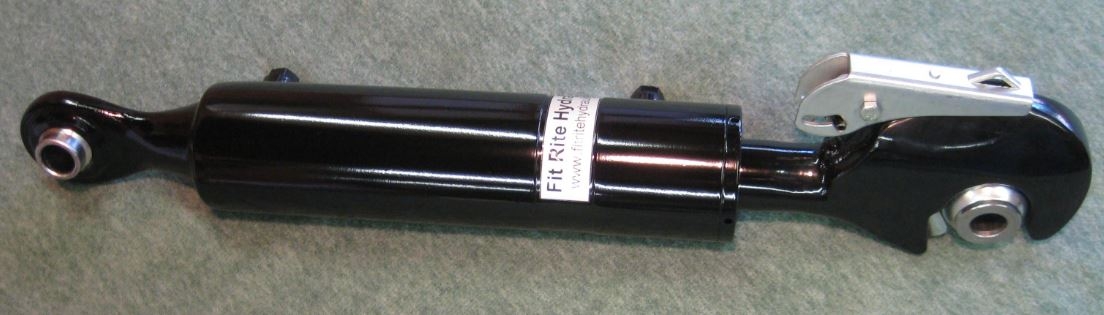

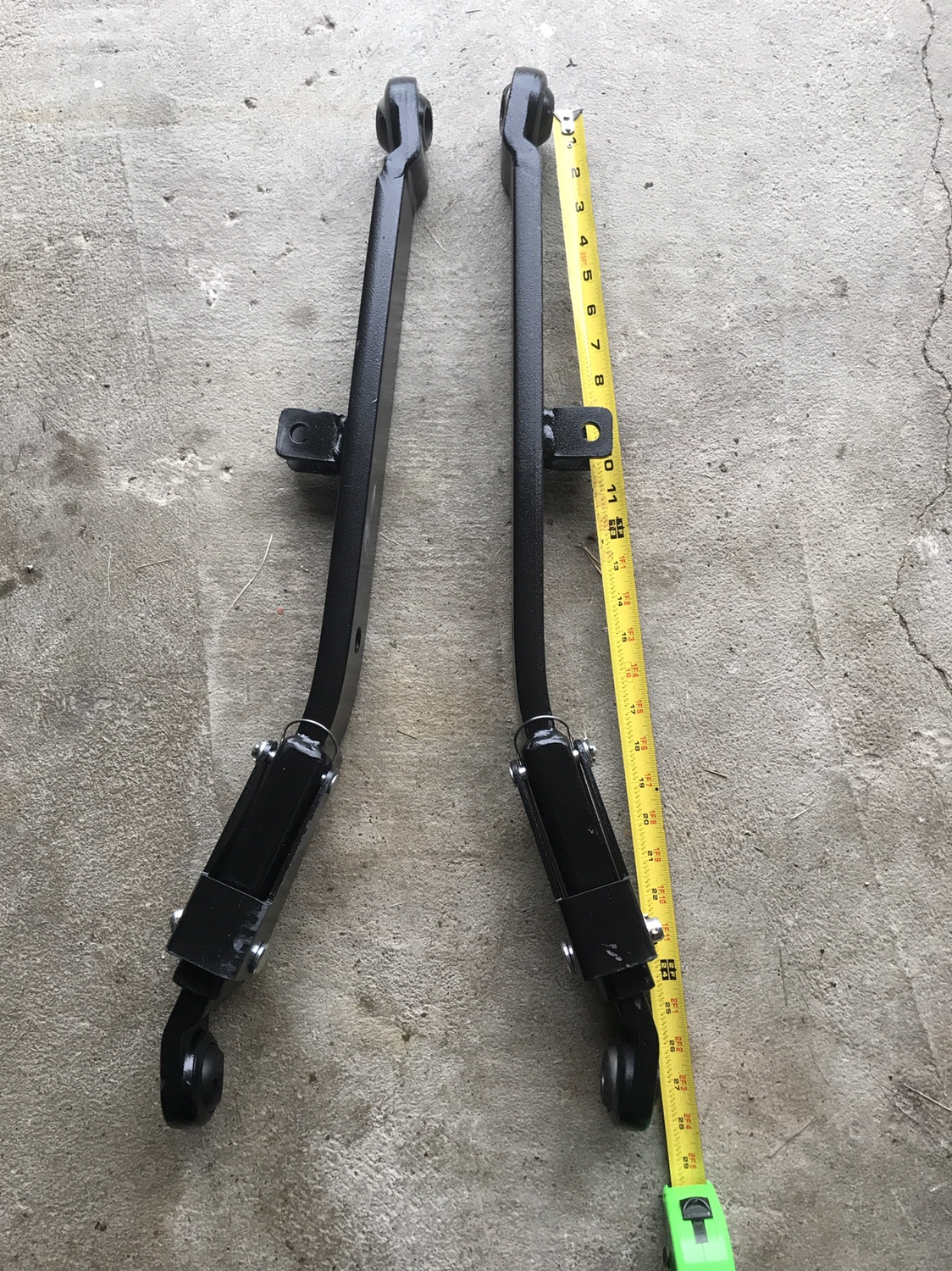

Do you make the extendable draft arm link with the hook? Also the hydraulic top-link with hook?
   / Quick Hitch or 3 point extendable arms? #49
I'm interested in a set for my New Holand TC35.
Typically the existing extendable links get the ball swivel ends cut off and the Euro hooks welded on.
Yes I can-do build the hydraulic top links with the Euro hook, similar to the one previously pictured.
