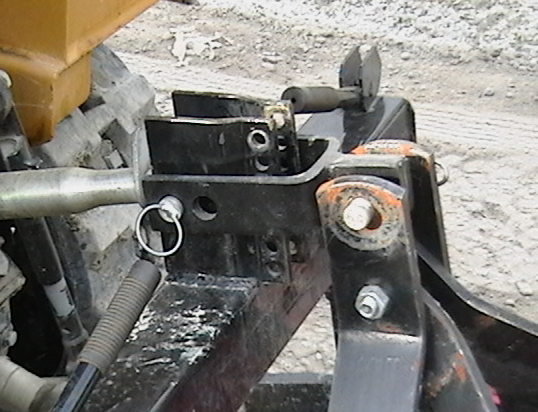

Adapter used on a non-compatible implement:
Bruce

Read my post from yesterday at 8:03. I am pretty sure that will work for the rake.
Agreed. Adding the "forked" adapter might permit me to hook-up without getting off the tractor, but the adapter will introduce floating behavior which might not be helpful when using ground engaging equipment. Might be easiest to do as you suggest!
(BTW - hello to anyone searching the Internet hoping to hook-up and get-off)
   / Quick hitch other than Harbor Freight? #94
It won't float. Bottom hooks stabilize up-down motion, the top link stabilizes front-back motion.
Bruce

Not my photo (found on the internet to illustrate), but I left my homemade link on the rake after each use, when I was doing ground work. Otherwise it stayed on the carryall. The others fit the top hook.
Bruce
