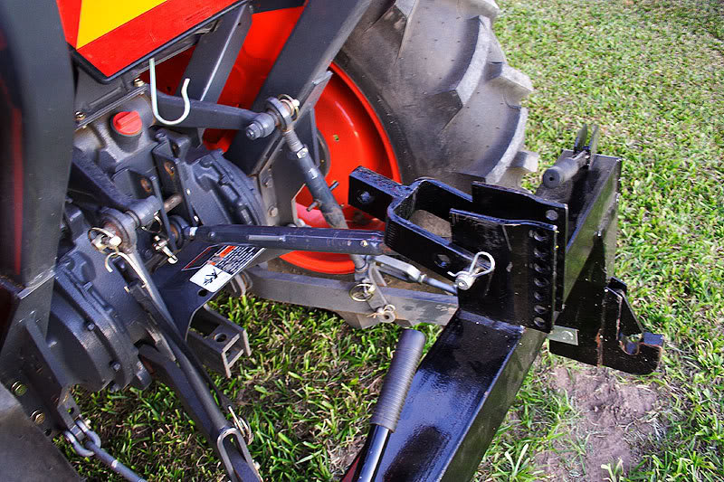

   / Quick hitch other than Harbor Freight? #88
Bruce,
Is that picture correct? Looks like that adapter would possibly work, but appears to be backwards. shouldn't it be attached to the implement, with the pin ready to connect to the QH top J-Hook?
   / Quick hitch other than Harbor Freight? #89
I think he needs this adapter for implements with no pin access from the bottom. But two flat straps can be used, instead.
Bruce
Could be, Bruce...maybe he'll respond.
   / Quick hitch other than Harbor Freight? #90
   / Quick hitch other than Harbor Freight? #91
Read my post from yesterday at 8:03. I am pretty sure that will work for the rake.
Sent from my Samsung SPH-L710 using TractorByNet

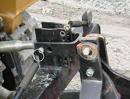

   / Quick hitch other than Harbor Freight? #92
Adapter used on a non-compatible implement:
Bruce
   / Quick hitch other than Harbor Freight? #93
Agreed. Adding the "forked" adapter might permit me to hook-up without getting off the tractor, but the adapter will introduce floating behavior which might not be helpful when using ground engaging equipment. Might be easiest to do as you suggest!
(BTW - hello to anyone searching the Internet hoping to hook-up and get-off)
   / Quick hitch other than Harbor Freight? #94
It won't float. Bottom hooks stabilize up-down motion, the top link stabilizes front-back motion.
Bruce
   / Quick hitch other than Harbor Freight? #95
Bruce - do you leave your set-up that way and use for all implements -- even if the QH J-hook fits?
Thanks
   / Quick hitch other than Harbor Freight? #96
Not my photo (found on the internet to illustrate), but I left my homemade link on the rake after each use, when I was doing ground work. Otherwise it stayed on the carryall. The others fit the top hook.
Bruce
