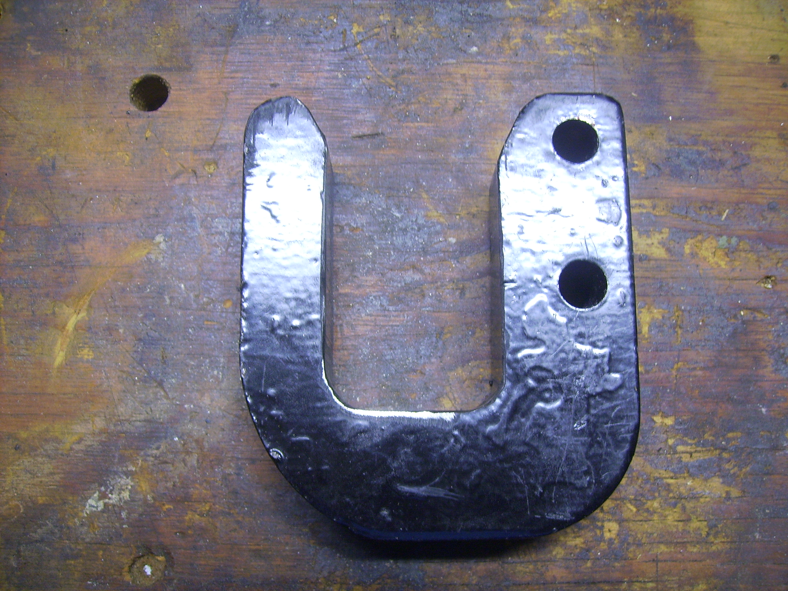

Fallon, if it's not too much trouble, would you post a pic of the spacer you welded on. I assume you did that to extend the top hook out.

Ya, pretty much what I did just looking at the first photo. Several threads on here about that mod... where I got the idea from.
I saw that pic. Early results with my new/first QH indicates that I may need to consider that option.

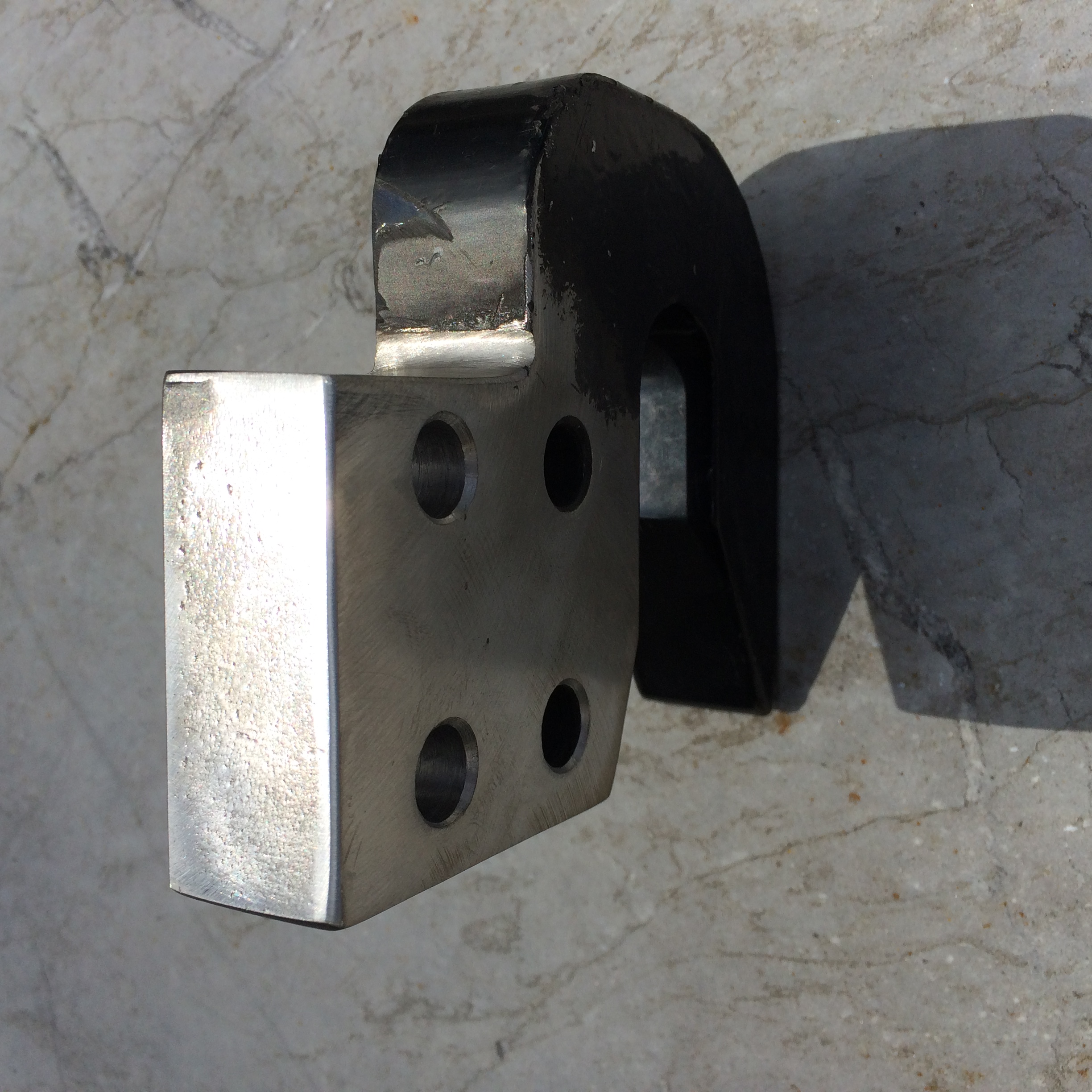

TnHobby, here's another example. I had Bennett Industries in Cookeville do this for me - welded on a 1-1/4 thick piece for the extension, then machine it down to exactly match the original thickness, then drill the two new holes. I paid $65, but also had some other work done for that, so the hook was maybe $45-$50.
/ Quick hitch recommendations #20
JRobyn, looks like a good job by the welder/fabricator. Based on my limited experience so far with the HF QH, something like that is almost a necessity for seamless compatibility of attachments.
Attached is a pic of my altered hook. I actually milled 7/16" off the inside of the hook. I'm not sure if this was a good idea or not. The loss of stock obviously has weakened the hook, and I'm not sure if the 7/16 is enough to accomplish the needed result. I have not been to my property yet to give it a try. I'll report my thoughts once I try it out. If this doesn't work satisfactorily, I may have to somehow source another hook and use your solution
