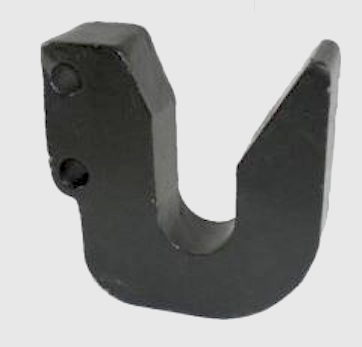

I had the HF quick hitch. Did not fit the box blade. Well today it died
   / Quick hitch #22
You can buy the solution for 16 bucks,,,
mine came FedEx Ground last week.
873-HF141137 TOP HOOK FOR CAT 1 QUICK HITCH S141137 - Quality Farm Supply - Farm equipment, tractor parts, agricultural supplies
Mine actually cost me more,, because I ended up getting a dozen things from QFS,,, :laughing:
Thank you CADplans! I was in the process of trying to file off about 3/16" from the inside front of my HF Quick Hitch top hook when I saw your post. I ordered it and It showed up this morning. I am comparing it to the stock hook and it is the solution I needed. It moves the hook out from the holes about 9/16". I guess I may have contributed to the lack of availability on the store shelves... I recommend this product.

Thank you CADplans! It moves the hook out from the holes about 9/16".

Any pictures? Didn't see any when I went there on my phone. At $15-20 it's barely worth my time to make my own extensions.
   / Quick hitch #25
i'll try.
   / Quick hitch #26
Made it easier to see. Looks like the holes aren't as far from the hook as on the ones people make.
