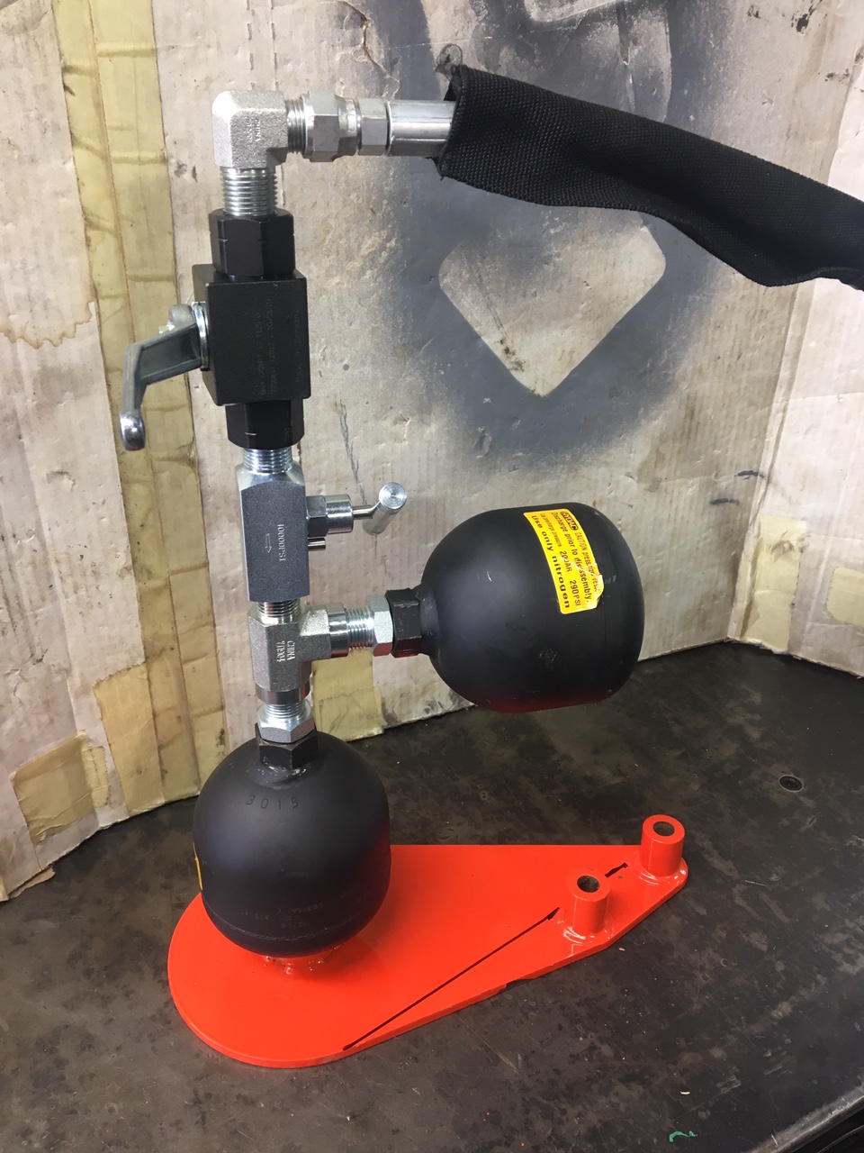

Recently modified a KSR system to fit my M59. Had a lot of lines, double valve and brackets I didn’t use. Tee into the line for right lift cylinder and a ball valve. Really improved the hard shock from the loader.
Planing to do a similar mod on the B26. Being smaller and slower than the M59 not as much need but sure enjoy the improvement in ride. Also should help with component wear.

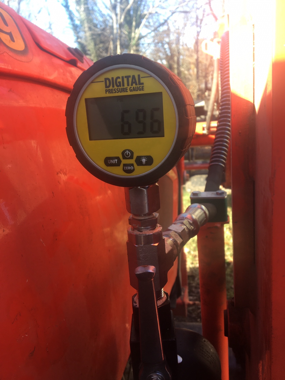

Is there any precaution when digging and maximizing pressure? I installed a gauge and had as high as 4950psi. Haven’t figured out weighing things yet. See the new MF smart loaders do have that feature.
As safety feature installed the accumulators behind a lower window guard on the M59. Thinking that if installed on the B26 the mounting bracket should also provide some operator guarding/shield? Thinking about those 5000psi accumulators being high potential energy hand grenades.
Can you post some pics of your setup?

M59 KSR.
I'm wondering if psi/load relationship is "straight line"? *
This would make weighing simple. That is a nice guage, is that part of this KSR system that you have?
I notice the "zero" button and that would be the key for weighing in my thinking.
*I've noticed that loaders are sometimes rated at various stages of lift. Didn't know if this was a safety rating or a mechanical or geometric change throughout the loaders range of motion that varies.

They have a rubber diaphragm inside, filled with nitrogen on one side. From the other side, oil pushes against it. If you look into the front, you should see a metal plate inside. Once they failed, you can push in that metal plate since the nitrogen is gone.
Those accumulators are not brand specific. But sure can be dangerous since they are pressurized.

I’m certainly no expert. Only know enough to be dangerous at times. Designing, building, modifying multidisciplinary complex systems was my job. Interesting my farming background was more instrumental in getting my career job than my educational degrees.
The gauge was my novel addition. Does show the significant cushioning effect of a accumulator enhanced hydraulic system.
Using a gauge with a grapple to weigh things probably not the best configuration. Aligning center of gravity of the load to a loader point is the key to consistency. Have more homework to do to figure this out. Round bales of hay or buckets of gravel would be easier to figure weight vs pressure. I don’t need the weight scale feature. Just a curiosity at this point.
