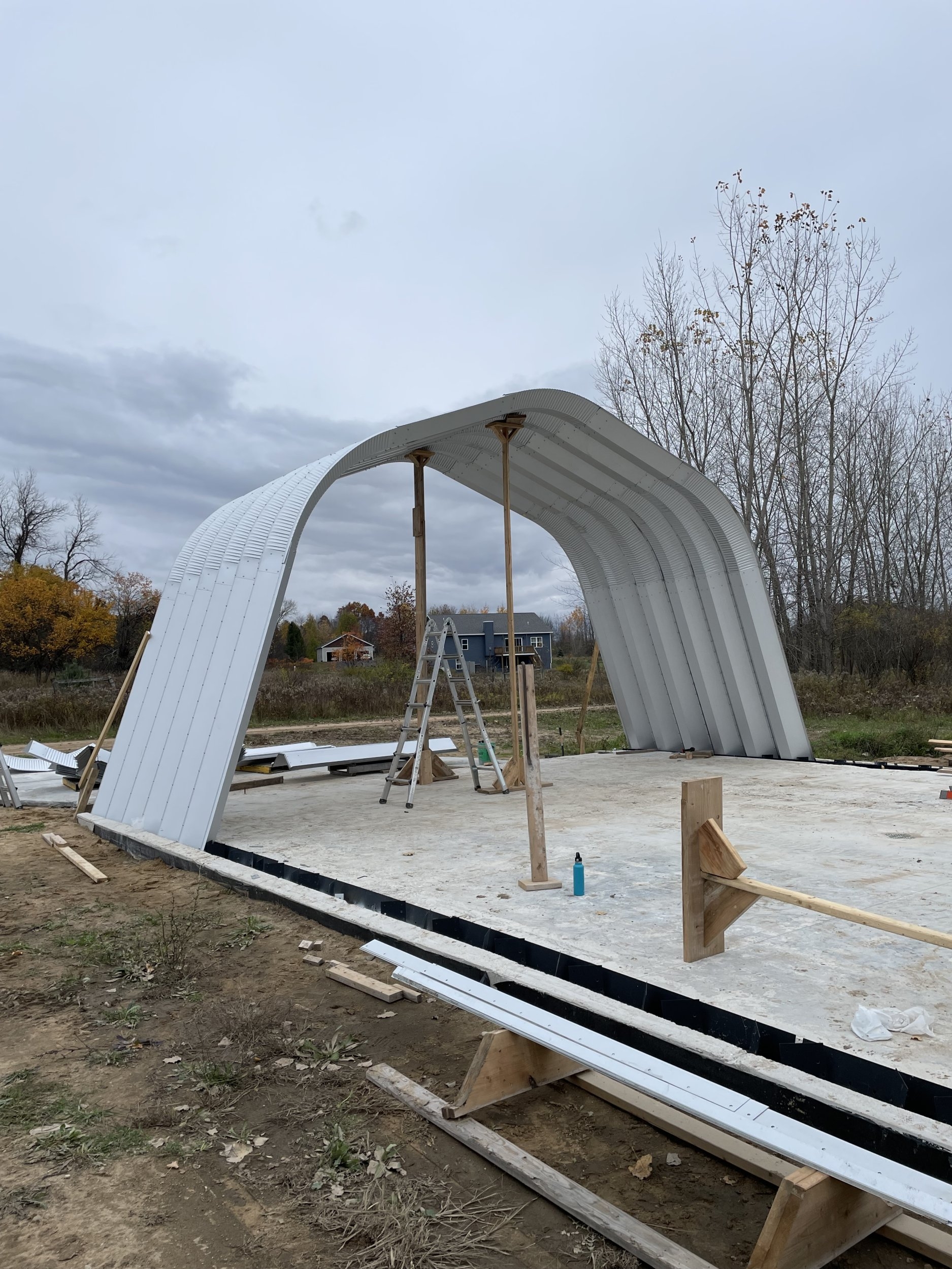

The Xframe is stronger for snow weight. I would not recommend elderly persons do this. The height and weight is a component of concern. I built my own baseplate. I found it very helpful for assembly. I would have bought the baseplate if it were 3k or less. The X frame was more like 7k for 48’ long. I feel that is not right priced.

I have a 25x36 Steelmaster A-model q-hut and has been trouble free and I would do it again. I built a scaffolding on a truck so I could move it and put up each section completed. After you have 3 rings up, it gets way easier because it is self supporting at that point. Having 4 people sure made a difference...maybe 6? The exposed threads on the bolts inside allow all sorts of opportunities to attach shelves, conduit, cord/tool hangers, elec outlets, kayak/bike hangers etc. by using double nuts. You have no gutters to mess with either.

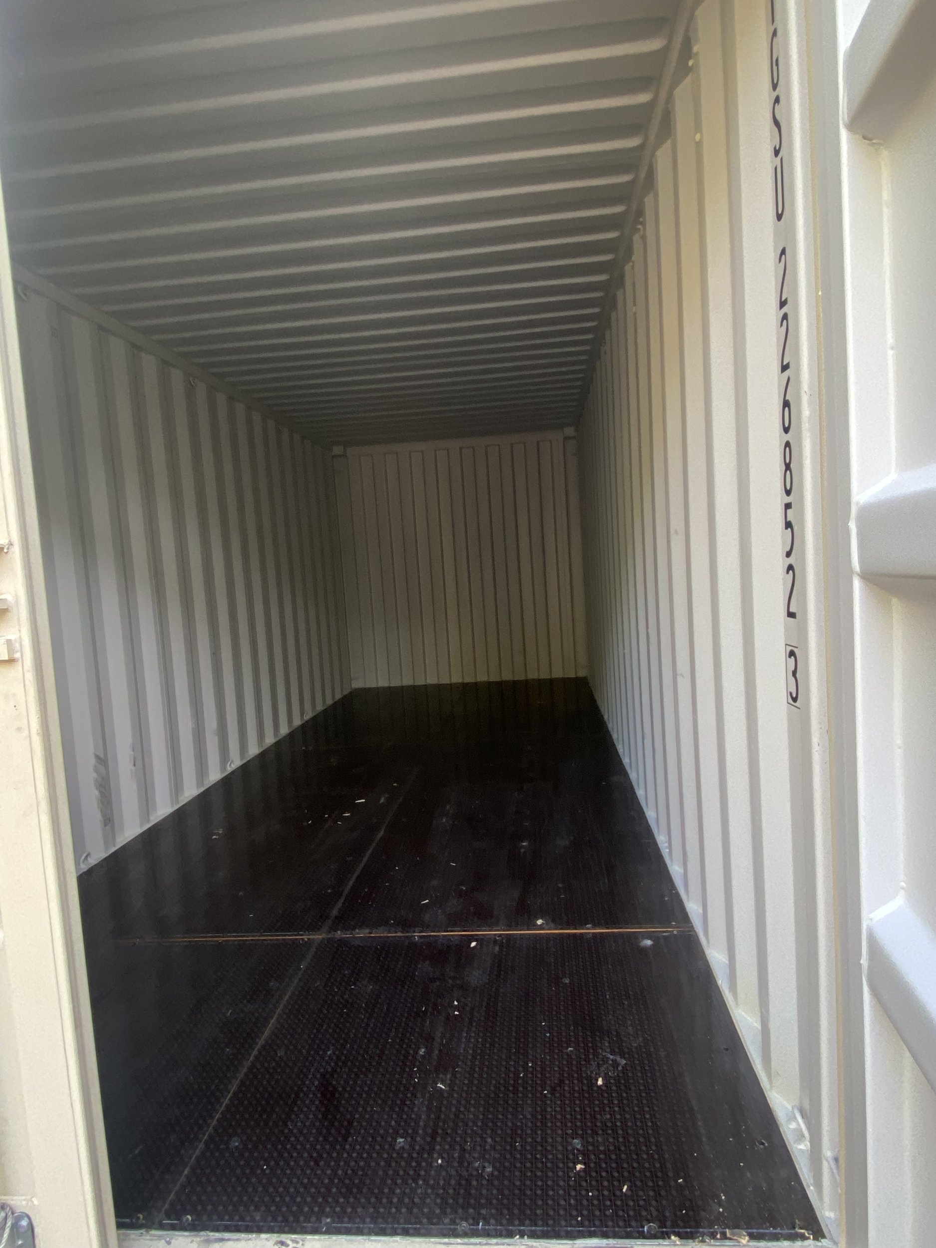

As mentioned, an 8' wide sea container is very difficult to use effectively for anything other than shelving.
Floor items will need to be moved out and in constantly to access stuff beyond it.
   / Quonset Hut vs Conainer #14
I have a 20 ft. container with doors on both ends. Well worth the extra cost. Also - I like that it is literally rodent proof.
