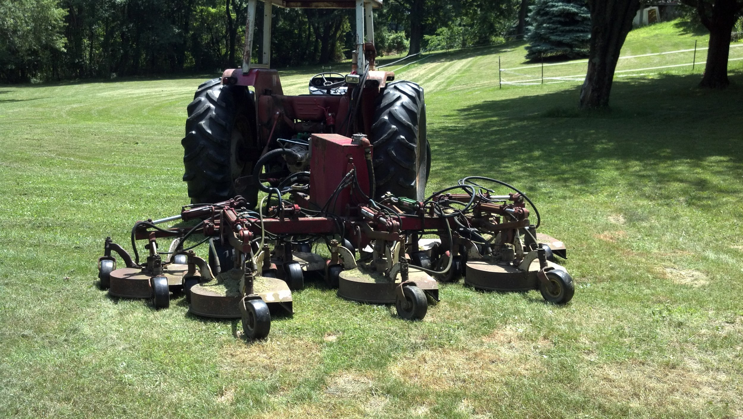

I now run my rears at 12 psi 18 front when mowing and 20/24 with loader and ballast box. Another good indicator you you’re close to proper inflation is to drive on some pavement with wet tires and observe the tread pattern. Thin to high, no middle too low. Or use chalk to draw a line across the tread and see how it wears.

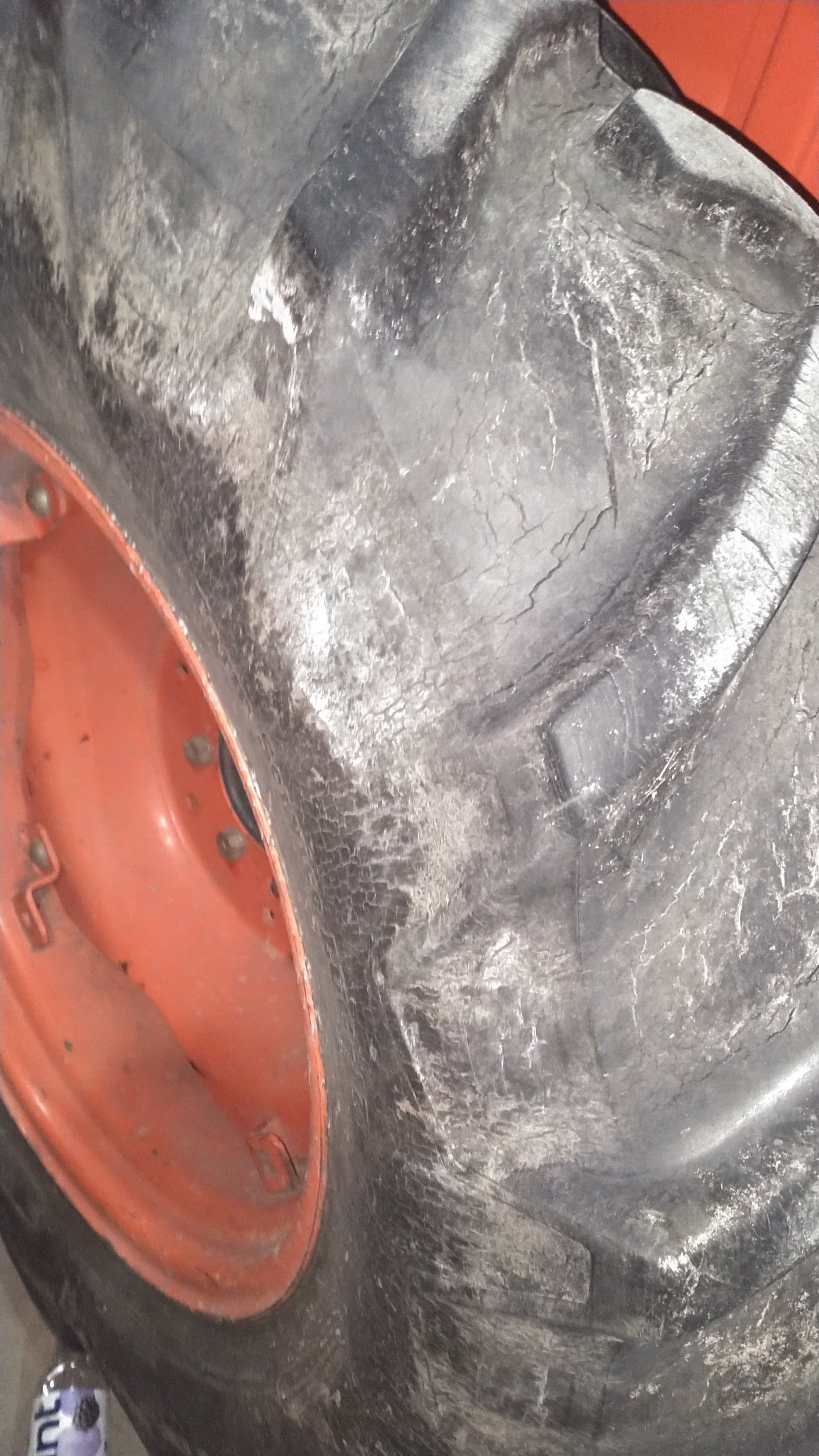

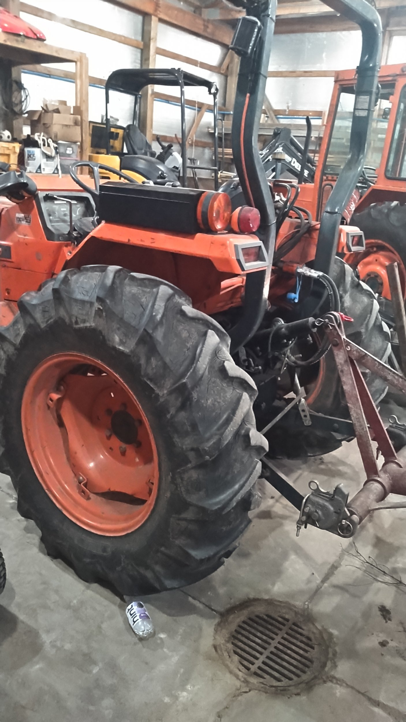

And how old is too old for a tractor tire?
Are my 30+ year old tires too old?
Do I risk death if I still run them this winter plowing snow?
I'm apparently awaiting disaster also. my weather checked tires that still hold air, are so old they were made before the date mandate lol. Unsure if a manufactured date is even required on off road equipment tires perhaps a owner of a newer tractor can chime in?

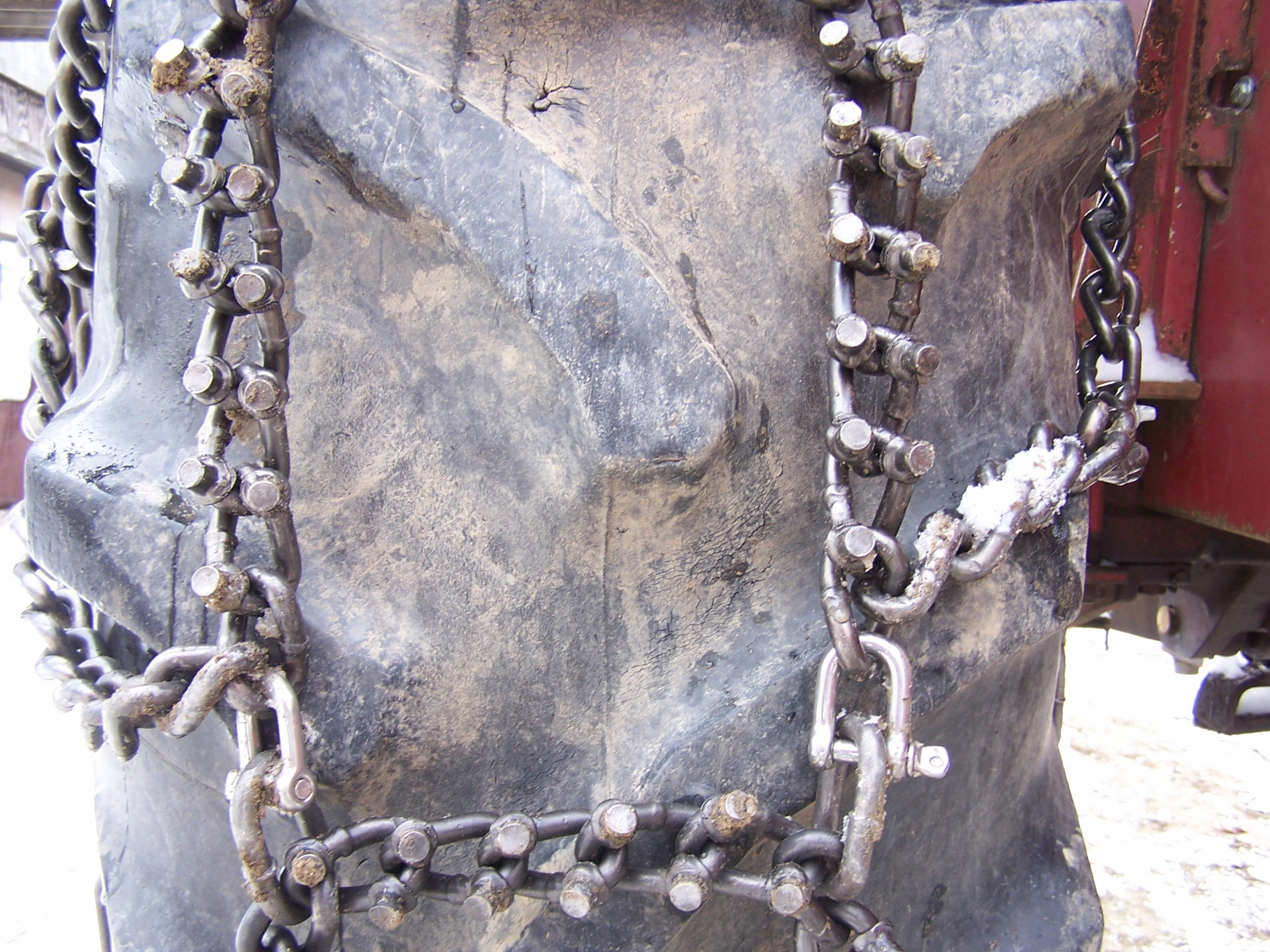

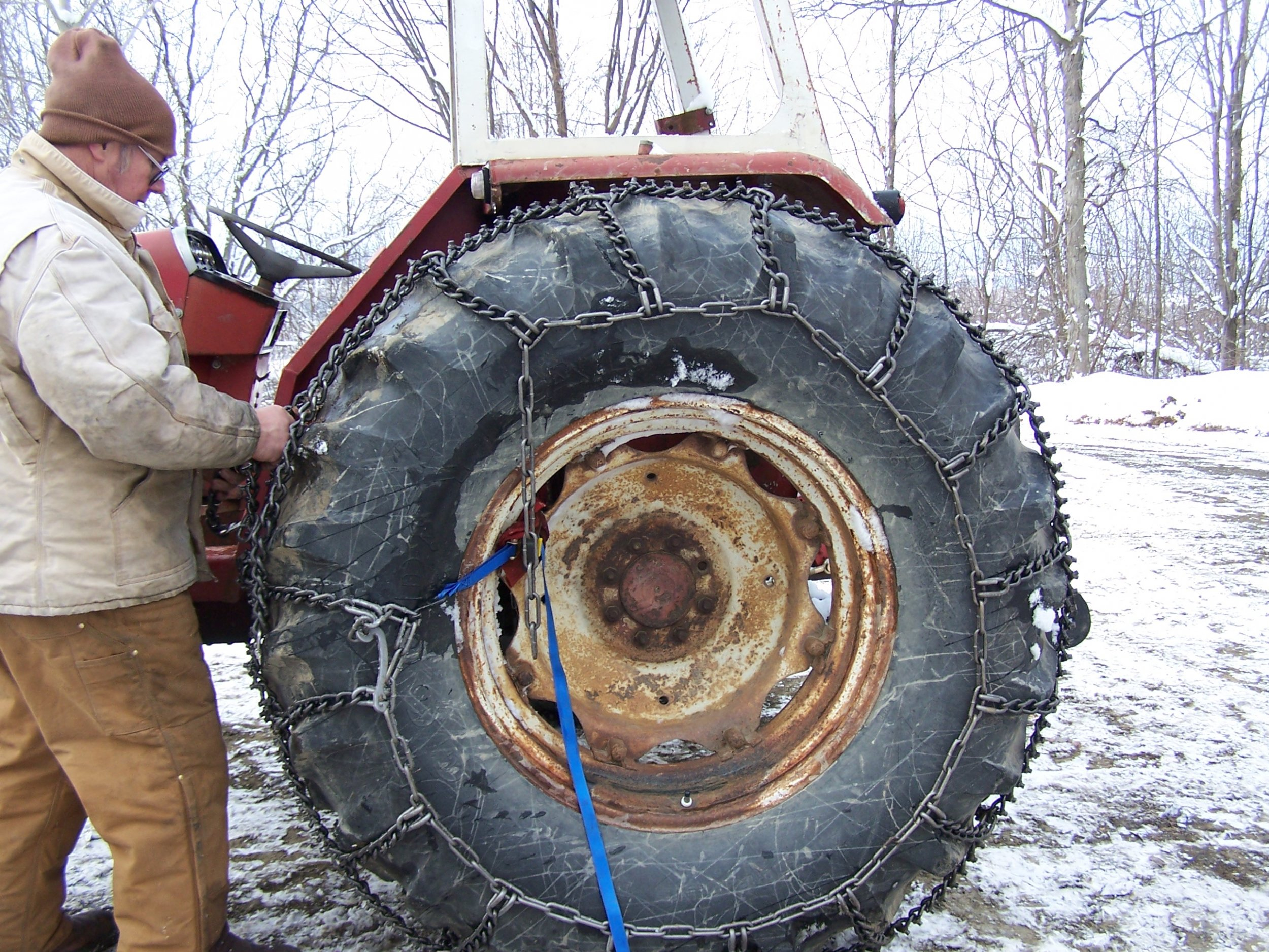

Putting chains on some well worn tires several years ago (10-15 or so).
Still running the same tires and chains.
Absolutely no idea how old these tires are, they were old when I bought the tractor.
there is a boot inside that tire were the puncture was,
well used and worn but still work great with chains, also nor bad on the lawn when I used to mow the lawn with this tractor
   / R14 tire pressure... have you read the sidewall? #44
