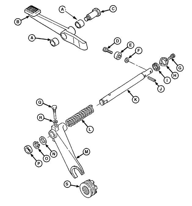

   / R4344 - split brakes and traction lock #13
simonsben said:
i am starting to disagree now that it is displaying a noise that is not melodious but more metalic/gear grind with the lock in the fully up position.
I am not an expert here, especially in Montanas, but I am inclined to agree with you. It sounds like the grinding might be the teeth on the differential lock collar almost but not quite engaging.
A diff lock is a fairly simple device. It is just a pedal (B) that moves a fork (M) to slide a splined collar (S) across the differential carrier to lock the two axle shafts together. Here is a diagram of mine.
I'm still going with the mis-adjusted or unlubricated linkage. It sounds to me like your lever is just sticky. Can you disconnect the linkage right before it goes into the differentail housing and at least make sure all of the external stuff moves freely?
Unless you're a rather stout fella literally jumping up and down on the pedal, I doubt you've done any damage.

When engaging your diff lock try driving forward slowly in a slight turn (if stuck then spin one wheel slowly). The splines have to be aligned to engage, chances are that if you are stopped the splines don't line up and stomping on the pedal doesn't help. To disengage, drive forward and turn side to side; if the axles are under load (wheels torqued in opposite directions) the lock will not disengage easily. When you steer to alternate sides the lock should disengage easily.
