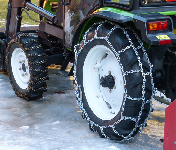

The REAL purpose of leaving chains slack, or "floating", is to enable them to self clear.
It has nothing to do with hoping that an imaginary loop will somehow jump out of the gap between lugs and magically find a lug peak to rest on for a few degrees of tire rotation.
From what I was explained so is the floating property of chains to distribute tire wear evenly as this avoids the chain to rub constantly in the same places. That kind of wear would no doubt have been a problem in countries where chains are used on tractors all winter.

I don't have a lab environment in which I can experiment by changing ONLY ONE variable at a time.
The switch between R4s and R3s is ALSO between ballasted and empty and between chains that stay on the tire surface or drop into the gaps between lugs.
In both cases I have left them free to self clean, the R3s become no better than the R4s in deep snow if tightened, they just load up - as expected.
ALL THAT combined the R3s with chains give better traction than the R4s with chains AND 1100 of fluid - I attribute that to the fact that they stay ON the tread and that advantage outweighs the 1100 lbs of additional wheel weight.
Before ballasting the R4s I had noticed that the R3s were a bit better on ice without chains.
Sure, they load up sooner in snow, but on ice their additional edges help.
Tread EDGES are what initially "bite" - however weakly the more the better, this is why siping works, to some degree.
Yeah this is apples vs oranges, but I have somewhat separate uses for both apples and for oranges.
Bottom line; R3s with slack chains beat the other alternatives I have available to me.
I don't have to hope for a thing. What is "real" is what works. Loose chain on certain lugged tires has been a game changer as it relates to traction for many here as opposed when they have been tightly snugged. As far as a "few degrees" is concerned, apparently "a few degrees" is all it takes making the difference between spinning and traction. As I look back on the ice I've traveled on, I'll remember that I am just "imagining" all the bite marks I see.
