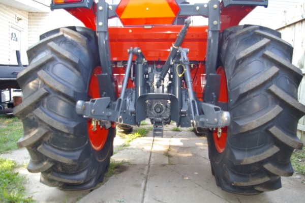

   / R4's are USELESS! #115
I had to get r1's on mine due to the slope and wet conditions. I have a 3130 but put wheels and tires on from the dealer from a 3830 when I purchased new. I feel they actually give me the floatation on lawns etc in 2 wd and really have the bite in Mud and on slopes in 4WD. Everyone has different needs and this works for me.
   / R4's are USELESS! #116
Yeah, R1s for me too. It would be nice to be able to always havethe right tire for the job, but for traction and wide ranging competence Ill put up with the marks they make until they develop a tire with morphing tread.
I guess youve lowered the tire pressure since that pic was taken.
larry
   / R4's are USELESS! #117
Never touched the tire pressure. I'm usually on slopes and in mud. They work great..
