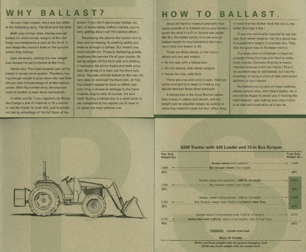

dynasim said:
I have to put it in full time fwd when I do FEL work with heavy dirt, though, as the back end loses power.
Chris
Hi Chris: If your rear wheels are slipping more than 15% when you use your FEL that means that you have almost all the weight transfered to the front axle. Look at your users manual and see how much weight your front axle can take. I am sure that it wasn't meant for that much weight. Also almost all your stability comes from the rear axle. Your front axle can pivot and allow the tractor to roll over when your tractor is balanced on the front axle. To transfer weight from your front axle to your rear wheels you must put weight behind the rear wheels. Loading the tires or adding weight to the rear tires only adds weight to the rear tires it does not transfer weight off the front. Think of a teter-toter. If you put weight on the pivot nothing is changed on the seats. If you put equal weight on the seats the teter-toter will balance. In this case the rear axle is the pivot point but we want about 45-50% of the weight to remain on the front axle.
John Deere Ballast Handout Scan I hope this scan is readable.
Marshall
