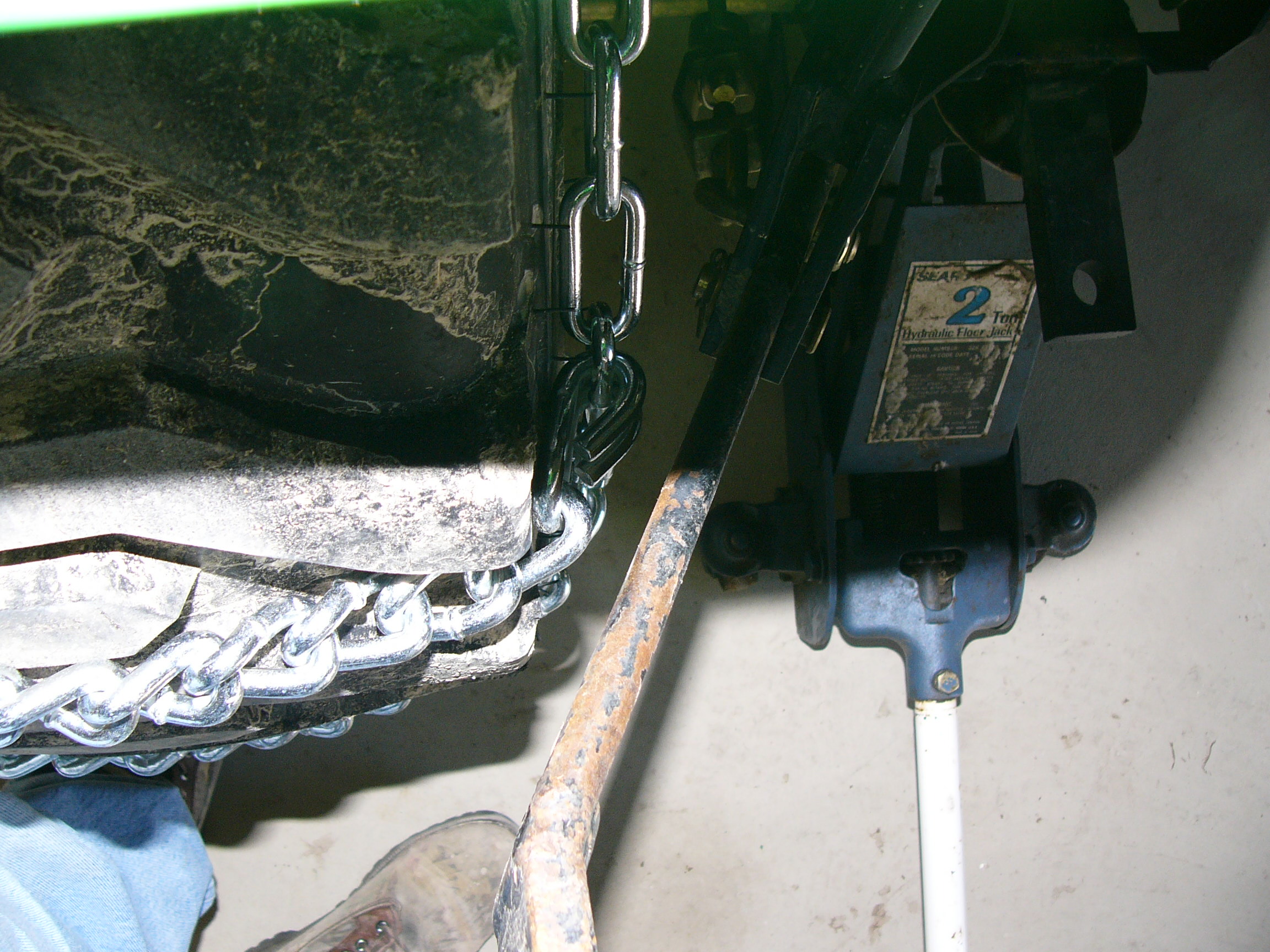

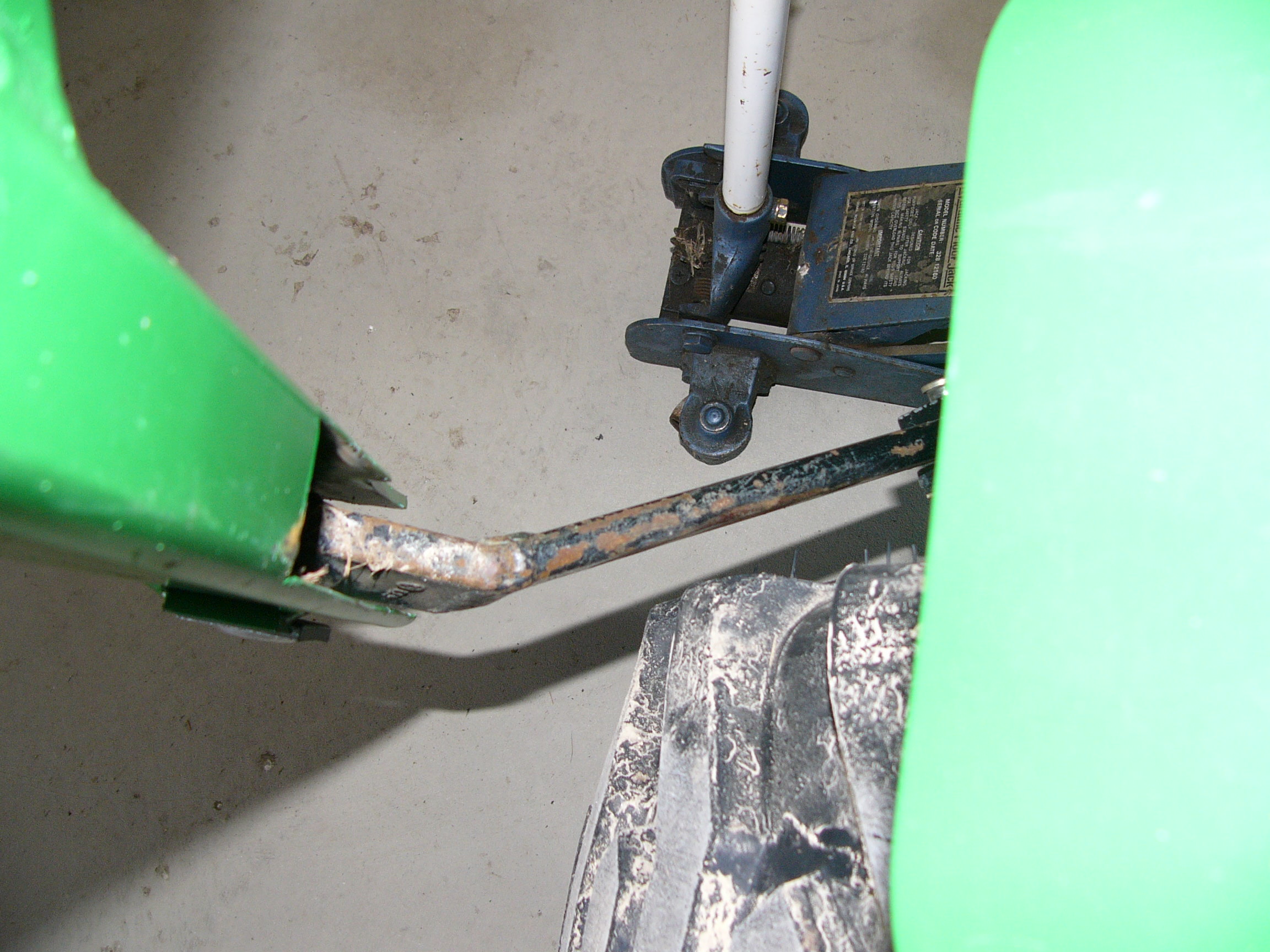

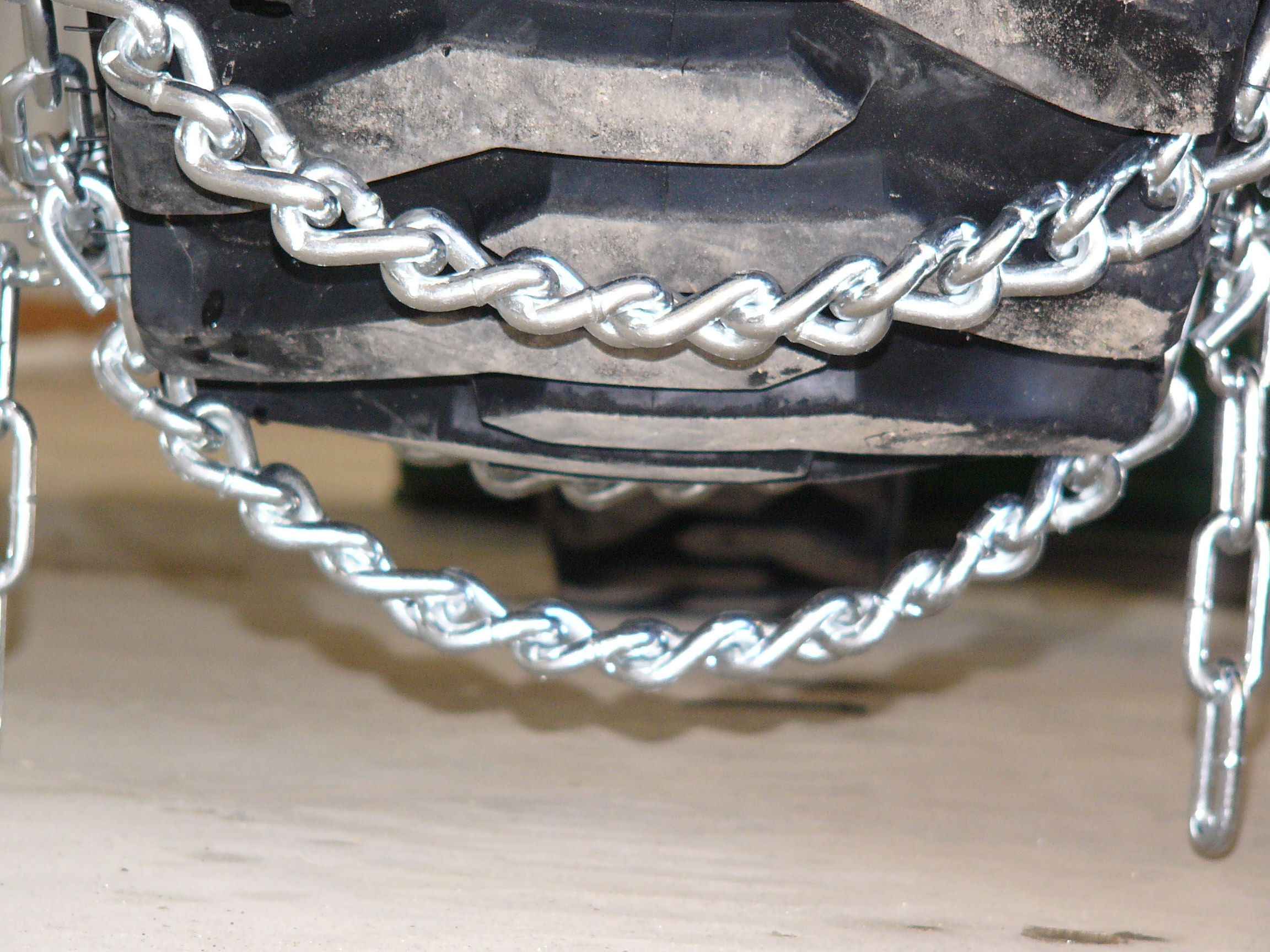

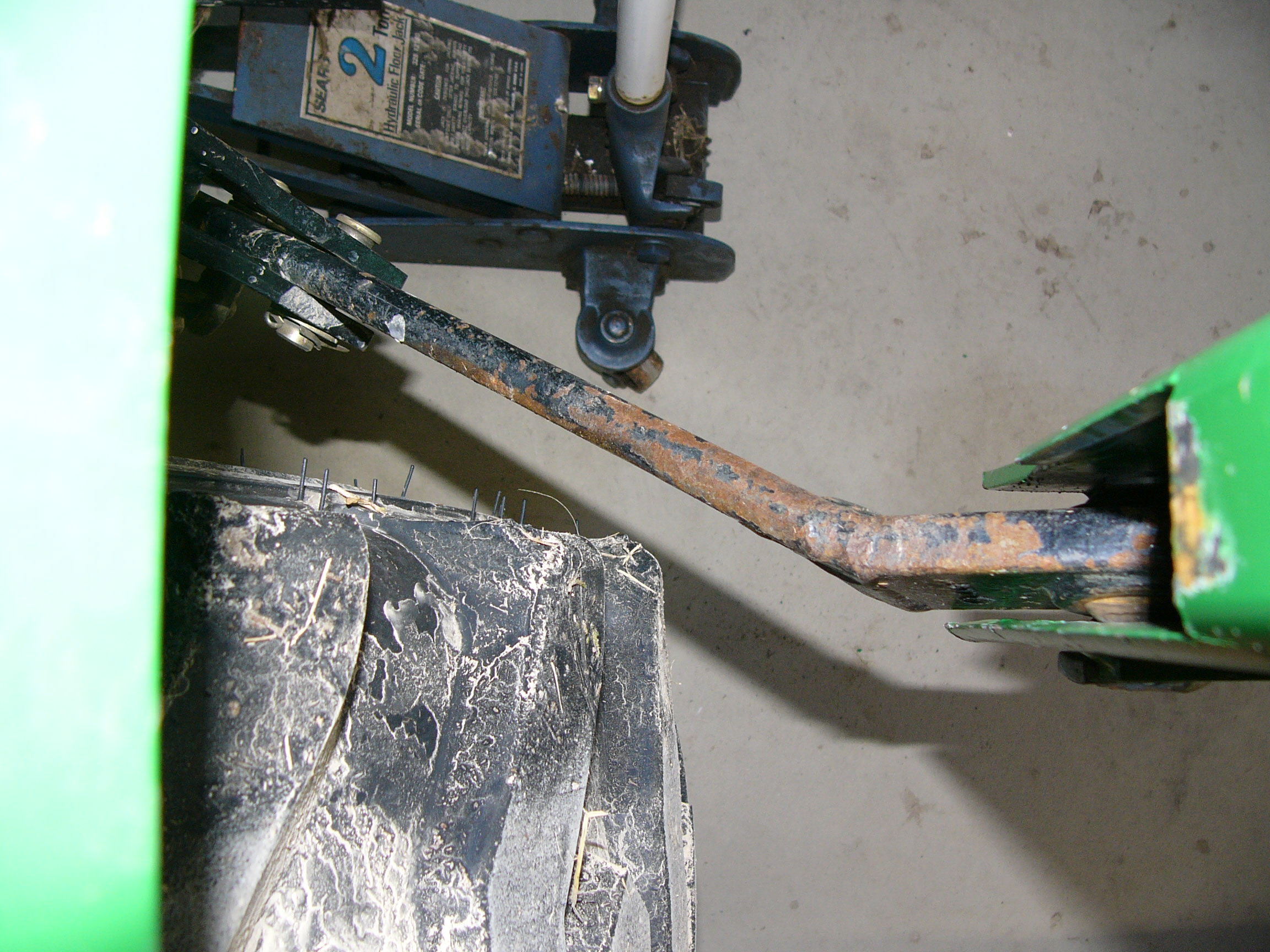

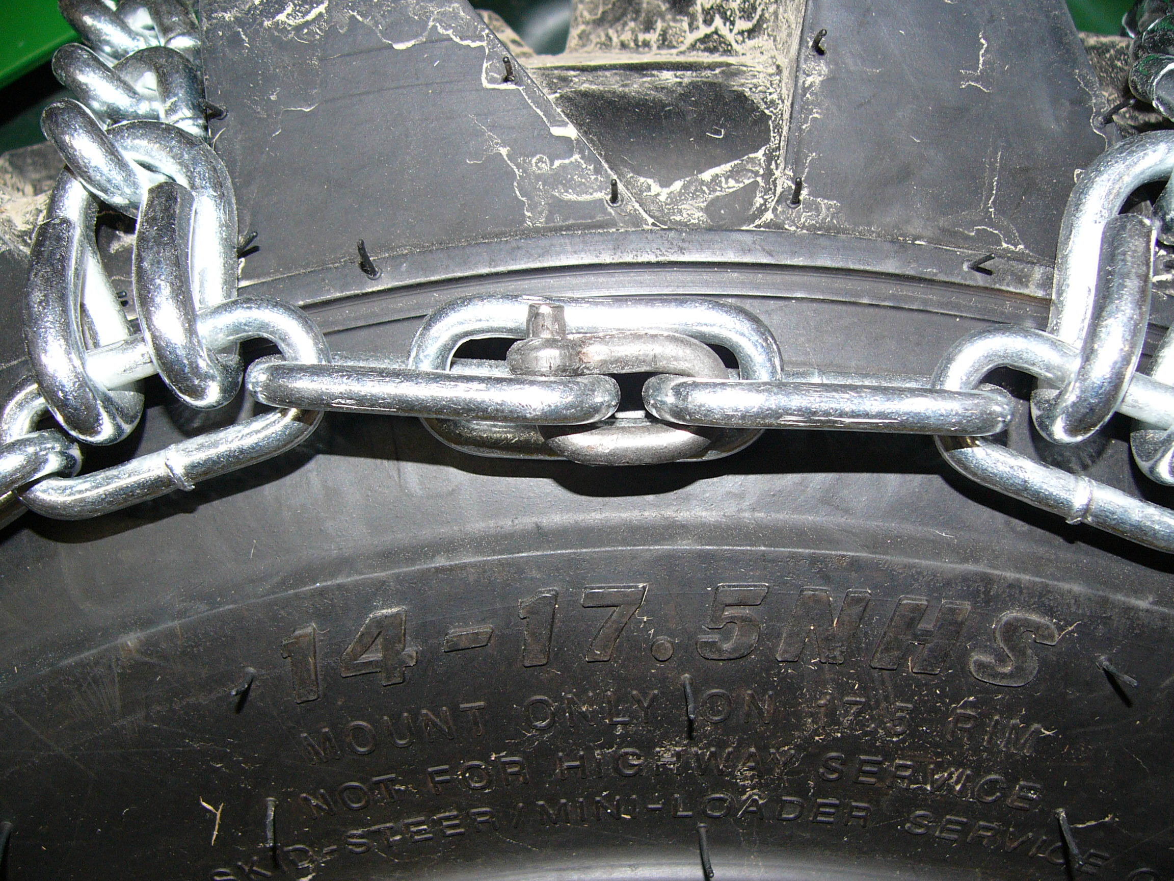

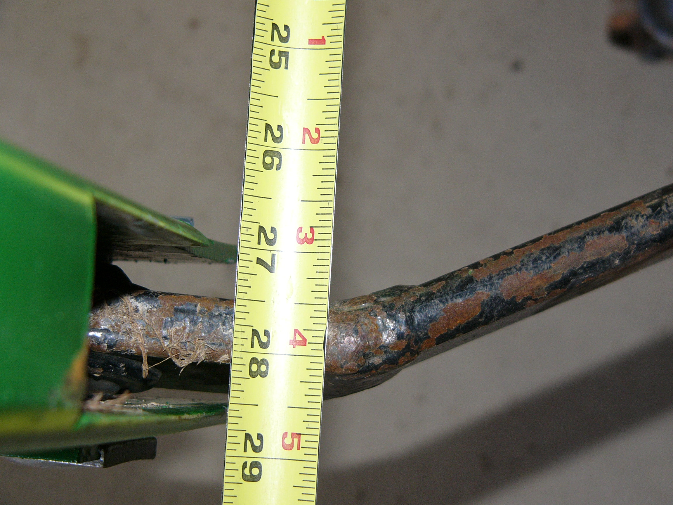

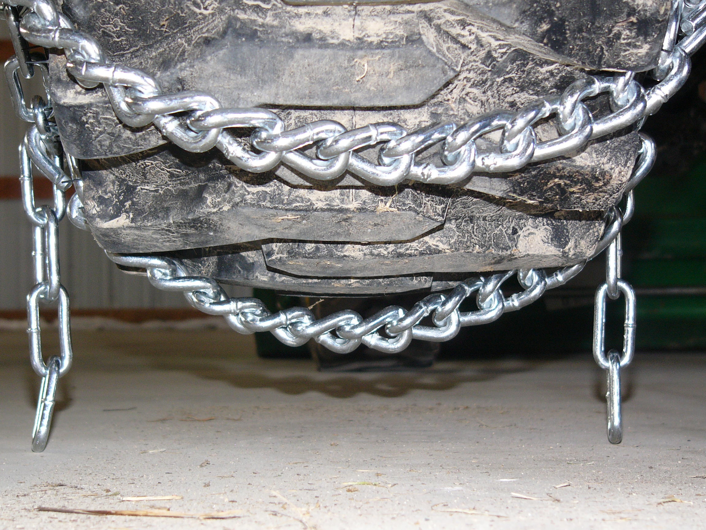

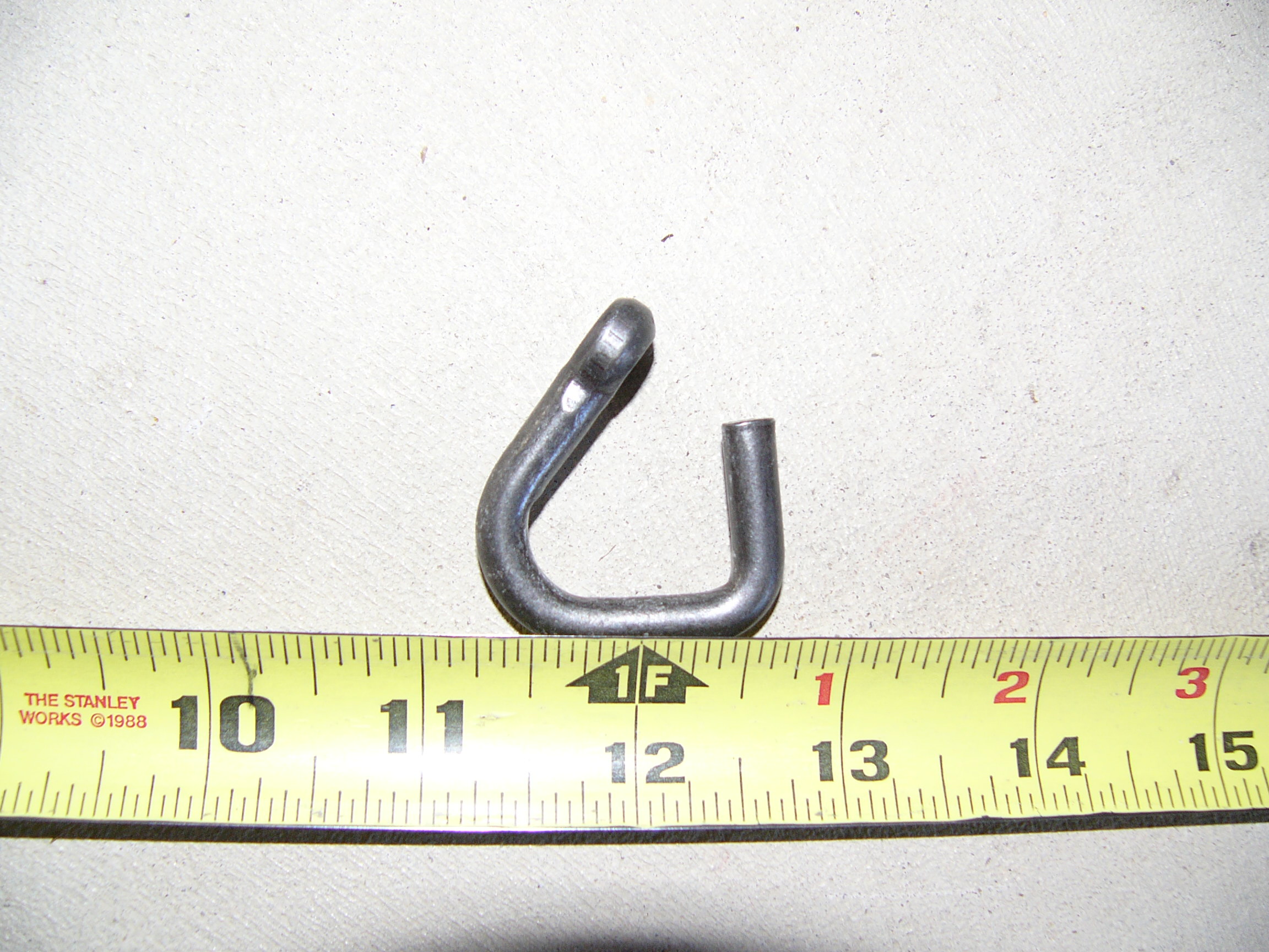

Deadman,
You asked the dimension inside of my 3pt arms with the I-Match on and what kind of clearance I had with chains on. I installed a "cold shut" in my new chains and put them on the tractor, decided to install a second one in each side to tighten them even more. I measured the clearance and it is close to one inch between the tire edge and the arm. You have to remember that our tires are not turning at the rpm's that you will see on an ATV or car.
I have photos of chain slack before installing "cold shut" and after, also the clearance between my 3pt arms.

THANKS, thats WAY more clearance with the I match. I'll be looing for an I Match right away. Any suggestions of which one to get? I'm leaning twords the Deere one.
The pics are great, thanks again! :D

Oh, 1 more question......In those pics were the 3pt arms UP or Down? They look like they were down, but just wanted to be sure because the measurements change as the arms raise! :cool:
   / R4's are USELESS! #98
The photos were taken with the arms all the way up....
