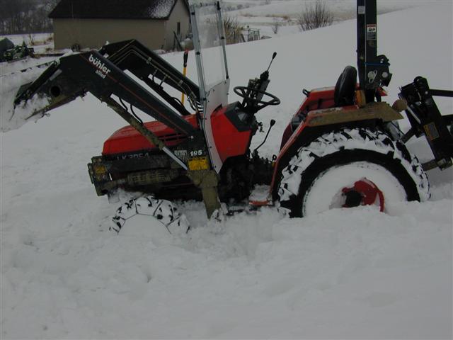

I still get stuck with R1's.
   / R4's are USELESS!
#75
I'd hope you get stuck in that deep of snow. My R4's would never even get out of the garage if there was that much snow. :mad:

I have never had problems in snow with my R4's!!! I don't know what you guys are doing to lose traction, but with the bucket down and 2' of snow on my driveway I drive 300' to the road and never miss a beat. Only time I've lost traction is on ice and even then I just raise the bucket a few inches and do two passes...no problems, all done in medium gear. Sounds like you guys need some more weight!! The weight of my BH is a obvious factor.
   / R4's are USELESS! #78
Weight and chains will help a lot on the R4's. Even R1's, in very wet and sloppy mud, will dig in and get really stuck, in deep snow they will get stuck (check out Jim's photo). And then there is mowing a lawn with R1's, that's a whole other debate. Some will swear they do no more damage than Turf's and others will swear that you will totally rip your yard to shreds...........
Has anyone missed anything regarding the R4's v. R1's debate?:confused:
