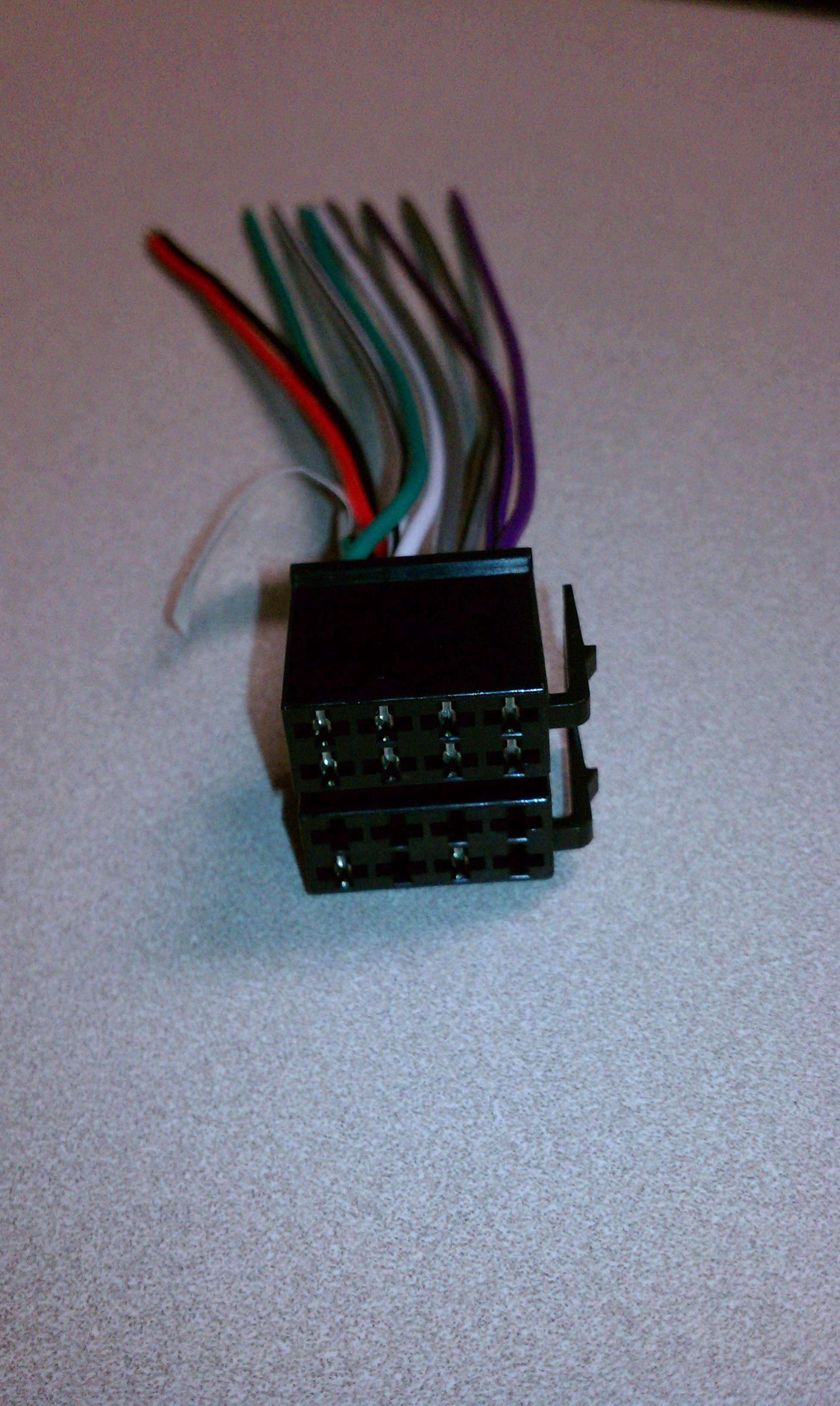

Hey Guys I stopped at the JD dealer and they sold me this wiring harness (see picture)
They could not give me a diagram for which wires does what. I picked up a cheap stereo deck and i see there is a yellow power feed wire that the harness does not have is there another lose cable up there i didnt notice for the power?
Thanks

If they wouldn't give you a diagram then I would take it back and tell them to keep it. That's BS.
It is possible that not every wire color would match. Easiest thing to do is to take a volt meter or test light and see which wires are hot.
However that only helps for power. You really don't want to connect the speakers up backwards.
The other option would be to find a plug from someone else and download the instructions for the harness. The wire layout should be the same.

It's not they wont the parts guy couldnt find anything sorry i worded that poorly.
and to top it off the wiring harness they gave me is the wrong one. that plug i have in that picture is the plug thats already pre wired into the cab. what i need is its female counterpart not the male with the lose wires.
If anyone knows of a PDF that shows those wires and what each color meants it would be a huge help.
I cant be the first guy to install a basic radio deck into one of these cabs :)
Thanks :)

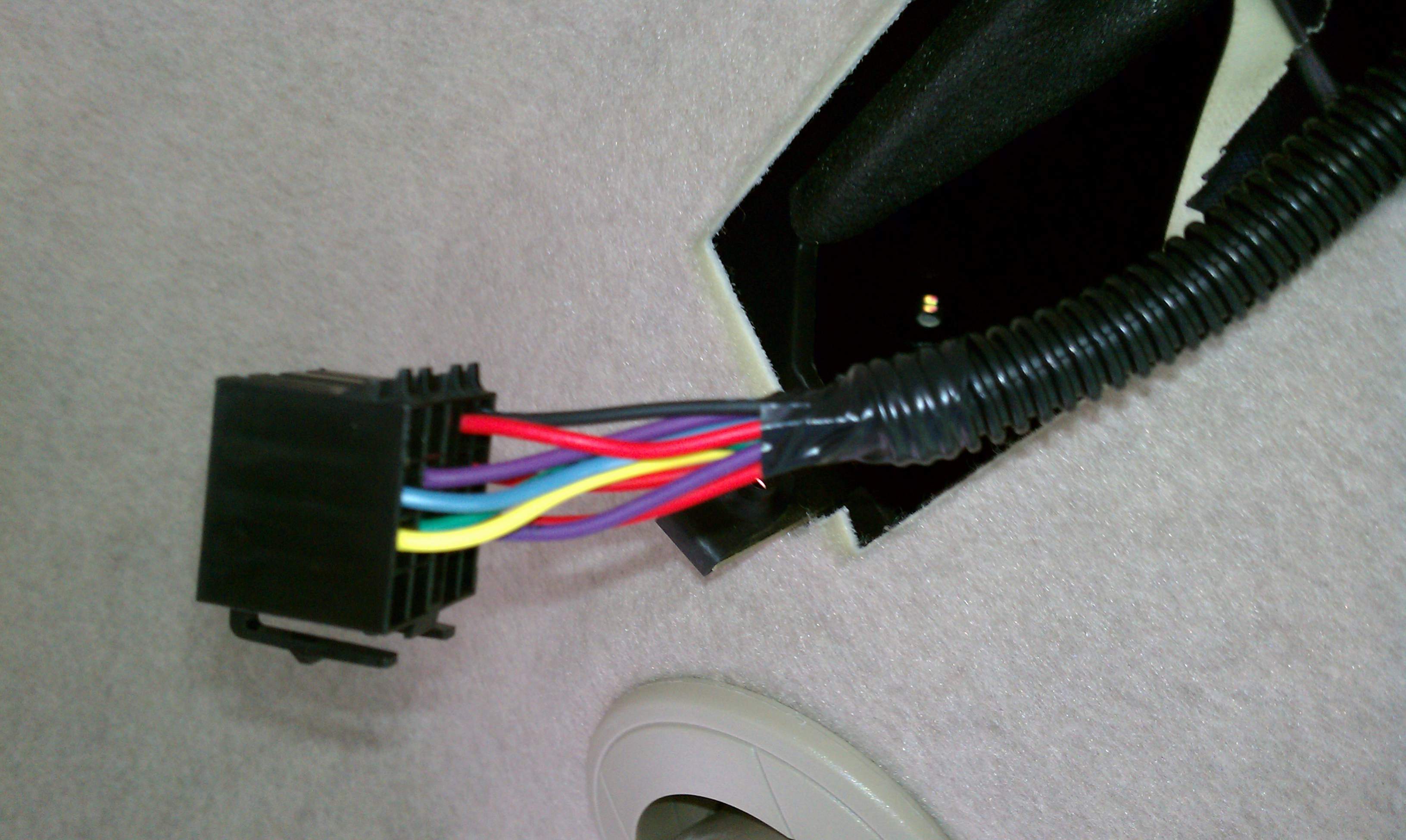

It looks like it uses a Vdub plug.
I pulled the wire out of the radio insert and also the antenna plug everything is there.
However look at the picture of the plugharnes.jpg that seems like WAY too few wires for 4 speakers doesnt it?

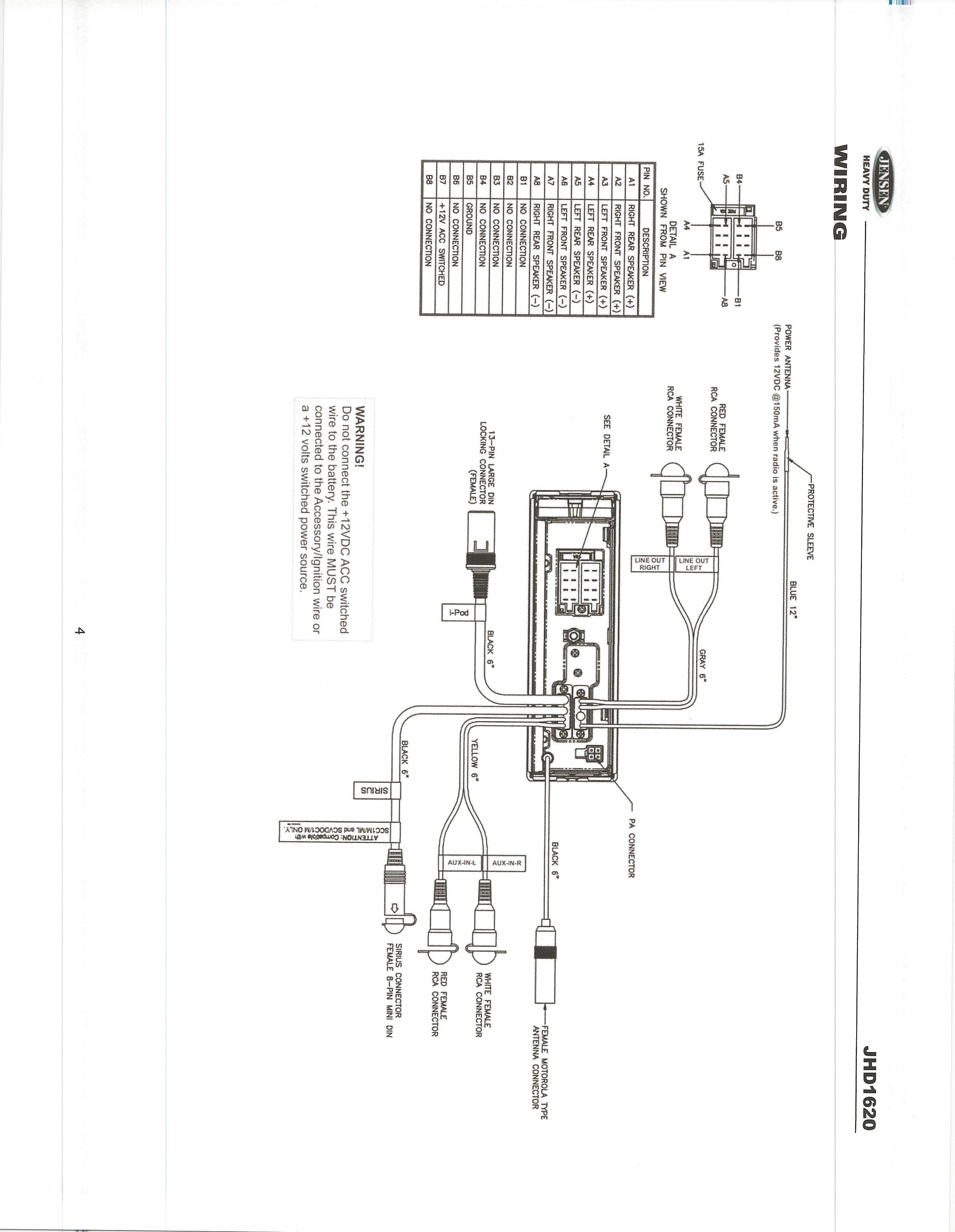

Attached you will find a page I scanned out of my radio manual. For you the radio isn't important here. But it does show the pinouts and caution for the factory wiring harness in the headliner. Another thing I like about this Jensen radio is the iPod connector and interface on this radio. It lets me fully control my iPhone, mutes when a call comes in, etc. via the radio.

Thanks for that. crazy thing is those pin outs do not match mine at all.
A4 is my ground A2 and A3 are the power. Here is where i really get confused B2 B3 B6 B7 seem to be speakers i can get them to crackle is i hook the speaker wires to them. But there dont seem to be enough wires for rear speakers. is it common they would only come with front speakers.
I have a total of 9 wires 1 ground 2 for power 4 that seem make the front speakers work than one other i havent figured out it's roll yet.
This one takes the cake as one confusing install. not figuring out which is + and which is - on the speakers could prove to be interesting.
/ Radio Install 3320 need help. #12
The cab only has two speakers in it from the factory. You can go to JDParts.com and get the breakouts and diagrams that will show were they are. You would have to add another pair of speakers to get four.

Take a 9 volt battery to both wires for the speaker, if the woofer pops forward, then you have the neg and pos correct, if it sucks in, you have them backwards.
/ Radio Install 3320 need help. #15
The wiring harness that you needed was the same one that is used for a VW car. Not exactly sure why JD used that, but they did. I took a pic of the plug and took it to Best Buy and the guy new exactly what it was and got me the adapter with the wiring diagram on the package. Crimped the wires from the radio harness to the adapter and it was plug and play. Didn't cut a wire.
