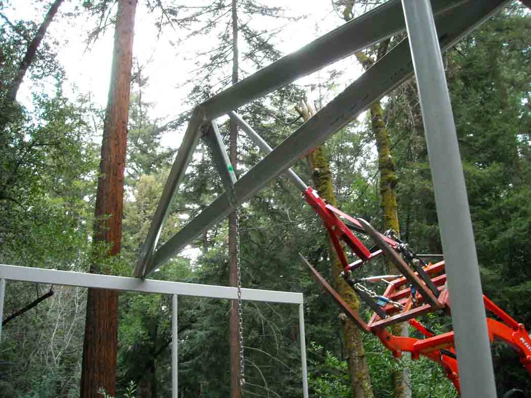

Hiya,
Looking for information/feedback.
Finally, I am going to build the workshop.
I am looking at having a 16 ft span on on a simple shed roof with a 2/12 pitch.
I am in Central texas, so there is no snow load.
I am trying to decide on the size of the rafters and spacing and I am looking for feedback from people who have experience with their buildings.
Depending on the tables, I look at, I can do 2x8, 2x10 or 2x12. My preference would be to stay at 24 oc, but I am willing to drop to 16 oc to add strength and drop to 2x8s (general easy of handling).
Any feedback would be appreciated.
Thanks
Although I'd probably use trusses (cheaper,faster,lighter) Here's some SSL data:
I assume you would mostly have SYP in your local
LL=20
DL=10
limited to L/180 (no ceiling attached)
#2 2x8@24"oc will span 15'-10" (This will be work since you will most likely be less than that inside of plate to inside of plate.)

USTMD, here I am setting my homemade steel trusses for my "tractor port".
With my boom pole, I can set these without any helper, which is nice.
I don't know if you consider cost, but each of my trusses is about $50
in materials, and can be lifted (if you have to) by one person. I do not.
You should be able to do better in TX. All manufacturers have span
tables to consult. I have a 17' span, and a 4/12 pitch. Spacing is 24"
OC, except for the outer 2 trusses.
I doubt that you can do better with pre-built engineered trusses-wood
or steel.
