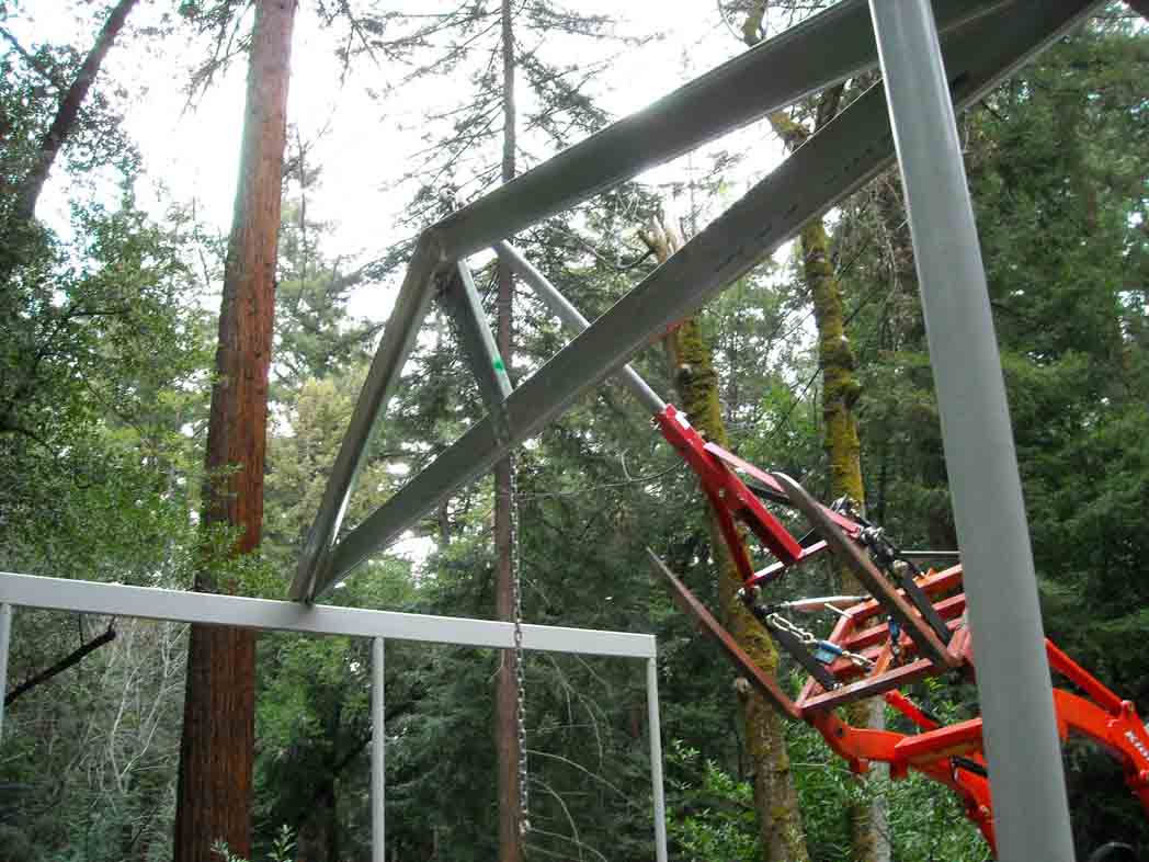

Don't forget light guage galvanized steel rafters, cut to order. I just
bought 18-ft 2x8x16ga for $22 each. They are very stiff, perfectly
straight, and cut to exactly 18.00' long. Impervious to the weather, too.
This is for my 17'x19' building. I will make trusses and go with a 4:12
pitch steel roof.

Don't disregard engineered trusses just because you're not in the trade.
Search for truss manufacturing companies (google or yellow pages) near you.
I got the trusses for my 24' x 24' studio building from a truss manufacturer. Cost was less than what stick-built would have been because they can engineer a solution to use smaller lumber than you will have to use for non-engineered stick-built.
