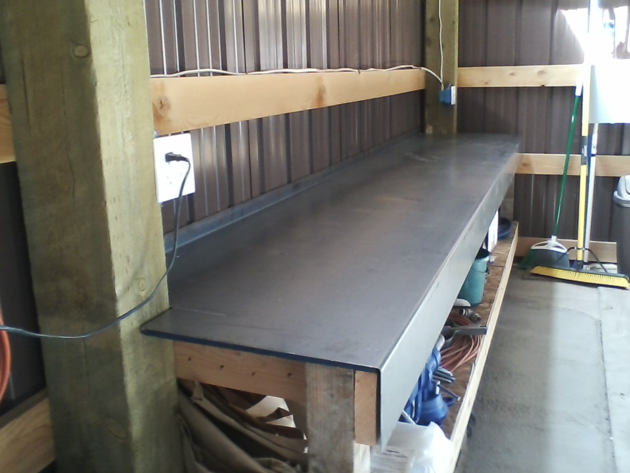

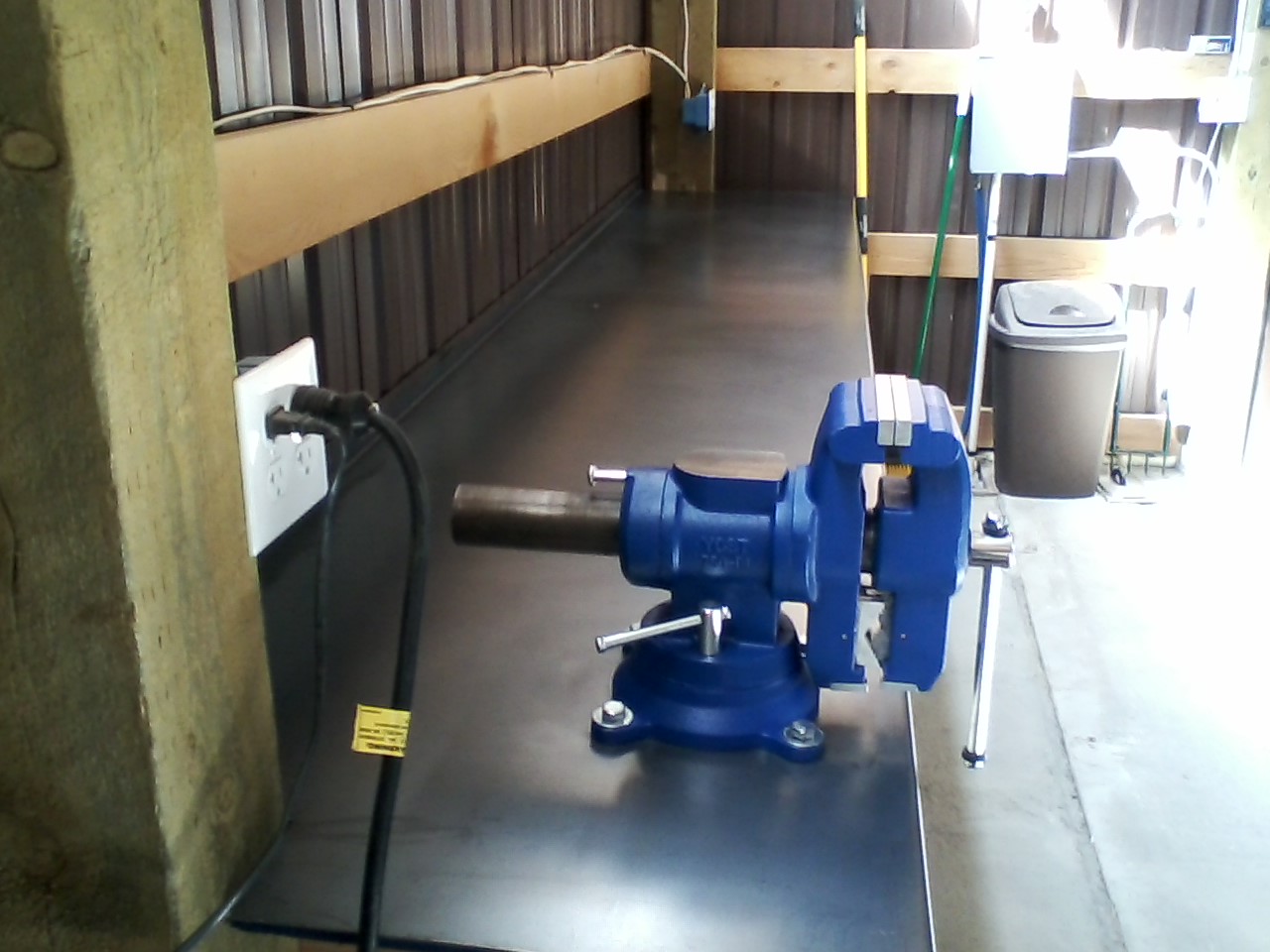

I got my metal top done and installed. It is so nice having everything coming together.
I can start moving some tools in now.

Thanks.
The metal is only 1/8" with 7/16" OSB under it. It is nice and solid though.

Really nice. My buddy just did one and he welded a piece of 1" angle iron around the perimeter with the V pointed up just like a "V" trough flush with the top surface. He welded all around the edge and ground the welds smooth. Now, if he's rebuilding an engine or transaxle, he figures his "V" will hold a quart or 2 before it spills on the floor. Also, if a ball bearing or something rolls it won't fall to the floor.
I like to mount my vise' near the corner of the table, giving 270 degrees of access.
