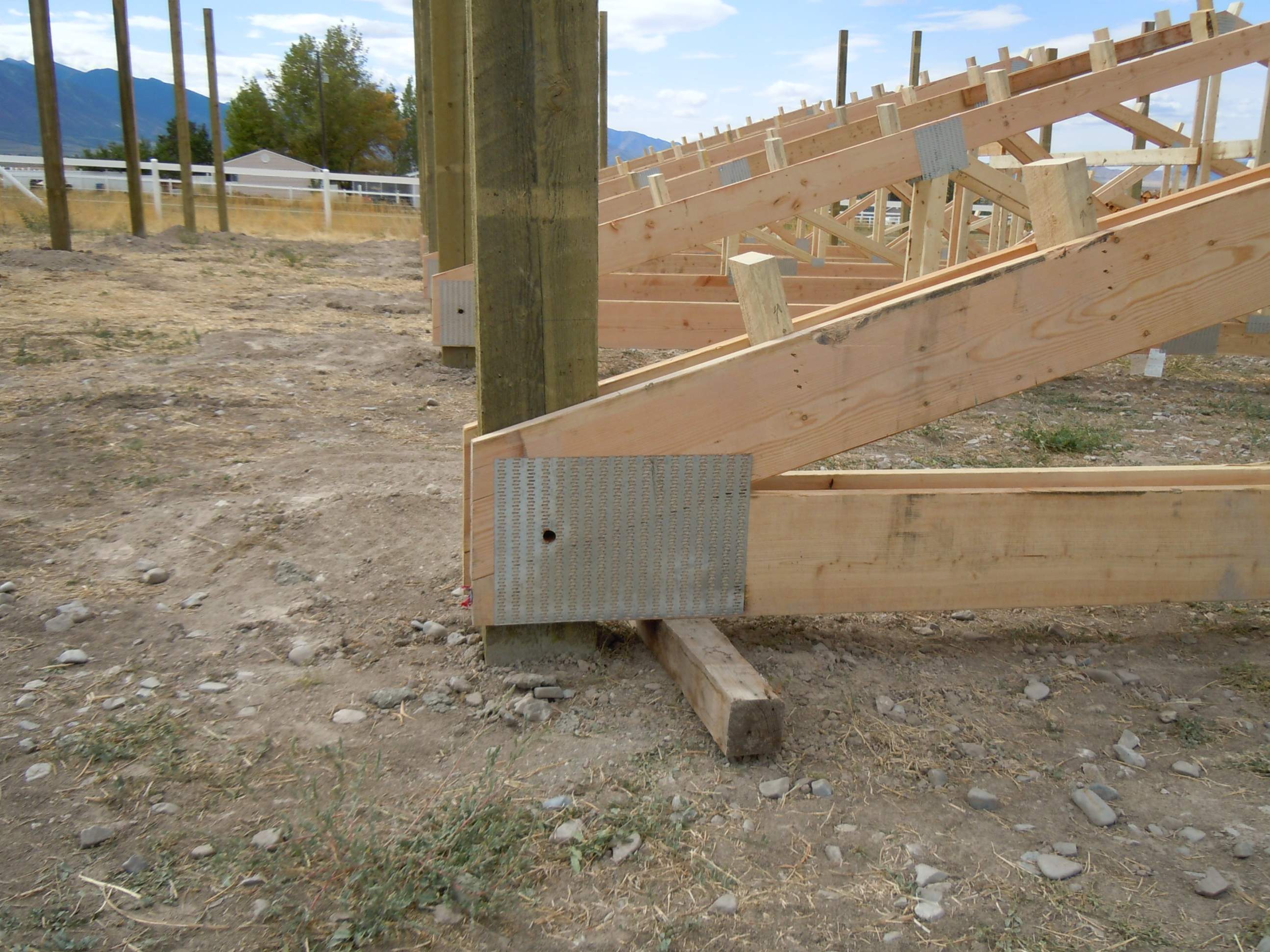

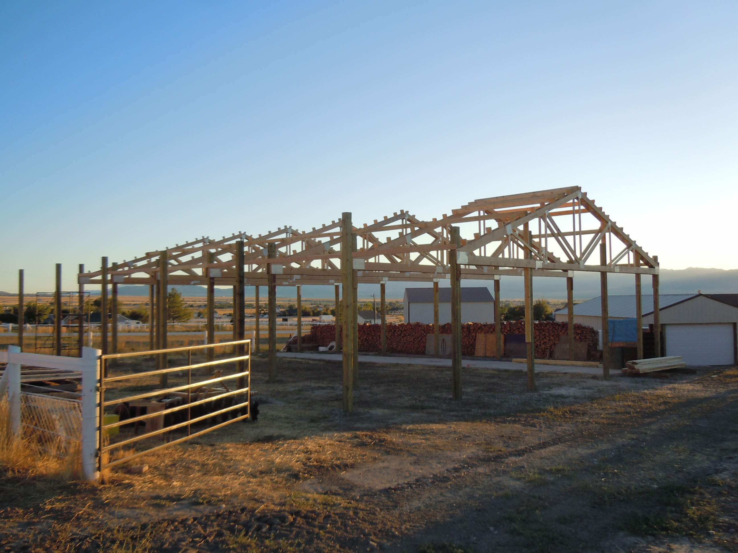

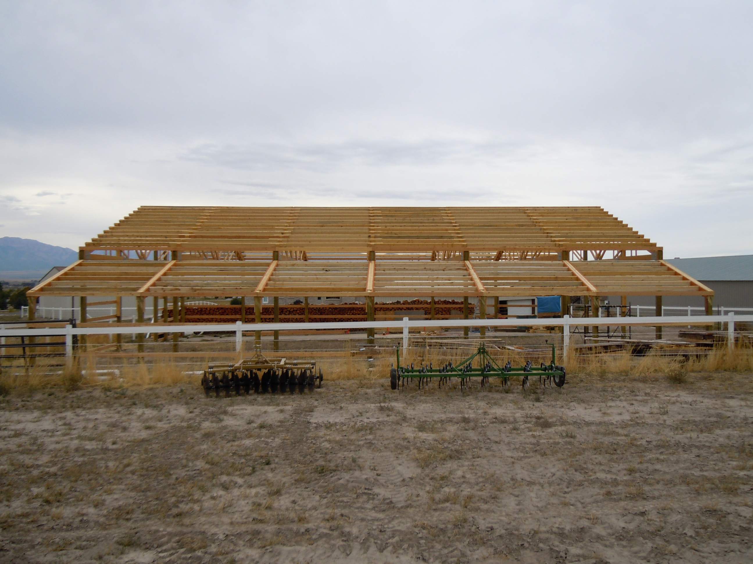

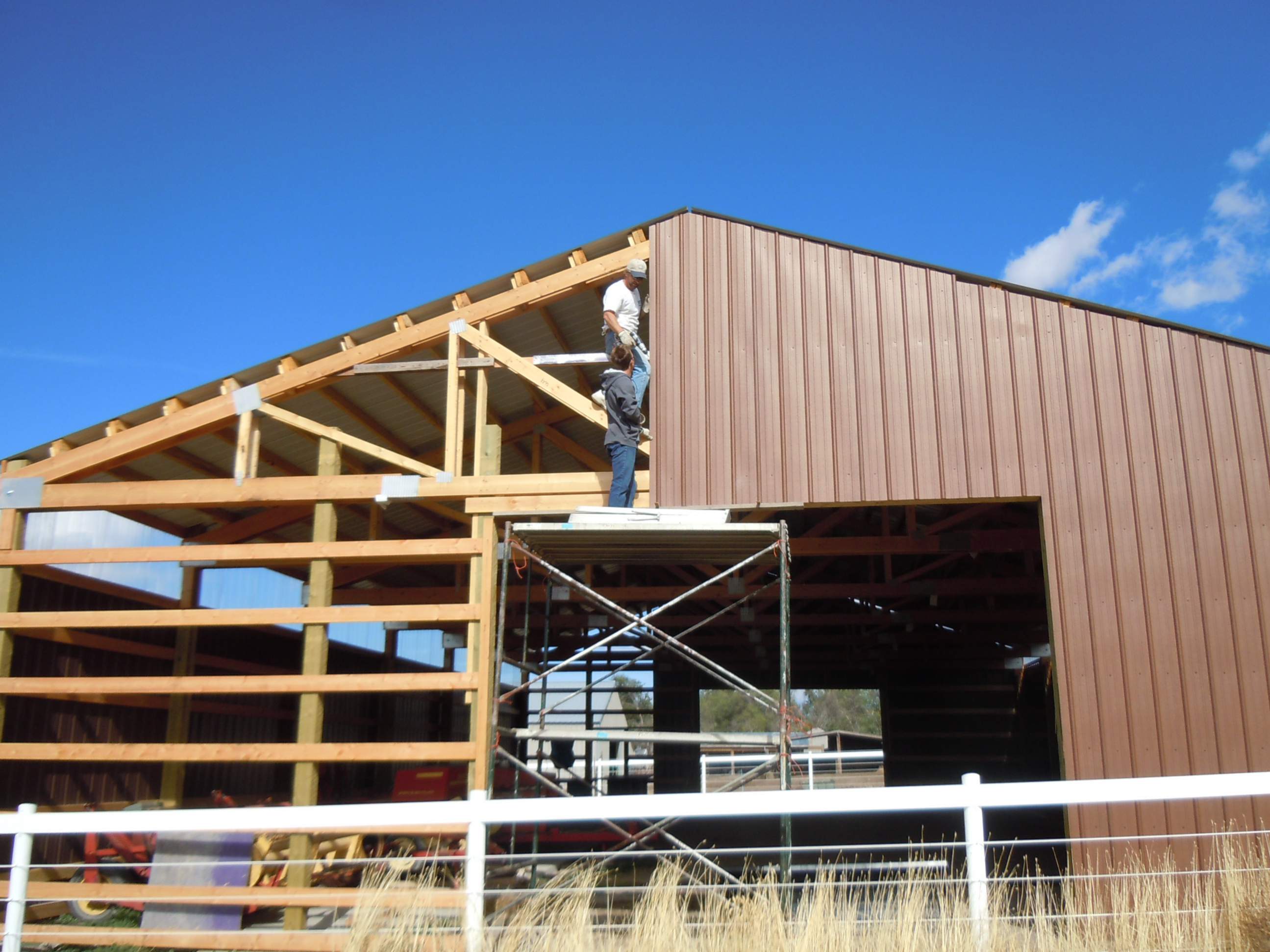

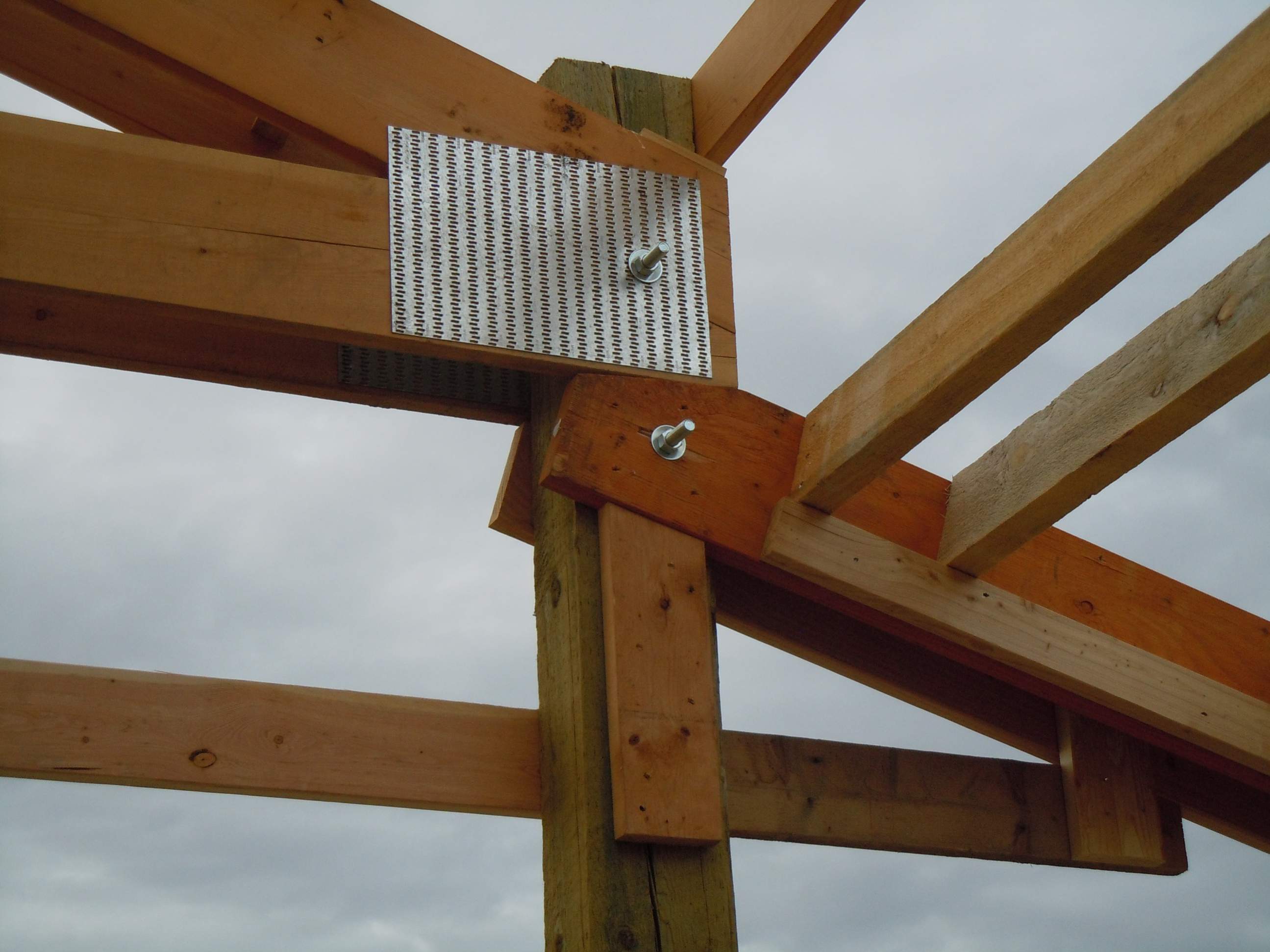

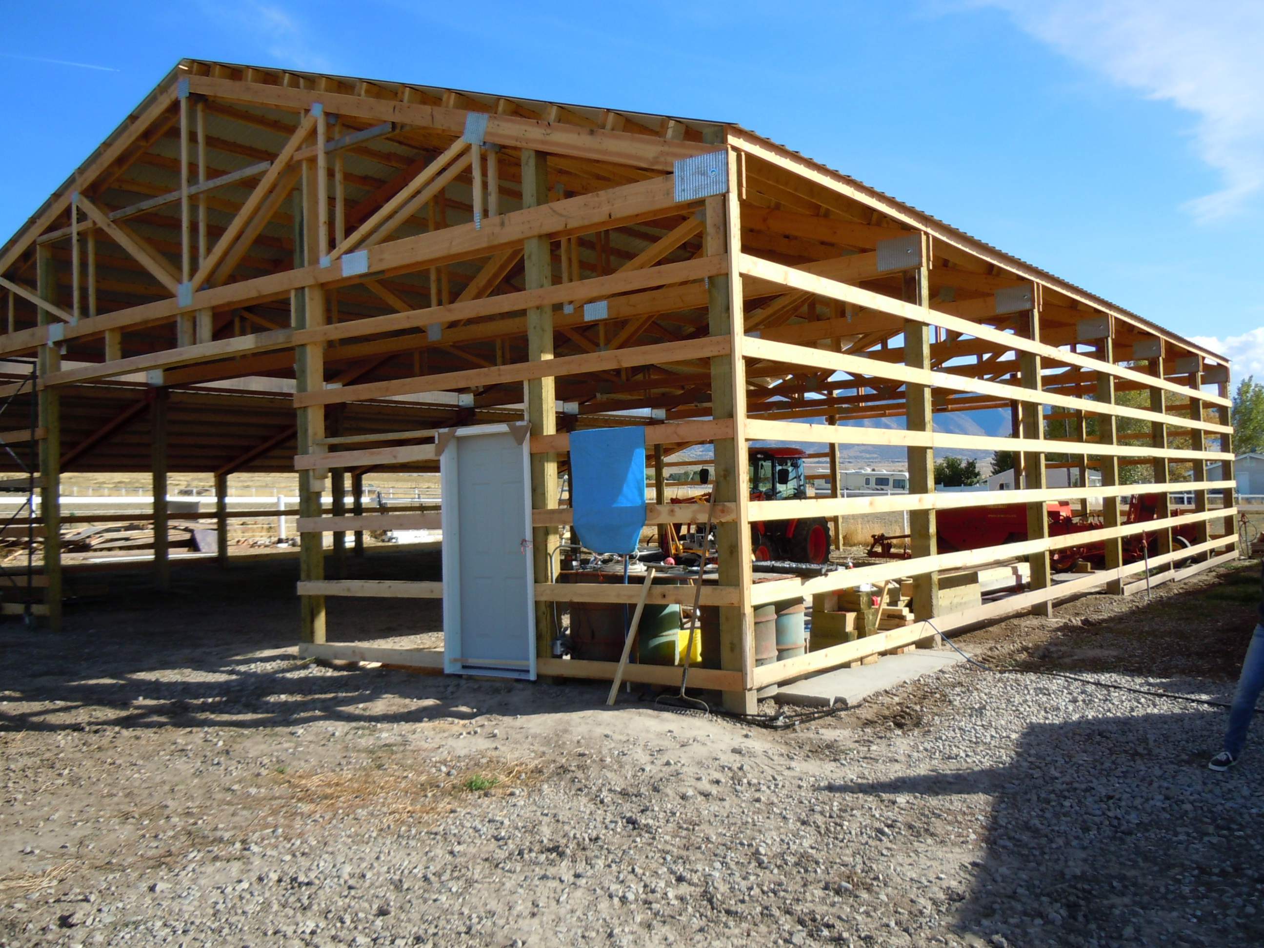

Did you just use a single bolt through the ends of your trusses to support them to the posts with a small block under the truss that is just nailed to the post?
   / Raising a barn
#22
Looks really nice.

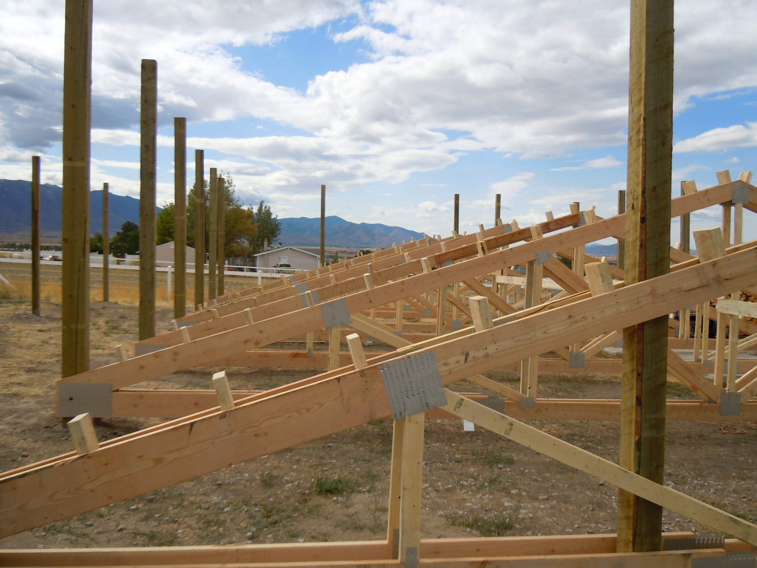

Yes, it's a 3/4" bolt. I have done the same thing on two other pole barns that are now 15 years old---no problems. Heavy snow load at times also.
I also had the truss plant put on thicker and larger steel connecting plates on the ends of the trusses. I guess the size got me a little nervous.

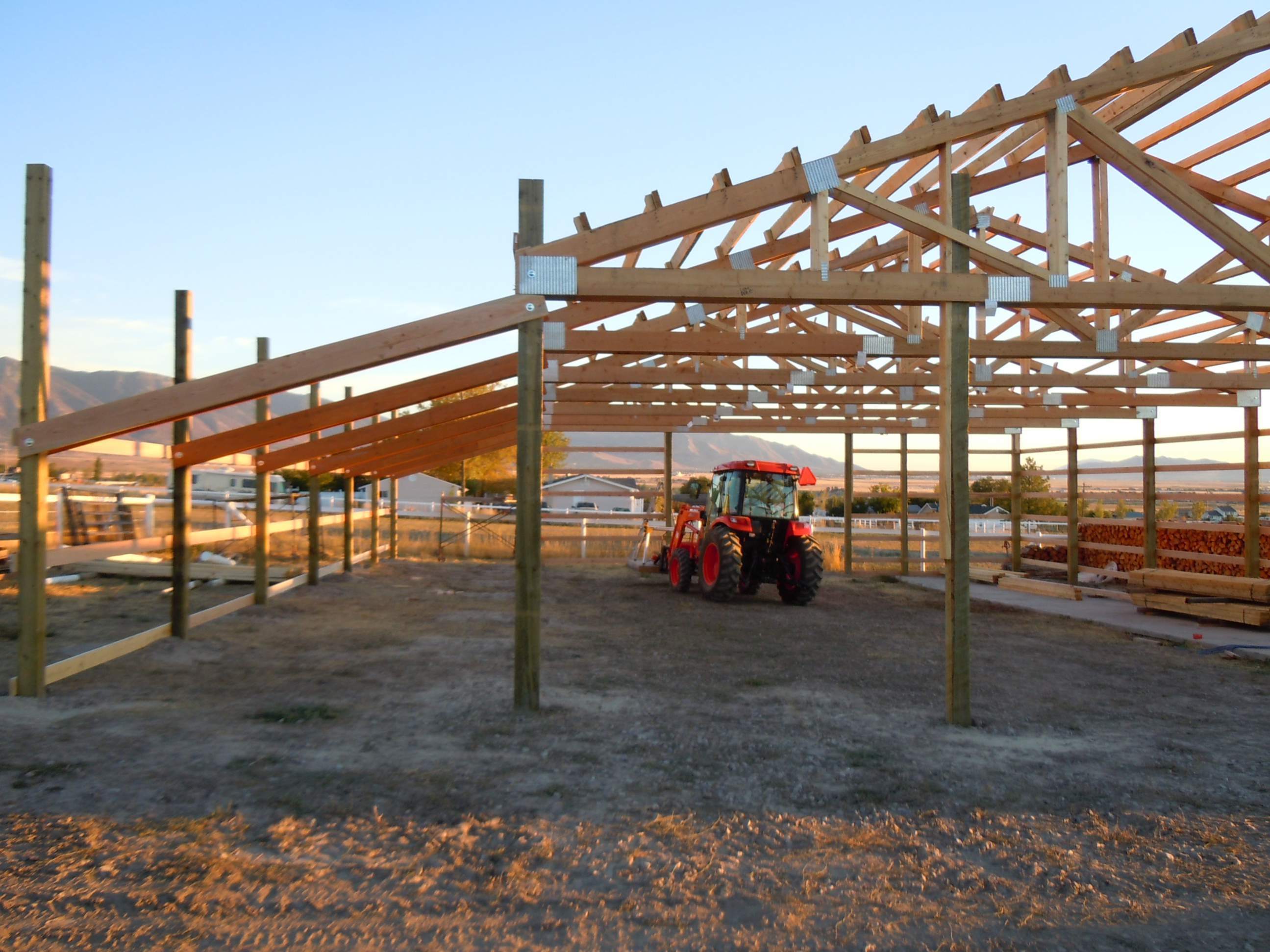

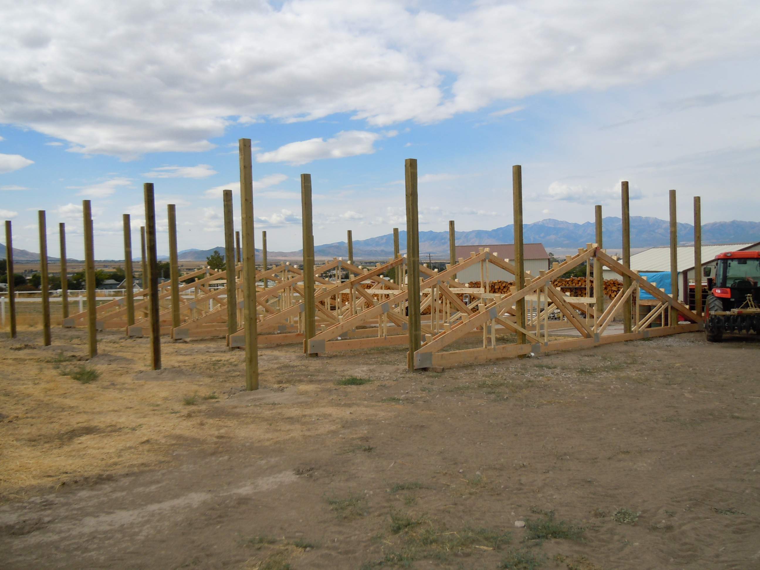

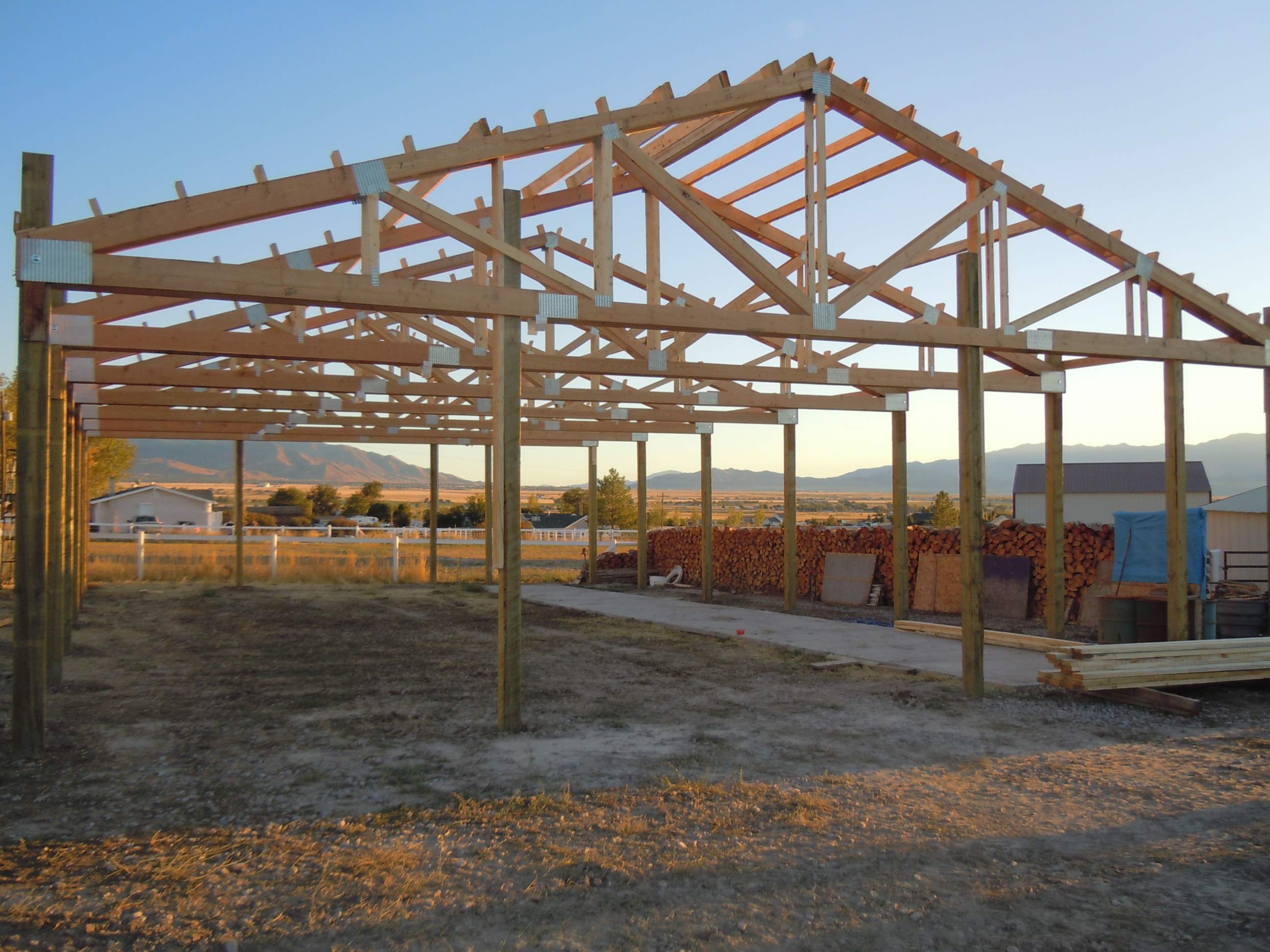

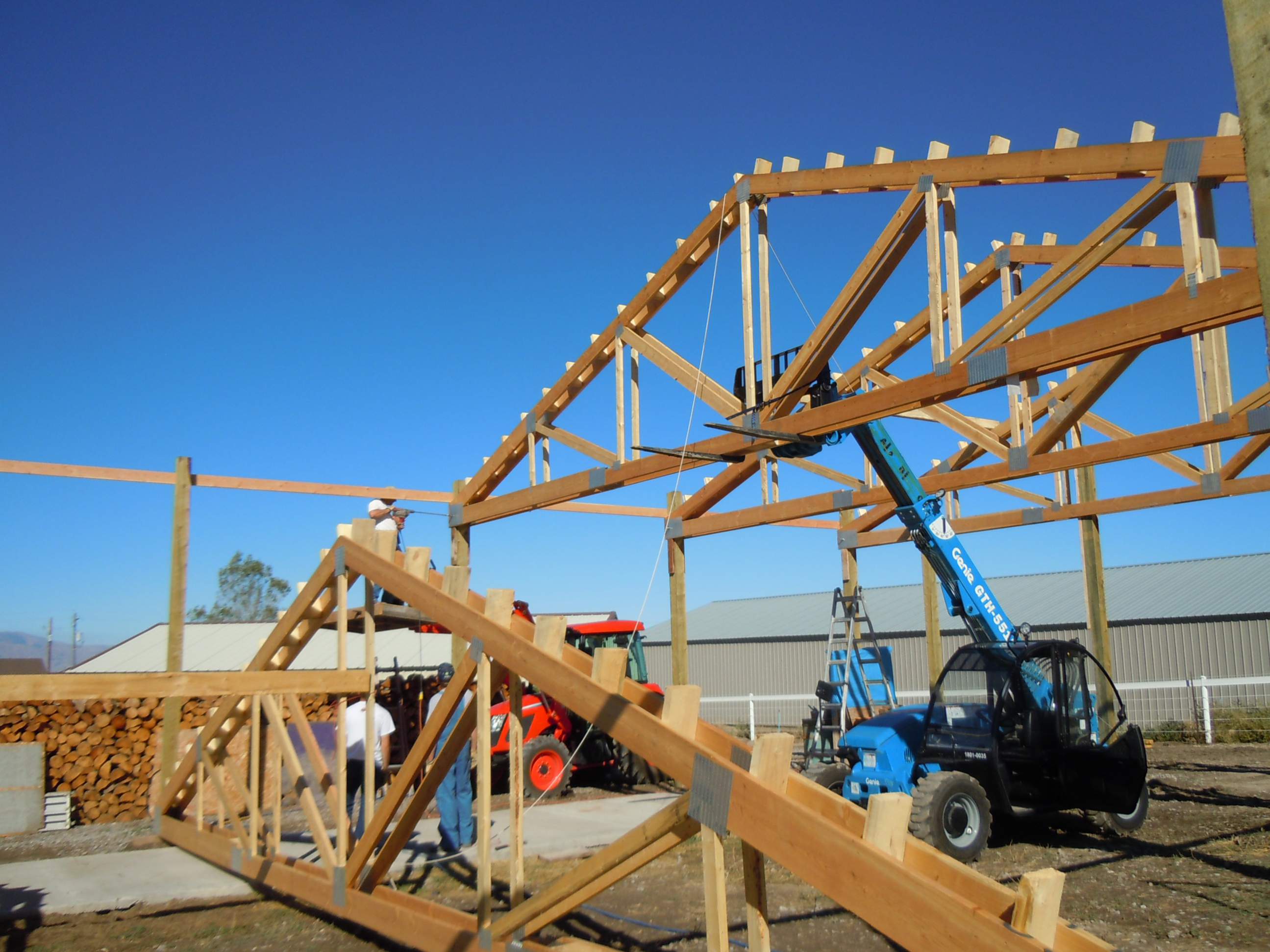

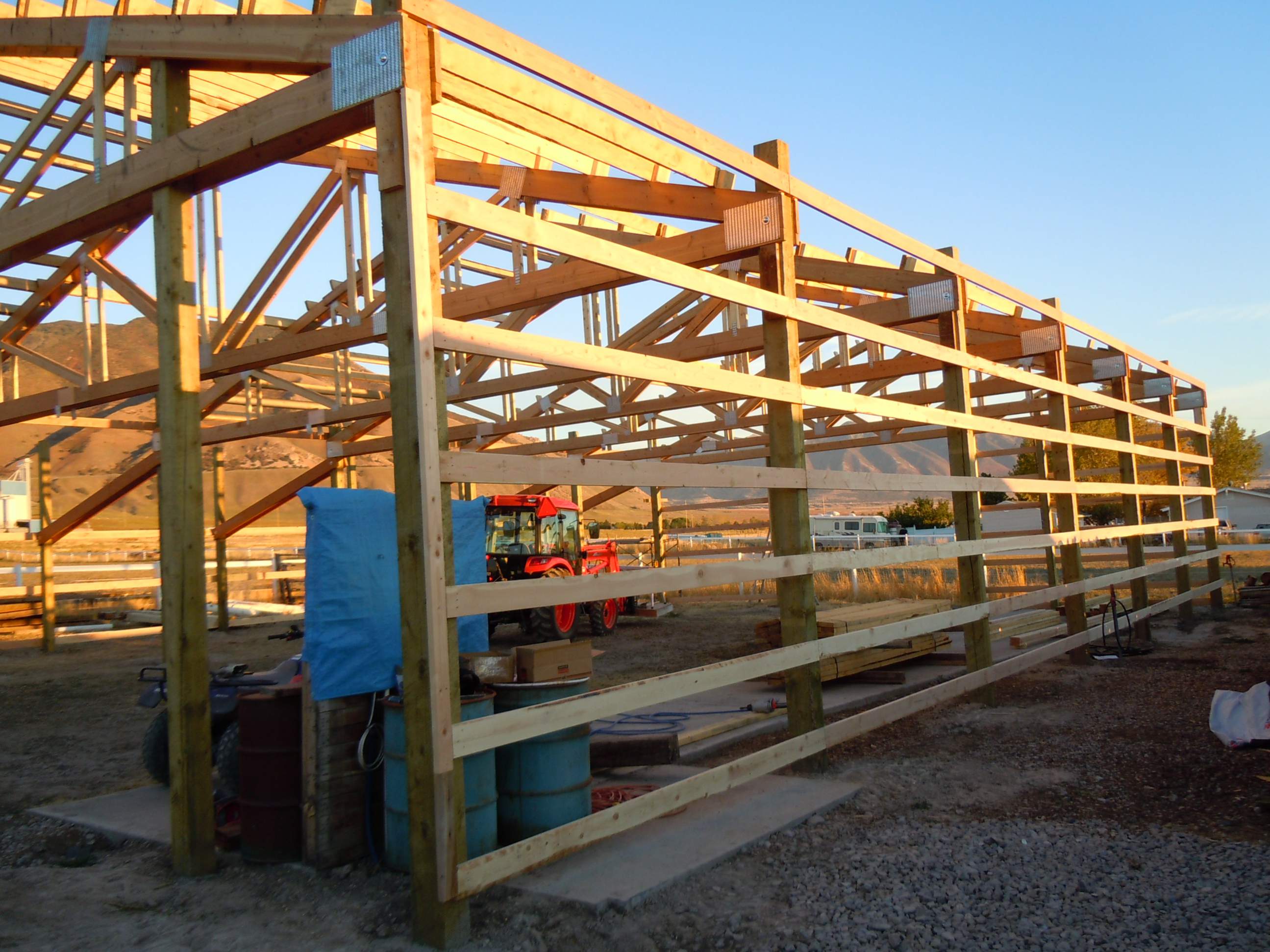

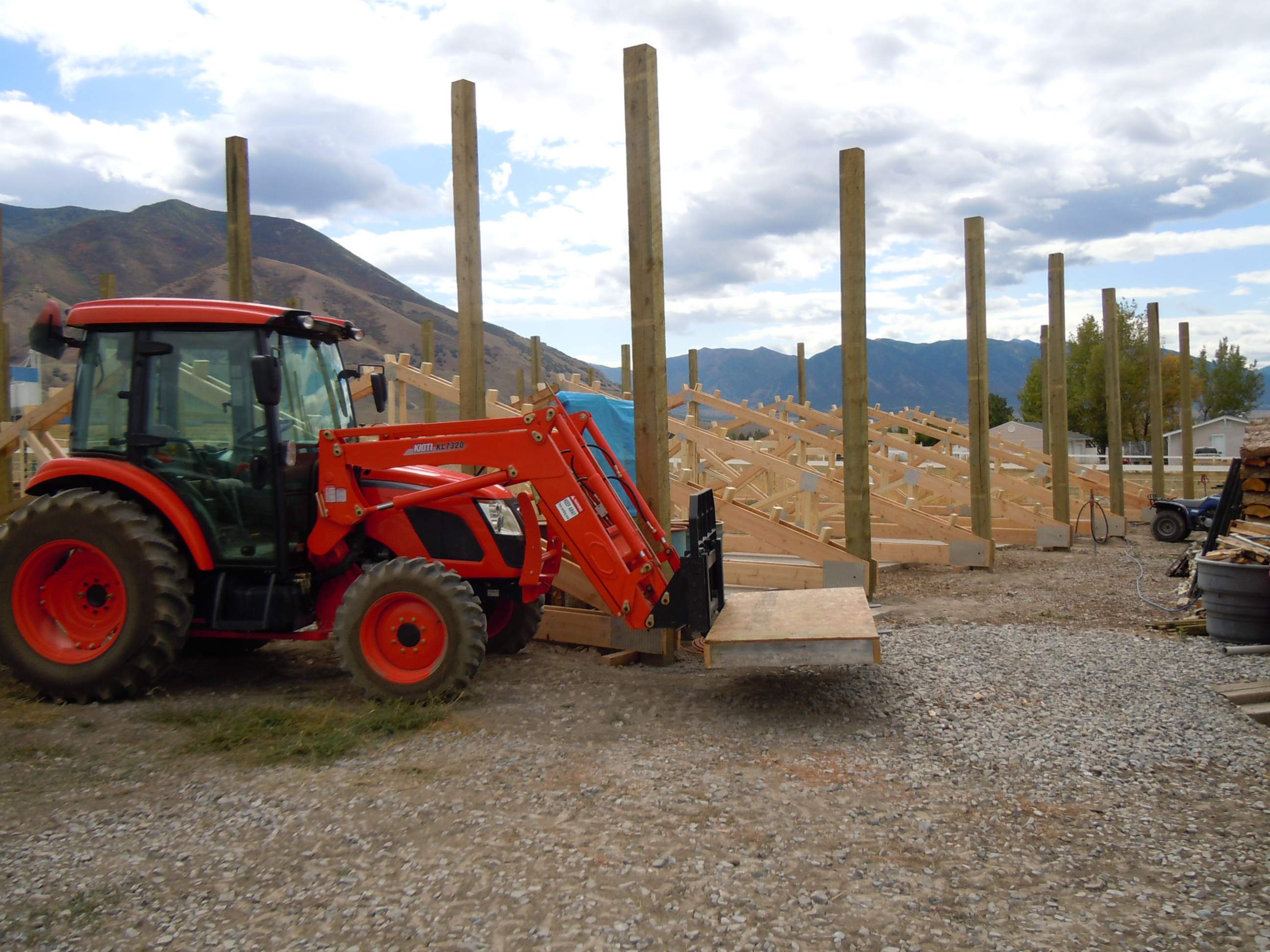

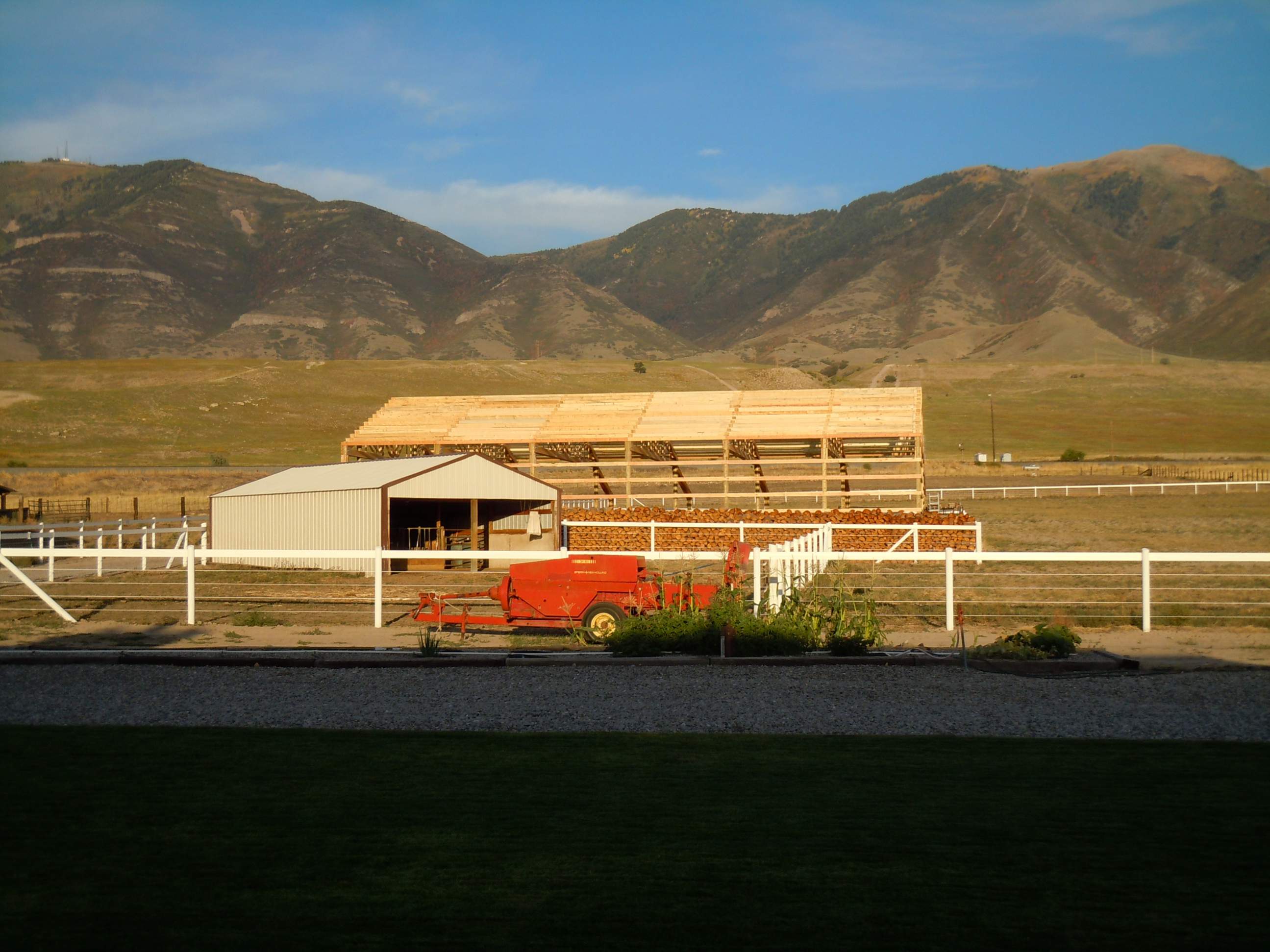

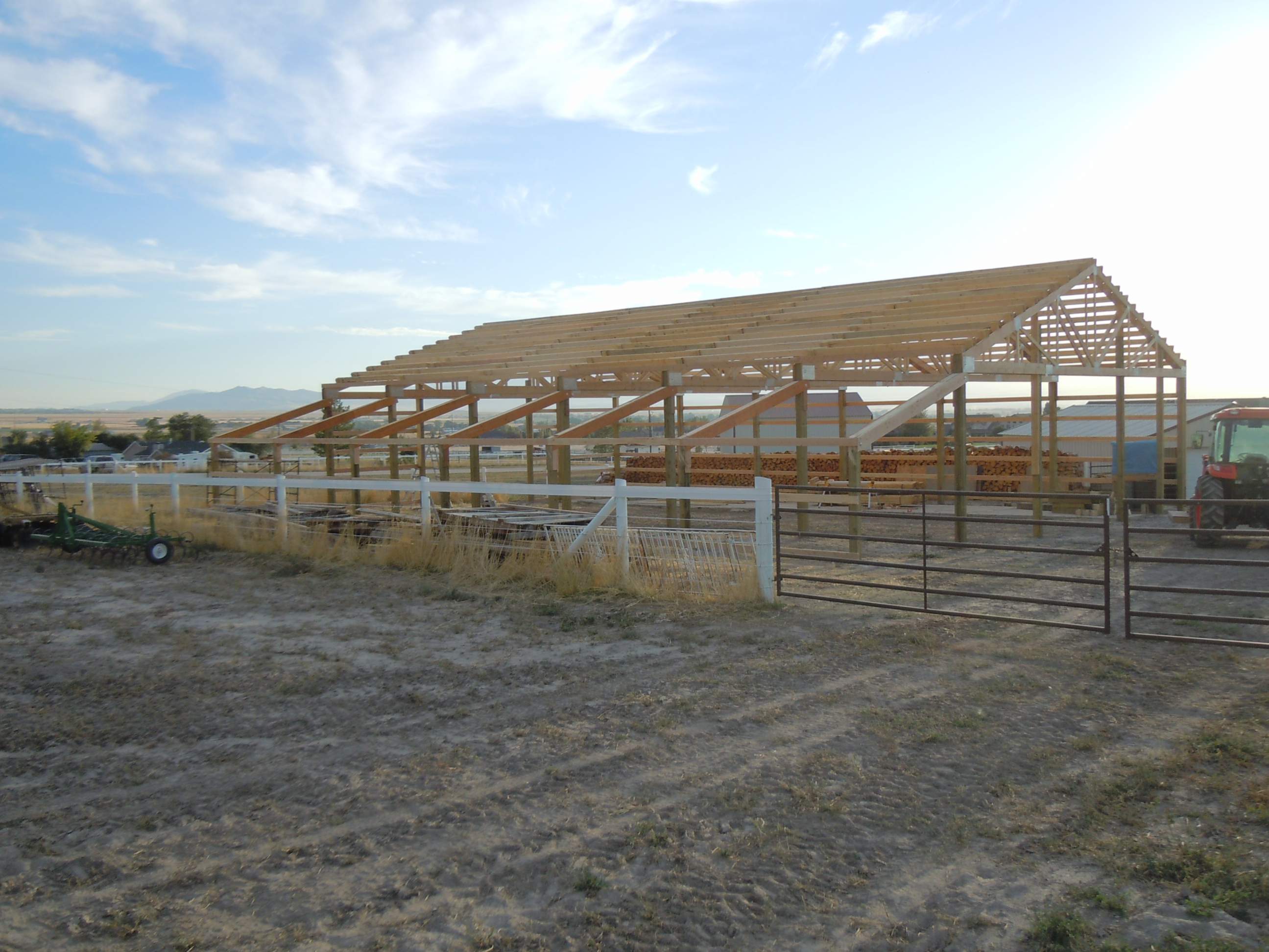

Still plugging along, here are some photo's from last night. I have to work Friday thru Sunday so not much will happen over the weekend. Just a little framing left and it will be metal time. DSCN2268.jpgDSCN2267.jpgDSCN2266.jpg

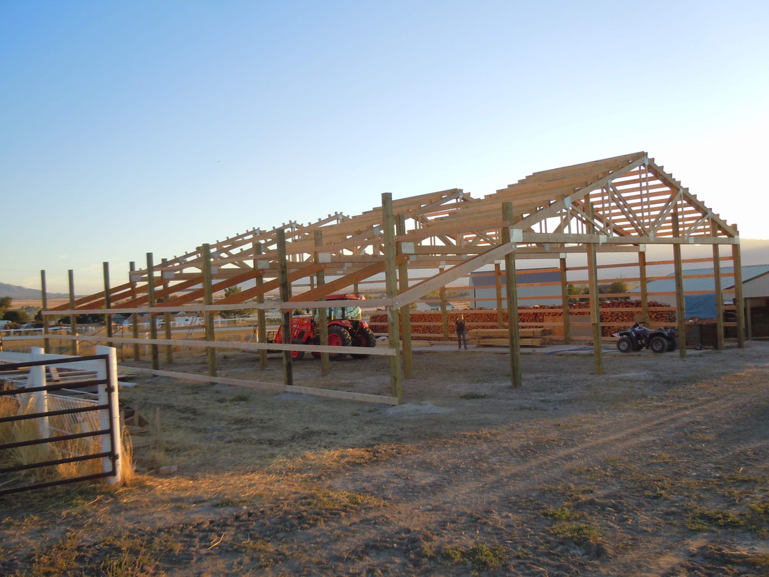

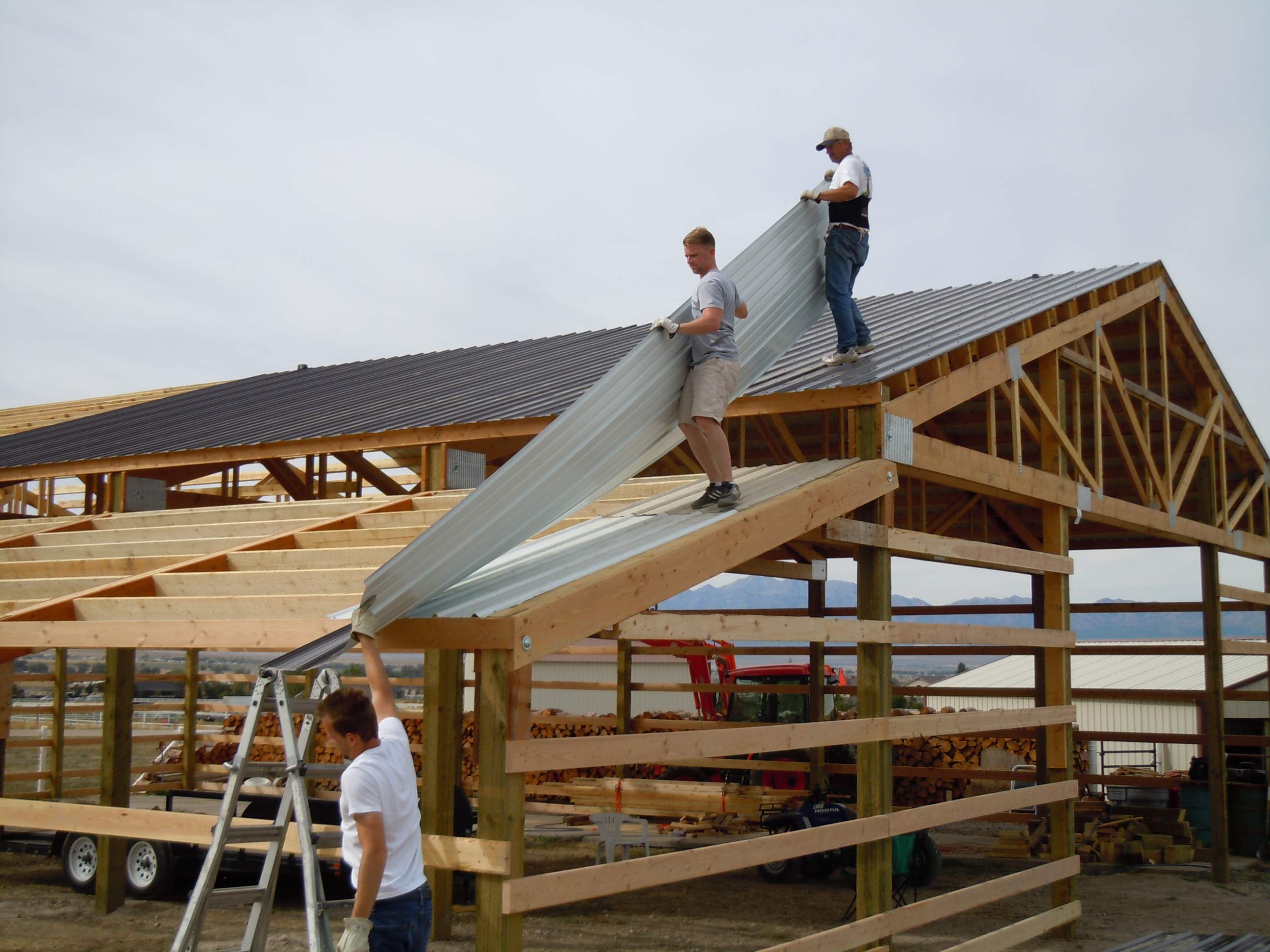

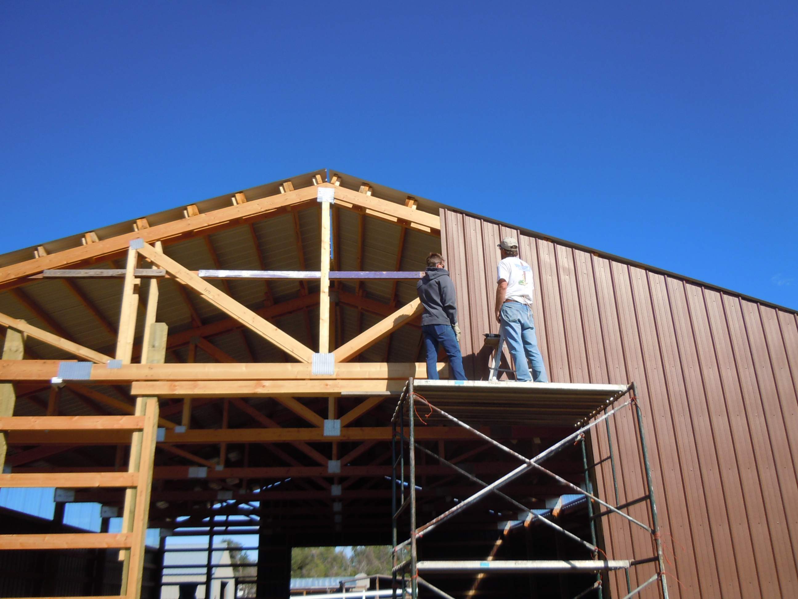

Here is an update on the barn progress.
The roof and awning are ready for metal.

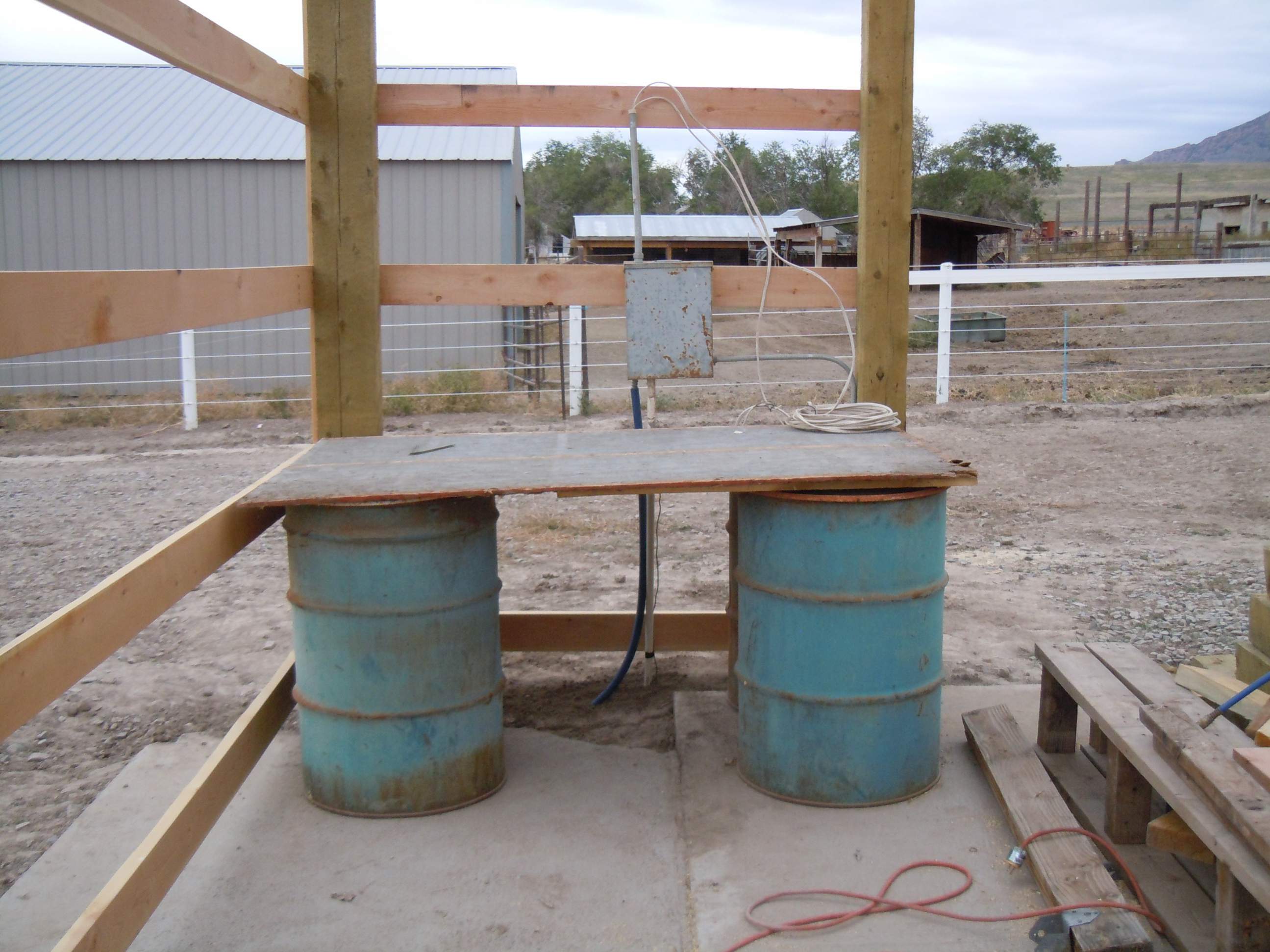

This is how I connected the awning to the post. 3/4 bolt with the bracer board underneath on each post.
Moved the electrical panel. The little wall with the blue tarp is now gone. At some point I plan to get more power to the barn but this will suffice for now.

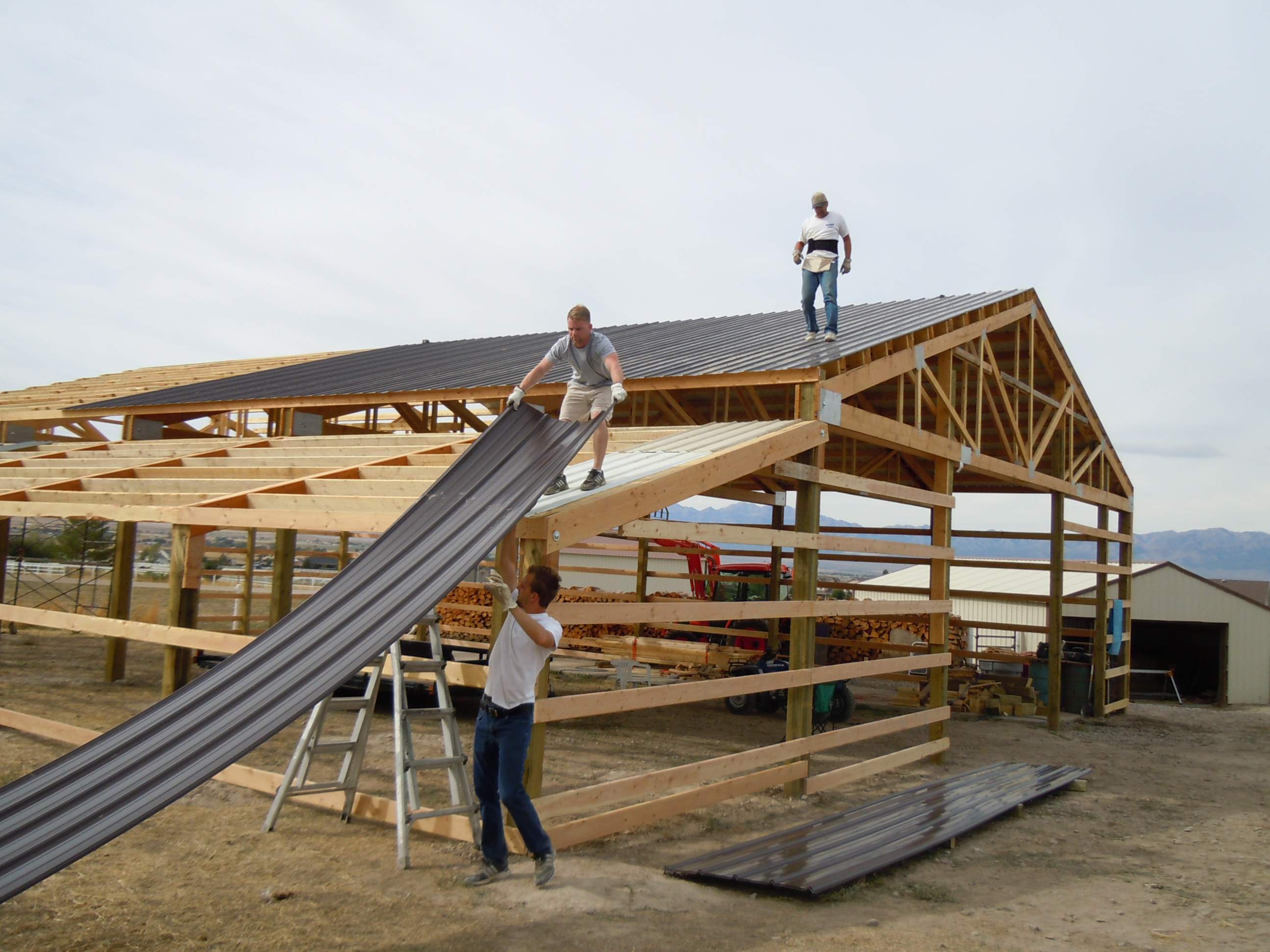

The roof metal is coming tomorrow so I will be busy for a few day getting that up. We got screwed on the wall metal by the distributor. They sold our metal to someone else and now we wont get it until the end of the month. (yes I'm pissed about that.) It's a premium color that I don't want to give up on. Took me and my wife 2 hours to pick out the colors. All in all it's going good. My back will be happy when it's done though.:)
   / Raising a barn
#26

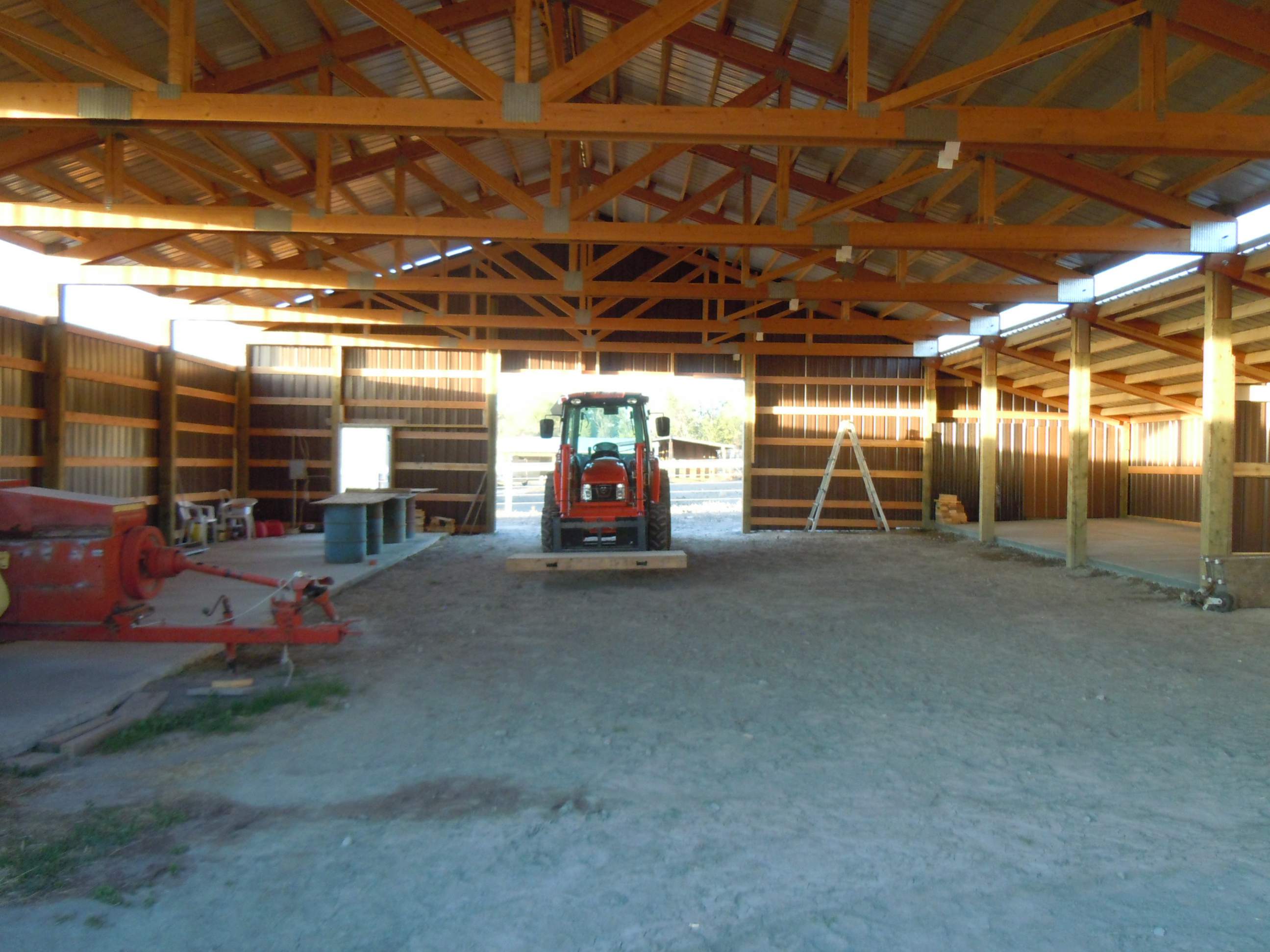

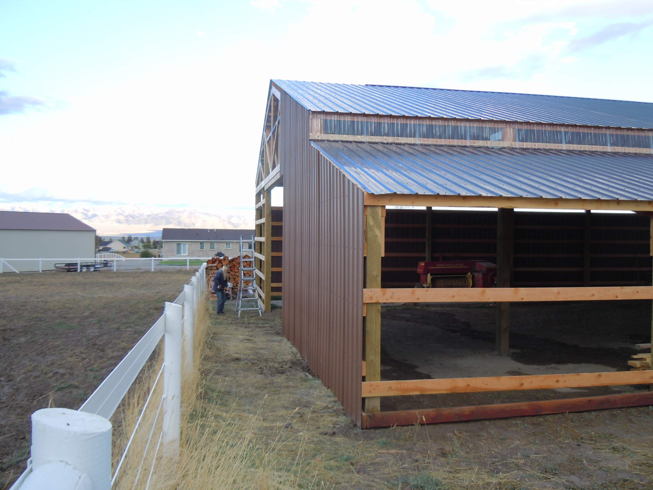

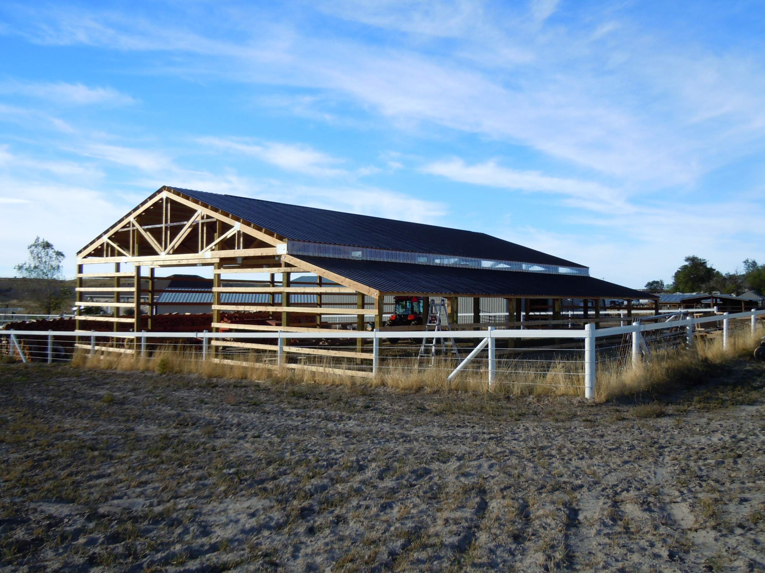

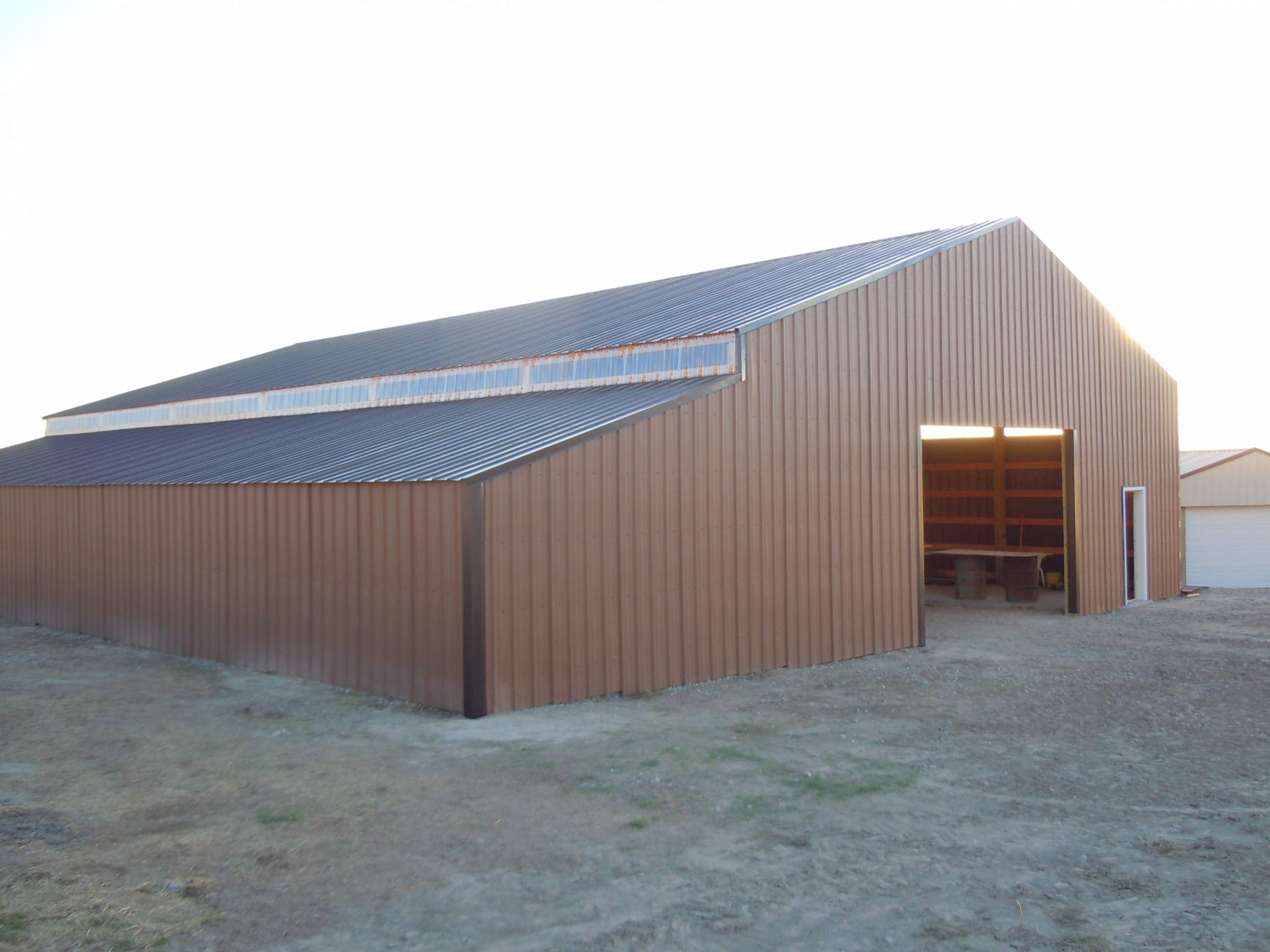

Some progress on barn; The roof is complete.:) My back is so happy.
I have the headers framed for the big doors and finished framing in the small door.
And as you can see starting moving in some equipment.
I still need to do some more grading inside.
With any luck I will get the rest of the metal next week.

Is your plan to open up the fence next to the barn to allow you to drive through? That is going to be a nice looking barn. You do good work.

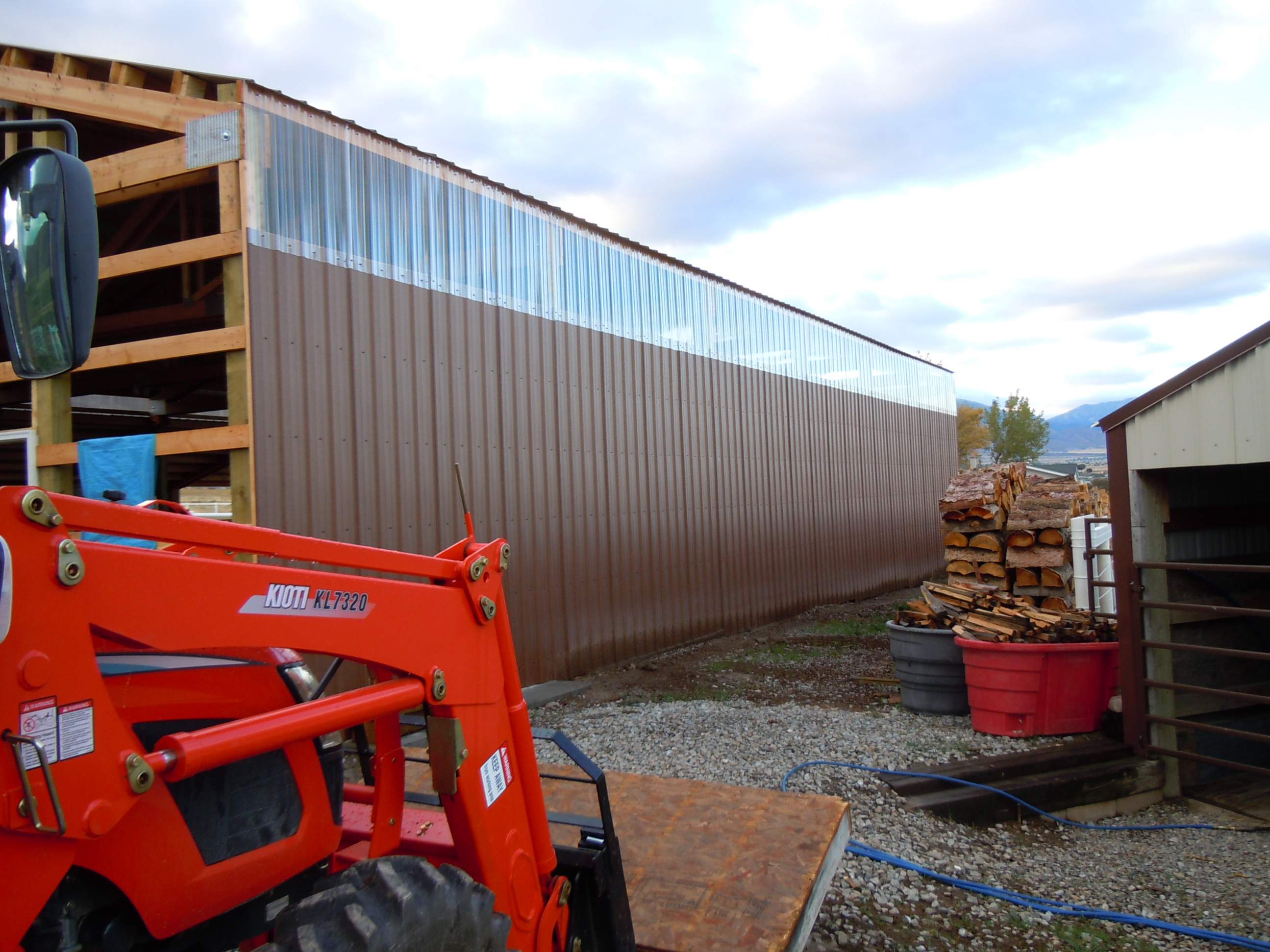

How did you do your flashing on the wall where the second roof starts? I've had some issues with this and found that putting a gutter on the top section solves all the issues of water splashing back up when it hits the second roof.
Yes, that section of fence will come down. I will put up a couple electric wires with a switch to make sure the cows don't rub anywhere on it. Then I can turn it off anytime I need access through that door.
Eddie,
You can't see it from the pictures but the clear panels are sloped. I may have to foam the bottom a little, I'm waiting for a good rain to see if it's needed.
   / Raising a barn
#33
Eddie,
You can't see it from the pictures but the clear panels are sloped. I may have to foam the bottom a little, I'm waiting for a good rain to see if it's needed. As long as we don't get a huge east wind it will not be a problem. An east wind would be rare around here.

I didn't notice that, but see it now. I have no idea how that will work and I'm curios to hear your observations. My experience is that the water coming off the roof splashes on the next roof and it sprays water back towards the building, and up under the flashing. I sealed up every valley on my metal and then added some on top of each ridge so that when I screwed the flashing down on to the metal, the black tar oozed out.

I was hoping that a 4/12 pitch and 3-4 inches of overhang from the upper roof would make the water hit a little lower on the roof. I think maybe I should have one of my boys get on the roof with a garden hose and see what happens. I'd rather fix it now than the middle of January.:)

I had a couple rain showers a few days ago and had no problems with water getting in from the second roof. I will still take some measures to insure I don't have a problem with heavier rain showers.

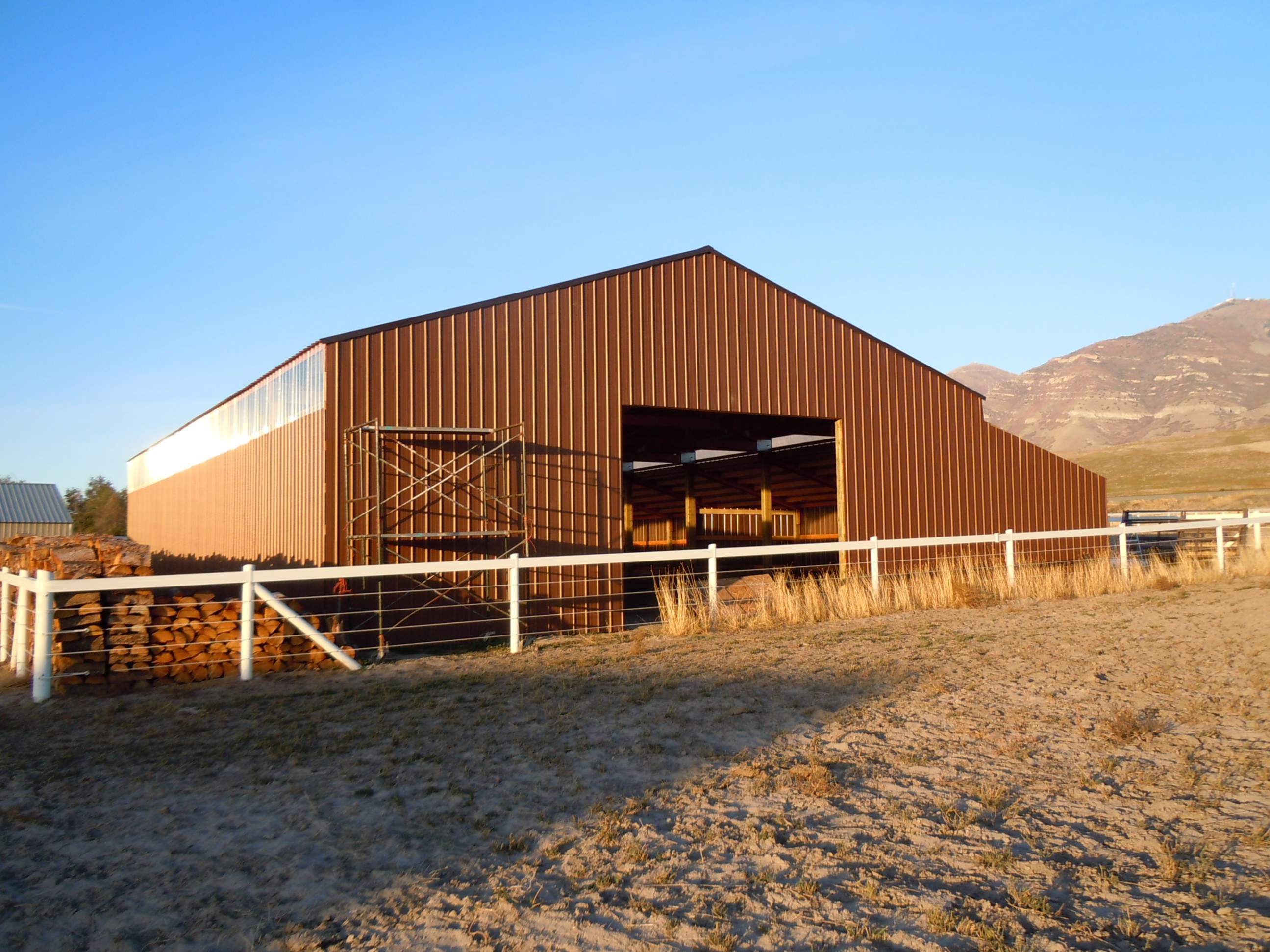

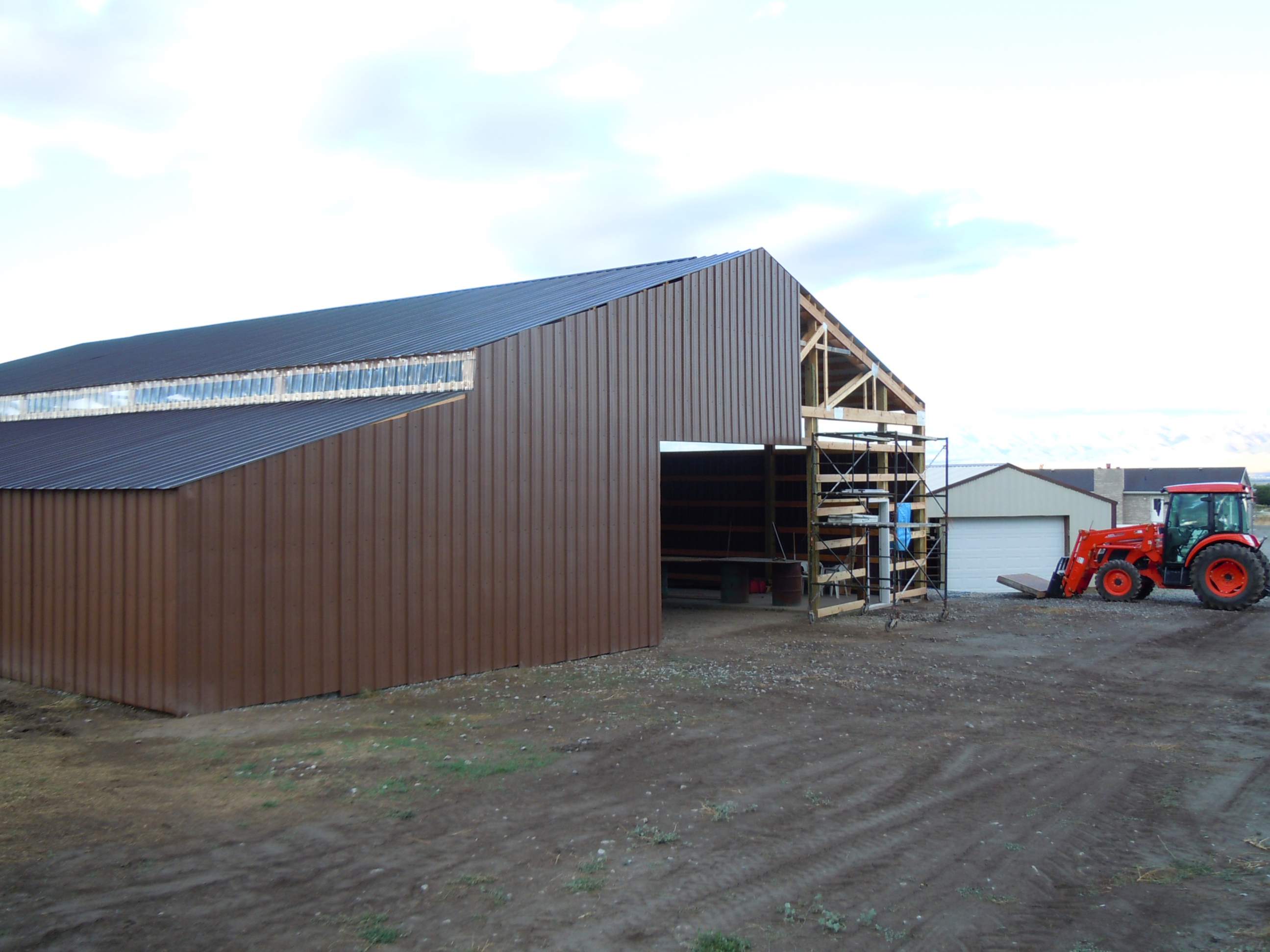

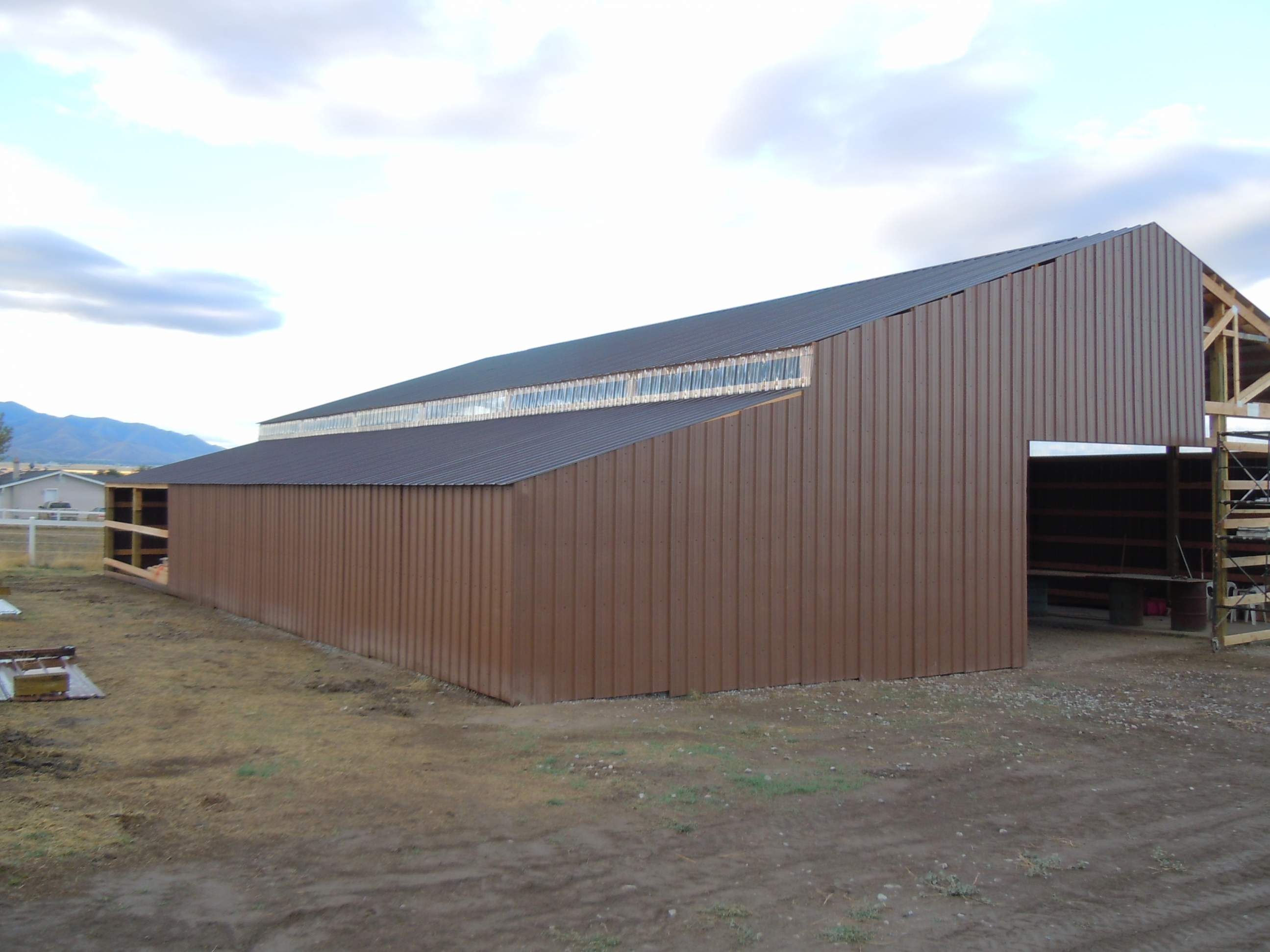

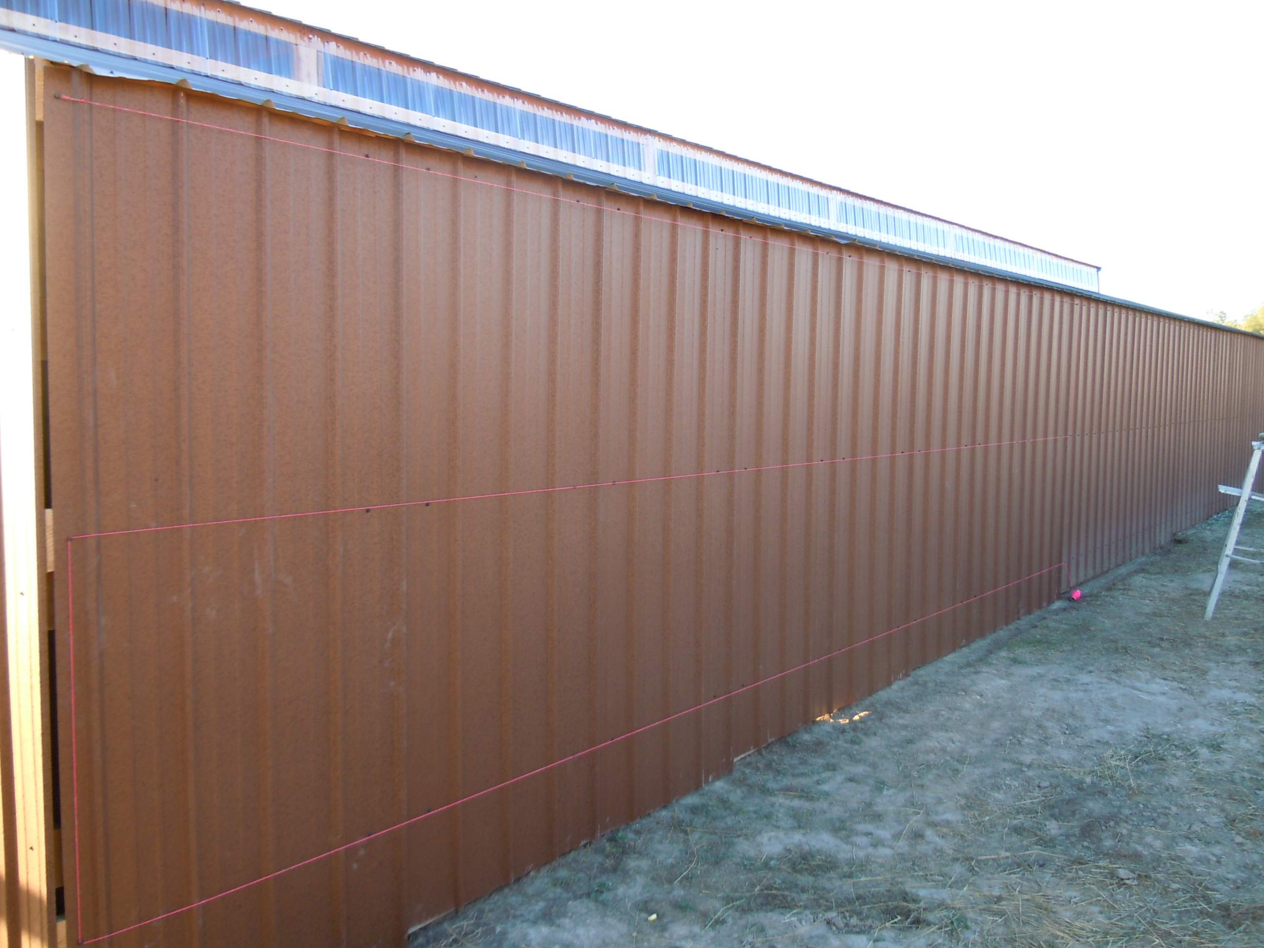

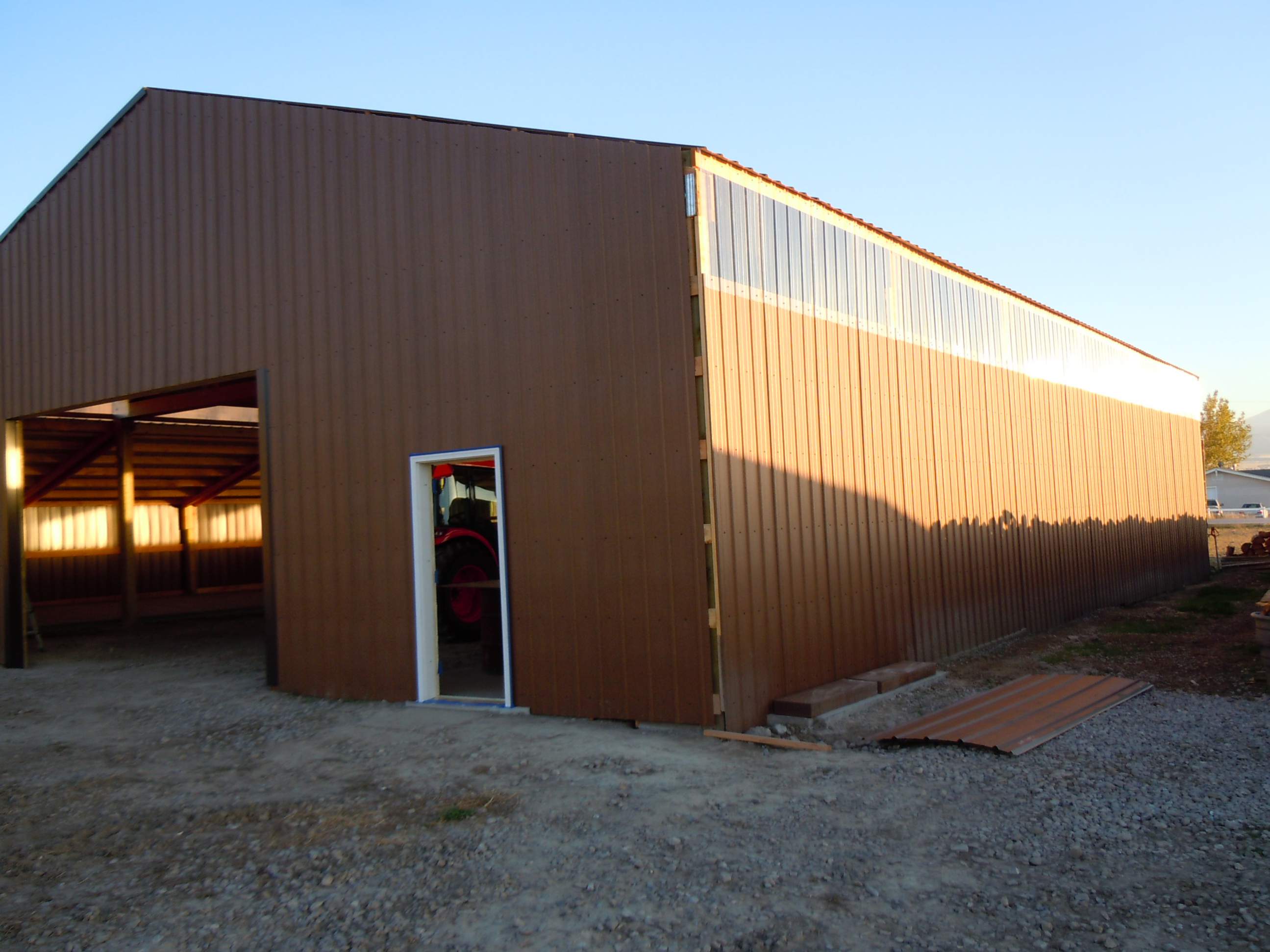

I took some pictures last night. As I said there are a few more trim pieces and the doors but it's pretty much done with the big stuff.
Here are the west and north walls.
Here are the south and west walls.
All the metal up and getting ready to paint the entry door trim.
This is the east side, the concrete pad is where I'll store the firewood.

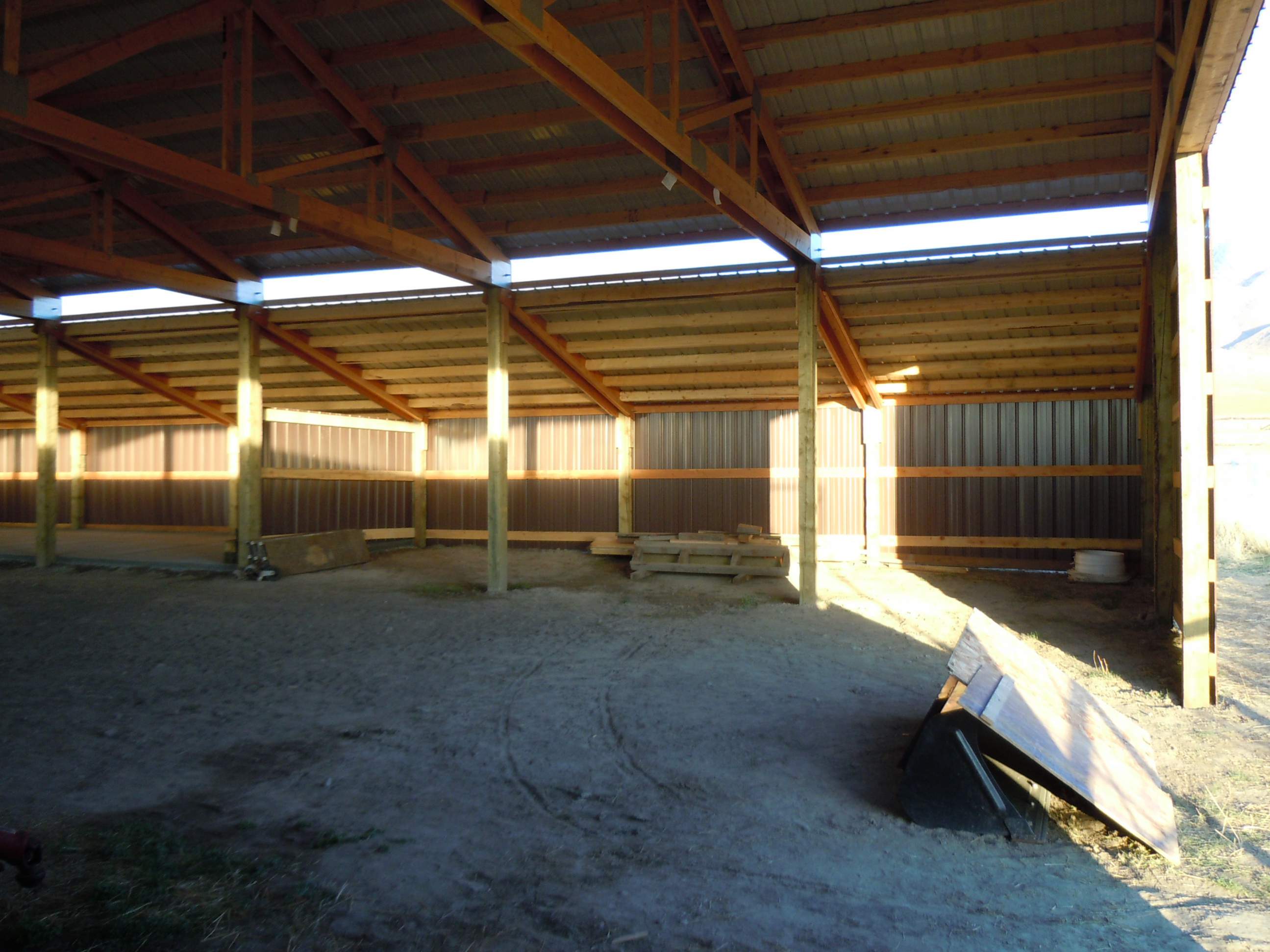

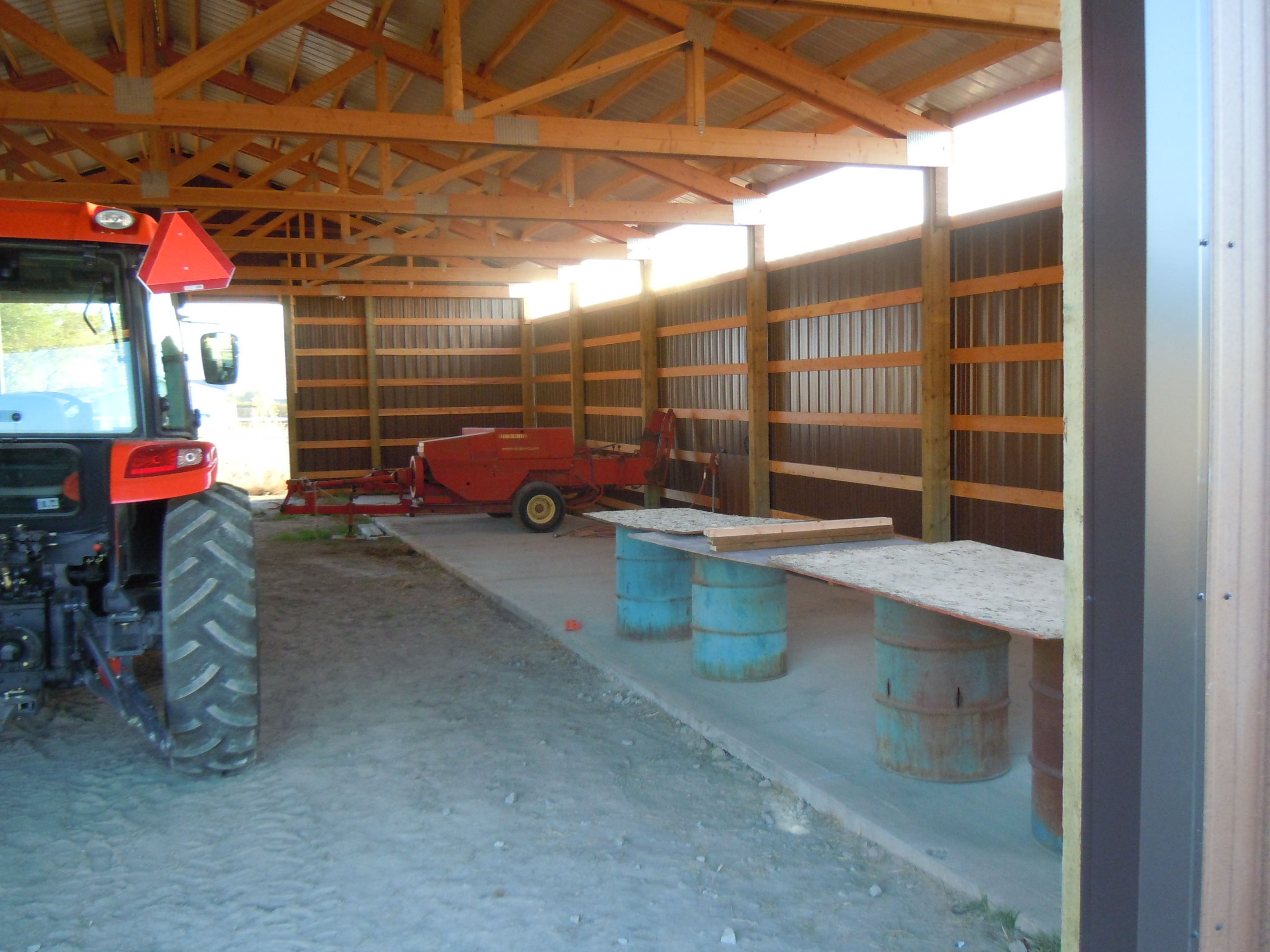

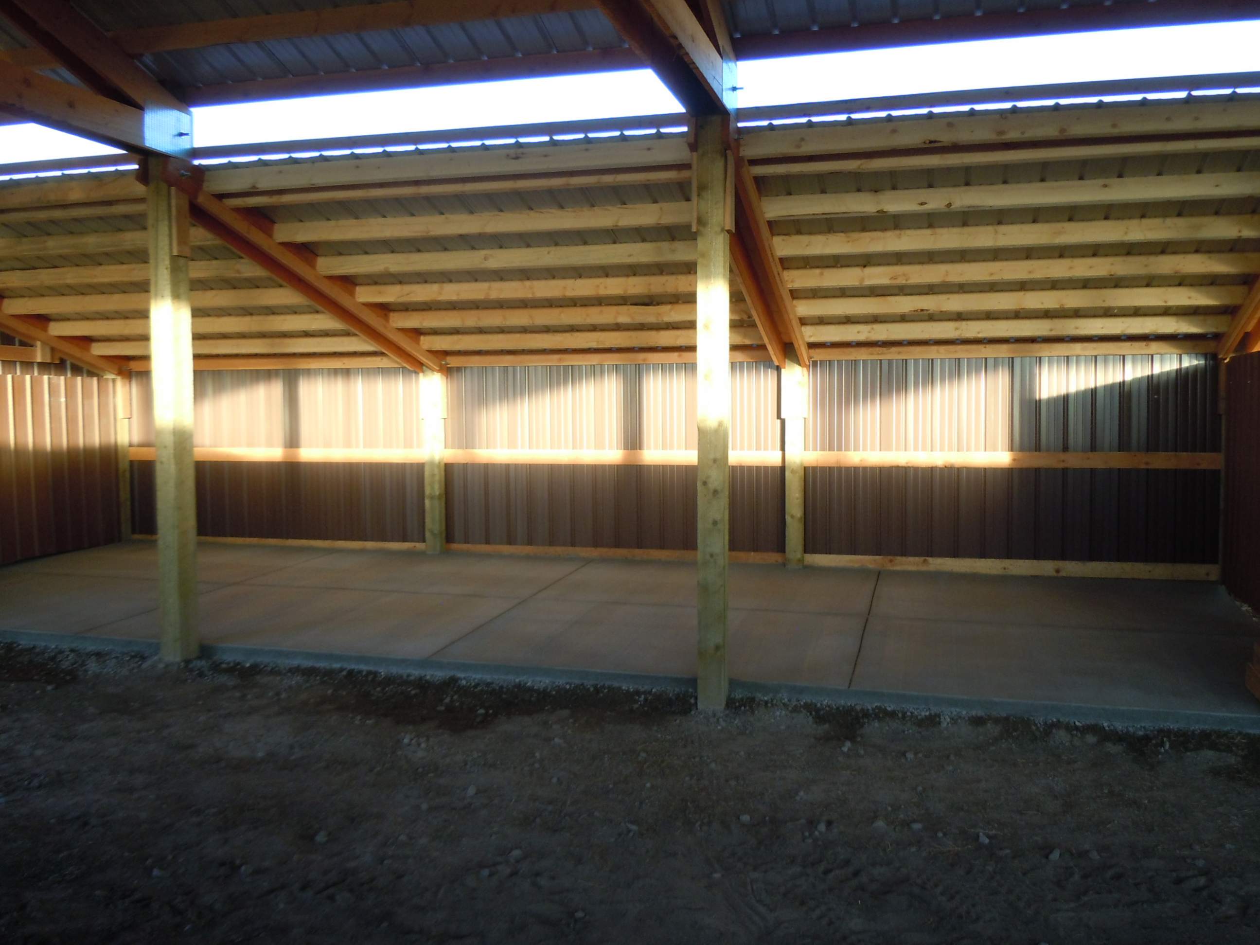

Some random shots inside. The high tech barrels with old plywood was the metal cutting station.:D
So I still need to remove the fence. It will butt up against the east and west corners of the barn. Moving all that firewood inside is something I'm not looking forward too, but it will happen next week.

That sure is a nice big open space you have created there for storing stuff!!!!!
   / Raising a barn
#40
I agree, but as I start moving stuff in, it is getting smaller.
I am really happy with how it's all turned out though.:)
