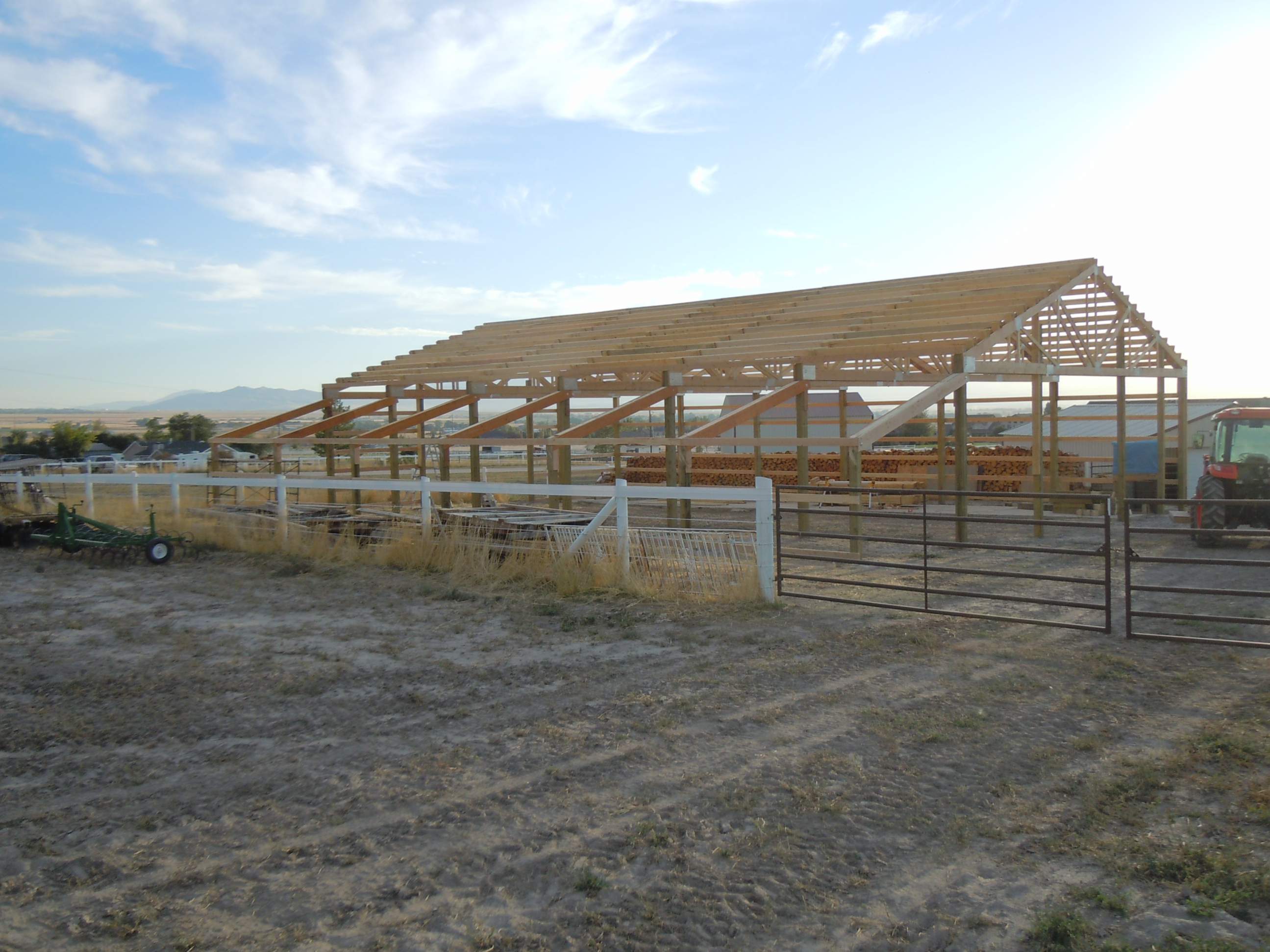

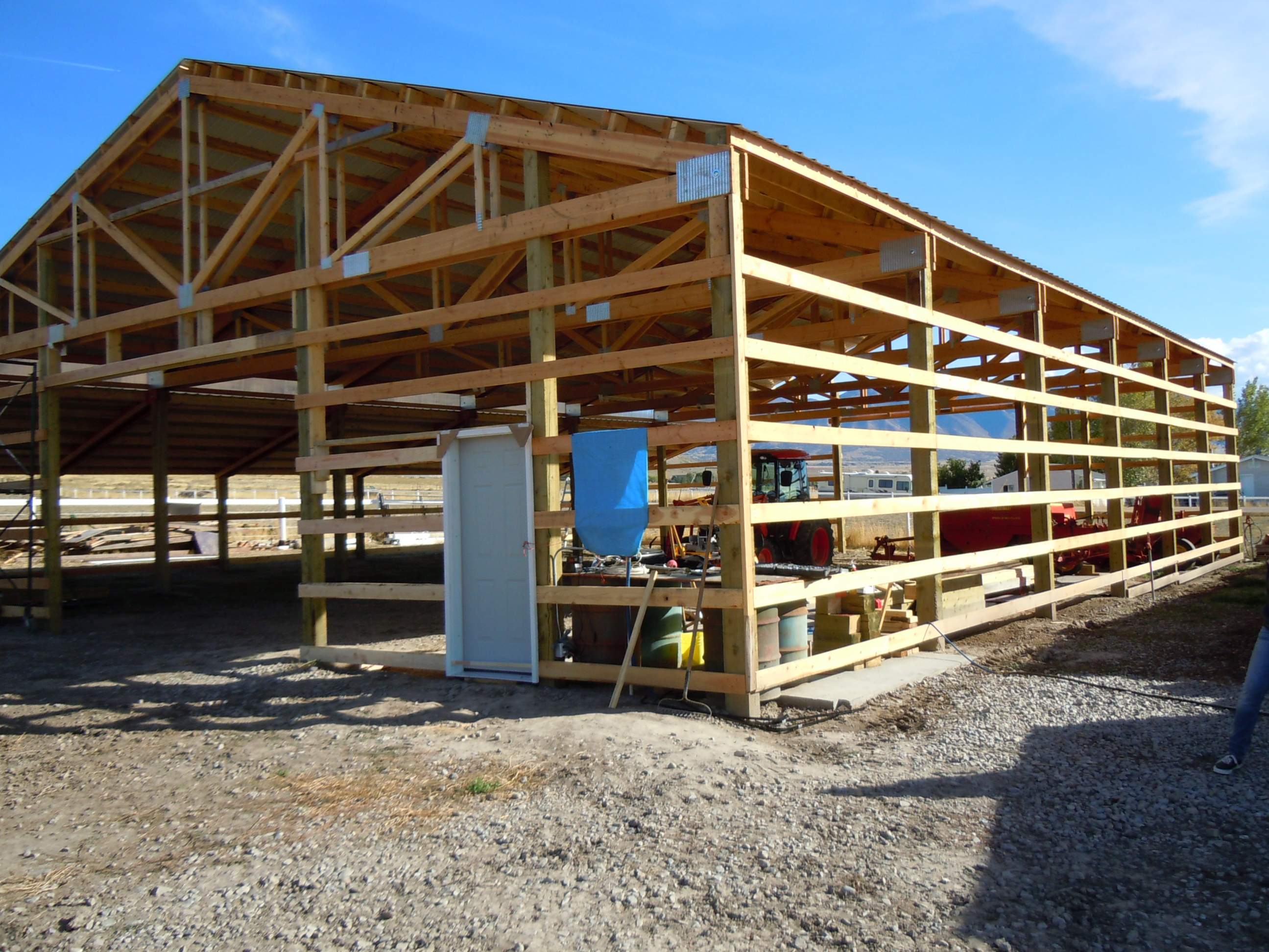

I still have not decided on what kind of doors I want. I like the idea of regular roll up house style doors for the fact I would be done working on it. But the barn style sliding doors make it look like a "barn". I would like that for the curb appeal, but then I would be building them. I'll post pictures of what ever I decide.
So here are two pictures of where I started and where I am now.

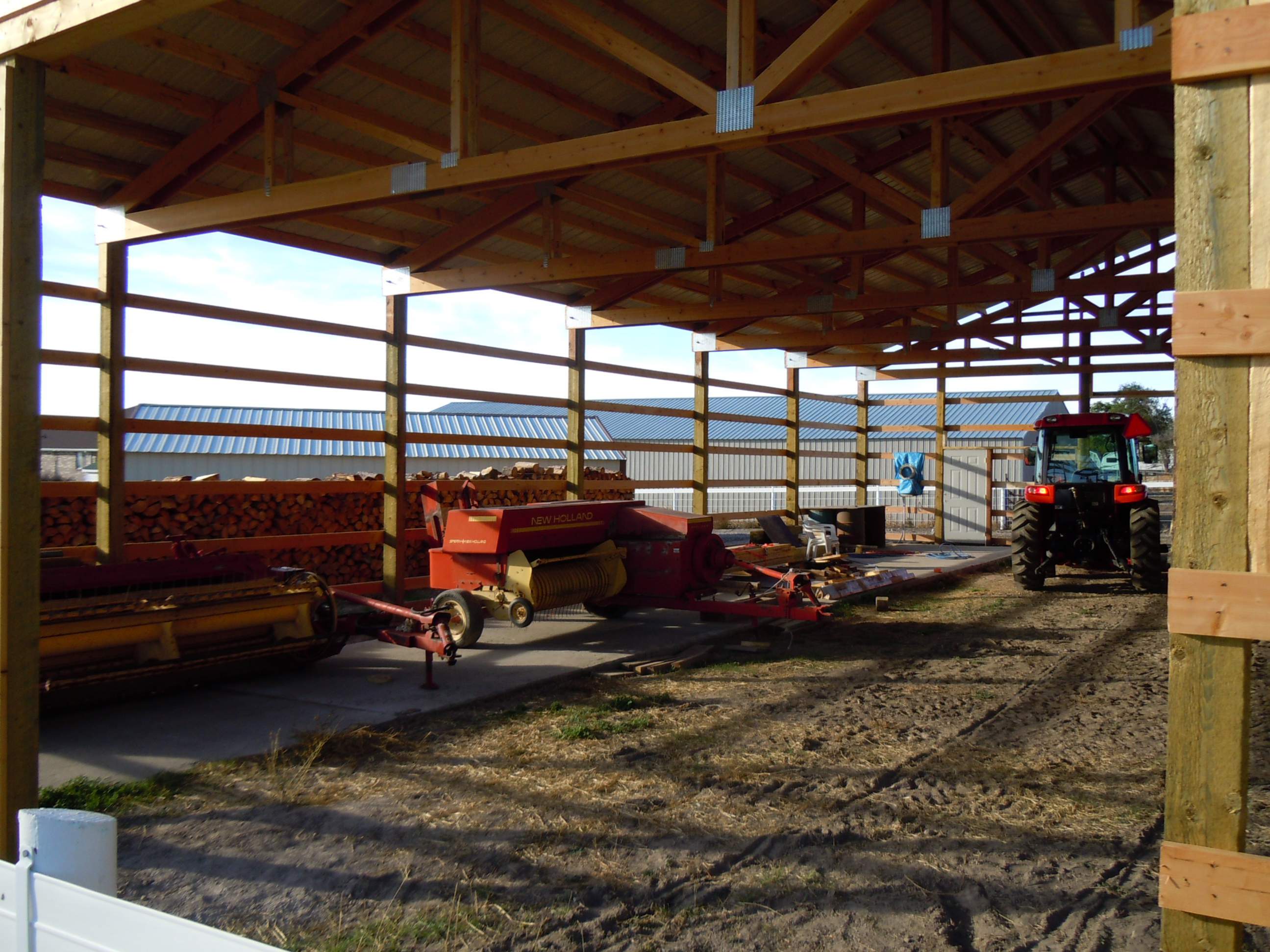

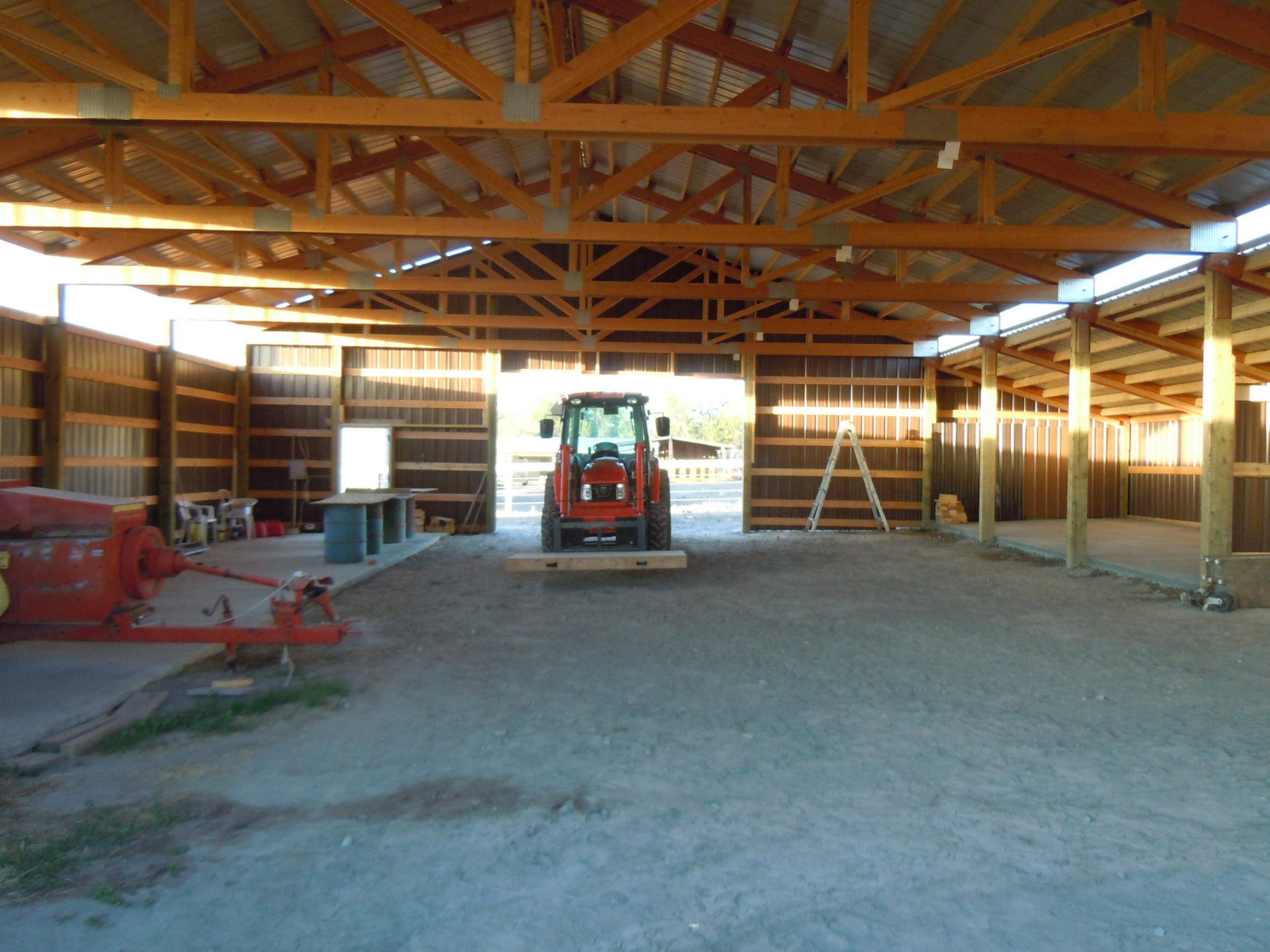

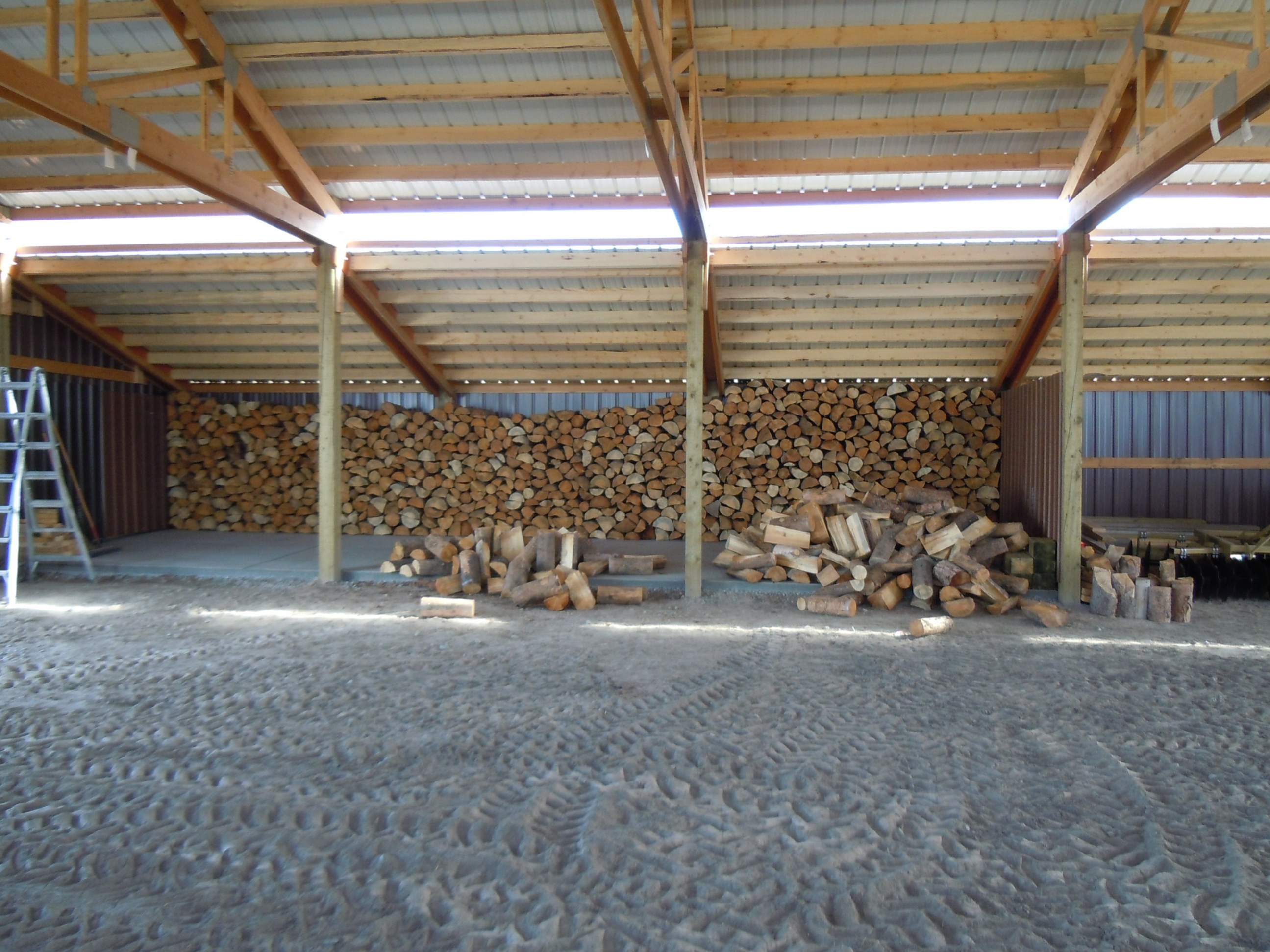

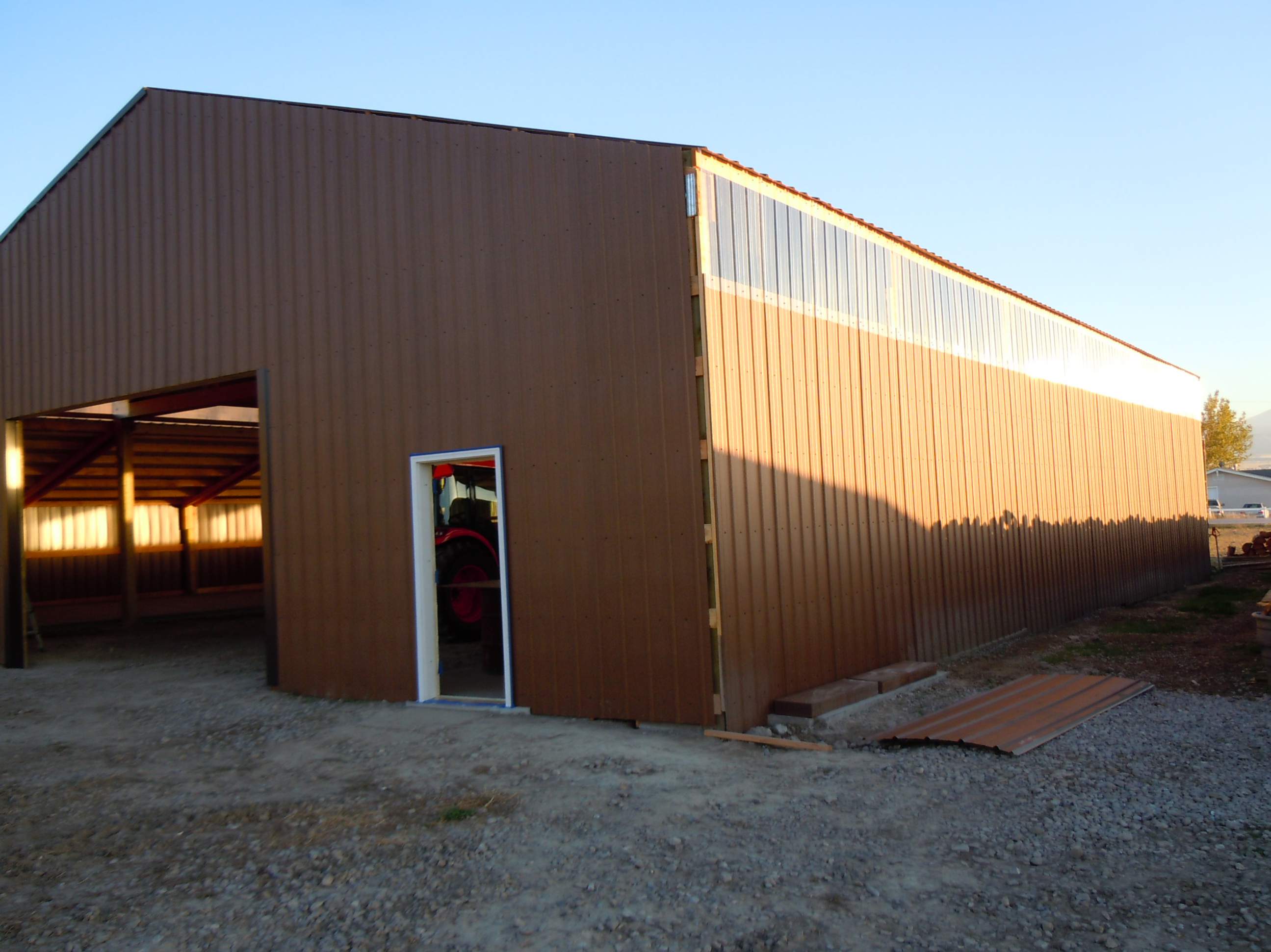

The translucent panels run the full length of the barn on the east and west sides. Here are the pictures.
The east is 14" high and the west is 30" high. I think it will let plenty of light in, even on cloudy days.
The last picture is inside just before sunset. Still plenty of light I think.

Sorry for the wording. They sure do let in a lot of light. Where did you source/purchase the translucent panels?
   / Raising a barn
#46
Got them from a place called Triple SSS in Salt Lake City.
   / Raising a barn #47
Those translucent panel are really nice! :thumbsup:
Can't beat natural light...or the price.

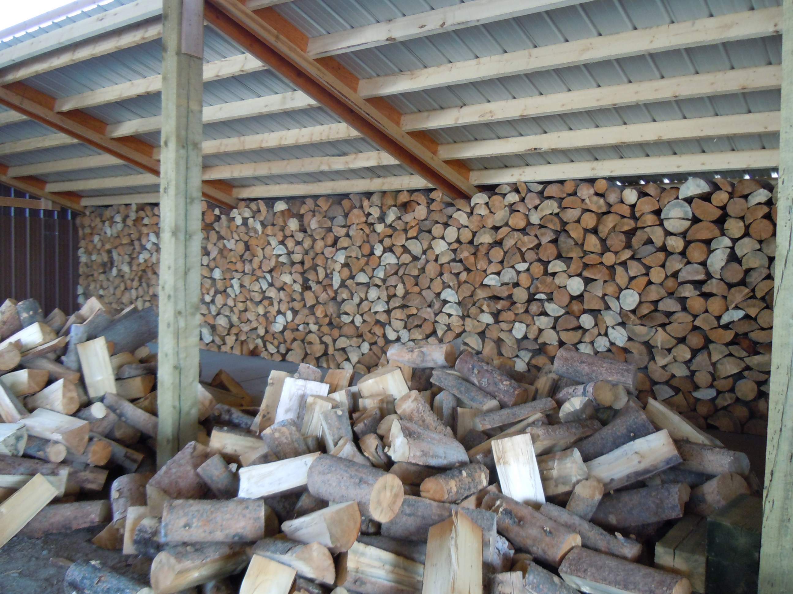

I still do not have the trim yet but have started moving all the firewood into the barn. Lots of work but glad I have a big bucket on the tractor.
Supposed to rain Thursday so I hope I can get all the wood moved in and get the rest of the trim up.

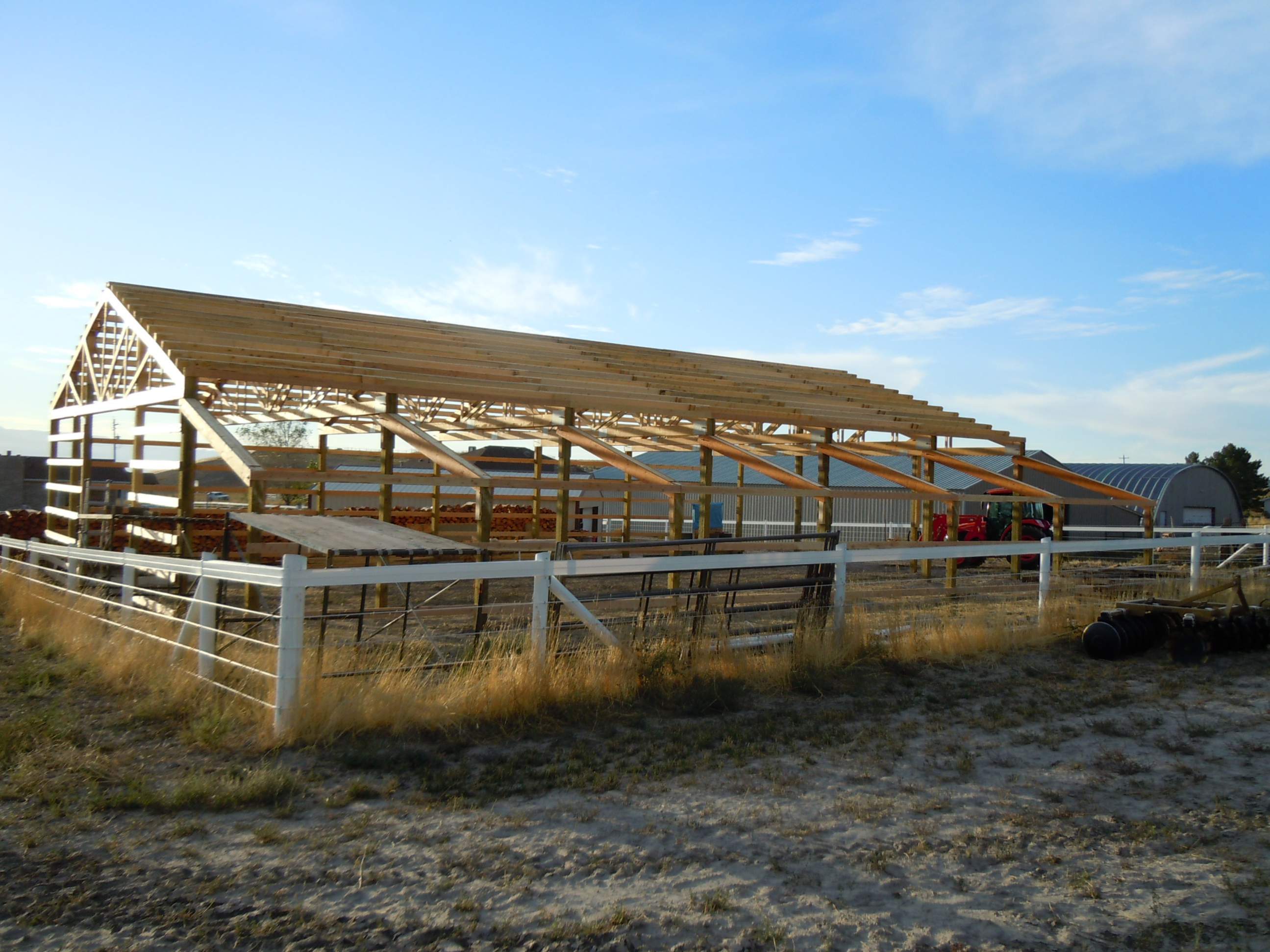

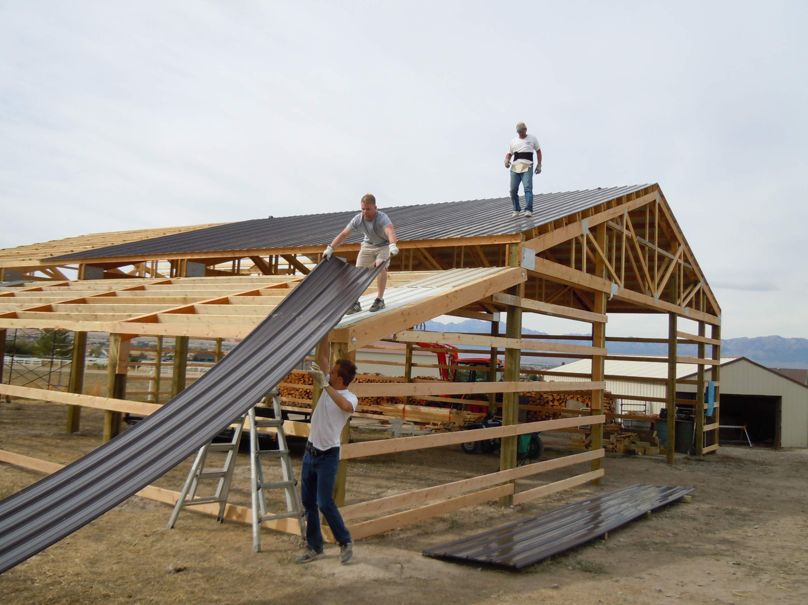

Not sure I posted a picture of how I moved the trusses in place. Since the weight of each one is about 400 pounds trying to carry them in was not much of an option. Maybe when I was 25 it would have been.:laughing:
Here is my only pictures of how it was done.

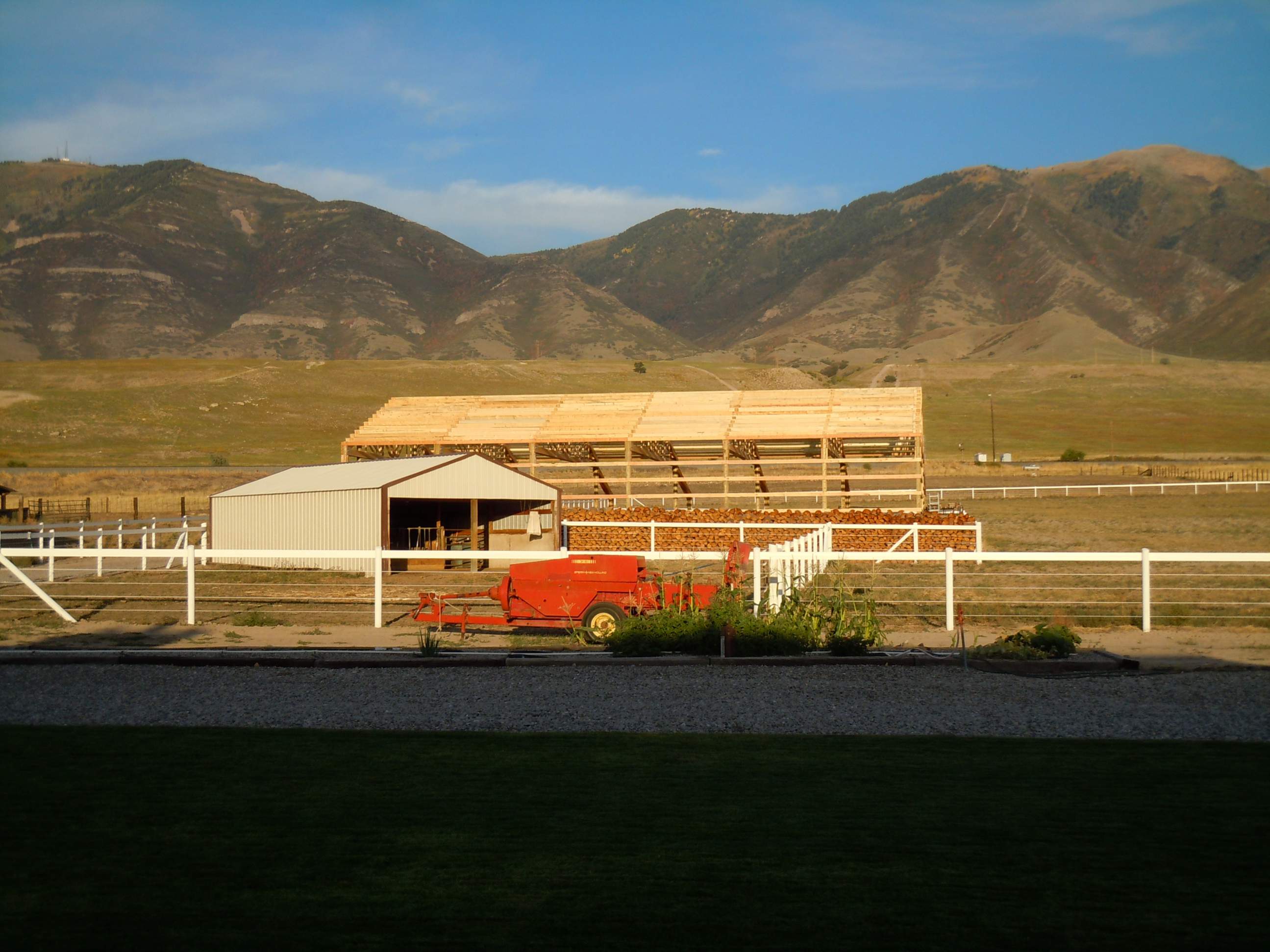

I was able to get some of the trim I was waiting for. The entire roof is now done, that's a good feeling since winter is just around the corner. This picture is looking out my living room window. Note the hint of white up in the mountains. Yes, it's snow!!
   / Raising a barn #52
You've done an incredible job adding beauty and function to a beautiful setting. I know you'll enjoy it as winter moves in. Thanks for posting your project.

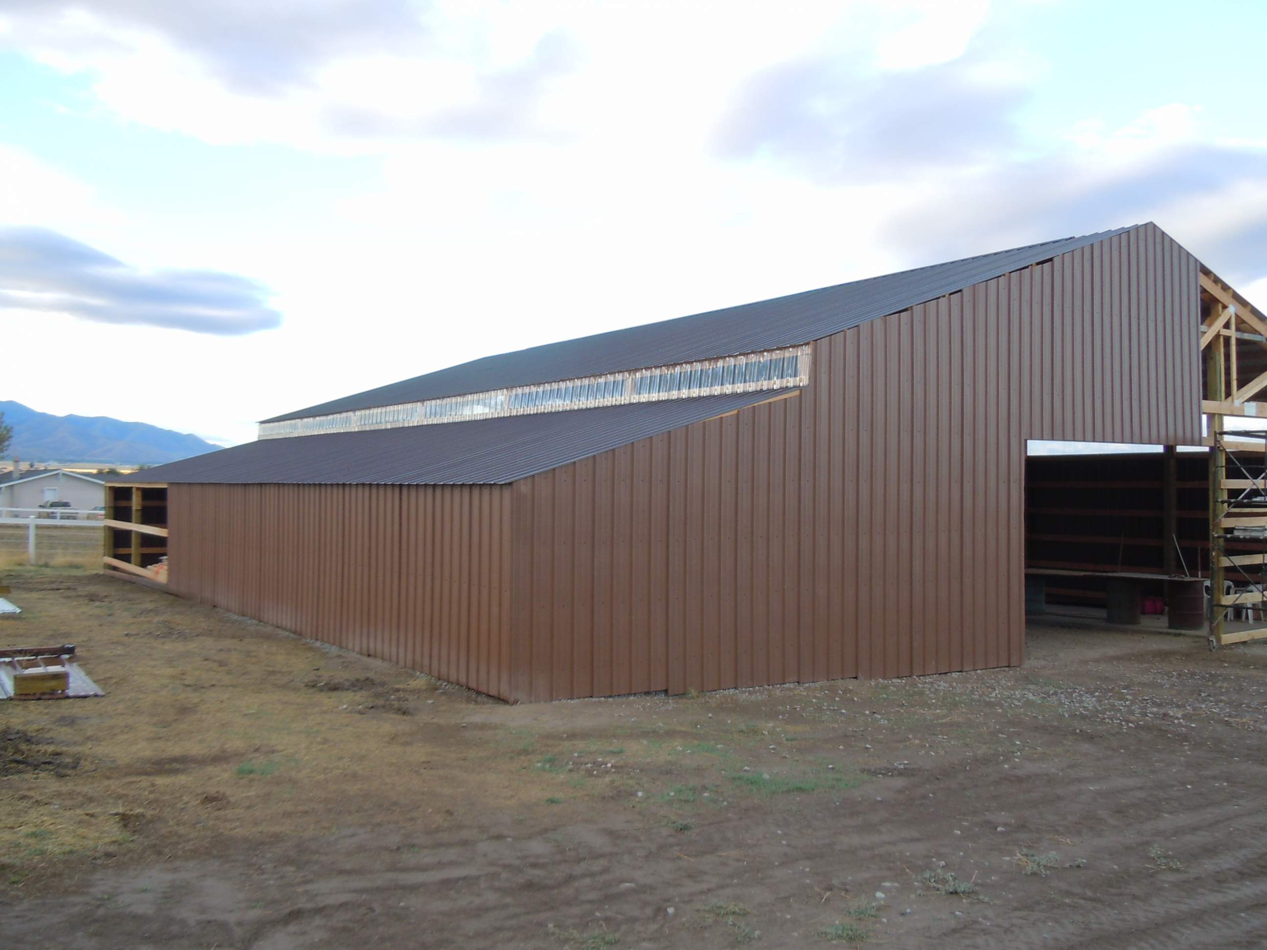

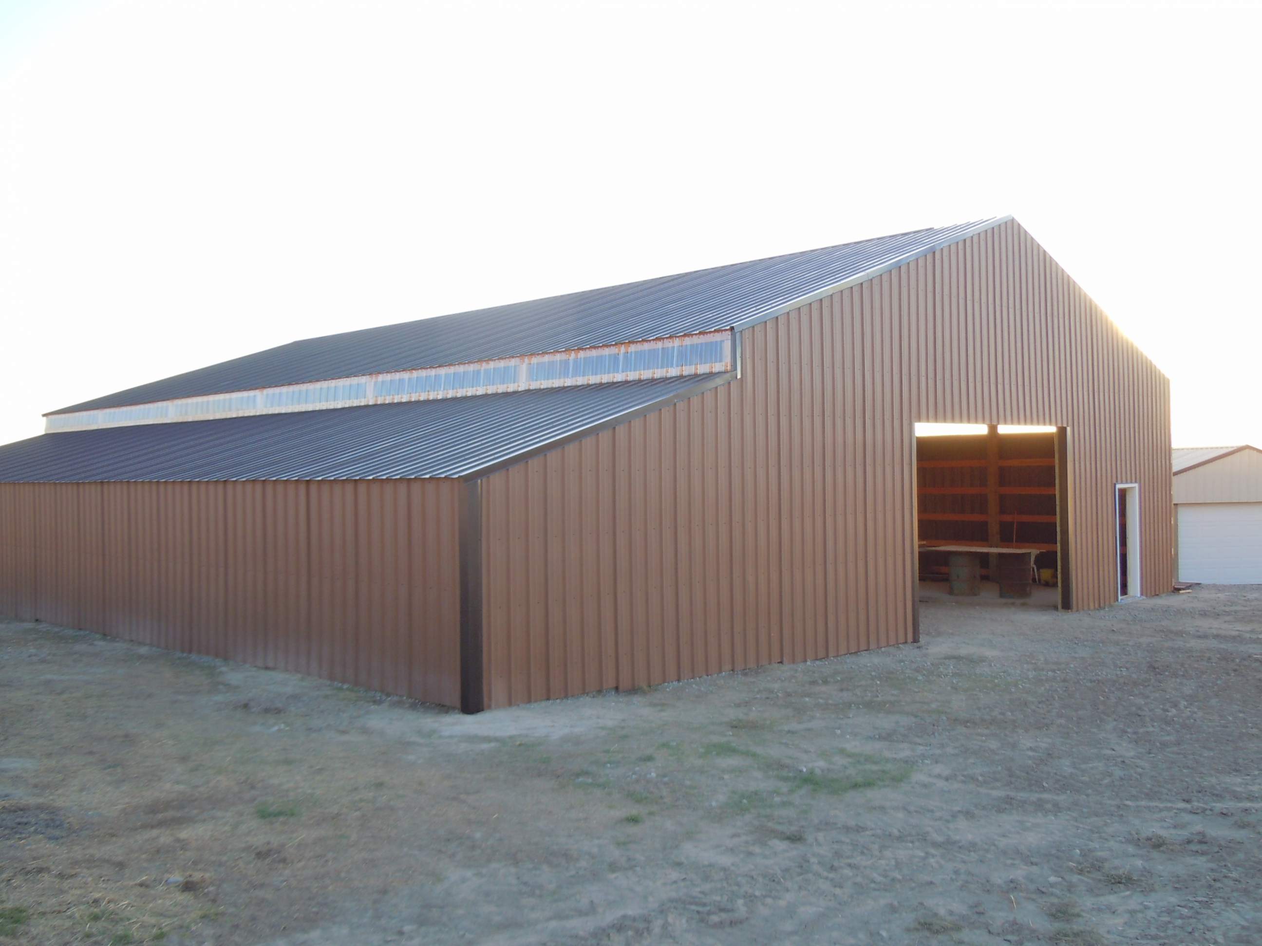

Here is another update on the barn build. As you can see from this picture getting done is a priority.20151110_072044.jpg
I am still struggling with the metal supplier, I have had one problem after another getting the right stuff. (pieces we order and confirm in person) When it shows up or I go to pick it up, it is not correct. I have two corner pieces left and I am done. I hope they show up early next week so I can get my work done. Here are a couple more pictures.
So the pictures without the tractor show the north end which is done. The picture with the tractor is where I still need the corner pieces for the door area. I have the doors ordered they will be roll up garage style and be dark brown to match the trim. Two to three weeks for the doors. I am happy to be getting done, it's been a long haul. The metal supplier delayed this whole thing by at least 4-5 weeks. Any how I think it looks good and will serve me well the rest of my life.
When I get the doors installed I will post some pictures.
Thank you all for your interest.
