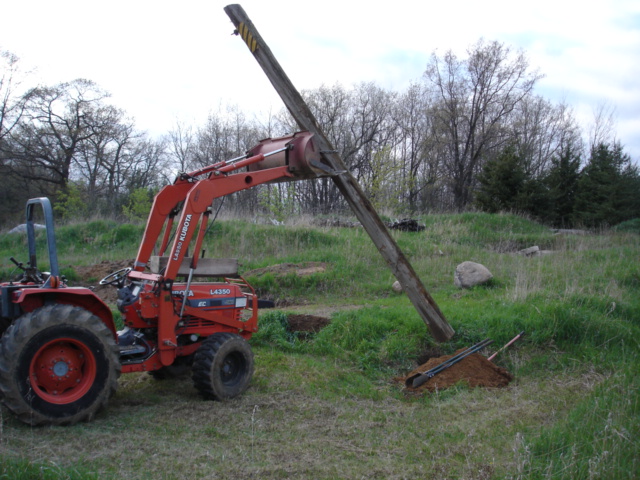

This is how I do it with my tractor and Loader Buddy. This pole is 16" at the butt end and 16' long. I can't imagine doing it w/o any equipment.

Forgot your tool question. I will have come-a-long, chain and tamping bar.
