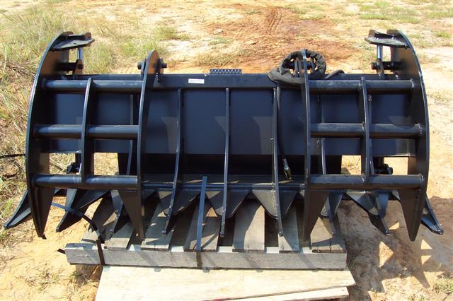

Here are some more pics. I spent some time this evening with my sissors and some cardboard. My first idea was a disaster, but plan B seems to be a winner. I've created a template and have my measurements figured out, so it's time to have it cut out and welded together.
Does anybody have any suggestions on what type of steel I should buy?
Thanks,
Eddie

Since most of the loads are linear, you could go with cold (CRS) or hot rolled steel (HRS). It is less expensive than a tool steel, and HRS is less than cold rolled. But like I said, with it being welded like you bucket shows, they aren't going anywhere. Are there bushings for the pins in the pieces? I would add them if not...even a short length of tubing on each side.
I'm sure you'll get all kinds of suggestions though.

Man, I am interested as can be, and somehow just not following along.
Was your middle picture something that you bought as well from the same guys, that is the magic piece to have, and I am assuming that you took that picture so you have it.
As to the mounts, mine would just be regular mild steel, gain strength by increasing thickness if needed.
That would be a cool mod if you get that done. While I wonder about the strength of the universal quick tach, the bigger tracked skids now days probably have the lift etc. that that 555 has as well, and lord knows they can put some side loads etc on those things, look at the ones carrying the big mulchers and the loads they put on those things.
Looks like it will be neat as all get out!
The other thing I would add, and it will really be a pain, and might not be needed, but I would do it.
TACK all the pieces into place with solid tacks and put it on the machine and try it. I realize it may take an extra trip or two between your place and the welders, but it is sure better to do that then to have the entire assembly solidly welded to find that in the back curl up with loader arms down the quicktach hits a hydrualic line.
Good luck.

I didn't realize you already had gotten the SS adapter center section. Cool, that'll make the job a ton easier. Would you happen to know how much just the adapter was?
/ Rake Grapple for my 555E #28
Grapple looks great. Nice template for the pin adapter too. Double check the angles to get adequate dump and curl once you put your adapter on. Looks to me like you are duplicating the bucket angles which obviously should work so long as your bucket can dump all the way to put the whole bucket face on the ground and curls enough to hold a load without clamping.
What gauge steel are you going to use for the bracket linking your pins to the QA fittings? Might take some engineering calculations but I was thinking off the top of my head something like 5/16 or maybe even 3/8 give the power of your loader.

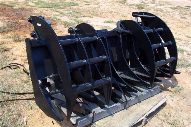

Nice looking grapple. Do know what the weight was with the two grapples?
Rik

I'll have to check to see if I have a weight for the grapple some place. It's six feet wide, but other then that, I don't have a clue what it weighs. I have 4,000 pounds of lift on my loader, so the weight of the grapple isn't a concern.

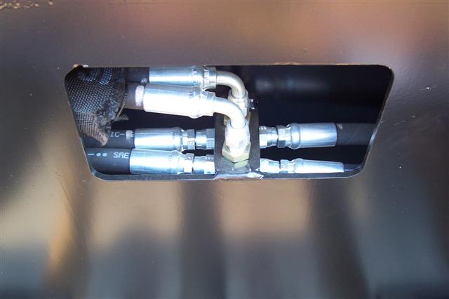

I made a bracket from some angle iron for the valve. I cut two pieces to fit on either side of it so that the hoses would fit and have good access. Then I spray painted it all black. I'm also going to create some sort of cover for it. I'm not sure if it's needed, but I figure it might be a good idea.
Eddie

To make operate the valve, I decided to use a button that already exists on my loader controler. The red button puts my transmission in neutral. I've never understood what this was for or where I would use it, so for the last five years, I've never used it.
Now it will switch the hydraulics from tilting the bucket, to operating the grapple. I just push the botton and then the controler will open and close it. I let go of the button, and it goes back to controlling the angle of the bucket.
Eddie
