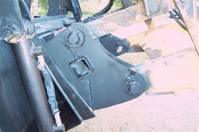

The welder got right on fixing the bushings. He was kind of embarassed by what happened and said he might have removed the pin while he was welding and plain forgot to check his work. I felt he was being honest about it, even thought it's annoying to have to bring it back and deal with such a simple mistake on his part.
It was done before noon, so they didn't mess around.
I had to do some things the next day, so my dad took off the loader bucket and installed the Quick Attach attachment by himself. He's 72 years old, but said it wasn't that dificult.

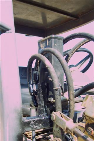

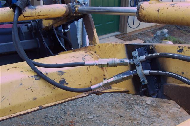

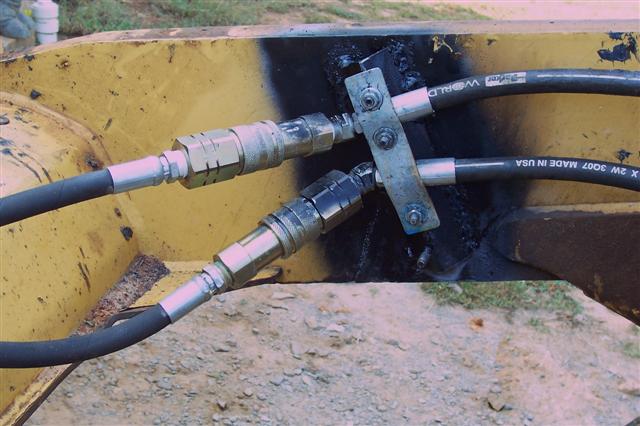

When I got home, I started fabricating some brackets for the hoses. They run down the inside of the loader arm so they will be out of the way and hopefully less likely to get damaged.
The bracket is a piece of angle iron that I drilled four holes in to hold four bolts. I welded them into place and then welded the bracket onto the loader arm. After installing the hoses, I saw that I had made a mistake in how close the bottom hose came to the tie down bracket for the backhoe. It's a massive piece of steel used to hold the backhoe in place when it's on a trailer. Too big and important to mess with, so I moved the hose up a little and created a new piece of steel to hold them in place on the same bracket. It was a little delay, but nothing major.
To hold the hoses from the grapple in place and allow them some movement without getting tangled, I cut the thread off an axle U bolt that I had lying around from something that I don't remember. This was a very simple idea that seems to be working very well.
The valve works great. Just push the botton on the loader joystick and it goes from tilting, or dumping, the bucket, to opening and closing the grapple. You have to positing the grapple to where you want it first, but that's pretty basic. I really only works in the straight up and down positing anyway. Once it's where you want it, then there isn't any real need to change the angle of the rake part of the grapple. Just drive up to the tree, give it a little nudge or make contact with it, and then close the grapple. It works great!!!
Anyway, the electric solinoid that actuates it is on the top of the valve assembly. It's on part of my ROPS, which is exposed to the weather. I don't know how weather proof it is, but figured there was no point in testing it. I got lucky in that a plastic case for my welding rods was a perfect fit over it. I notched it to give it a better, tigher fit, and just slid it over the solinoid.

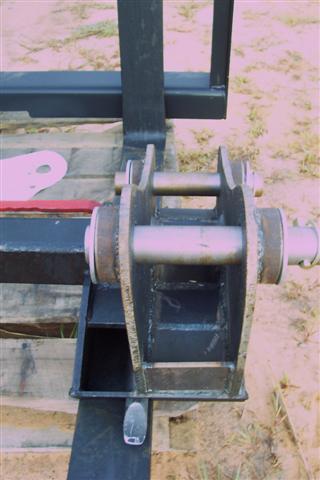

#42

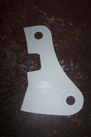

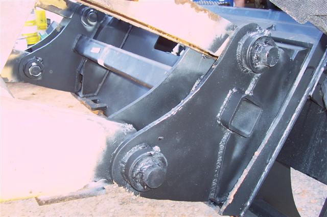

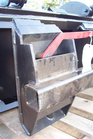

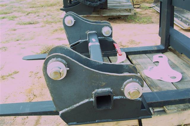

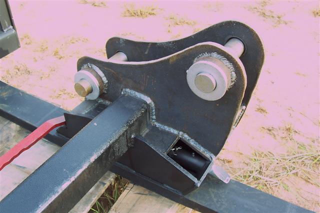

The bracket that I designed and had welded onto the Quick Attach attachement worked out perfectly. I don't know where I got the idea to do this, or if I just got extrely lucky, but it's a perfect fit.
The welder really did a nice job of this, much better then I'm capable of.
Eddie

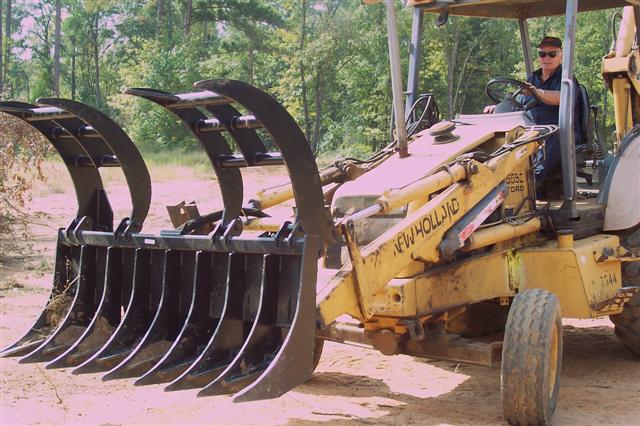

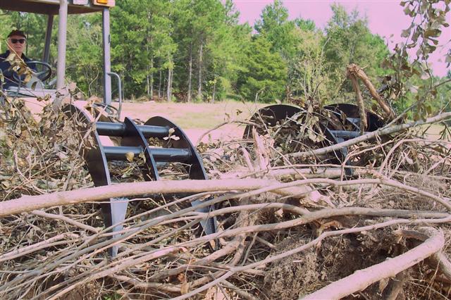

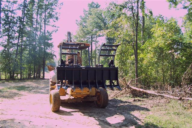

#43

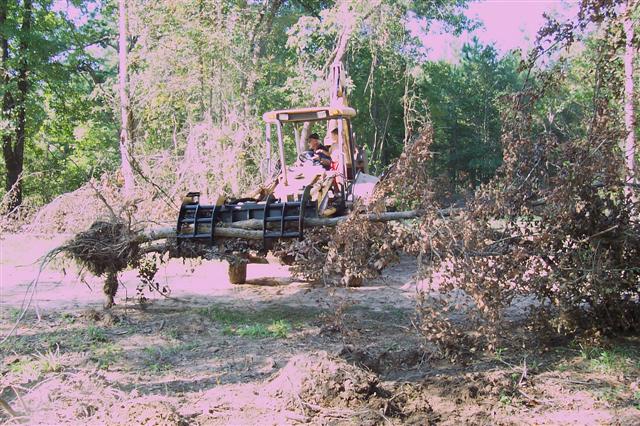

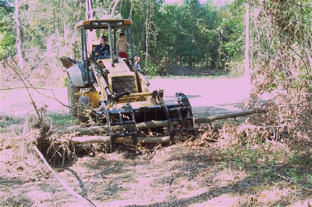

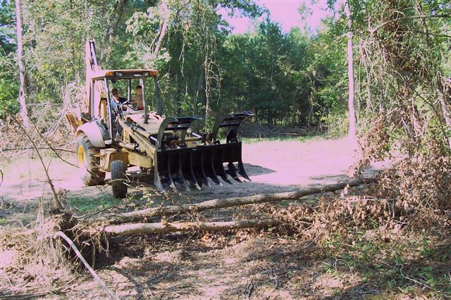

Now for the test run.
My dad had the honors and we were both a little nervous on how it would work. Just normal fears I think, but after all that was done, it would be a real shame if it didn't do what we had hoped it would do.
It works better then we had hoped it would. The rake is very easy to see through and position the tractor for picking up stuff. The grapples are just amazing. They close until they are tight and if one side of the load is thicker then the other side, then one side will close more then the other and both sides are tight!!!!
The best part is how fast and easy it is to pick up the trees and carry them to the burn pile. I bet that my dad got a weeks worth of clearing done in just two hours. The amount of material that he moved was just staggering!!! We had to stop because the pile was getting too big and we needed to get a fire going. Of course, these were trees that have been on the ground awhile, so it was just picking them up and carrying them to the pile, but that's been the biggest time consumer for us. Not to mention the effort of climbing on and off of the backhoe to tie the chain around the trees, then doing it again to unhook the chain.
After less then a day of use, it's pretty obvious that this is something that I should have done years ago. The amount of time and energy that I've wasted is just staggering. But at least I have it now and the future looks really good!!!! :)
Eddie

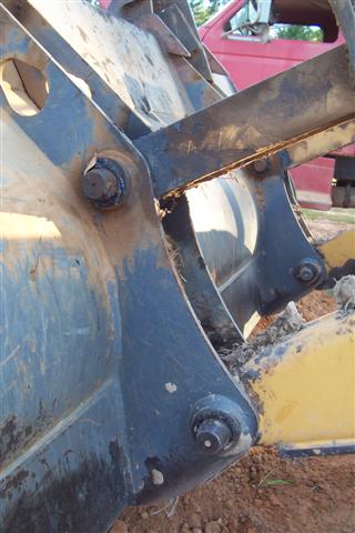

I'm sort of embarrassed at how easy it actually was to install it. Too much thinking and not enough comprehension on how it works is what I'm thinking caused me to shy away from this. Now that it's done, I'm kicking myself for not doing it five years ago!!!! There's no telling the time I've wasted, but then again, what's done is done.
One issue that we've discovered is that when it's on and down to hold the backhoe in place while taking out trees, it will come loose. I'm gonna have to think of a way to lock the bottom into position since there is so much force put on it when the backhoe is digging.
My first thought is to weld on some brackets that I can slide a half inch or 3/4 inch pin through. Something secure, but easy to remove.
Eddie
