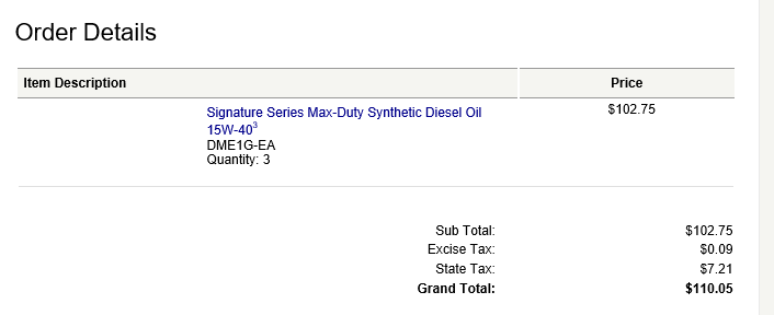

I have a 2015 2500 Longhorn with just under 80k miles. I have used Amsoil since the first oil change. I became a preferred member for something like $20 a year that saves quite a bit due to free shipping for orders over $100 plus the lower cost of the oil. Here's what I paid for 3 gallons of 15w-40. They also have a 5W-40 for colder climates. Even though the company is in Texas they have warehouses all around. I order before noon and I get it delivered from Orland the next day. Other full synthetics like Mobile 1 are good too but I believe that Asmoil is the only one that adds ester that helps keep seals soft.

Why would synthetic oil run cooler? Cummins engines don't have a problem with the oil overheating. Look at DonRybaks example and see that Amsoil costs over three times as much as Delo and even Delo should make your engine run for 500,000 miles or more.
