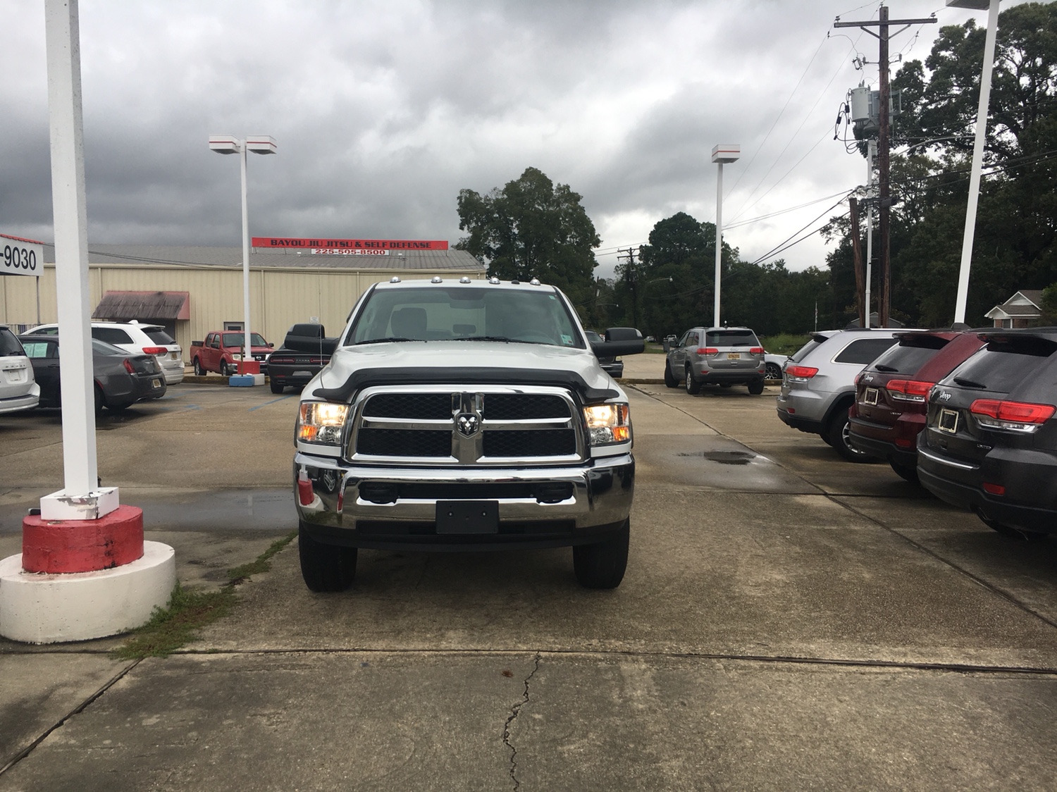

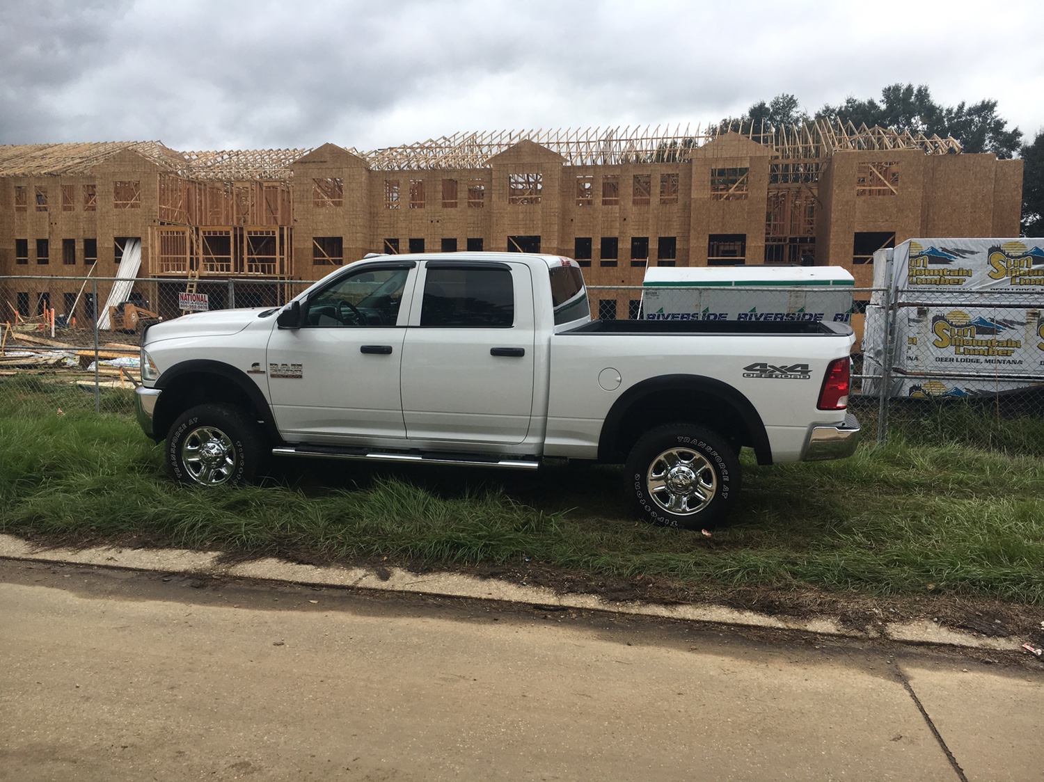

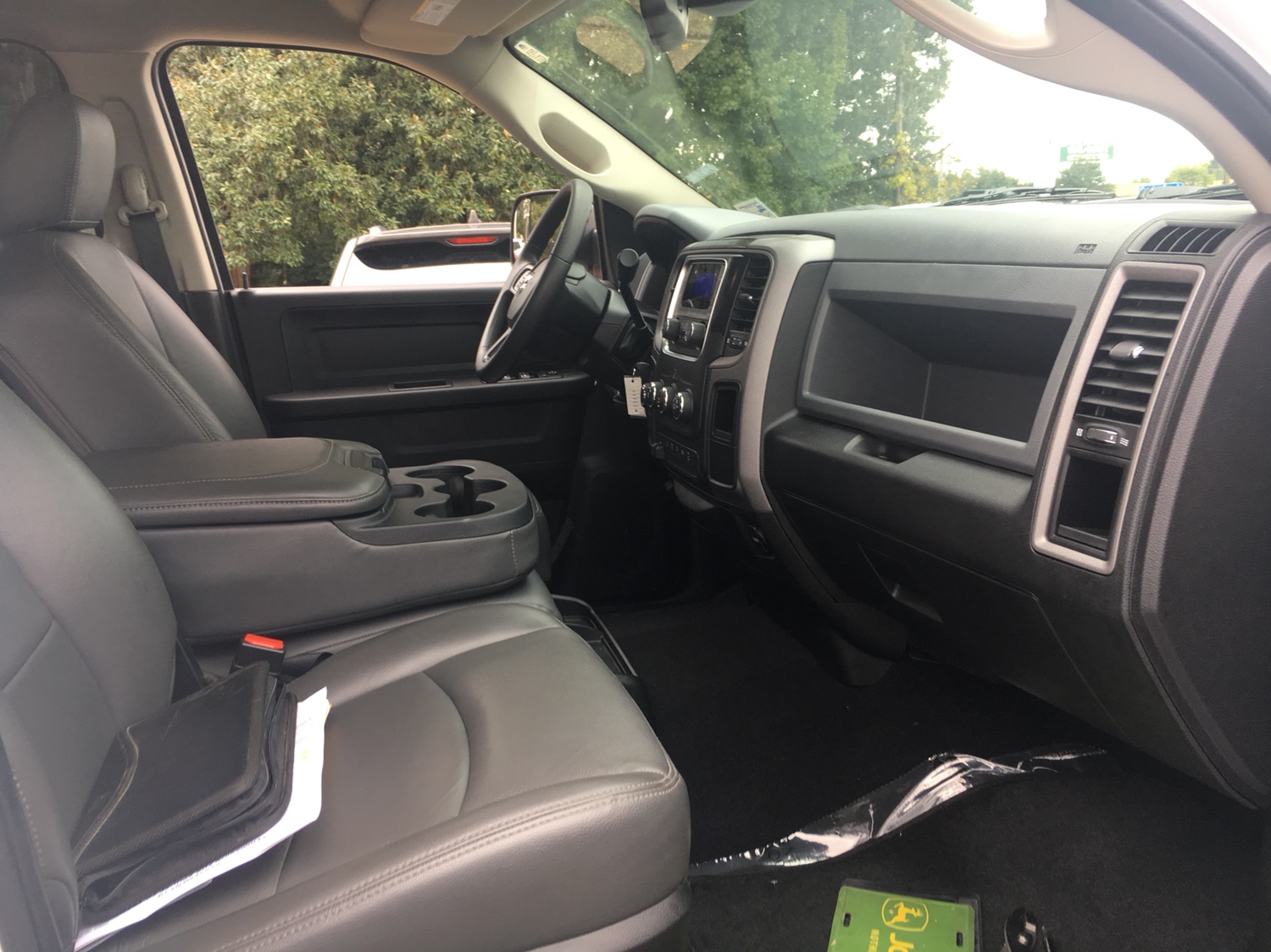

The deal is done. Truly will miss the Tundra, but interested to see how the Ram/Cummins hold up. Here are some pics
