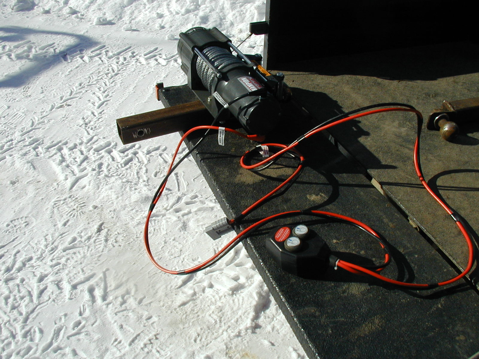

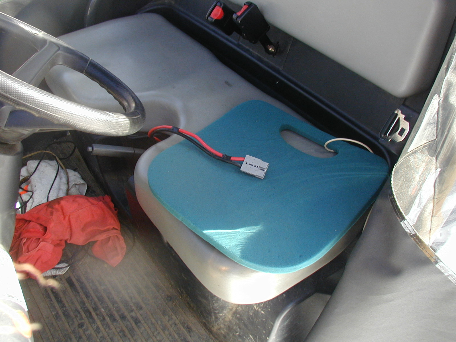

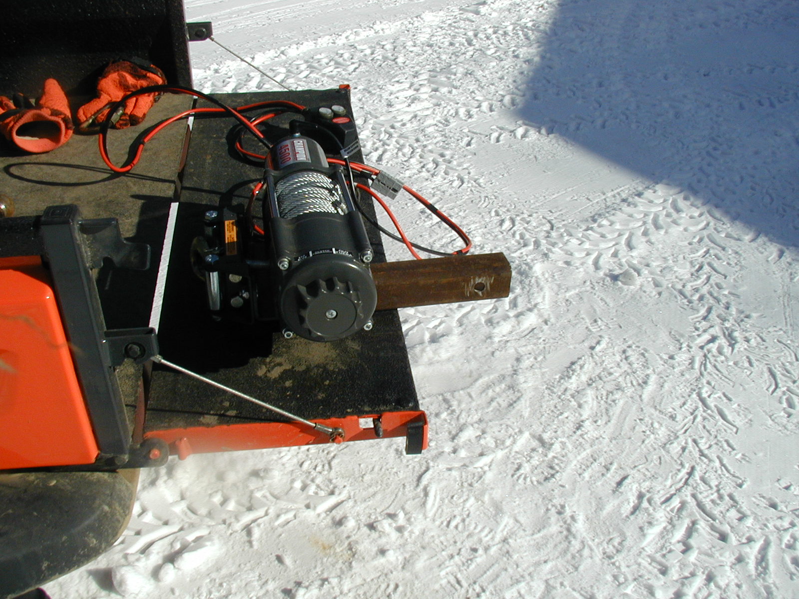

Mounted my winch (TSC $150.00) on a piece of steel plate welded to "2 tube, can put in the front or rear of the RTC, Tractor, Truck with Anderson Powerplugs. I have the hand remote for the winch control.

O.K. I think I did it right this time!!!!!!!!!!!
JW5875 Connected to battery and ran the lead through the hand brake. boot
