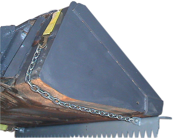

Interesting product. I'll wait for the reviews, but one thing in the design would worry me and that's how much wear the straps would take when back draging. Would seem the nylon straps would eventually tear from contact with rocks/roots/etc. Wonder why the bolt on version is no longer available as noted in the video.
   / Ratchet Rake - ever seen/used one? #36
I agree the straps would seem to wear.Id like to have been able to see how it bolts onto the bucket. It could and should be fairly simple to weld some thing up.I assume the advantage of the straps is that it can be moved from on machine to another.

Talked to my brother in law, a machinist and had him look at web site to appraise value of product in regards cost to make. He said the grade of steel and thickness of the $299 one is a good deal at that price. He looked up patient and saw it started in 2004 and originally was welded pieces before now being what looks like bent steel and originally bolted on before straps. He speculated it changed to straps from bolts for convenience to quickly attach to bucket. If it's an issue I'm sure holes could be drilled to make it bolt on. I had a toothed bar on an earlier tractor and I believe this will do a much better job for what I want it to do than a tooth bar. The finer tips and spacing appear to better meet my needs. Hope you guys get yours quick and report back. I want one of these. Mybe they will let me go to Denton, NC to EE's house and pick it up. He'll probably have a bunch of raw fish to eat if he even offers me anything to eat. I may bring him some of the Colonels Chicken (fried).
On the site I saw where they suggested using chain on the bottom of the bucket....
Ratchet Rake - Photo
